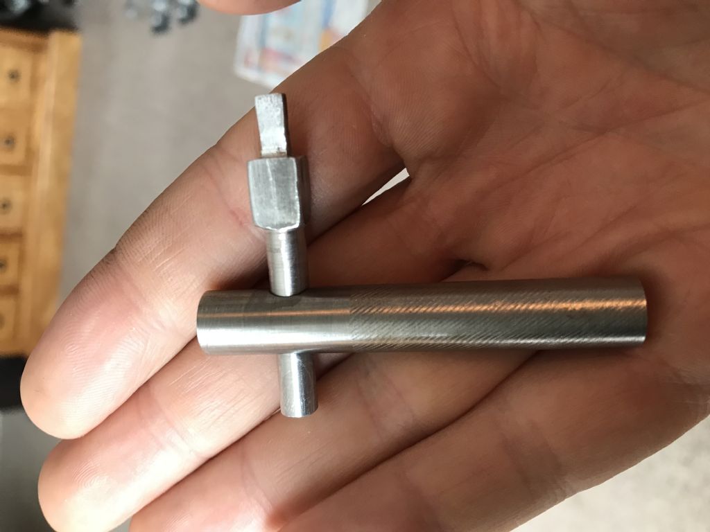

            Hi guys, it’s been a long time since I’ve managed to get on here. Suffice it to say I haven’t plucked up the courage to try out the various methods you all suggested, the main reason is the lack of material I have in case (or perhaps when) I make a mistake, I’m trying to build up my collection of offcuts so that I can try and try again before committing to the project proper.
            Anyway I feel I have finally made a useful tool that I needed. I bought a second hand 4 jaw chuck without a key, an Allen key worked on 3/4 screws but number 2 seemed more worn than the others so the key wouldn’t grip. The inside shape was also square rather than hexagonal.
            I started the hole central on the outside cylinder but as I increased the drill side I think it drifted slightly. I also have not been shown how to tap and thread yet and my first couple of efforts weren’t good so I decided to try to make it press fit and use loctite. In the same vein knurling is a brand new concept but I decided to have a go, it wasn’t perfect and hardly improves the grip but aesthetically it didn’t detract too much.
            I realise most seasoned engineers would simply grind a square from an old Allen key or something but I wanted to practice some techniques. Feel free to commen and please don’t be too harsh with the criticisms to come
