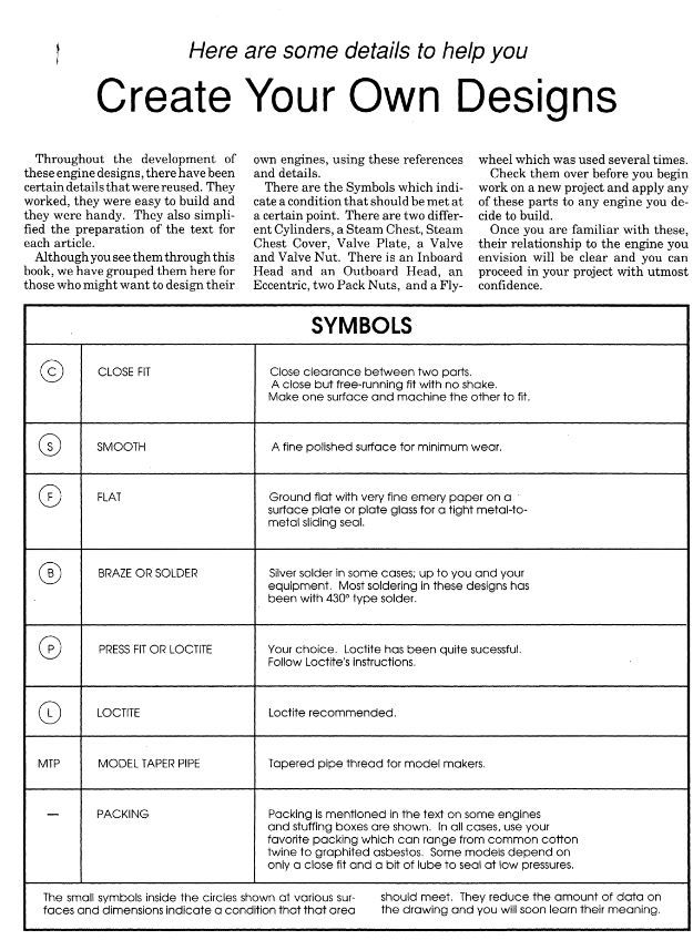

                #369964
                  You'll be wanting this page

                        #370004
                          Well Elmer's drawings are from America so won't be to any British Standard.
                          Also as they were being published in a book it was not possible to lay them all out and neatly space everything, more a case of getting one engine onto a page or two if a larger design. Also you have part and assembly drawings as one to again keep space down.
                          Then again thousands of engines must have been built to his designs over time so with a bit of help for the beginner they can be made without getting bogged down in the finer points of drawing standards etc.

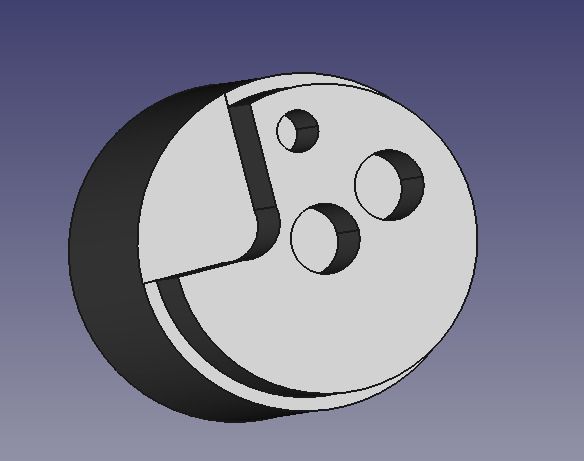

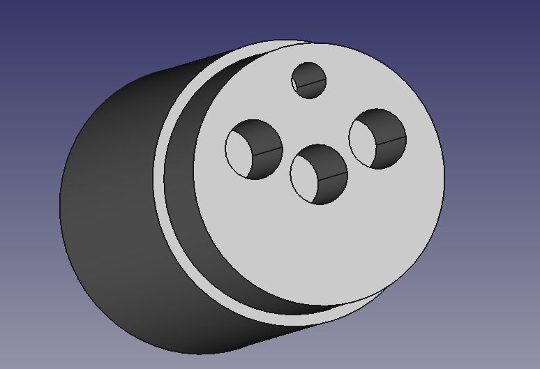

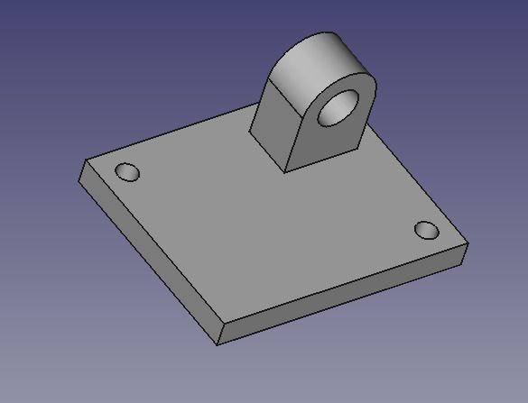

                                I agree with Howard, dropping poor Alastair straight into details may not be helpful. How about this for a starter for ten.
                                Consider being asked to make this object:
                                Houston, we have a problem. Although the shape is defined, there are at least two ambiguities: does the large hole go all the way through, and, is there a third corner hole hidden behind the boss?
                                Looking at the object from another angle clears one point up (no third corner hole), but the large hole isn't quite nailed down – is it a single through hole, or is it two holes that don't meet in the middle?
                                A drawing that will be used to make an object should provide all the information needed. The designer / draughtsman should not leave the builder in the dark.

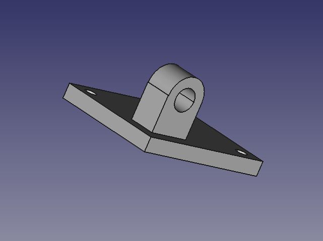

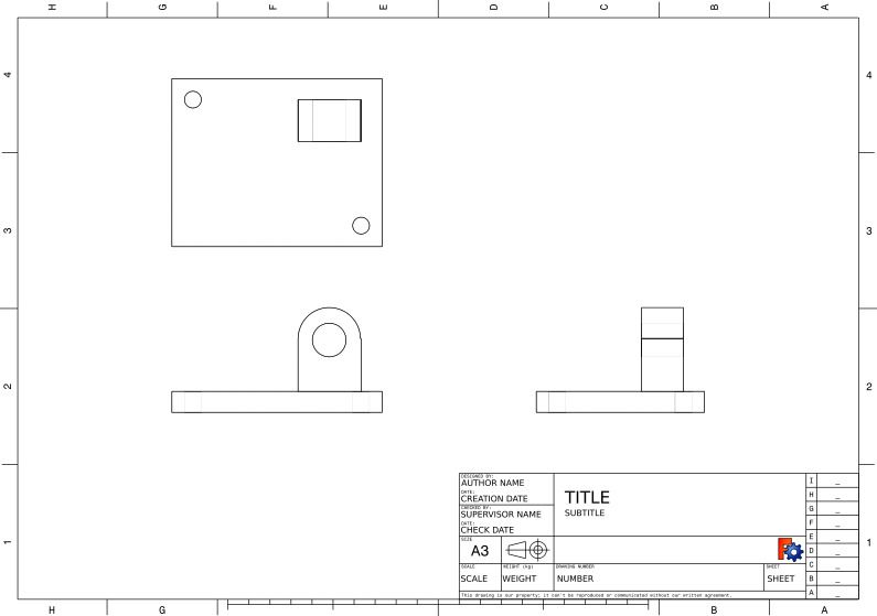

                                At a basic level, an engineering drawing will provide three views of the same object. What it looks like from the front, what it looks like from the side, and what it looks like in plan view.
                                This drawing shows that the large hole goes clear through the boss. Dotted lines (not very clear in the picture) show hidden detail.
                                The example drawing is still incomplete; no dimensions are shown, nor are we told what the object is to be made from. The way dimensions and construction lines are shown and the way the drawing is identified, perhaps with version control, follow a standard. As there are a number of differences, and changes over time, it's best to approach drawings with suspicion. Amateur drawings tend to bend the rules, perhaps mixing different standards in the same drawing. When faced with an unknown drawing, I redraw it 'my way' to make sure I've understood it. Some objects are 'back of an envelope' simple, others call for 3D CAD.
                                Finally, 'What it looks like from the front, what it looks like from the side, and what it looks like in plan view.' is itself multi-choice – for example, is plan view from above or underneath? Older British and European practice was to draw plans 'First Angle'. The Americans spotted advantages in drawing plans in 'Third Angle', and this is now the preferred method world-wide. (The advantage mainly appears in complex drawings.) In my experience, the difference between First and Third Angle is rarely a problem. However, getting First Angle and Third Angle confused might mean certain features are made as mirror images of the designers true intent.

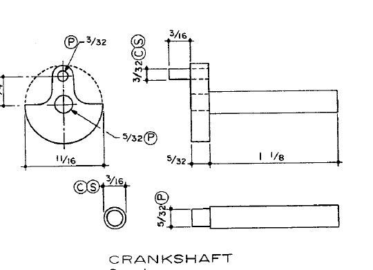

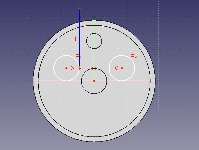

                                    How would I machine the disc into the shape required for the crankshaft? The letters SF CF C P etc also are not clear to me, I keep looking through the plans and reading the instructions provided hoping to find one bit that I fully understand how to do but it’s all quite overwhelming and I get bogged down by the overall thing.
                                    Edited By JasonB on 02/09/2018 14:30:30
                                    #370047
                                      P – the 5/32" dia end of the shaft is a Press fit into the 5/32" hole in the web though you could also use a suitable loctite.
                                      S – the 3/16" dia shaft and the 3/32" pin want a good Smooth finish as these have other parts that rotate against them.
                                      C – As well as the above two parts needing a smooth finish they need to be a Close fit in the mating parts otherwise your crankshaft will wobble about and the conrod will knock on the pin.
                                      I'll give someone else a chance to suggest a machining method, if not takers I'll come back later.

                                        Drawings are supposed to be a formal document fully specifying what's to be made, but they often fall short of this.
                                        For example, Alastair's end view of the crankshaft assembly doesn't specify the radii at the bottom of the cutouts or around the crankpin hole at the top. I think I might want to make the throw with the 3/32" hole in it 1/4" wide, although it scales at more like 3/16". With that uncertainty, I might draw it out by hand at 2 or 3:1 to see what looked most like the drawing as printed. Many drawings carry the legend 'Do Not Scale', to indicate that using a ruler to settle an unspecified dimension is at own risk.
                                        Could you clamp a piece of 11/16" diameter material in your vice with the flat end facing your mill spindle and mill out the pockets to a depth of a bit more than 5/32" prior to parting off in the lathe chuck? You'd need a length of at least 5/32 + part off tool width + enough to grip in the chuck. It would be simplest to file the radius around the crankpin hole, or grind it with a bench grinder if you can be cute enough.

                                          This is how I'd do it.
                                          1. In the lathe 3-jaw, turn a 3/4" rod down to 11/16" for about 1/2" and face-off.
                                          2. Drill the 5/32" hole for the axle, about 1/2" deep.
                                          3. Remove from the lathe and mark out and centre-punch the position of the 3/32" hole for the crank-pin. The position must be accurate. By eye, because the position isn't important mark out and centre-punch the two 5/32" holes that will form the cheeks.
                                          4. In the milling attachment or a drill press, drill two 5/32" holes, and one 3/32" hole, all about 1/2" deep.
                                          5. Mill off the unwanted metal in each quadrant, one side only done in picture:
                                          6. Saw or part off the crank disk, reverse it in the 3-jaw making sure the rear face is flat to the chuck, and then face-off the rough side leaving the required thickness (3/32&quot
                                          7. Round off the sharp edges on the crankpin radius with a file until it looks OK.
                                          None of the machining need be accurate apart from the 3/32" crank-pin hole, and the 5/32" axle hole, and that their centres are the right distance apart. (I guessed because the dimension got chopped off!)
                                          I like to keep parts attached to the mother metal for as long as possible because it often makes work holding easier. Depending on the exact shape and equipment used, it may be more convenient to cut off the 3/4" rod and clamp the semi-finished part instead. Don't be afraid to experiment with different approaches, and don't be put off by a few failures!
                                          The crank-pin and axle parts are both turned in the lathe very slightly oversize (say a thou) to be a 'has to be tapped in with a hammer' fit to the holes in the disc. Or as Jason says, Locktite will secure looser parts perfectly well.
                                          If anyone has a better way, please suggest it. I still have a lot to learn…

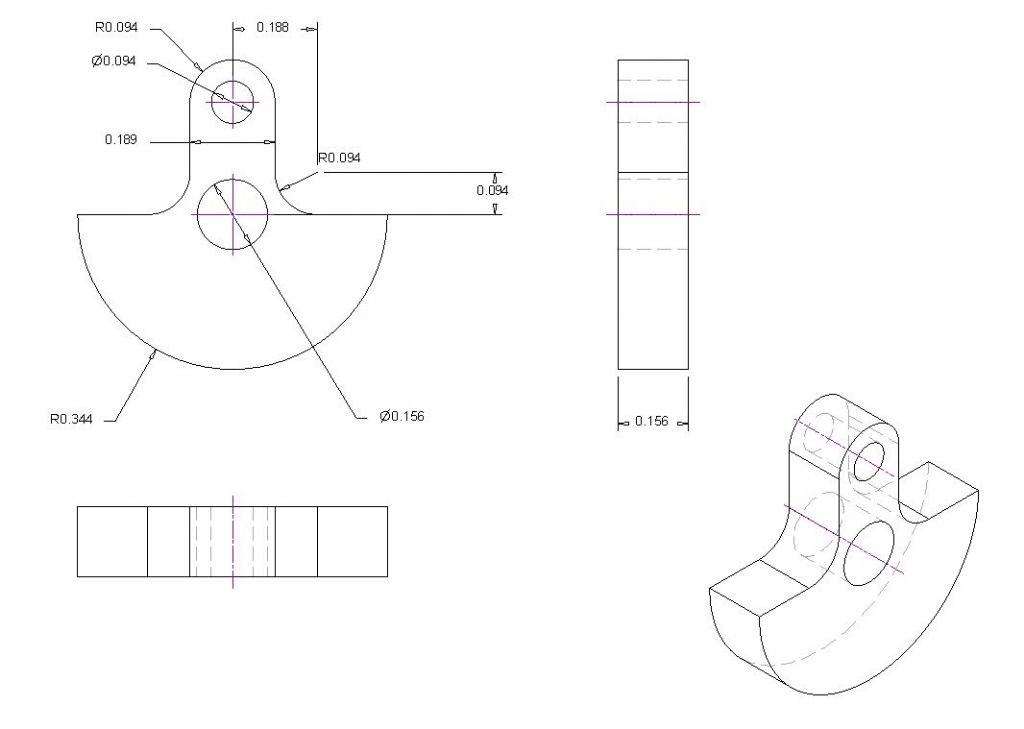

                                                    I posted the extract from the drawing and chopped off the 1/4" dimension, have a look at this on how to post photos but as the copyright issues on Elmer's designs are a bit uncertain an extract is better than the whole thing.
                                                    I would start off in much the same way as Dave describes to get a stub of bar with the 4 holes in it.
                                                    I would then either part off a little over length or saw off and and face again leaving a little over length. You then have the choice of milling away the two unwanted areas or you could simply saw down towards the hole that defines the corner to remove most of the waste material and then file the rest to your lines. Milling can be done with the work held vertically in the vice, the top radius can be filed.
                                                    At this stage I would put the web to one side and machine the shaft making the 5/32" spigot a little longer than needed. When you get close to the 5/32" use the hole in your crank web as a gauge rather than measuring as your hole may be a bit over or under the nominal 5/32" of the drill.
                                                    You can then press or loctite the web onto the shaft before returning it to the lathe where the web can be machined to finished thickness while holding in the chuck by the shaft. Doing it this way will ensure the face of the web is at true right angles to the shaft even if it pressed or bonded on a bit wonky
                                                    This is a quick sketch that will give you the position of two 3/16" holes to define the corners of the cut out parts. Click to enlarge
                                                    Edited By JasonB on 02/09/2018 17:04:02
