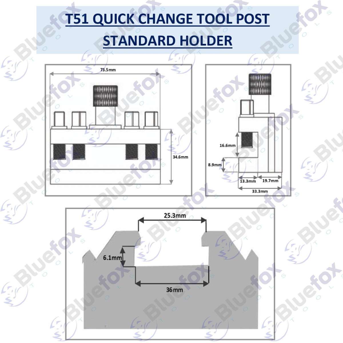

      Is there a dimensional standard?
      #507154
      Bo’sun
        @bosun58570
        Good morning,
        In response to a previous topic of mine, I purchased an inexpensive T51 (as advertised) Dixon style tool holder from Amazon, hopefully to fit my Warco QCTP. I reasoned, that if it didn't fit, I hadn't lost much.
        The tool holder duly arrived and appeared realy well made. It fitted one side of the QCTP perfectly, but the second side would barely clamp up. I'm guessing there's a dimensional issue?
        Presumably (and I say that cautiously) there is some sort of dimensional standard for these? Anyone know where I can find one?
        #507159
        DC31k
          @dc31k
          Start here:
          https://www.model-engineer.co.uk/forums/postings.asp?th=135594
          Continue here:
          Google "dickson toolpost dimensions" and look at images.
          Try a different combination of eccentric cams, sides and top-hat parts (number the holes 1 & 2, the cams 1 & 2 and the top-hats 1& 2. Try all possibilities).

                        Depends where the problem is that is stopping the clamp going tight. A simple bit of linish/belt sander work got some of the ones I bought to fit.

                          The design of the Dickson toolpost system is over-constrained, so the holders need to be made to a high degree of accuracy over multiple dimensions to fit properly. Although I (mostly) don’t use a QCTP all my Dickson holders are genuine parts with one exception. The exception was made by A&R (I think) who was a toolmaker and at one time supplied holders after Dickson stopped making them. I think he ceased trading some years ago.

                              My problem is that the RDG holders do not clamp…the distance from the piston face to the holder face is larger than the Warco holder…
                              when the cam is turned the piston does not push out far enough to engage on the holder face, and the cam can be turned fully round…
                              They would probably be fine with a RDG QCTP…
                              RDG we’re doing a good deal some time ago so I bought 6, but have only recently got round to using them…If I’d have know the problem then, I would have just bought one to try the fit…Hind sight..etc..Hopefully this may  pre warn anyone doing the same..
                              The Warco holders have now doubled in price…It was a while ago that I bought the originals 🙄
                              #724047
                                Had that too on a couple. I sacrificed a Woodruff cutter to thin down the inner edge that the piston pulls against. If doing it again a cheap carbide Tee or Woodruff cutter from the likes of Ali may stand up better.
                                It is not just pushing out far enough but you also need to ensure it pulls up enough to go round as far a sother holdes allow as it will come loose if not.

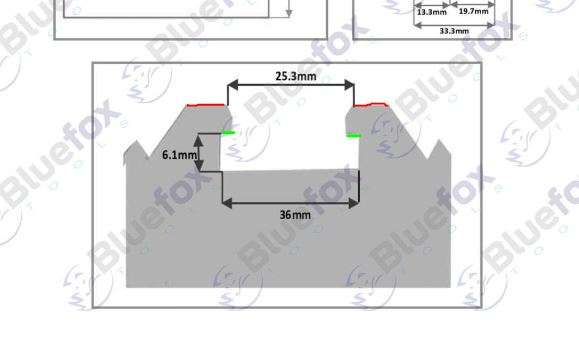

                                      I have always found the angled surfaces OK but problem is either the red area touches the post before the angled faces make full contact, linish the red area down. Or the area shown green needs to b emachined away as either the piston won’t reach or cannot be tightened enough to hold.
                                      dickson

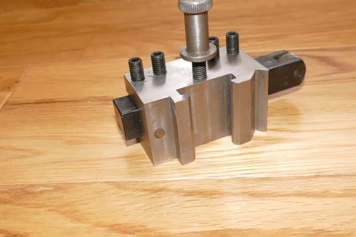

                                                  The issue of over constraint on these tool holders led me make one that only had one V and an adjustment screw in place of the other V. It was a proof of concept tool holder and it works fine. It can be adjusted to allow the plunger to retract to the point where it toggles properly which is something the purchased ones clearly fail to do.
                                                  P1170423
                                                  Martin C
                                                  #724222
                                                    Martin C
                                                    2 vees are a pain to manufacture but IF made correctly they work fine, looking at your offering it’s easier to make but I’m not liking the single location vee close to the cutting tool end and the clamp behind it with no 2nd vee further outboard to support alignment and resist pivoting. Just my first impressions and hardly a problem in hobby machining, who knows what would happen under a heavy cut.
                                                    Tony
                                                    #724236
                                                    Martin Connelly
                                                      @martinconnelly55370
                                                      In order to lift off the single V something would have to give, either the piston or the lips that it pulls on or the V of the tool holder, I think the tool post is a harder steel so unlikely to be the thing that moves. Since the piston cam is over-centred as it is adjustable that is not going to rotate to a position where it is loose, which is a possibility with two Vs and a cam that is not able to go slightly over centre and so is unable to effectively toggle.
                                                      The issue with two Vs is that if there is any deviation from the exact dimension between them, even if within tolerance, on either the tool holder, the tool post or both then you cannot predict which V the tool holder will settle on and be high on the other. This is the over constraint in the design that has been mentioned. It is like the difference in stability of a tripod and a four legged table on an uneven surface. It is possible to set up the tool to a zero, take the tool holder off and replace the tool holder and find it is no longer at the previous zero point. It is similar to the problem of taking something that has just been turned out of a chuck then putting it back in and finding it is not running true. Friction prevents the small movements needed for things to settle in the same position. It can also be compared to the location of something on a jig where if you have two round pins to go into two round holes you will have a problem but if one of the pins is lozenge shaped and oriented correctly then parts fit on and come off easily but are correctly restrained, not over constrained. Basic jig and tool design philosophy, no more constraint than is needed.
                                                      The issue of not being adjustable for the purpose of toggling the cam is that you can get the cam pulling up the piston in different positions due to manufacturing tolerances. If you filed a bit out of the hole in the piston to get a toggling action for one tool holder then the next tool holder you try might let the cam go over centre but not pull the piston tight enough.
                                                      Martin C
