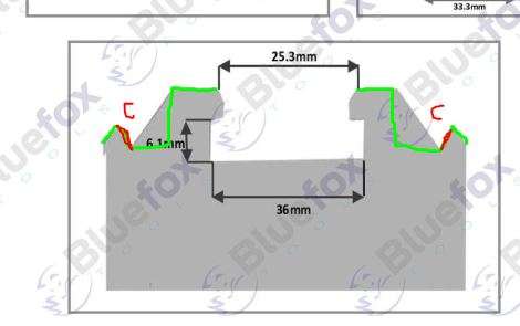

      It’s a wonder those Multifix holders works being constrained by those multiple scallops 😕
      I wonder if someone wanted to unconstrain the Dickson type would it be better to just have say the two outer faces of the Vees making contact ? That would spread the single opposing surfaces as far apart as possible and unlike the one shown with the knurling tool if you were using it with say a boring bar along the lathe’s axis you would still have constraint at the end where the load is.
      constrain
      #724249
        It’s only a matter of making them sufficiently accurately
        Samuel Colt had this sussed, and so did Dickson
        … back in the day.

                The question of ‘two outer faces’ of the V or two next to each other is exactly the same conundrum as the flat bed Myfords saddle running on the two faces of the forward sheer, ie close together, or the compensation for a worn bed using front and rear faces that has often been detailed on the forum and the magazine.
                The dimensions given in the drawings earlier are irrelevant to the problem What I must do some time is measure the green marked face in Jason’s sketch wrt the Vs (using two round parallel bars in them) in all holders. This will  establish the range of variation, possibly dividing the holders in to sets from different sources. Then with reference to the locking lever cam offset the range of lever angles to expect the holders to lock decide what is acceptable or needs correction.
                The simplest correction would be to loosen the cam so all fit easily then instead of needing to remove metal from the green area the correction would be to add a shim there.

                    Fair to say the Dickson ones made by Wessex are made to a suitable standard to be interchangeable, as are the Bison and any others that cost a bit more.
                    The Dixon style made to a budget can suffer with interchangeability problems.
                    Having said that I have not found the need to alter the angles surfaces, all the ones I have bought from the likes of Chronos and RDG that had issues of fit were related to the retaining method not the constraining surfaces.
                    I seem to remember that some of the smaller Emco QCTPs also just has two angled surfaces at he ends of the holder much like the sketch I marked up so must have worked for them.

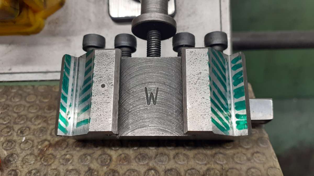

                      Quickly “blued” an original Dickson, fitted and removed half a dozen times then slid it up and down the post several times.
                      Contact on only 3 of the 4 surfaces and even that is not fully over any surface.
                      Well it has produced the goods for me over 37yrs so I don’t think I will be making any alterations.

                        I copied your test and got a similar result i.e. touches here and there but on all four surfaces in my case. No doubt there would be better mating under clamping load but difficult to demonstrate. My holders have the same markings as yours, I wondered what the W stood for (Wessex ?).

                            My take on things is that only a couple of points are critical. 1, the distance between the V’s and 2 the relationship of the V’s to the undercut lip ( green on JasonB’s marked up drawing). The first point is easy on a tilt head miller or a horizontal mill with the correct cutter but there are other ways. The second is not difficult to achieve if you think about how to measure it, with rollers, depth mic and slips (packing pieces).

                                I’d say that Jasons result suggest that the male and female Vees on his sets aren’t exactly parallel.
                                If memory serves me right all mine showed line or symmetrically intermittent line contact on opposing Vee faces. Effectively the same contact pattern as a WW pattern lathe bed.
                                What is clear from Jasons results is that the so-called over-constraint of four potential mating faces allows the system to cope with any small manufacturing errors and still achieve kinematically stable positioning as reported by ChrisH. It’s fairly obvious that if the various Vees are sufficiently parallel, of sufficiently similar angle and sufficiently similar in spacing you must get line contact on two opposing faces, subject only to the limitations of surface finish. Actually defining “sufficiently” in that context might be a problem but, if my memory its correct, all my industrial standard tool holders achieved that on both Dickson and Rapid tool posts.
                                Turning the problem round it would seem interesting to figure out what the maximum tolerable positional and dimensional error in the Vees is before the system cannot find a stable 3 point or 2 line position. My guess is the Dickson set up is least tolerant of any out of parallelism between the pairs of Vees in the vertical plane. Effectively requiring the tool holder and tool post to take up a skewed position which would seem to guarantee inadequate contact.
