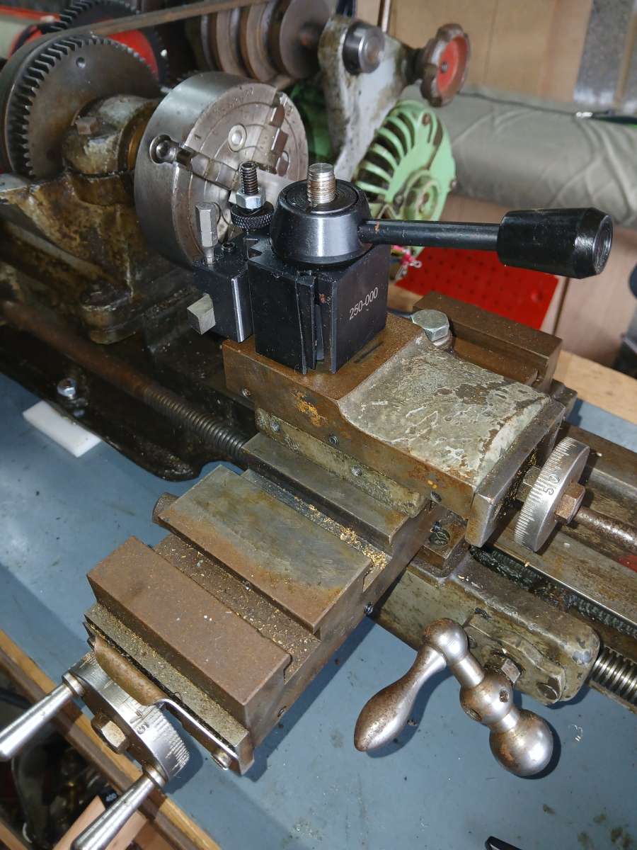

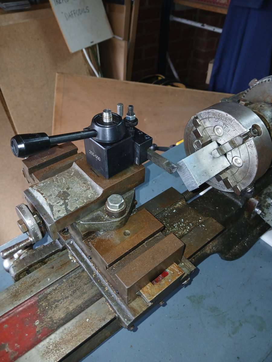

      I’m trying to set up a Portass PD5 lathe for some turning jobs. The probelm I have is that the tool height seems to be much higher than the axis of the lathe, which means that I could never face off or part off a workpiece. Here are some photos:
      20260507_160419 20260507_160206
      Rear View                                                                    Front View
      The problem that I’ve got is that if from the bed of the lathe I add the thickness of the saddle, and then the cross slide. and then the compound slide, and then the tool holder (a new cuneiform quick release toolholder I bought form China) even it its lowest position, as you can see in the picture, the tool height is well above the centre line of the lathe. What am I doing wrong? Even with the old original tool holder, it’s difficult to get the tool low enough even without any shims at all under it.
      Thank you – Rowan

        All the pictures of Portas PD5 (and other Portas lathes) on Lathes.co.uk show the tools clamped directly on to the topslide with suitable shims. I can’t see you having the headroom to use a QTP on top of the topslide.
        If you want to use the QTP (and don’t need to turn tapers), one option may be to remove the topslide and attach the QTP to one of the T slots in the cross slide assuming there is sufficient control of he cross slide traverse towards and away from the headstock.

          Your problem is probably that the QCTP is too big for the lathe. It would originally have only had a simple clamp for the cutting tool.  QCTPs had probably not been invented when the Portass was first made.
          Have a look at the “Lathes UK” website, to see pictures and to learn more about your machine.
          Simce most tool holders are hard, it might not be possible to mill the bottom of the holder to lower the tool.
          You may be better with the original tool clamp, or a four way toolpost that gives a lower tool height
          Using smaller shank, or section, tools might help, but at the expense of rigidity (A 1/4″ toolbit is 2.37 times stiffer than a 3/16″, so use the largest section toolbits that you can)

            The PD5 is a final update of the Portass S design and shares many of its fundamental dimensions. My first lathe was a Portass S so I can confirm Peters comment that it was built to use (small) tooling clamped directly to the topside. Very dim memory (it wa almost 60 years ago) suggests that even 3/8″ square tooling needed a bit taken off the top to get down to centre height. Absolutely no chance of getting tools on centre height with a tool post on top of the topside.
            It came with some tooling but I’m blowed if I can remember anything behind a “thats optimistic” feeling over what was provided as an alleged parting off tool. Hacksaw and subsequent facing had to do whilst I saved for something better.
            Peters suggestion of mounting the toolholder on the cross slide either direct or via block suitably sized to get your preferred tool size on centre height is the sensible option. Given an occasional bit of creative thinking its fairly rare to absolutely need a topside for work of the classes generally done on machines of this general type and style.

              Without some actual numbers about just how high the tool tip is currently above the head stocks center line it’s difficult to recommend anything. Safest and making the least permanent changes to the lathe would be Peter Cooks thought about attaching your qctp directly to the cross slide. Although it looks like that may also need a metal block under the qctp to then position it roughly at the correct elevation and allow the last fine adjustments to be done using the tool holders.
              The top slides upper face appears like it could be re-machined to help lower the qctp. But I’m somewhat adverse to making permanent lathe changes by machining since once the metal is removed it’s gone for good. Machining a bit off the bottom of each tool holder and using smaller cutting tools would further help.
              If your qctp is what would be referred to as an AXA sized tool post and holders, it may be too large for your lathe. There is one smaller and designated as an OXA. Although I don’t know how well those standard tool post designations and sizes match up with the Asian copies.

                I agree with everyone else: I am afraid you are trying to use tooling not designed for the lathe. I don’t know the centre-height of that lathe but that QCTP looks as if it would be too big on a Myford 7.
                Don’t go and try modifying the lathe to suit incorrrectly-chosen tools. No-one stocks putting-on tools for when you find you should not have done that. Worse, apart from the question of spoiling the machine’s original form, cutting the slide surface down will weaken the slide.

                  Realistically, as you already have the QC toolpost, removing the topside for most work using the QC post directly mounted to the cross slide is your best option. If nothing else it allows the use of larger parting tools and boring bars with vastly greater rigidity and corresponding ease of use. For the occasional jobs when you do need the topside, short tapers mostly, a basic square shank HSS tool and shims will be workable. Nigels idea will be more convenient in use but whether the gain is worth the work for occasional use may be open to question. Still use the alignment plate on the topslide tho’.
