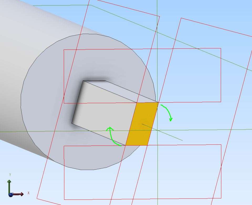

                    Can you manage a drawing or a photo please?
                    Is it like this, which wouldn’t cut very well?
                    cutter1
                    Usually better to start with the object you want to make rather than the tool needed to make it.    Grinding might well be the answer, but there are many ways to skin a cat.
                    For example, how many are you making?   If only a few, then hand-filing and a Dremel might do,  if hundreds, a milling machine, tool-post grinder, CNC, or grinding machine.  If millions, a production machine…  Maybe an ordinary bench grinding wheel with a jig, and the actual question is ‘how do I make a jig?’
                    With luck they can be bought from a shop, or made by adapting a shop item.

                          Or does the second set of cuts get made at an angle to the first so that you have a “blade” with relief and two cutting edges that will when rotated act like a 1mm dia x 10mm long router bit.
                          cutter
                          If that is the intension then it will indeed be a fragile cutter. Any reason for not buying an off the self cuttre? Although still fragile a long neck 1mm milling cutter would cut wood easily enough and if taken in several passes shoudl be OK. These can be had for about £3 and would give the 10mm depth that standard 1mm cutter s won’t
                          1mm bit

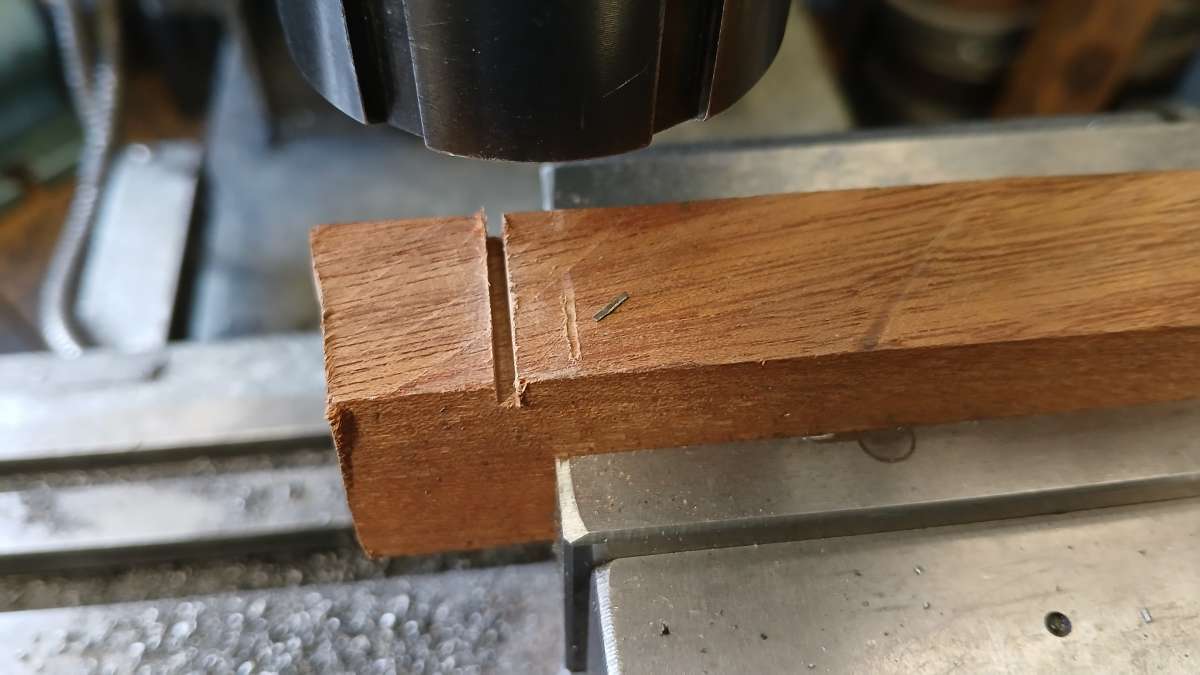

                                    #822756

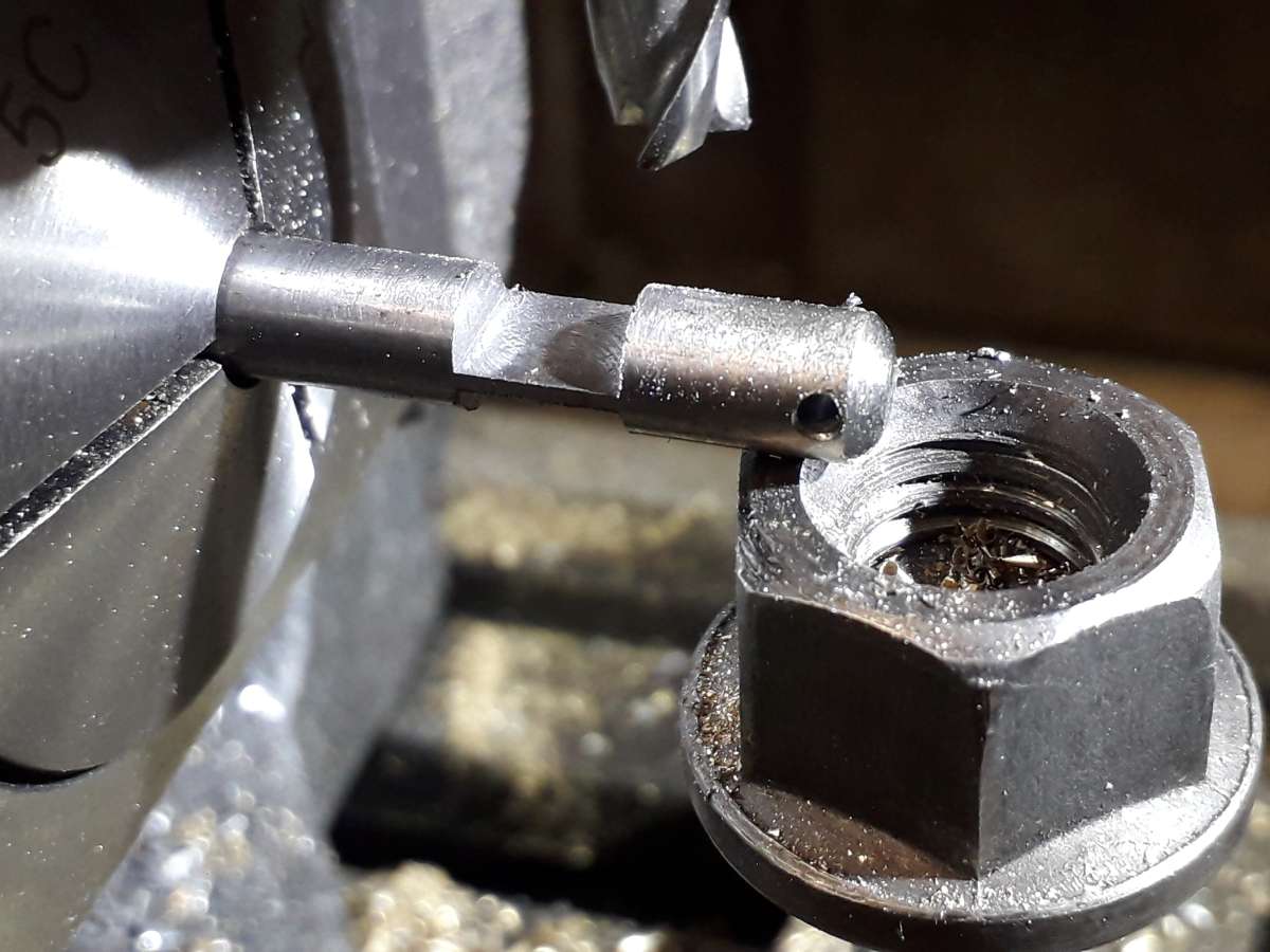

                                      Here is a similar job I did with a milling cutter, yes it is on a milling machine but easy enough on just a lathe.
                                      That is 1.2mm thickness in the middle. Although I needed the round bit at the end it may be worth doing similar whan making your cutter as it will support the slender piece you want and prevent it from deflecting away from the cutter. It can be trimmed off after the main work.

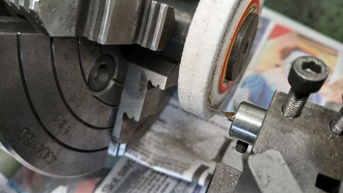

                                          Simple setup to do the flats, just rotate to do the other sides. A 3-jaw will do to hold the cutter, I just had the 4-jaw on the lathe. Bit of brass stops the work deflecting away from the tool.
                                          20251102_093836
                                          If you really wanted to grind the last little bit than the same setup can be used with a decent sized grinding wheel so no need for fancy high speed spindles to get the periferal speed up, the old Flexspeed will spin a 4″ wheel fast enough.

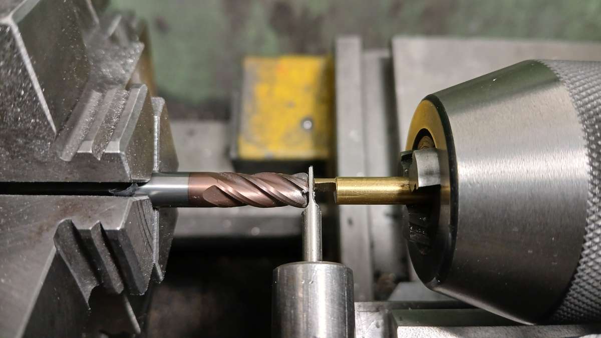

                                                Even with the cutters I posted you would not really want to be hand feeding those in a plunge router even if guided by a template or using a router compass. If you could go a bit wider with the kerf then a trepaning tool may be an option but depends on the diameter of the required hold. If you can come at it from both sides then that would only mean a 5mm cutter length which stands a better chance of staying in one piece.
                                                Unless you are trying to keep the grain pattern on veneered of melamine faced board I would cut the hole with something more suitable an dthen make a disc from separate material.
                                                I made one that cut a 1.6mm groove OK in hardwood but the “blade” was only 6mm long. A narrower one did not last very long. I was feding these with a milling machine and only going down 0.2mm per pass.

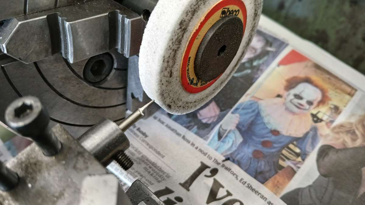

                                                Two possible setups to grind the final size after roughing out with a milling cutter
                                                20251102_114448
                                                20251102_121328
