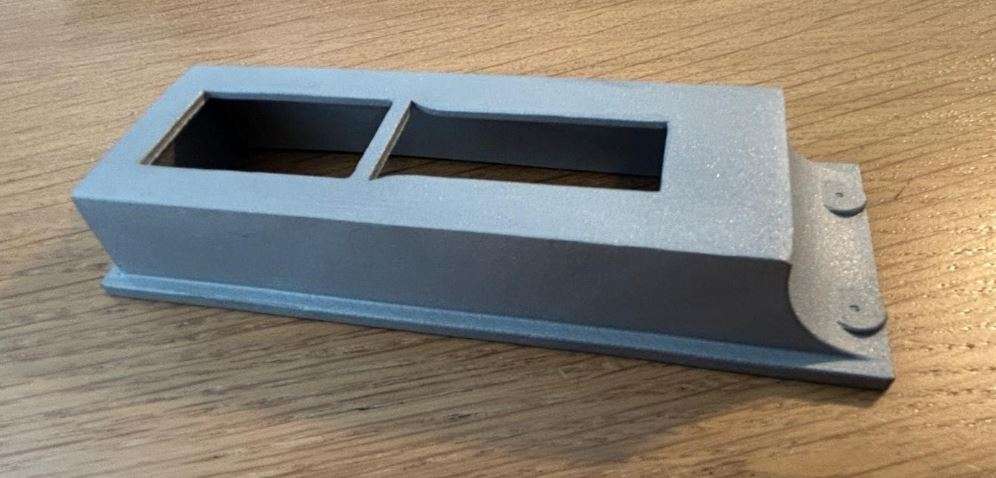

      As it has been a bit quiet here for the last week or so I thought I would post this example of 3D metal printing.
      One of the members over on MEM recently started building a Stuart Williamson Engine. He did not get too far as he decided to start with the fluted column. As you can see the aluminium casting is not one of the finest examples of the foundryman’s art with poor definition and more holes than a lump of Swiss cheese. Things did not improve much after several hours of fettling.
      cast willey

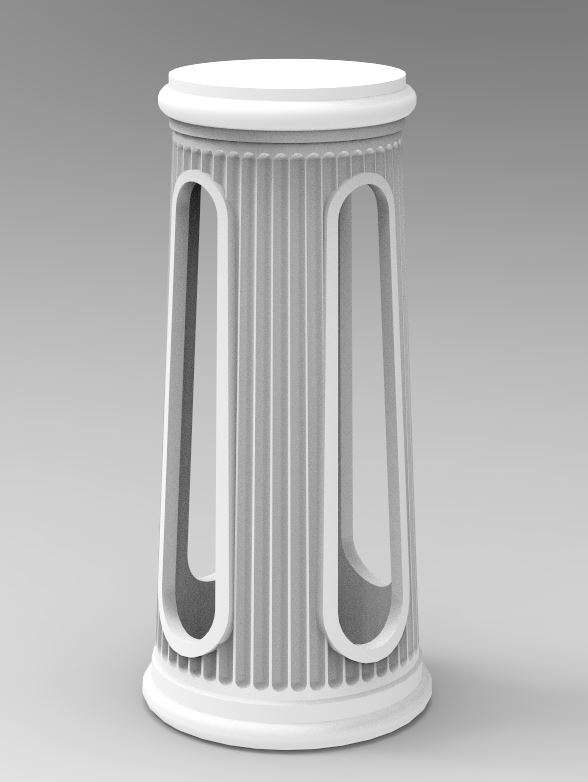

      I mentioned to him that I already had the column drawn in CAD for a possible future “Big Willey” build. After rescalling back down to the original size and adding a 0.5mm machining allowance to the top and bottom I e-mailed the .STP file to him.
      bigwilly
      It was an easy job to upload the file to Craftcloud and get an instant quote which was 2/3rds that of a replacement stuart casting and no gaurantee that the replacement would be perfect.

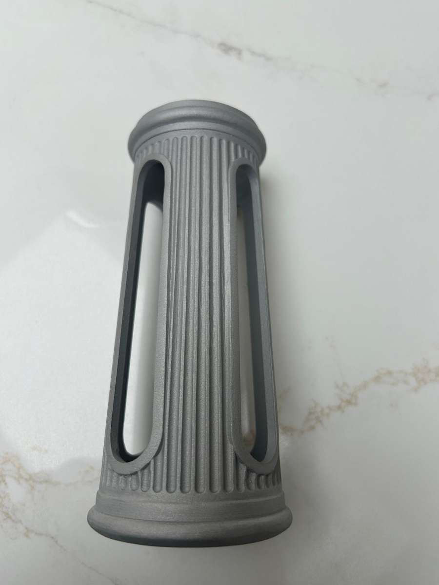

      I have just seen some photos of the finished column, which looks to have come out extreamly well.
      printed willy
      I had intended to fabricate the larger version of the column if and when I decide to make it but 3D printing is now looking a very attractive alternative and price wise comprable to thick wall tube etc needed to make it.

        Looks very clean if that is the print rather than a CAD rendition – sometimes can’t tell these days.

                Yes that is the print as recieved, this is a quick 3D render of the STL file

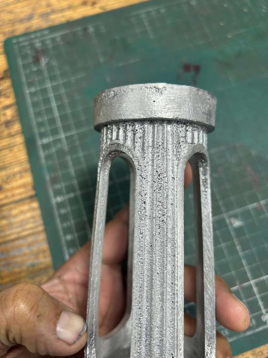

                  Funny you should mention that. I am currently doing machining and tensile strength trials on some 3D printed stainless steel test pieces. The plan is to write up the results for ME&W, editor willing of course.
                  All I am going to say at this point is that I am astounded, in a good sense, by the outcome of the tests so far; not at all what was expecting.

                    From my own rough and ready pull out tests on an M4 x 0.5 thread in printed aluminium I too was quite impressed with the strength.
                    The figures given on the craftcloud site for the alloy used are better than those of solid 6062 T6. Other suppliers give similar figures. Even printed 6061 is given as beingas strong as solid 6061 T6

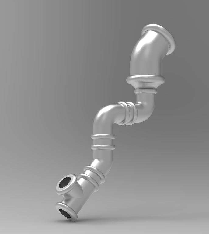

                                  Well I sent another file off last night, this time something else for me.
                                  pipe tree
                                  The current engine needs so pipe fittings for the cooling water to suit 6mm pipe. I could have used the PM Research cast ones but the advantage of these printed ones are that they will include smooth sweeping internal bores and will also be counterbored at the ends ready to thread M6 x 0.75. rather than being solid castings
                                  The larger 135deg bends are for the exhaust. I had wasted money buying these along with some 1/8″ BSP brass elbows. The Elbows were fine but it seems that due to lack of demand for the 135 bends they jusy use the larger casting for 1/4″ BSP but machine it to 1/8″ BSP which gives an ugly oversize fitting. These will actually be threaded M10x1 so are counterbored 9mm. ( I rethread the BSP to M10)
                                  Pricing was quite interesting. At first I just drew a single 6mm 90deg elbow and got a quote for one, 5 and 10 all of which were quite expensive.
                                  I then joined a few together with a simple 2mm wide spacer between each and the prices started to look better. Adding the Tee and two sizes of 135 bends completed what I needed so I uploaded the STL as shown above. Clicking on the quantity button the cost to have four sets printed was only £2 more than a single set so it would have been rude not to get my monies worth. I also had a discount code from my previous order so got the four sets for just under £50. Better than buying PM Research 1/4″ trees and the BSP from BES plumbing supplies.

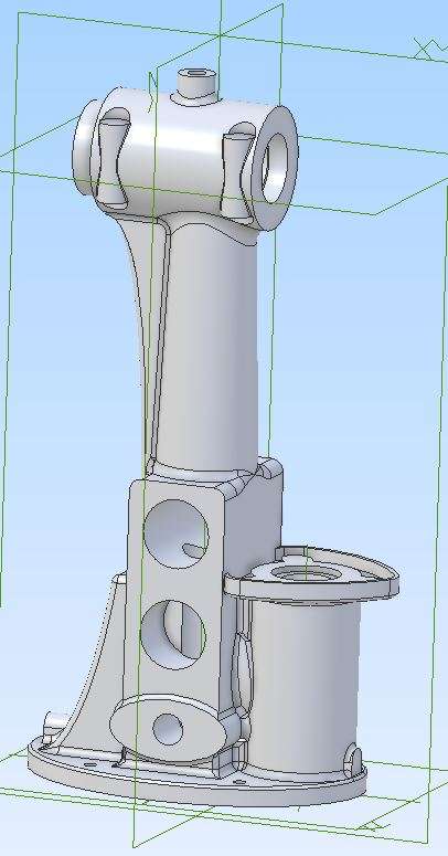

                                      At the moment I’m not sure it is the way to go with larger models, I recently drew up this pump that stands 275mm with twin 9″ fast & loose pullies to the ctr of the crankshaft and 3D printing was really putting the cost beyond what the majority of people would want to spend. I have not done the sums for a fabricated version which may be an aternative as there are a lot of similarities to the Cameron pump I di dsome years back.
                                      Though as can now be seen in the Model Figure painting world you can easily alter the scale at the click of a button.

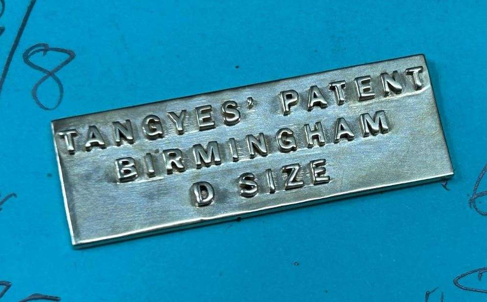

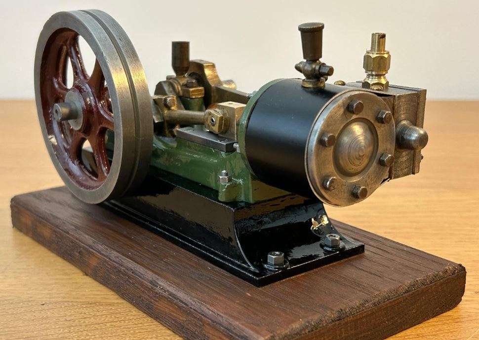

                                        As another example of 3D metal printimg, Sanjay, who I gave the column file to also has a box bed printed for a very old Stuart 10H which is a different casting to the current one and something that you are unlikely to ever find to replace a missing one.
                                        3d 3
                                        3d 4
                                        He also had this brass nameplate done which Craftcloud produce by a combination of a 3D printed “wax” which is then investment cast in brass. It will be interesting to see some of the results from the Cambridge Casting Trials particularly if Julie tries some printed “waxes” using the likes of Polycast filament.

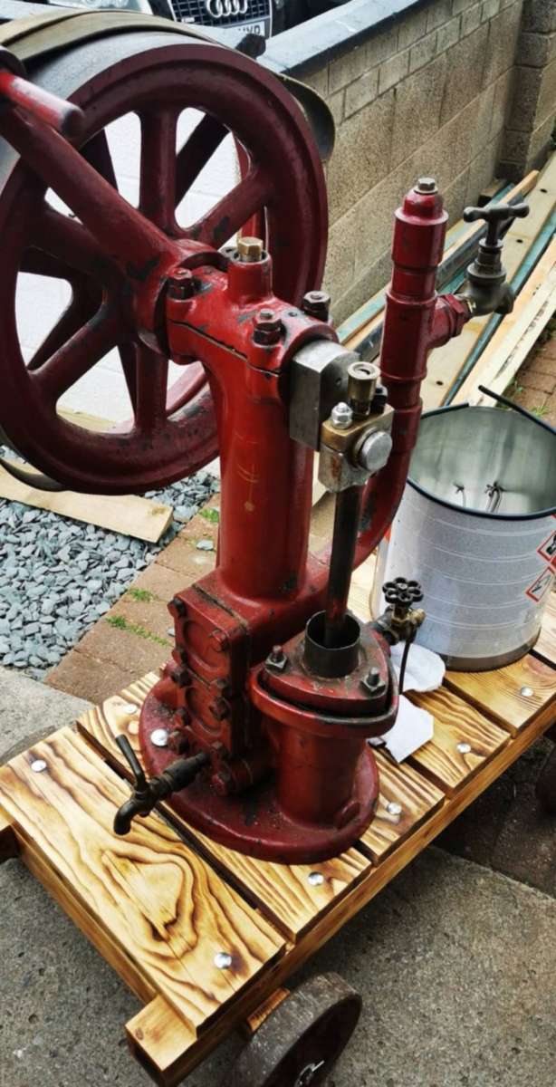

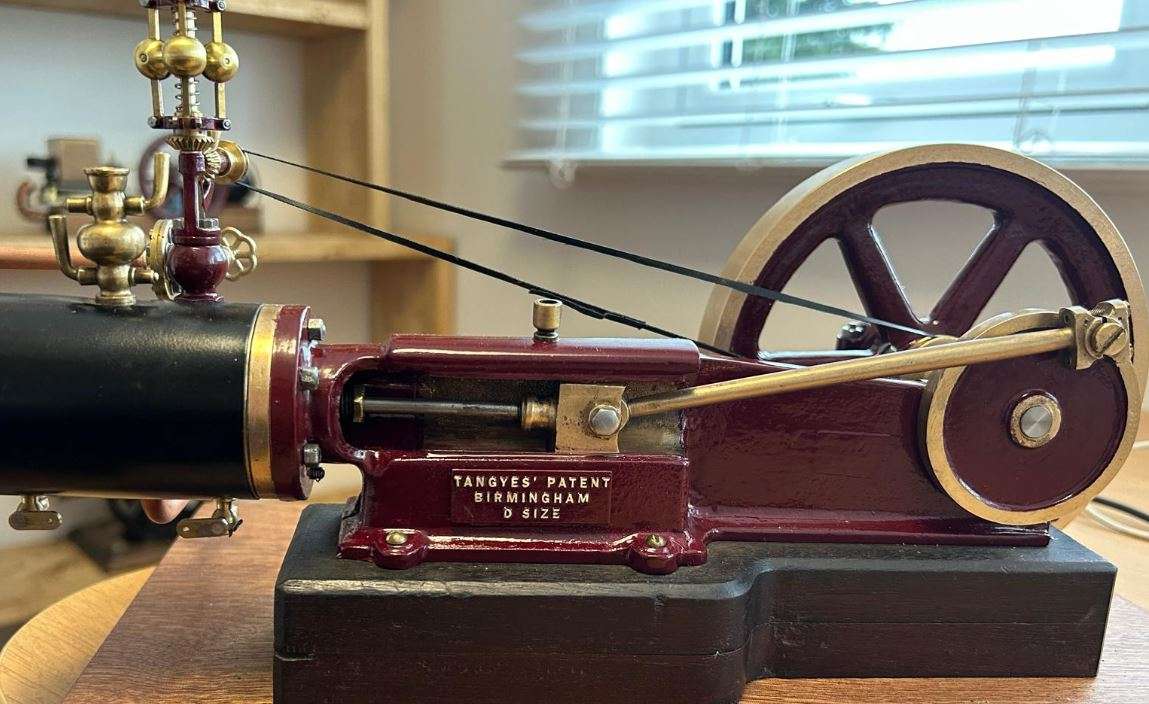

                                            Just a  quick update as Sanjay who I sent the file to has got his Williamson to the stage where it could be test run. Most of the other parts were made while waiting for the print to arrive. I’d be tempted to leave the column in bare metal and maybe black paint for the other parts.

                                                  The whole thing does indeed look very nice.
                                                  Rod
                                                  #840911
                                                  Andrew Crow
                                                    @andrewcrow91475
                                                    A lovely looking and well made engine, the 3D printed column is first class.
