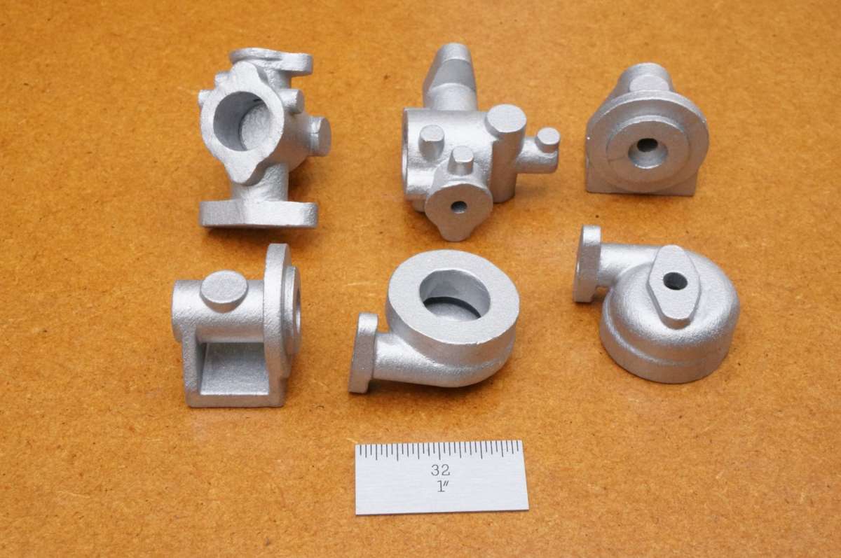

      I recently had some small parts from Craftcloud, printed in Hong Kong. They were modeled in Onshape, .STL files exported and sent to Craftcloud, manufacturer selected, ordered on 20 April, and arrived on 7 May. All the parts were within the weight for minimum manufacturing charge, but even so, having a second one printed added only about 50% to the cost. So that’s six parts delivered for £120.
      All the parts are for my Westbury ‘Seagull’ 10cc twin. There is a carburettor body, and the bearing housing and volute casing for a water pump. The carburettor body is designed to look similar to the original, but to incorporate some of Graham Meek’s improvements. The results are generally very good and accurate, though rather generous on size. Holes in particular can be smaller than specified. This does not matter if they are intended to be machined, but one of the advantages of the process is that complex and inaccessible internal shapes can be made. In this case, if I had known about this issue, I would have designed the internal spiral volute on the CAD model oversize to compensate.
      So far I have machined one bearing housing. It machines pretty well, without the soft gummy character of some castings and without any tendency to make bird’s nests.
      Printed Pump and Carb Parts

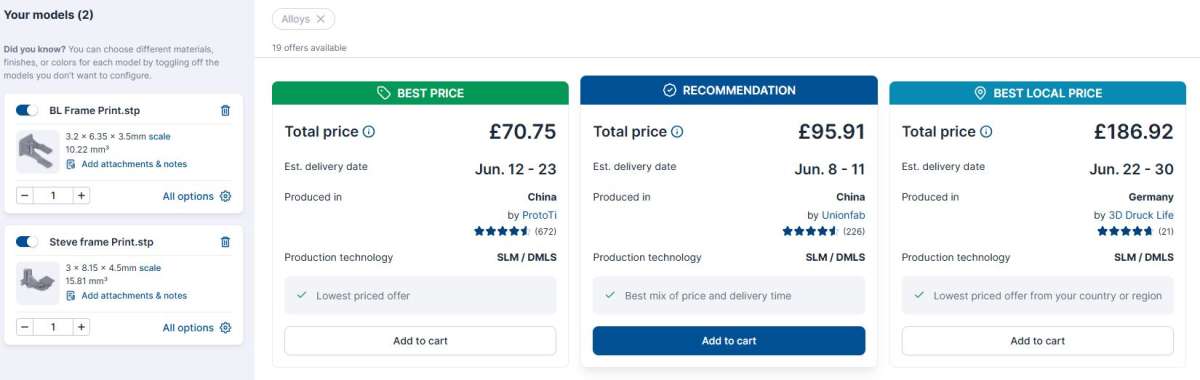

                    At the moment half to 2/3 the cost of a metal print seems to be the shipping and agents’ fees and taxes. Just imagine if you lived in one of the towns in China were these things are currently being printed. You could design something one weekend and have it in your hands the next at less than we pay for the billet to machine it from solid.
                    Maybe we will get to a stage where larger towns in the UK do have a print shop like they used to each have a foundry.
                    #850528
                      But would they be cheaper, I doubt it.
                      Craftcloud gives me many quotes, the most expensive are from Europe yet they have the least distance to travel. Tax (VAT collected at source) is included in all those prices. Highest not shown is Portugal at £344
                      Also quicker from China than Europe
