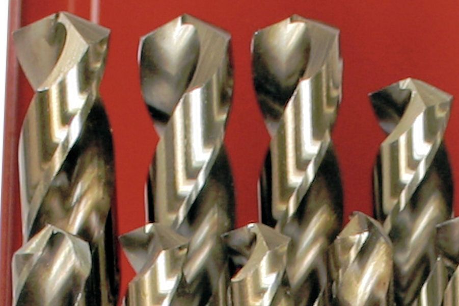

                                        I've seen a nice set of Cobalt HSS drills, although the point grind is a bit odd – looks like 6-facet split-point? Is this normal for these type of drills? Might be tricky to sharpen.
                                        Chris

                                          those look good! Do you have a link? The narrowed chisel point will make them easier to start on a centre punch mark. If it wears too much they can be gashed in again from the side with a very narrow wheel or perhaps with a Dremel in a jig.

                                            Link is here: **LINK**

                                              I find that quality (Dormer) 4 facet drills start quite accurately without centre pops being needed. If I need better accuracy (less than a thou or so) then I start with a carbide spot drill.
