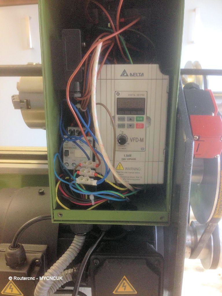

                            If you remove the louvred panel on the back of the headstock, the inverter is behind, the fan is positioned below that ,to cool the motor at lower speeds.

                                I would check that none of the wiring is hitting either the motor cooling fan or the vfd fan. It's not exactly tidy in there!

                                  Posted by Journeyman on 15/11/2016 09:25:29:
                                  dont know Good grief … Do they really ship them like that ?
                                  P.S. … I agree with Graeme W …  That sounds like the motor cooling fan … badly mounted

                                      It sounds like a fan problem to me too. I'd be most suspicious of the computer cooling type fan immediately under the VFD. One of those wires may be too close to the fan. Try gently moving the wires to make sure they are all well clear. Guessing again, it may be that using the lathe sometimes sets up a mode of vibration that twangs the wire.
                                      My experience is of similar fans failing in computer servers. On these the problem was usually the bearings. They can make odd noises, but not – in my limited hands-off experience – quite like your example.

                                        Posted by Michael Gilligan on 15/11/2016 09:42:48
                                        Apparently so! It's not mine, I have the older WM 250, but I just happened to be reading a post on MYCNCUK and this picture was there of a brand new lathe being unboxed. I edited the photo to credit the source. I can't see it in the photo but I assume the cooling fan is somewhere at the bottom of the cabinet.

                                          It's the fan on the back of the drive motor.
                                          The cooling fan has it's own motor to keep the drive motor cool while running slowly, mine does it sometimes after a heavy cut causes vibration. Probably caused by cheap bearings with too much clearance.

                                                    Hi Bruno, I have the 290V lathe which has the same issue.
                                                    As an engineering manager for an industrial fan manufacturer I know full well how noisy fans can be (up to 400kw motors)
                                                    The fan noise is from a separate cooling fan for the motor so it continues running even when the lathe is stationary.
                                                    I put a piece of Rockwool insulation between the motor and the wall it is against (being careful not to block any airflow) this helped reduce reflected noise albeit not dramatically.
                                                    It is still annoyingly noisy but I suppose I have got used to it, if I could be bothered I guess I could find a quieter fan or look at boxing it in, again making sure the airflow into the fan is not restricted.
                                                    As I say in my case I am against a wall, so not easily accesible without shifting hte lathe, maybe one day.
                                                    In my world this is a tiny fan so should really not be that noisy but it is probably a cheap very inefficient type.
