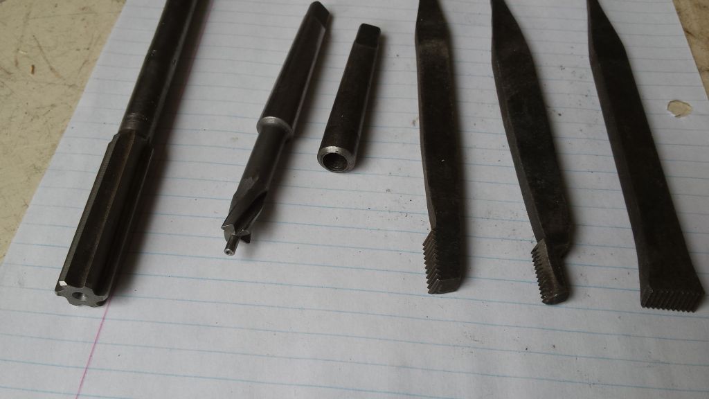

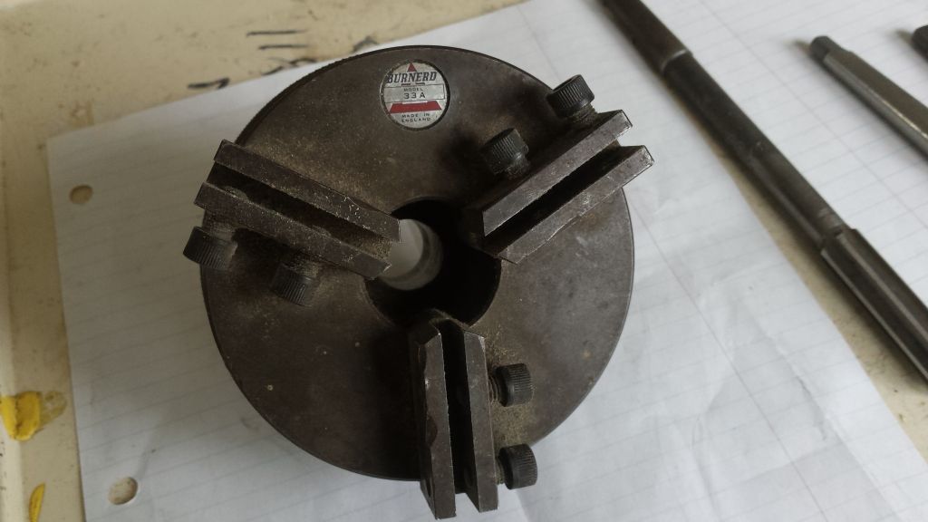

      There are a pieces that came with lathe and I don't understand what they would be used for. Picture 2 shows a Burnerd chuck, but why would it have jaws like that. Why would it have an unthreaded back plate with 19mm hole. Picture 3 shows an assortment of tools. The three on left have a taper, but it does not fit the lathe. What are the three on right for.

          2) The chuck seems to have been modified to make the jaws adjustable. That is, if you fitt 3 pieces of steel into the slots and clamp them with the sccrews in the side of one jaw, then you can adjust them the make it possible to get a piece of round or hexagon bar to run really true.
          If the chuck has not been seriously modified then it will be posssible to buy the correct jaws.
          The three items on the right are hand held thread chasers, used normally for finishing threads cut on the lathe with a single point tool. The other items may fit the tailstock, either directly or with an adaptor.

              Re the chuck – why would it have a backplate as shown with no threads – is it meant to fit on a morse taper in the headstock?

                your chuck may not be for that lathe

                  Any idea about the three tools on left of earlier picture – they don't fit on the lathe. Even if they don't belong what would they be used for.
