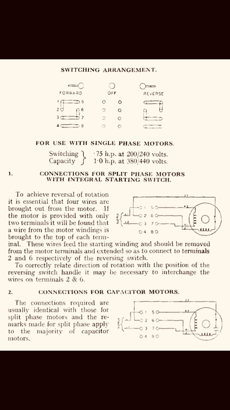

      see this earlier post, it has a drawing of motor plate connections for various makes and details of connecting the Dewhurst switch, everything you need to get the reverse working, but as said don't forget the chuck is screwed on.

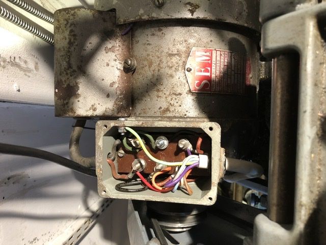

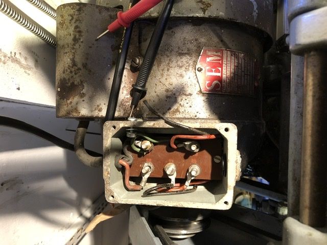

        Here is a connection diagram I found and used to sort my lathe out
        the connection labels might not be the same as your motor. By the way what make is your motor? Mine is an SEM and this is the connection box as it was when I started.

          I had to add another post to make enough connection points for the Dewhurst
