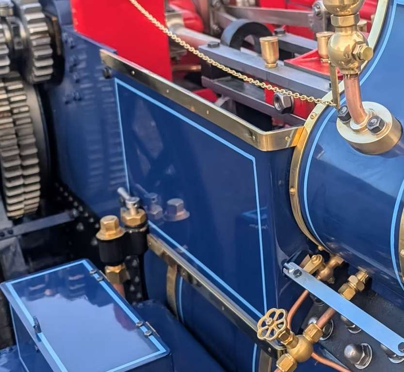

      I’m making new motion covers for my 4″ Burrell SCC and will be fitting new 3/8″ x 1/8″ brass section beading. I’d like to rivet these on rather than drill and tap as it was on the previous ones.
      Is there a good rule of thumb for determining rviet size and spacing or is it a matter of what looks right? I’d plan to cold rivet by hand, should I use brass or copper rivets?

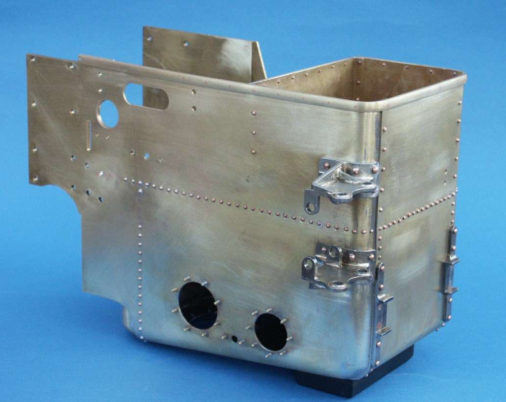

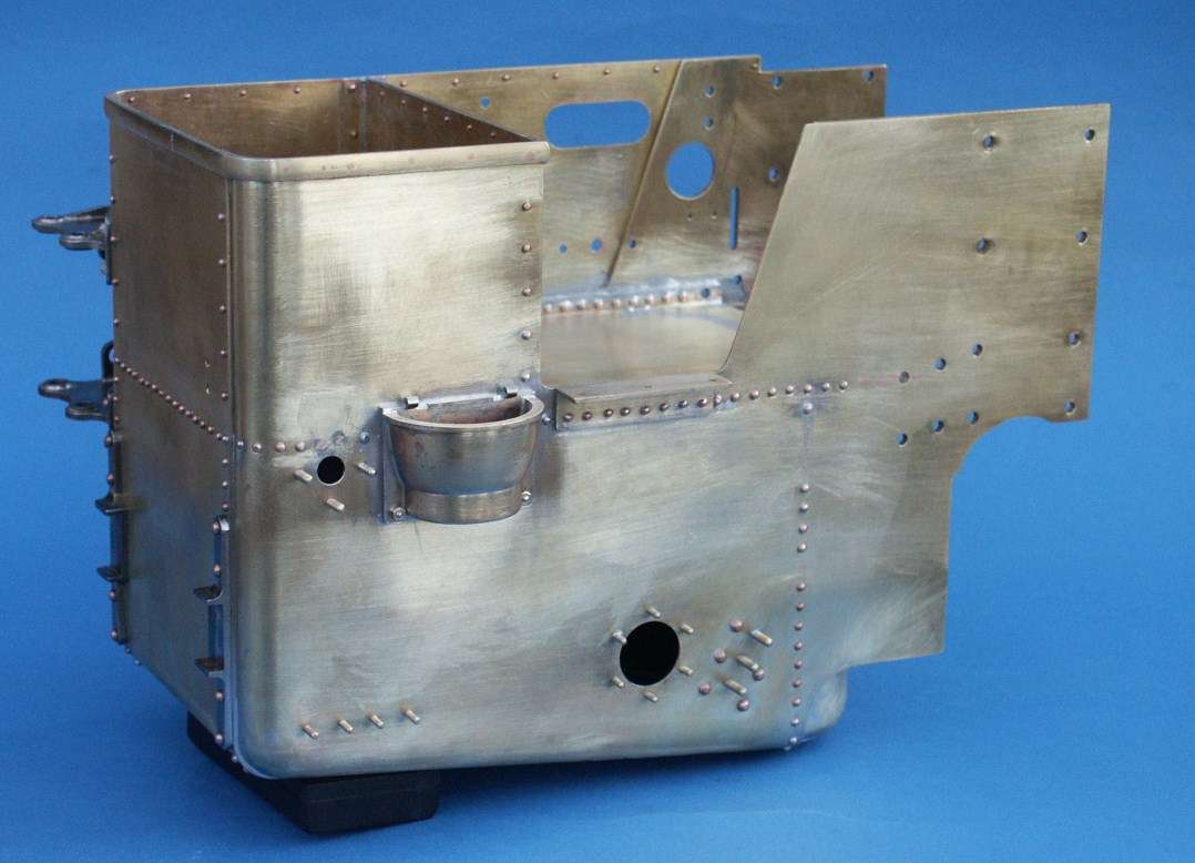

      Julie Ann
        @julieann

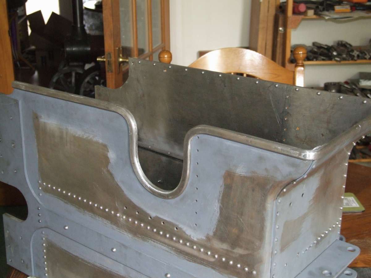

        Brass and copper are not prototypical. I made my own beading from hot rolled steel strip and fitted them using steel rivets. Rivets were 1/8″ diameter on my 4″ SCC Burrell engines. Holes were predrilled in the beading before bending and fitting. Holes were spaced 1.5″ and the drilling was done on the vertical mill with the beading against a fence to ensure that the drilled holes were in the centre of the beading. An off centre hole is much more noticable than small errors in spacing. Results were acceptable:
        Tender Beading
        Rivets were closed cold. The best technique is to use a ball pein hammer to flatten and expand the rivet and then use a punch, at a slight angle, to force the outer edge of the flattened rivet into the countersunk hole. That way, when the rivet is filed flush, the countersink is completely filled without marking of the beading from misaligned hits if using the ball of the hammer.
        Julie

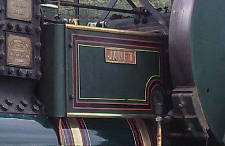

          Thank you for your input, what’s the dimension of the beading you have fitted to your tender? I’m trying to get a feel of an appropriate rivet to beading size.
          The engine I’m taking inspiration from has brass beading on the motion covers;
          Janet motion cvr
          The current beading looks out of proportion to me.
          Current motion cvr

            Although I don’t have motion plate son either of my engines I did use brass beading as the tenders were also brass.
            on the 2″ Fowler the beading is shaped from 1/4 x 1/16″ bar and 1/16″ rivits specified. I would say 1/8″ may be a bit big so 3/32″ would be about right on your 3/8″ strip.
            If you are leaving it bright like your photos then also us ebrass rivits which only need a shallow CSK that should all but disappear when filed flush. If painting then copper would do and is easier to form.
            I’d also suggest tinning the surfaces before riviting and then sweat them together once rivited.
