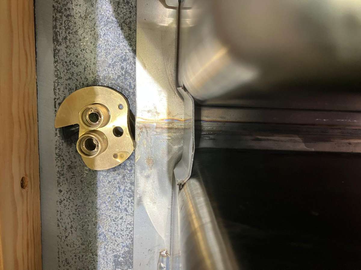

      HELP,  I have a kitchen mixer tap – make unknown to replace.  Water off, flexipipes (Male stub ends) removed, looked under the worktop, no obvious means of removing the mixer tap.
      Both water inlets are female thread to take the flexi hoses, but one inlet is threaded on the outside as well.  No obvious way of removing either.  No obvious means of attachment between the fitting under the work surface nor removable collar above the work surface.
      Any ideas ??
      Tap Mounting
      I thought the black thing in the quadrant of the fitting would be some sort of catch, but it seems to be a gasket.  The 6mm hole on the right of the fitting had a 6mm rod threaded into it with a screwdriver slot in the free end – but what was this for.
      Of course, the kitchen fitters are long gone with the instructions.

      #843622
      bernard towers
        @bernardtowers37738
        its the water pipe with an internal hexagon that when loosened releases it I think.

            Robert Atkinson 2
              @robertatkinson2
              These are normally held by the 6mm rod and a nut. Is that sealant I see on the plate? The fitter may have glued it in.

                It looks to me that everything that holds the tap have been removed, wobble the tap about from the top it should just pull out, probably just stuck if the plumber used a sealant which it shouldn’t need, normally that brass plate falls off when the retaining screw is removed.

                DC31k
                  @dc31k
                  As above, the tap is probably installed and dismantled from above.
                  Many Bristan taps are made to this design.
                  Please read the installation instructions for this one:
                  https://www.screwfix.com/p/bristan-echo-easyfit-mono-mixer-kitchen-tap-chrome/4648g

                  Mike Hurley
                    @mikehurley60381
                    <p style=”text-align: left;”>Agree with the above. Standard fitting is a threaded road in the base of the tap unit. On this fits a long nut. Simple</p>
                    There are sets of special long & thin box spanners to make fitting easy.
                    As others say, looks like everything mechanical has been removed & probably just held in situ with sealant or possibly residue

                      Yep, its a Bristan “Cherry Washer” should be able to find online fitting instructions
                      https://www.bathroomspareparts.co.uk/bristan-cherry-washer-blh153-42684-p.asp

                      Speedy Builder5
                        @speedybuilder5
                        That’s the one Jason.
                        Thanks to all    Bob

                                      I agree with Robert. The tap is probably stuck with sealant. The threaded rod should have had a nut on it.  Lever the quadrant off with a screw driver. You may then have to dig out the tap itself from below.
                                      #843729
                                        Look at my links
                                        There is no threaded rod to put a nut on, the 6mm hole is for an unthreaded guide rod that keeps things inplace while you fit from above
                                        You can’t lever the “quadrant” off as it is still being held from above by one of the two brass sockets as one is threaded into the quadrant and needs to be undone with an allen key from above once the tap body is removed from above by loosening to grabscrews towards the rear.

                                        Dave Halford
                                          @davehalford22513
                                          Good luck with that, a crowbar might snap off the brass socket but the sink may not survive.
                                          Now a tiny allen key will remove the tap and allow access to the fixing from the top.
                                          Speedy can then spend the next hour trying to spin up the 6mm nut from underneath on his new tap.
