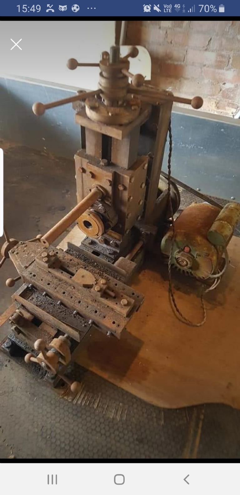

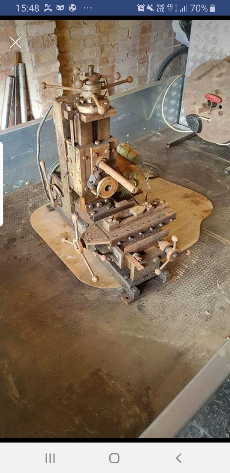

      I recently picked up.. No we actually slid it along as it was perhaps the heaviest thing I have ever lifted in my life. This mill has no makers name I can find but it is very well made. Can anyone help me with identification? I'm going to keep and use it if I can find a few missing parts or even what bits are actually missing.
      I have been stripping bits off for two days and still can't lift it easily. It's a beast.

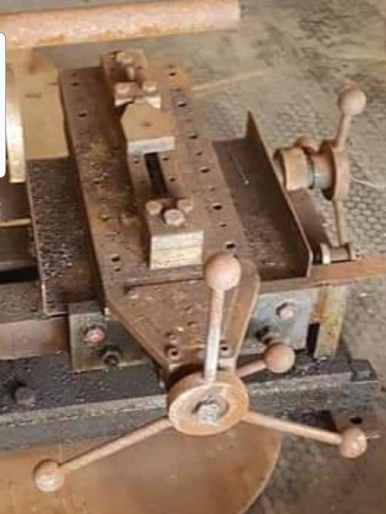

            Wow that is a beast. A nice one. It is either very old old someone has perhaps fabricated it from bar stock and flat plate? Is the main body a casting or is it all bolted up from stock? Sorry, can't help with identification. But fascinated. Please keep us posted with your progress.
            #415521
            Hollowpoint
              @hollowpoint
              Looks homemade to me. If it had been made in a factory there would likely be much greater use of castings.
              #415539
              Plasma
                @plasma
                Definitely a home brew job, a lot of work to make it too.
                Not sure how well it will clean up or perform but a good project to have a go at.
                I think the hardest job will be to get any cutters to run true, the arbor is missing and the support bracket.
                Good luck in making it a runner
                Best regards Mick
                #415583
                JohnM
                  @johnm51917
                  It's all solid flat bar bolted together. There are many, many bolts and solid is an understatement. It will be a good while until I get it in a working condition but if anyone can send me links of what I need to get it working in a basic form I would be very grateful. Thanks for your messages and I will keep posting on my progress. Some parts are getting Electrolisis treatment as we speak. Pics to follow. One thing I know I could weigh it in for less than I paid for it 😂
                  K
                  #415601
                  Nigel Graham 2
                    @nigelgraham2
                    Plasma-
                    Arbor missing? That look like a lathe chuck back-plate on the spindle, suggesting the builder was unable to make a conventional taper-fitted spindle or perhaps used an ex-lathe spindle.
                    Making a new arbour drop-bracket: I had to do that for a Centec mill. My method:
                    1. Completed the bracket's over-arm clamp arrangement. (The Centec over-arm is dovetailed but the method is adaptable to any over-arm form.)
                    2. Drilled the arbour hole just below size.
                    3. Clamped the embryo bracket to the over-arm and to a pair of angle-plates fitted to the table with plenty of T-bolts, so the hole was comfortably between the angle-plates and aligned with the spindle.
                    4. With a boring-head in the spindle-nose and the over-arm just slack enough to slide, gently bored the bracket to finished diameter, winding the table inwards to advance the cut along the bore.
                    I took only very light cuts and very gentle feed as the method does put a somewhat unfair stress on the machine; but it succeeded. I think I wound the handle with one hand while gently pushing the over-arm with the other, to relieve the load.
                    I have a small Denbigh horizontal mill that needs a new drop-bracket for its single, round-bar over-arm, and will use the same technique.
                    So I think this a way worth John Milton considering in restoring this machine.

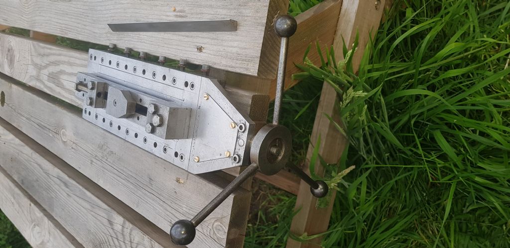

                      20190622_200026.jpgToday's effort.
                      #415629
                        You deserve to end-up with a good machine there, John

                            I don't know how much you know about horizontal millers, nor quite what I'd not explained fully, so please bear with me if I start from first principles and repeat what's already familiar to you.
                            On the Denbigh M photo, the over-arm is the heavy bar projecting forwards from the top of the machine. What I called the drop-bracket is that hefty casting dangling from the over-arm's outer end.
                            On yours, it is the bar projecting from the vertical-slide, directly above the spindle.
                            The Denbigh is shown with its arbour, without a cutter, in place, and you can see its outer end runs in a bearing (probably just a bronze bush) in the drop-bracket.
                            This is analogous to the steady on a lathe, and supports the arbour against the heavy lateral loads imposed by horizontal milling.
                            The inboard end of the arbour normally has a standard Morse or other taper in the spindle nose, and is pulled in tight by a draw-bar extending back through the hollow spindle. It also means you can use drill-chucks (for drilling only, NOT milling!), boring heads, etc. with similar tapers.
                            Now, you machine seems to have, or had, a lathe chuck on its spindle, and what we don't know is whether it has a through-hole spindle with taper and draw-bar. If just a lathe chuck, you'd need an arbour with a plain rather than taper shank.
                            Now to the nub of what I wrote above. Obviously, the drop-bracket centres need to match the over-arm to spindle centres, so the method I described was to give that.
                            On most smaller mills like the Denbigh M or H-series, the over-arm can be slid backwards and forwards through its mounting holes (with its clamps slackened). The Centec has a dove-tailed slide but the principle here is the same. This meant that when I linked the table to the over-arm with the drop-bracket I was making, the over-arm slid back with the table.
                            On yours, the over-arm is fixed, so you will need to clean it to a good smooth finish and slide the bracket on that.
                            I would recommend you make the drop-bracket (assuming it's not already there among any bits and pieces that came with the machine) with either of two clamp patterns. The first, common on bench-drill columns, has two scalloped steel bushes on a draw-bolt. The other is the split-type clamp, as on the Denbigh machines.
                            You need clamp the bottom end of the bracket to the table in such a way you can drill and bore or ream it horizontally for the arbour bush. You could use two angle-plates with a sacrificial steel bar across the gap to support the bracket. Or clamp it on some way in the vice. Either way it all needs to be rigid enough not to spring or rotate under the cutting forces while also transmitting the table movement to the top of the drop-bracket so that can slide without shake along the lubricated over-arm. Ease the clamp just enough to allow it.
                            I would drill the bulk of the metal out first, before setting up as above.
                            Effectively this uses the milling-machine as a horizontal borer, but the secret of success is in the drop-bracket moving without springing under full control of the table – along the over-arm on your machine, with the over-arm on my Centec and Denbigh.

                                It looks as though it could be combination lathe and milling machine. With that chuck backing plate below what appears at first glance to be a milling spindle. Job could be held in the lathe chuck mounted on that backing plate, and a toolpost mounted in the vice or direct to the table below.
                                Or is the chuck backing plate mounted on the main spindle and the round bar above it remains stationary to act as the overarm on which to mount a steady for the milling cutter spindle below?
                                Some pics of the area behind the main column showing the drive from motor to spindle/s would possibly clarify.
                                Certainly an interesting machine. I wonder if it was ever written up in ME magazine?

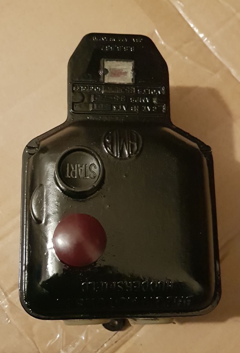

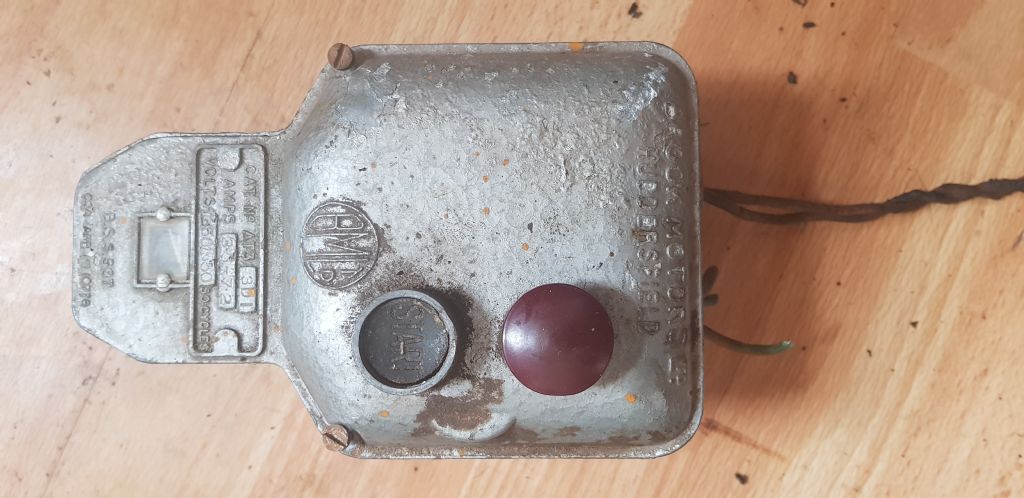

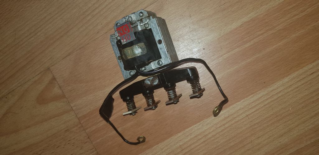

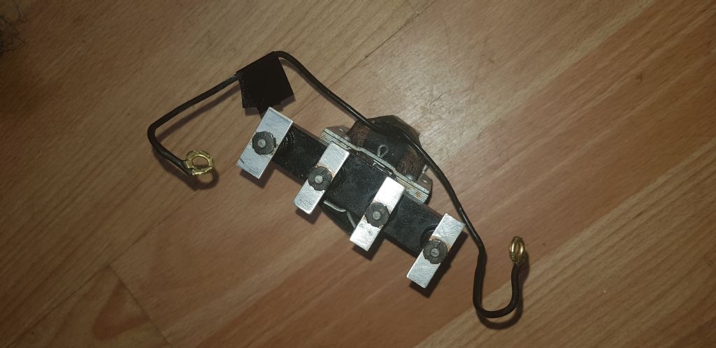

                                  i have setup an album for anyone interested. I am unfortunately clueless but learning all the time. there is a very old but perfectly formed I believe gearbox that is hidden away in the bottom of the machine and I am cleaning it despite only being able to see the handle visible on the outside of the machine.
                                  The motor runs as sweet as a nut and I have rewired this with a new earth connection now added. It has probably been running for the past 100 years or so with just twin live/neutral wires. I will get you those photos but it's mostly apart right now Hopper. I wish I could find out who built it as I would get the plate engraved. It really looks to me no time and no expence has been spared. I have an overflowing pot of bolts collected during the partial strip I have made so far. I would have used four where he used eight or so.
                                  Right back to it and will report back later today or this evening. Thanks for all the interest I believe the seller could be joining the forums today and having a read today so he may have some more information for us.

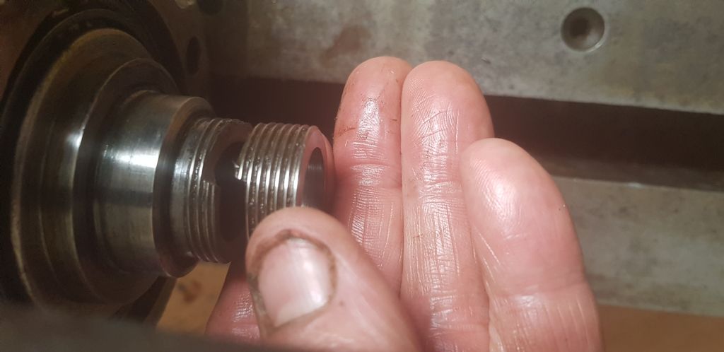

                                    Houston we have a problem!
                                    #415705
                                      Posted by John Milton 2 on 23/06/2019 10:16:57:
                                      Think positive, John … See it as an oppurtunity angel

                                        Is that broken thread, the spindle nose? It's hard to see what happens at the register end, but is the thread actually on the same metal as the spindle or is it some sort of insert? If the only answer will be a new spindle I suggest you do make it as I'd described above – with through-bore and internal taper as well as the thread. The taper will probably have to be a Morse at that size, but it will allow using a range of tooling and collets.
                                        The original builder might have used an existing spindle, perhaps from a scrapped lathe, or a new one sold as a spare for some make of lathe.

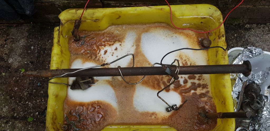

                                          Today I made some Electrolysis soup for most of the components I have stripped off. I think I need a new Whitworth spanner as the only spanner I have that fits the nuts I have targeted for removal is a ring spanner and it keeps slipping, took all my self control not to keep on attacking them and rounding them all over to give me a real challenge I am really struggling to move more than a few bolts even with a sea of WD40 and using heat to try to shift them. I took a little break though and cleaned and painted the start/stop switch housing.
