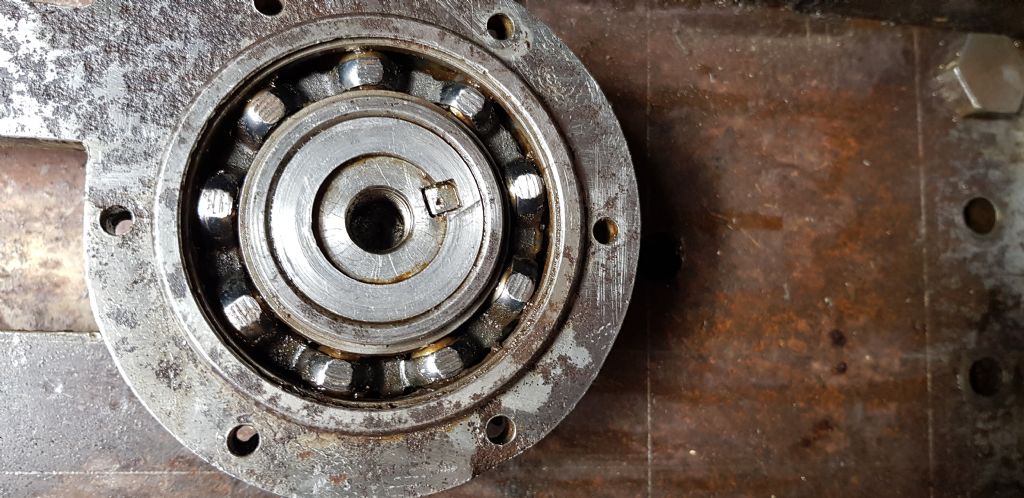

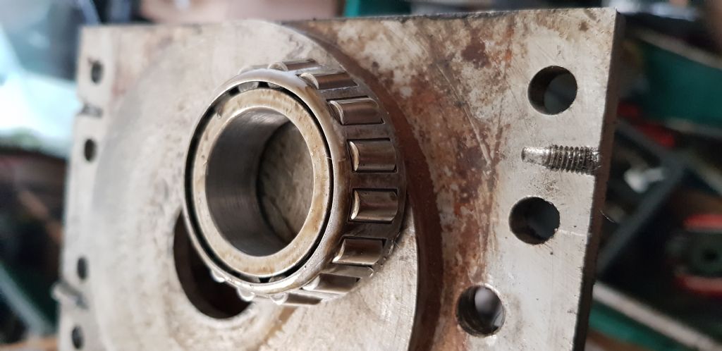

                                It's all apart now with one exception.one of the tapered bearings on the main shaft is being an awkward bugger. I'm looking at the price of a new one if I go Rambo on it so am just soaking it and pretending I don't care if it comes off or not. I'm cleaning off 60 years of grease and dirt and then going to re-assemble and decide which parts need oil and which need paint. I'm thinking I may drill out the existing fittings and go metric as Whitworth is not working so I'm thinking they could be pre war and either American or some other standard. Seven bolts made me lose sleep but eAuction site meant that I had the bolt remover required and all seven were out after only 30 minutes grafting. I am still trying to work out what milling head I am going to replace the original with to make this a fully working machine. I don't know which search terms to use so I'm struggling. Anyone that can give me a point in the right direction here?
                                I will add some photos soon but am on a mission so may take some time to reply. Thanks for reading and it's all good from here on… I hope 👌

                                  Bearings: I'd thought it possible to obtain replacements. Whoever built it would have almost certainly used stock bearings. Probably worth fitting new anyway unless the original ones can be cleaned up and are in serviceable condition. Caked-on grease is not a problem but corrosion will have destroyed them.
                                  #416945
                                  Hopper
                                    @hopper
                                    If bearings are pre-war era they could be obsolete imperial size taper-roller bearings. Modern ones are (mostly) metric. Measure the shaft size and outer race outside diameter and look them up on the Timken website etc. Don't get cheap no-name bearings. Try to get Timken, SKF etc. Sometimes adaptor sleeves etc have to be made up to fit the next nearest size modern metric bearings to old imperial machinery. Have found this on vintage sidecar wheel bearings etc .

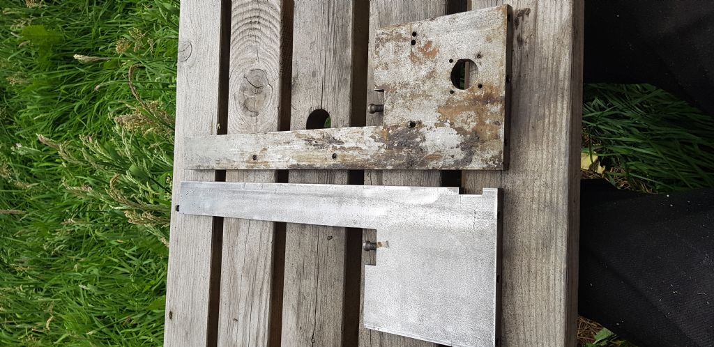

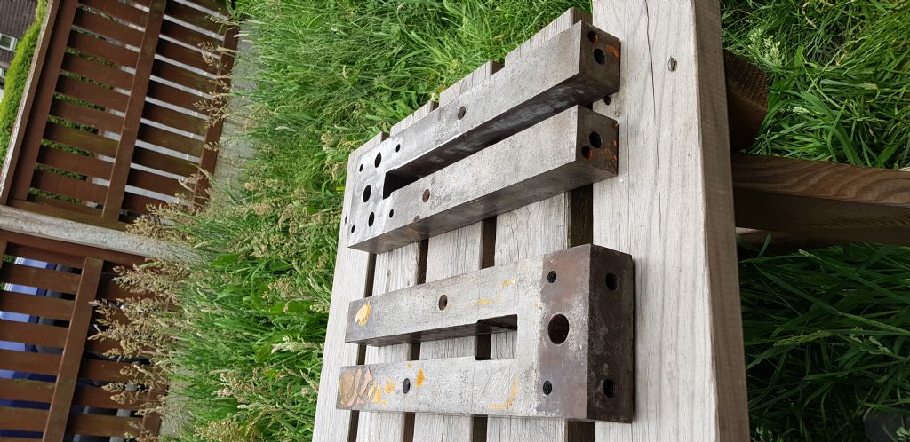

                                                  Just a quick update and the reason why we don't involve our other half in anything practical.
                                                  I sent the following two photos to my partner and innocently she asked me which was the before and which was after 😱
                                                  #418773
                                                  Nicholas Farr
                                                    @nicholasfarr14254
                                                    Hi JohnM, I've got it, you've taken the top one just lately and the bottom one when you first had it in your youth. nerd
                                                    Regards Nick.
