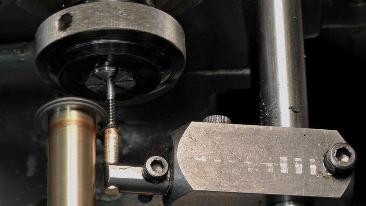

                Never worked on a Merlin band clock but done lots of musical box worm gears and a pitch of 3mm driven by a 60 tooth wormwheel should work fine. I thread mill the worm on a Myford lathe, the one in the photo has a diameter of 2.8mm, pitch=1,10mm and has 8 turns. That goes without extra support, with longer lengths you place an extra support to stabilize the thread. The cutter in the photo is a carbide one but sometimes a normal pinion cutter fits the profile or you can make one yourself by profiling a 32mm saw. After hardening and tempering the thread is polished with a profiled fiber disc in a simple setup to polish it in a smooth movement at the correct angle.                       Niko.
                milling worm
