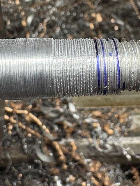

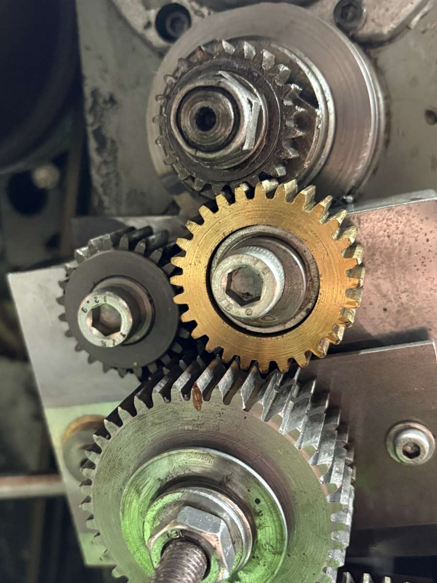

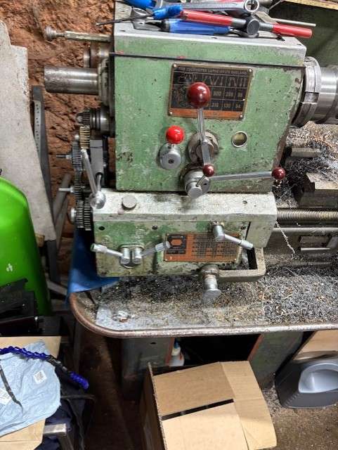

      so let me set some ground work
      I am a hobby machinist at best so i apologize if i have missed something.
      my machine is a Colchester master mk2 in a home shop. I only really cut metric threads and my lathe has a imperial lead screw
      about a year ago i decided to make a version of Graham Meek famous dog clutch after finding and reading everything i could i began making my clutch. after a lot of work and re-design and re-making many parts to get everything to work properly, i have finally managed to get it working smoothly. how ever there is one major problem and this is why i am righting this asking for help. for some reason the clutch isn’t working, what i mean by this is when i am cutting a thread for example 1.5 pitch it cuts the first pass i disengage and run it in revers with the clutch to the start, when i restart cutting it cuts in between the original 1.5 pitch thread almost like i was cutting a twin start thread. now i have no idea how this can happen i thought that the clutch might be engaging early but that doesn’t seem to be the problem. so I’m out of ideas. the only other thing i can think is the gear ratios are wrong. from the pitchers I’ve seen of others clutches the use a smaller gear on the drive stack than the to gears with the pins in them but i don’t know why this is hens why i made mine all 40 tooth gears. (i would have to check but from memory the original gear set up was a 21t 127t 35t in that order from the spindle)
      if any one has any ideas or questions please post them i really don’t know want to do now.
      many thanks for reading
      taris
      thumbnail_image2thumbnail_image1thumbnail_image0

        Sounds like you have the dog clutch running at the wrong speed.
        To maintain synchronisation in both forward and reverse drive the dog clutch has to run at the same speed as the spindle.
        Adjust the clutch drive gear sizes to get it running at spindle speed.
        Easy way to check is to mark both spindle and clutch drive gear at some convenient point, eg at 12 o’clock on both, and verify that both marks remain in synchronisation as the spindle is turned by hand.
        Clive

              If it were just a case of the wrong gears that would only alter the pitch. The error seems to be with picking up the same starting point. The 40T gears are only idlers
              From your description you don’t say if the “second start” thread is being cut when the tool is moving towards the headstock or away. You will need to back the tool out of the work to avoid any backlash messing up the thread.
              Is it possible the dog clutch is engaging in more than one position which would be a bit like disengaging the half nuts when cutting metric on an imperial lead screw?

                  Hi Taris,
                  First of all I congratulate you on having a go at the design on a different lathe.
                  The Input gear out of the Headstock needs to be the same size as the dog-clutch gears. Currently there is a reduction and there-in lies the problem. You are not driving the Dog-clutch at 1:1.
                  If you want a solution send me a PM via the forum and I will let you have my email address.

                          Generally,
                          As regards the 1:1 requirement. Each revolution of the lathe spindle or mandrel equates to one complete pitch of the thread selected.
                          With a 1:1 drive from the Mandrel to the output gear from the clutch you can only ever engage at one position or pitch length.
                          Introduce a reduction between the output from the mandrel and the output from the clutch. Then the pick-up points are a factor of this reduction. This will be made even worse if one gear has an Odd number of teeth. Coupled with the return cycle having a similar number of pick-up points.
                          The 19 teeth that are left over in this example on the return cycle is nearly half of any selected pitch, because of the 21/40 ratio. As such the leadscrew will not be returned to exactly the same start position by 19 teeth. This is what has produced the double thread.
                          Regards

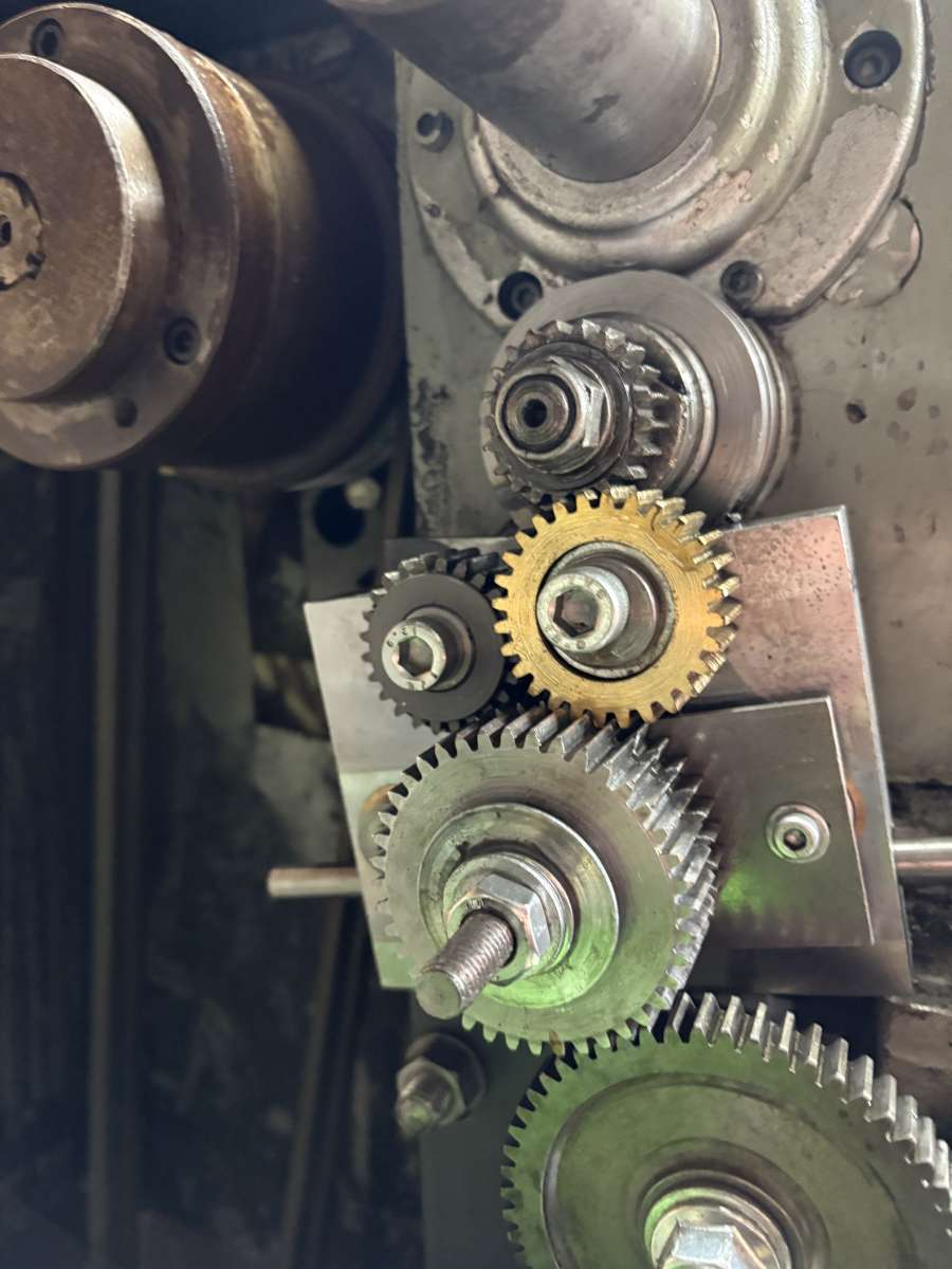

                              Just increase their was any doubt I did check the timing between the spindle gear and the driver gear on the clutch shaft and remarkably 40 is indeed a bigger number than 21 so it doesn’t run 1:1 this is something that I have completely overlooked. So now I must make up a work around and as Gary has very nicely offered to have a look i must say I’m in capable hands.
                              there are marks on the gears but you might not be able to see them very well.
                              IMG_8928IMG_8929IMG_8930

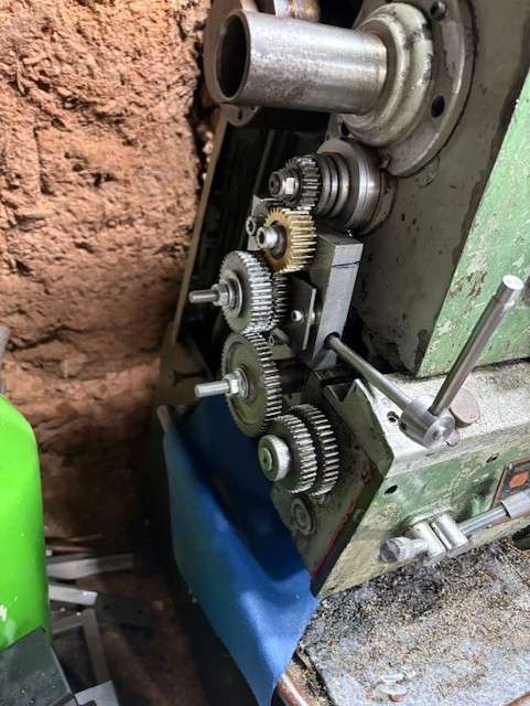

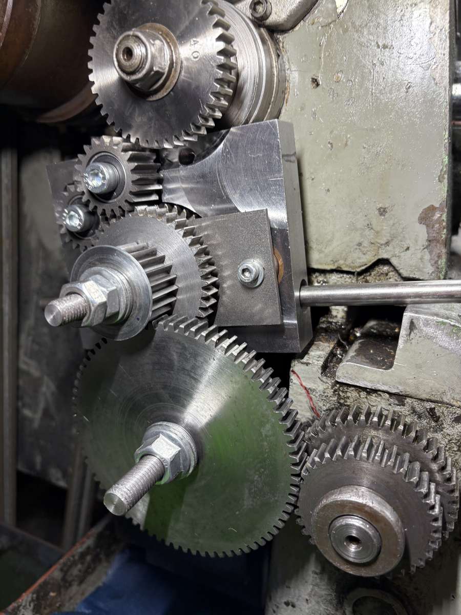

                                Afternoon all I thought I would share an update on the clutch. Over the weekend I finished up the new gears and got everything fixed up. I still need to make a couple more parts before I use it properly but I the first couple of practice cuts it is working perfectly.
                                once again thank you to everyone for the help and a thank you to gray for his help with modifying my backing plate to take the new gearing.IMG_9047

                                  Well done sir.
                                  Very nice job.
                                  Worthy of an article and drawings in Model Engineer & Workshop as an inspiration to those of us running larger, ex-industrial machinery proving that Graham Meeks design can be re-arranged to work with the typical end gear train layout.
                                  Certainly made me wonder if I was premature in deciding there was no way of getting Grahams clutch onto my Smart & Brown 1024. Seeing yours I clearly missed an engineering nicety that should have been obvious. Concept is still a horribly “round the corner” drive but stealing your idea might just be enough to make it work. Another winter project!

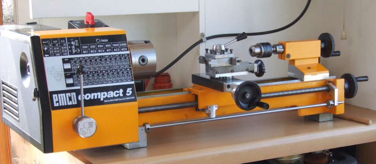

                                              The Compact 5 my most recent addition to this system never had a tumbler reverse to start with but this unit still works as Hardinge intended.

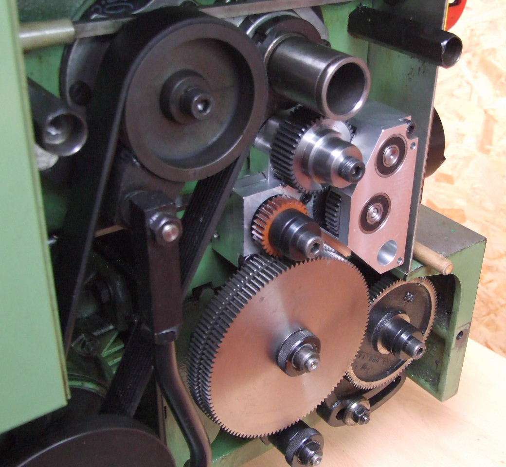

                                              C5 Screwcutting Clutch Trip Rod & Stops
                                              Compact 5 Screwcutting Clutch
                                              The ease of threading is the whole idea of the screw cutting clutch. Stops to the front or rear of the lathe, which ever is the most convenient for the trip rod on that design of lathe, are set to determine thread length. After engaging the the clasp nuts, (which are never dis-engaged until the thread is finished), and setting the tool in contact with the work the screw cutting proceeds in the normal way retracting the tool at the end of each cut, (a retracting topslide, or tool holder is ideal for this), until the thread is finished.
                                              I can, on the C5, set the gear train for a particular thread and finish the threaded item in around 15 minutes. When I had the Maximat Super 11 threads were much quicker than this because of the Leadscrew gearbox.
                                              Photo 7 Clutch fitted
                                              Above all the threads produced were truly concentric and the finish is always good.

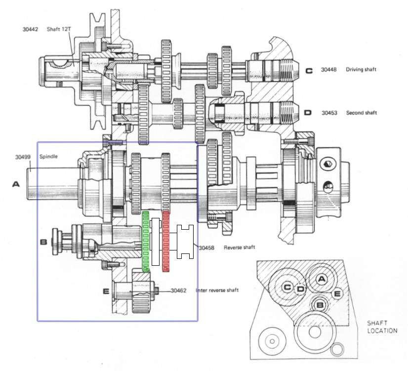

                                                #815642
                                                Macolm
                                                  @macolm

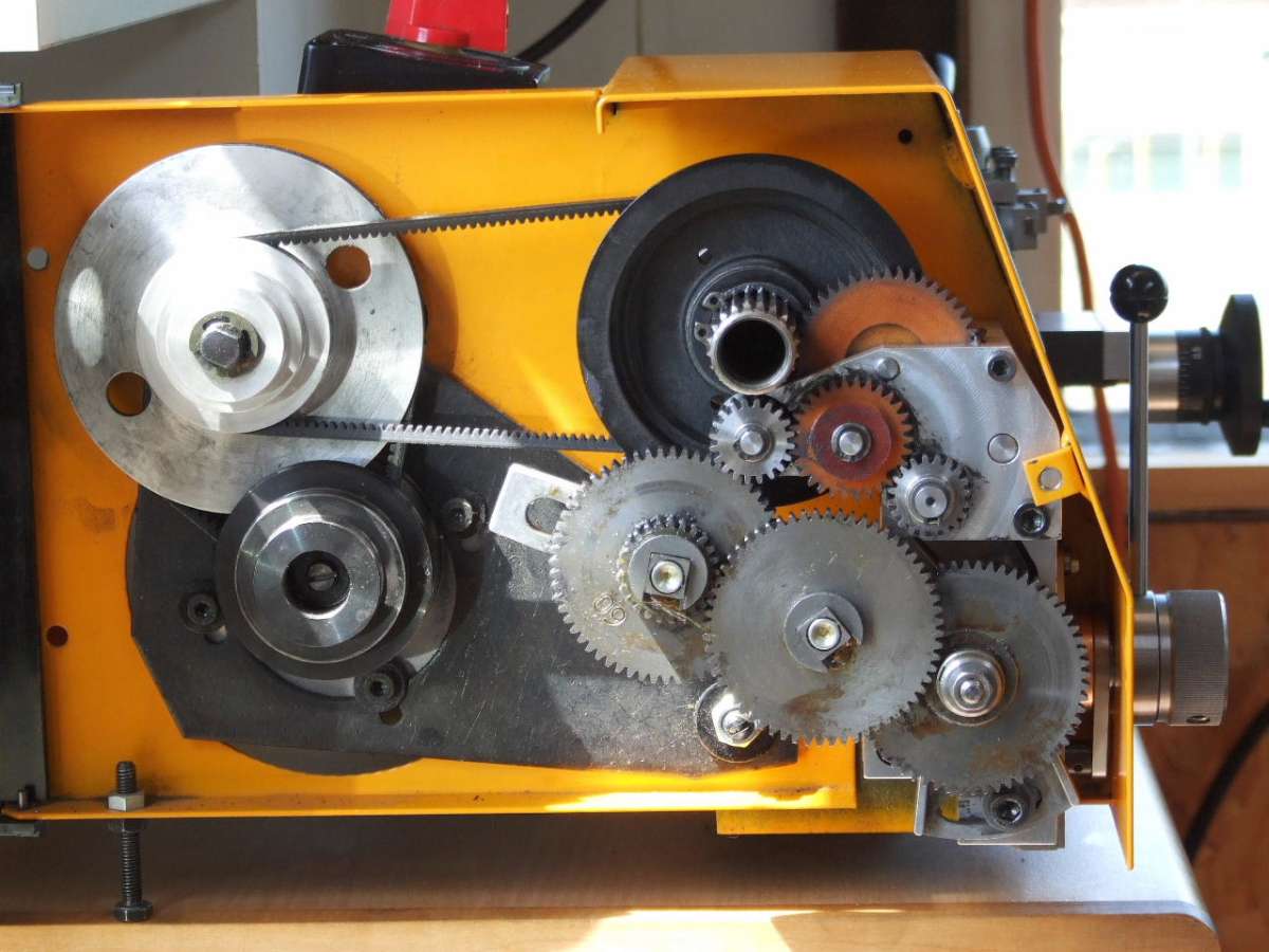

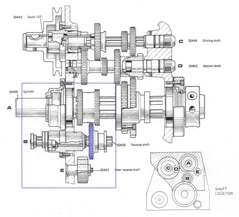

                                                  Apologies if what I wrote suggests that a tumbler reverse is in any way part of your designs. It was merely to applaud you for dealing neatly with what at first sight is an awkward feature. Again, I have no doubt fitting one of your designs to a suitable lathe provides a valuable feature and great productivity boost. Thanks for the helpful videos.
                                                  I merely wanted to point out that things may be simplified if adding a similar feature to lathes with feed reversing like the Bantam. It is never easy to describe these things purely in words, so to clarify what I was suggesting, here are diagrams modified (fairly poorly) from a Bantam parts list.
                                                  Bantam Leadscrew Drive1
                                                  In the first diagram, the feed reverser parts are within the blue rectangle. The first of the change wheels fits at B. Note that the left side of the inter reverser gear runs in constant mesh with the leftmost spindle gear, though shown separate for parts list purposes. The movable reverse shaft gear works in crash mode to couple either to this gear, or to the adjacent spindle gear. Obviously synchronisation is lost immediately it is disengaged.
                                                  Bantam Leadscrew Drive2
                                                  The second diagram shows how it might be modified. The reverse shaft would almost certainly be replaced with a new purpose design, a simple item to make. Two new simple gears would be needed, shown green and red. Each would need a single tooth clutch dog, but be otherwise ordinary straight spur gears, and run on the shaft in constant mesh with the existing gears as shown. Making the new shaft with a suitable bore and cross slots would allow dog clutch control via the usual fork selector, three position with cental neutral.
                                                  The bad news with the Bantam (at least the Mk 1) is the gears appear to need to be 30 tooth, 10DP, and probably 14.5 pressure angle.
                                                  #815649
                                                  Graham Meek
                                                    @grahammeek88282
                                                    Hi Macolm,
                                                    What you have shown for the original Bantam set-up is the same set-up as that in the headstock of the Maximat Super 11. The original design I had for the Maximat was to do exactly what you have suggested in your second set of drawings.  This involved stripping the spindle out, which at the time I was not keen on. Although Emco did offer me a spare headstock to get the ball rolling and a complete set of drawings.
                                                    Another problem with fitting the gears inside the headstock especially the Maximat is that the factory made gears are all Shaved for smooth running. Fitting standard gears in the machine means some loss of quietness.
                                                    It was not until some 30 years later that I decided to fit the unit externally. This took several attempts as the switch gear for the motor runs through this area of the machine. Given Taris’s solution I would be inclined to adapt this solution to the Bantam. The Colchester lathes have a strong family resemblance as regards layout. Fitting a unit externally means the gears can be of any DP or Mod you like to use as long as they are strong enough. Of course the output gear from the clutch has to be the same as the Quadrant gears.
