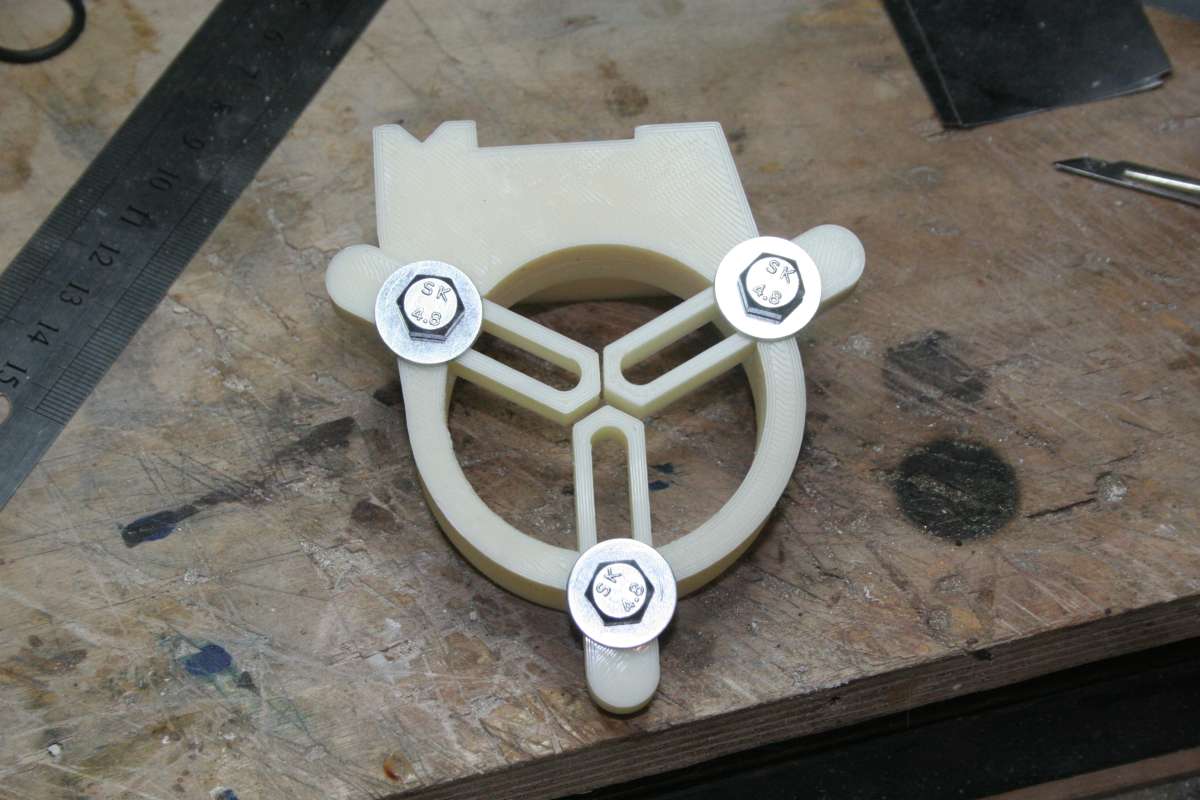

    Emgee
      @emgee

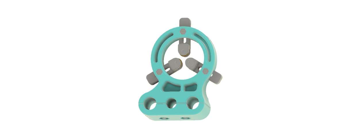

      If the poster wants a print file joining the Unimat iO Group is a good route to take, download is FOC.
      https://groups.io/g/Unimat
      Emgee.
      SL steady.SL steady

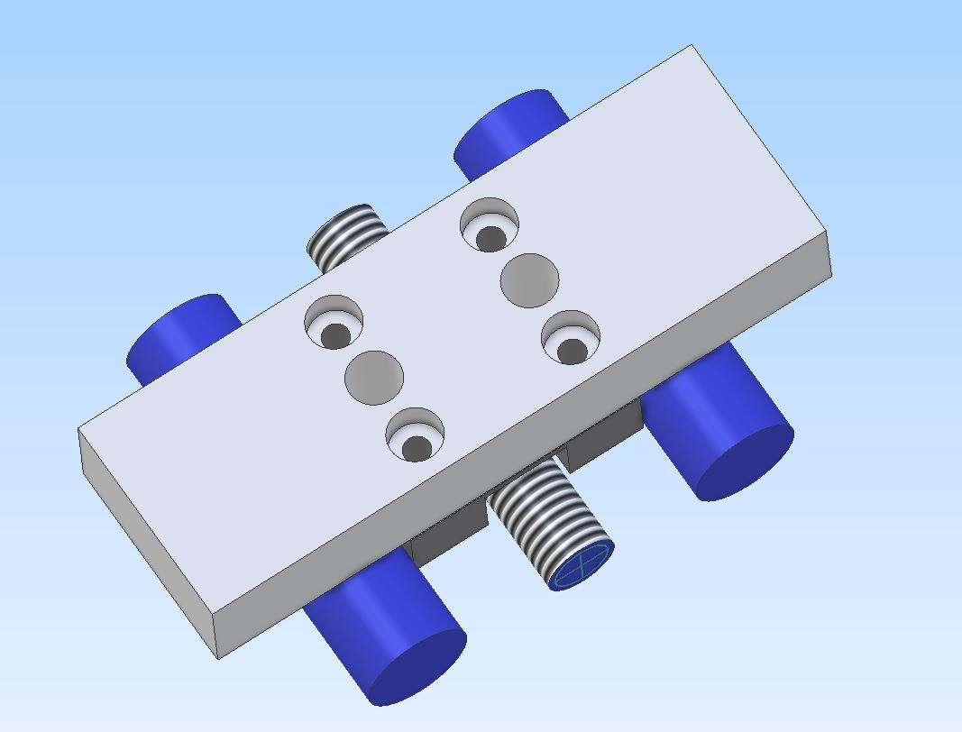

        All it needs is a bit of flat to locate between the 2 round bars, which could be done with file and saw, screwed to  a longer bit sat on top, and a 3rd long bit underneath to clamp it all together. No accurate holes of vees. Don’t introduce spurious accuracy.
        You may be ‘technically’ correct there, Duncan … But, as Dave has repeatedly reminded us elsewhere, we should consider needs and wants separately.
        If I was making a ‘fixed steady’ for a Unimat, I would want it to include kinematic alignment with the headstock spindle [which makes the job of setting-it-up for work much easier].

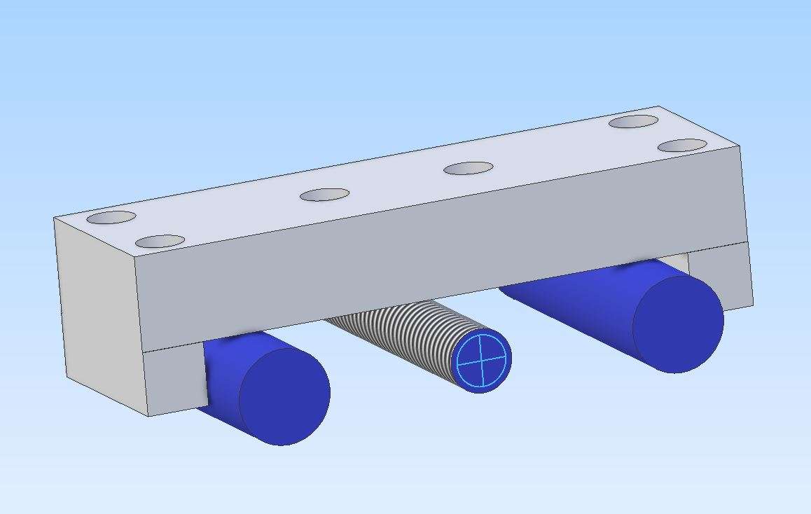

        #812990
          Duncans method would give 4 long contact points as would two vees so should keep it lined up. Take a look at a Myford fixed steady, If it works for myford then it should also work for a Sl and give the Kinematic alignment desired.
          Emgee is that designed for the Sl as it looks like the U3 type but would still have 3 points of contact and work OK if sized for the round bar SL’s ctr height?
          #813003
            Sorry, Jason … I have difficulty visualising Duncan’s proposal
            I’m struggling to “accommodate” the central feed-screw in that simplistic description.
            Out all day today, so I probably won’t be disrupting.
            #813009
              Maybe that is why it wa ssimplistic, he was describing a way to locate the steady, clearance in the middle would be upto the builder. Yes you would need to cut a clearance notch or similar for the feed screw just like the third hole if going for the drilled/bored/reamed option.
              Or two small blocks that bear on the outside of the bars would do the same job, screwed on with clearance holes they could be finally tightened up in position so reducing the need for accurate sizing of a central block. Infact given the OPs limited equipment just a single block at say the front would do, so long as you pushed that up against the front bar when setting and again when positioning the steady and leaving the middle clear for clamping bolts. Graver rest would not even need a block, just a flat bar will do and the added ability to swivel it’s position on the bed bars would be a bonus as you would get more versatile positioning of the rest, similar to the banjo arrangement found on woodturning rests.

              Emgee
                @emgee

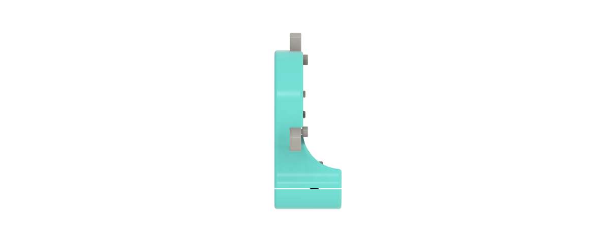

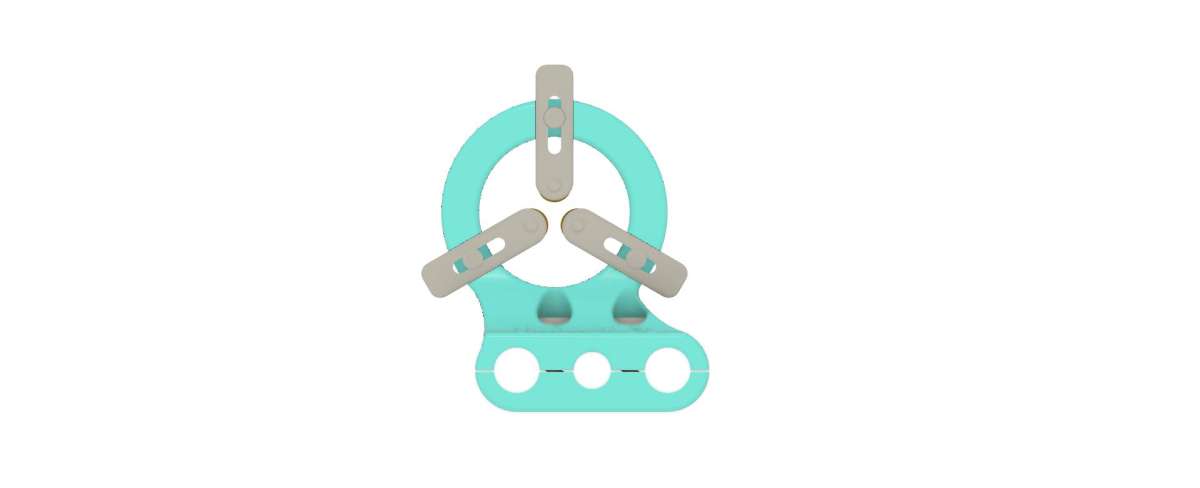

                Updated info: Yes Jason the pictures show the U3 Steady but have found the correct file this morning for the DB/SL steady. Step file opened with Fusion360 to capture images.
                Emgee.
                Unimat-SL-Steady29-Sept-2024..Unimat-SL-Steady29-Sept-2024.Unimat-SL-Steady29-Sept-2024

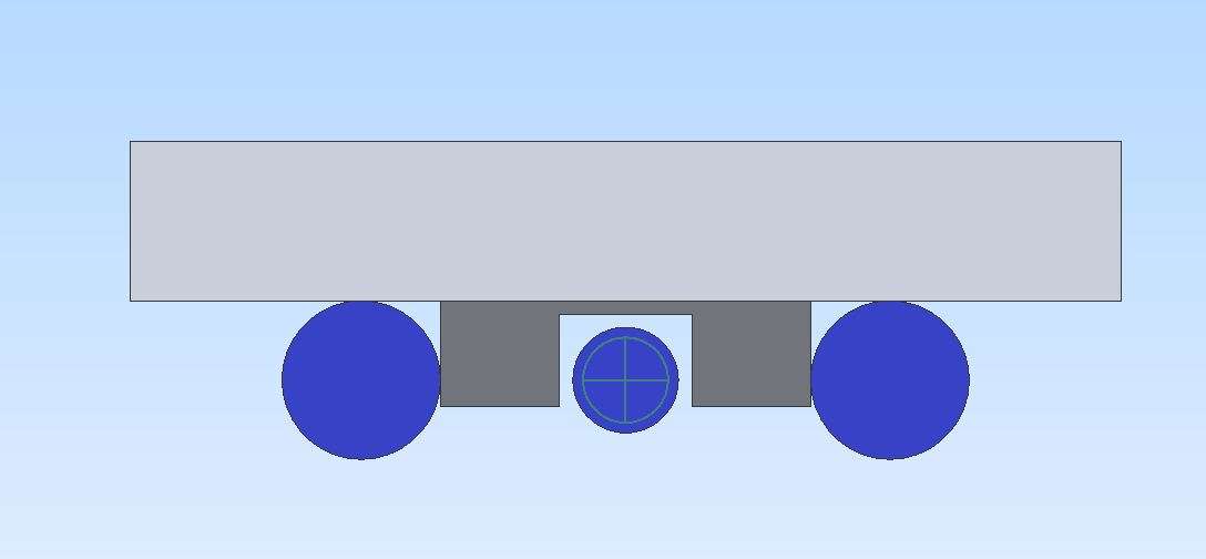

                #813020
                  For anyone else who can’t think beyond a simplistic description this is how Duncan’s suggestion would work with a bit of common sense applied.
                  steady1
                  steady2
                  Or the outside block option
                  steady3

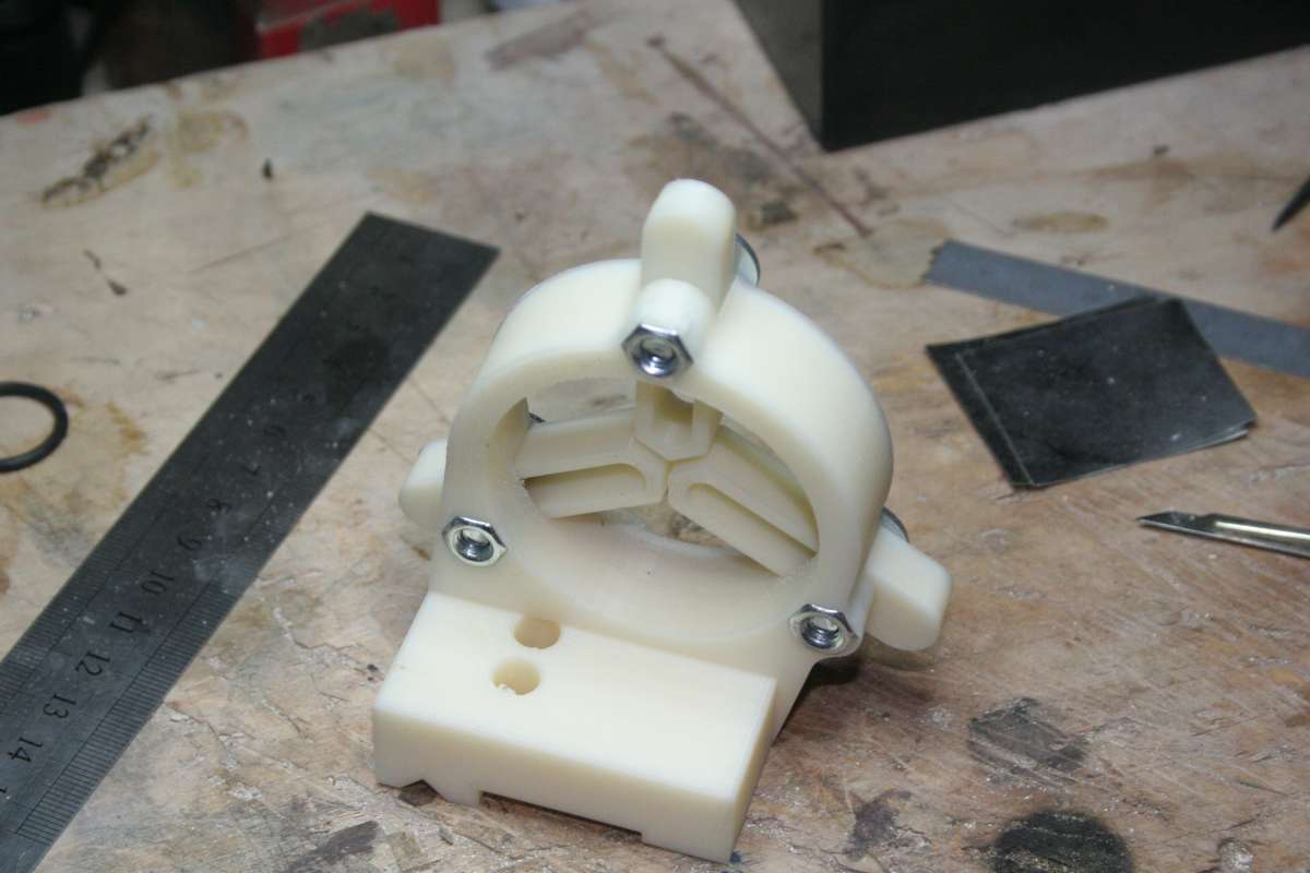

                    That looks the part Emgee, just need to find that reel of Emco coloured filament. 😉😉😉
                    Looking at that U3 version they seem to have got it the wrong way round as the foot will face away from the headstock meaning you will need excessive tool stickout if the carriage is not to hit the steadies base. My cast one has it the correct way round.

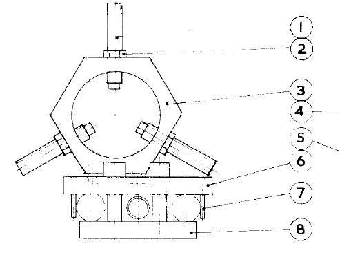

                      Bazyle
                        @bazyle
                        Just a reminder that there were a lot of articles on using and upgrading this little lathe in ME in the ’70s.
                        eg 1976
                        142
                        3551
                        1284
                        R.L.Tingey
                        A Travelling Steady for the Unimat
                        #813052
                          Or how about this earlier one from 1969, four pins on the outside not unlike the two blocks I suggested
                          pins
                          #813059

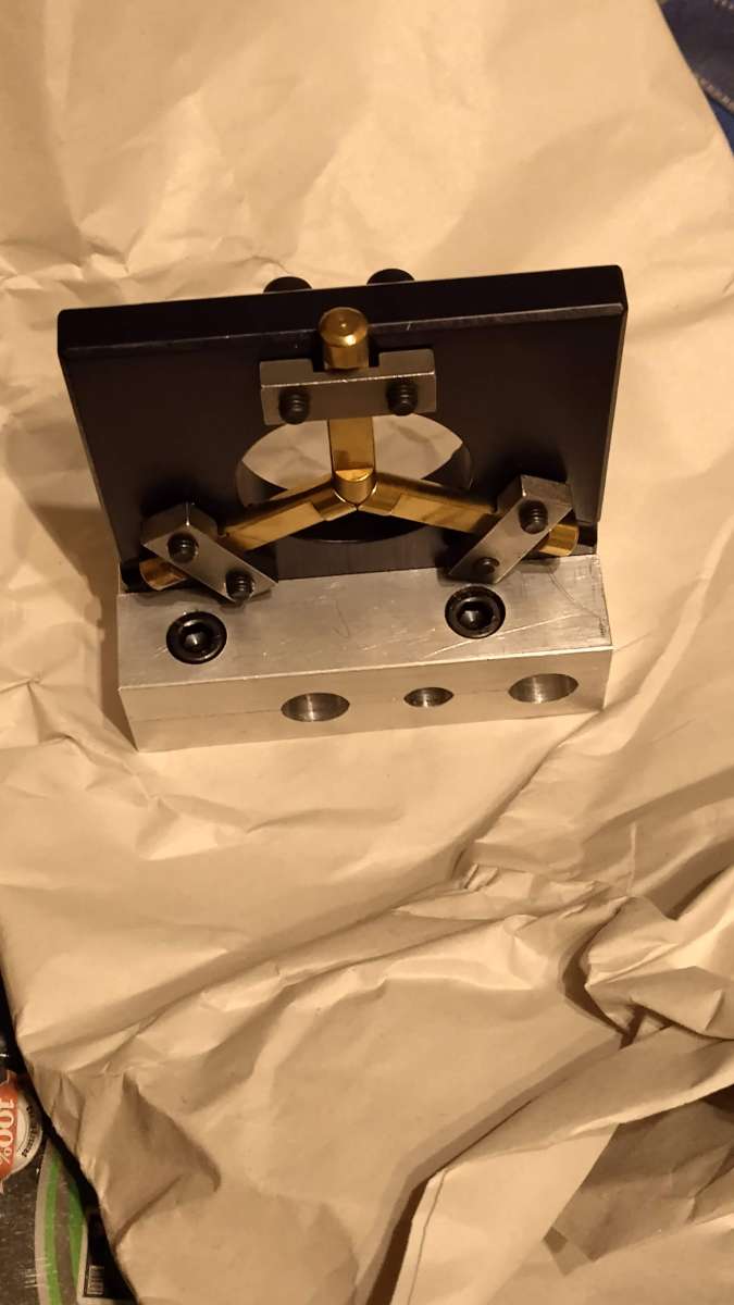

                              Gosh this thread has certainly woken up again after a month being quiet! … typically while I was away for a few days.

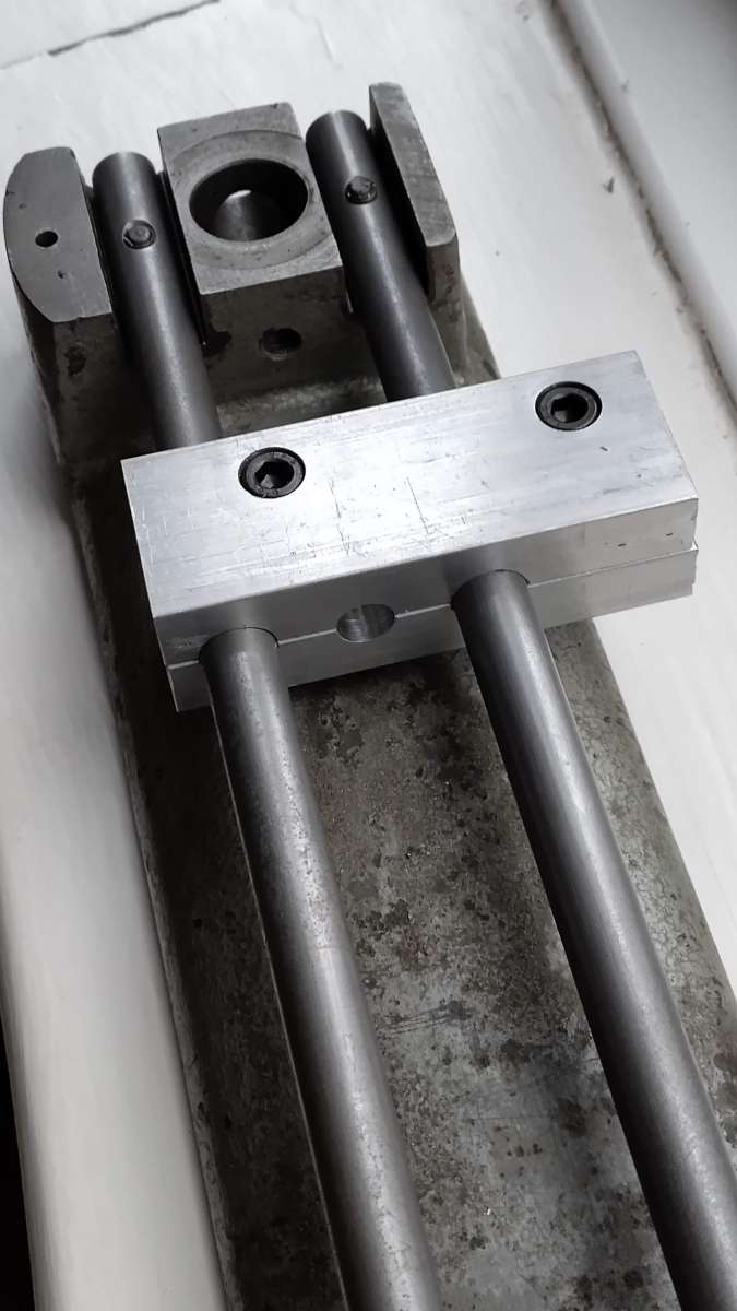

                              Thanks again for all of the suggestions. The job is not yet done but the materials have arrived to do the job with two rectangular aluminium bars and three holes. One thing the Faircut does very well is putting drills through things so I am ok with that. This is also a prompt for me to get my clamping arrangements made less hand to mouth and that is now underway.
                              The actual plan is to cut down a Taig steady and screw it to a Unimat compatible base. A similar base is planned for a hand graver support and another adapted Taig steady with a base to fit my son’s EW lathe. The Taig bits are also now in my grubby mits.
                              I will think about other options for riding the Unimat bars but the multiple block options would likely mean starting with different bar stock than the stuff I have already bought.
                              I am intrigued by the discussion of alignment but searching for the kinematic variety turned up a lot of info on knee surgery so I am not sure what it means for a fixed steady.
                              Regards,  Andy

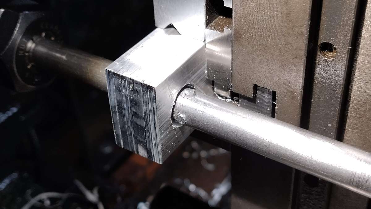

                                  Andy Carlson
                                    @andycarlson18141

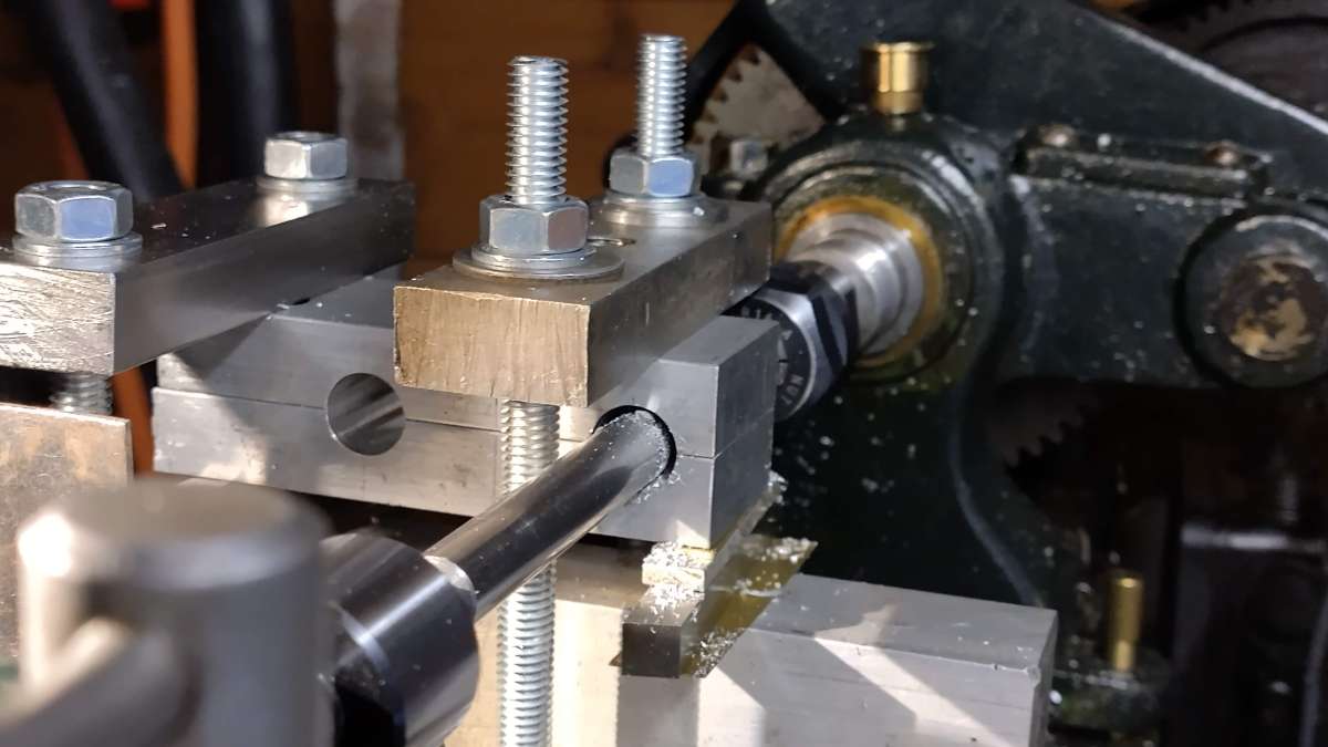

                                    A small update. Things are progressing slowly due to other demands on my time but I have finished making a decent set of ‘T’ nuts and a 3/8 ins boring bar using a bit of 3mm round HSS as the cutter. Said boring bar was then given a test run on a piece of Aluminium stock held in the vice on the vertical slide…
                                    IMG_20250917_203904 (1)
                                    The stock for the job proper has now been cut out and drilled and tapped for the clamping screws so that these can be used to hold the two halves together while making the 12mm holes.
                                    I also tested my cross slide leadscrew/dial for accurately spacing holes at 20/40mm and found it wanting so I am planning to measure using vernier calipers between a square clamped to the saddle and a block clamped to the cross slide. This setup was used when drilling the clamp screws… not because I needed it but because it was an opportunity to try it out.
                                    It’s amazing how you think you have already bought or made tooling to cope with most jobs… how wrong you can be!
                                    It’s wet and windy out today so traipsing back and forth to the shed to set the next (trickiest) part of the job up seems rather unattractive.
                                    #819396
                                    Andy Carlson
                                      @andycarlson18141
                                      Some progress has happened. The 12mm holes have now been drilled and bored.
                                      I changed the plan a little while doing it – I reckoned I was getting measurements repeatable to about 0.1mm using the vernier calipers to measure the cross slide position… which might or might not have been good enough. After getting the second hole to a sliding fit on the bar I then offset the cross slide by 0.1mm in each direction and did another pass with the boring bar to make the hole a little bit oval… so something of a nod to the positioning discussion but without the need to try to make different shaped slots and get them both to ride the bars at a consistent height.
                                      IMG_20251007_170842
                                      Seems like a result! …
                                      IMG_20251007_174502
                                      A nice sliding fit all along the bars. I needed to skim the joining face with a fly cutter to allow the thing to grip the bars. I also needed to skim the bottom because although it cleared the Unimat base just fine (I had checked when drawing it), it was not possible to slot it into place without slackening the screws that hold the bars down.
                                      I still need to modify the Taig steady and do the drilling and tap to hold it on top of the base… plus tidy up the remaining sawn end of the base.

                                      #819450
                                      bernard towers
                                        @bernardtowers37738
                                        Why did you not shim the blocks before boring the holes?
                                        #820798
                                        Andy Carlson
                                          @andycarlson18141
                                          I thought about shimming them apart but that meant cutting some shims to suit and possibly an interrupted cut. I needed to lose some thickness from the bars anyway so skimming after making the holes seemed like the path of least resistance.
                                          The Unimat steady is finished now… except I neglected to take a photo.

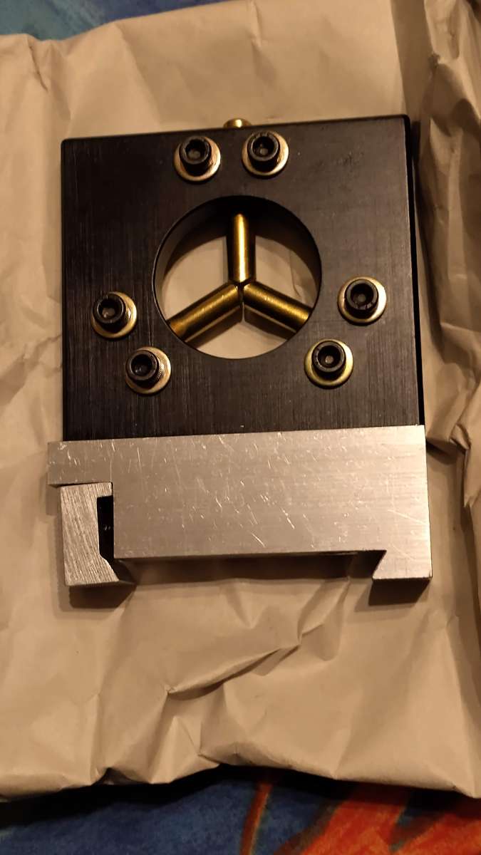

                                          Andy Carlson
                                            @andycarlson18141
                                            And the photo…
                                            IMG_20251023_213725
                                            Bonus photo… EW version… no tricky 12mm parallel holes on this one…
                                            IMG_20251023_213433
