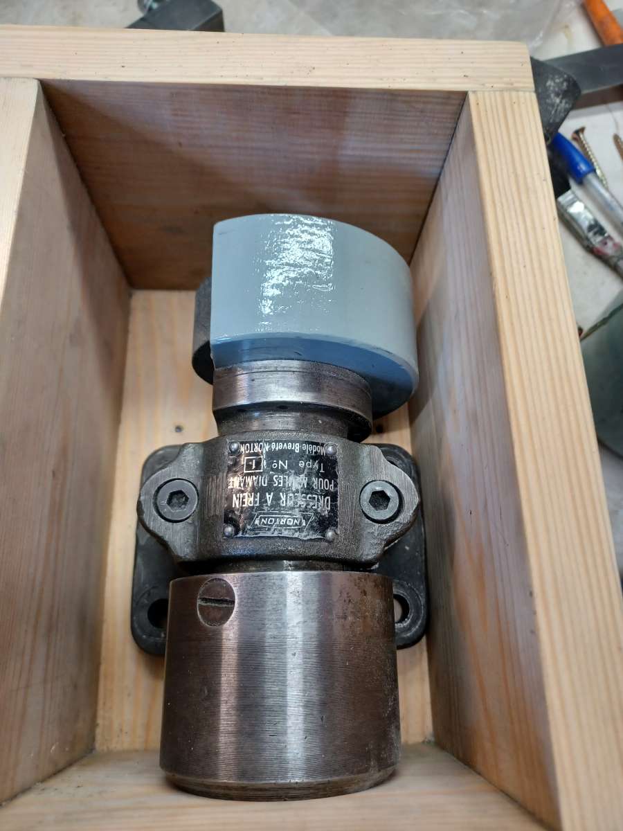

      I recently bought a diamond dressing attachment to dress the cup wheel on my modified cutter grinder.  It cst me £150.00 and if I was to buy a new one they are I believe around £300.00. I had it on my bench for a few months as I am strugling for proper storage space and I needed to look after it a bit better and so decided to make a box to protect it. The box was made from some spare planed wood I already had which was a bit thick but as itwas free ok. I ordered some hinges, handles and catches of the net which cost me around £18.00 in total and made a sturdy box with some wood dowels which fit the hold down holes and stop it moving about.

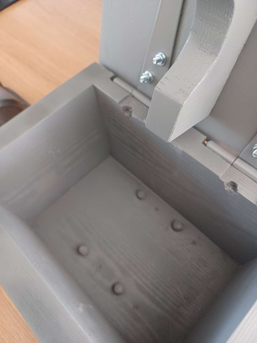

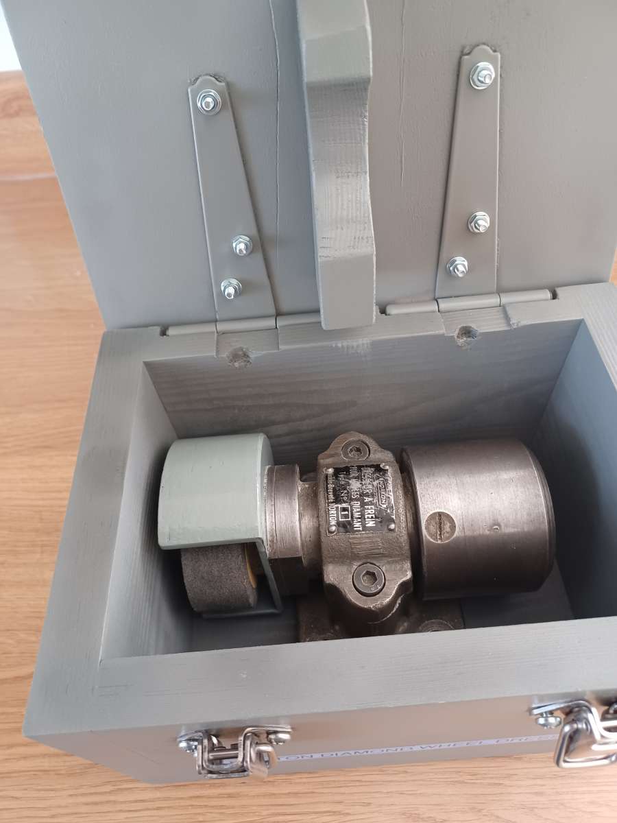

      The next thing I did was to make a lid with a piece shaped to hold down the Dressing attachment when closed.
      20250919_151027
      also it was painted in and out with spray paint to I hope keep out damp etc.
      20250919_151001

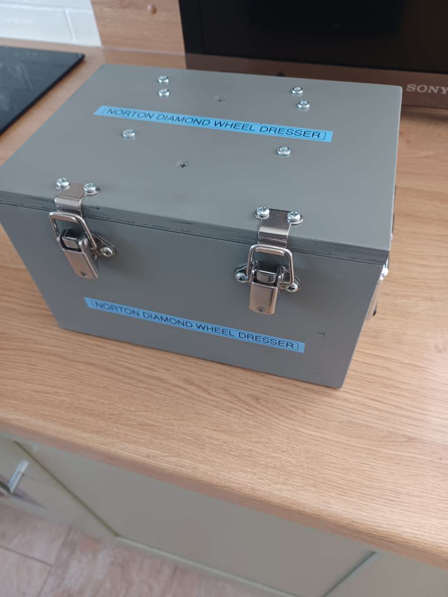

      The handles, latches were fitted and a couple of labels and will I hope help in the future and with protecting my investment.
      20250919_150950
      Is it a bit over kill or worth the trouble?

        Probably overkill…. But it does look very nice and very professional. So well worth the effort ! 🙂
        It should probably have a green baize lining 🙂  🙂   🙂

          I have to admit that I do the same with my tools and have never regretted it. You can knock the box about but the contents are still ok so in my book its worth it.

            Can I say that I think you have a screw loose?
            On a similar theme, countersunk screws in the lid would allow you to put something on top of the box.

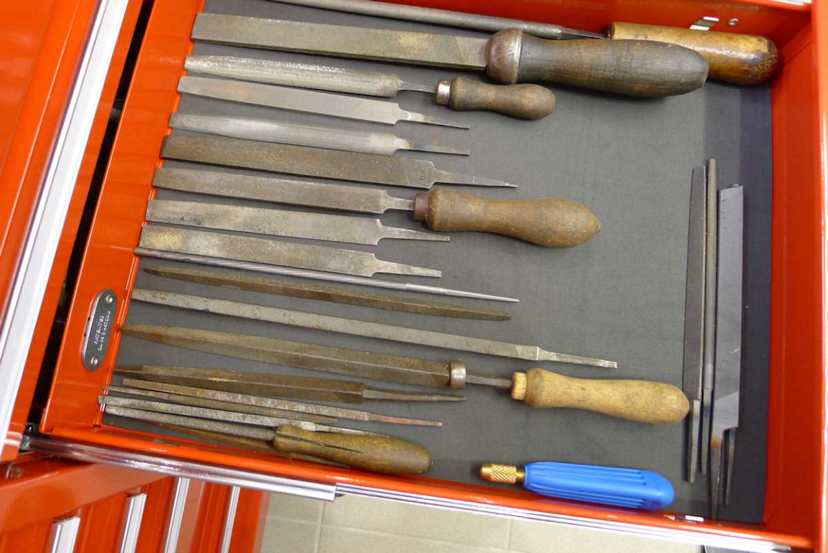

              It reminds me of an incident in my very early days at sea.  The engine room workshops in those days were frequently attached to the engine room itself and, in some cases towards the stern where not only machinery vibration but also propeller vibration was quite excessive.  On this particular ship we were also fitted with a controllable pitch propeller, which were also noted for higher levels of vibration.   Consequently at full speed the vibration in the workshop made many tasks, such as machining, simply impossible.  Vibration also has an incredibly destructive effect on any item not securely fixed.  Valve handles for instance that are not secured will eventually erode away and fall off.
              Anyway one day the chief engineer came into the workshop doing a bit of tinkering with something and opened the drawer with the files in it.  The files stored in there had been rattling around against each other for years and were all well chewed up.  He want absolutely crazy shouting as anyone in range that we didn’t deserve good tools as no-one showed enough responsibility to look after things etc..etc.. He dragged the storekeeper down as well and gave him a thorough dressing down before storming out.  That was around 45 years ago now yet I remember it to this day.  I remember it because he was right.  Consequently all my files are now laid out neatly in a foam lined drawer and they are always cleaned before replacing them.
              I’m a great believer in looking after all tools, no matter how basic.

                It depends a lot on your workshop conditions. If not temperature stable moist damp air will penetrate the box albeit in small quantities relentlessly over the years. Consider further protection for the base of the tool in contact with the damp wood (hard candle wax in this instance) and any unpainted metal.

                            I think the box is worth the effort.  The Diamond Dressing attachment is expensive and probably spends most of it’s time in storage.  Left unprotected, it’s liable to be found rusty when needed, could get dinged, and might be hard to find in a roomful of anonymous cardboard boxes and old carrier bags.   Also helps whoever inherits David’s workshop when the time comes: it’s labelled ready for sale on ebay!

                            David’s box is great, though I’d put the contents inside a thick sealable plastic bag with a Silica Gel bag and some vapour paper as well.  Whether belt and braces are needed depends on how damp the workshop is and how much the temperature swings.
                            Choice of wood can be problematic.   Pine should be safe, Oak might not be.  Many oaks are acid, and it’s ironic that many a posh oak tool-chest has caused corrosion!   Oak is perceived as “quality”, but cheaper woods or plastics often perform better. Has to be the right type of oak…  I expect other woods are unsuitable too.  Anyone have a list?

                                Nice work on the box, the green baize lining would put the icing on the cake.

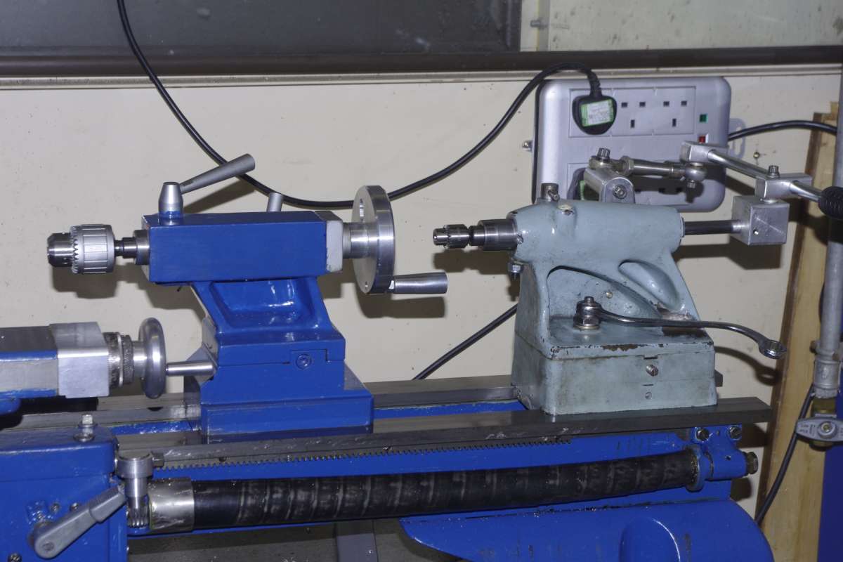

                                As for the paint, I bought 750ml of Hammerite smooth direct to metal paint some years ago to paint the Atlas 12 X 24 lathe that was gifted to the museum along with the Tom Senior light vertical. Much too much for the one lathe as I found out and on Thursday, I searched the whole restoration shop for it. Roger found it in somebodys cupboard with about 10mm of paint still at the bottom and still in perfect condition to paint the spare tailstock which I had converted into a lever operated sensitive drilling one.
