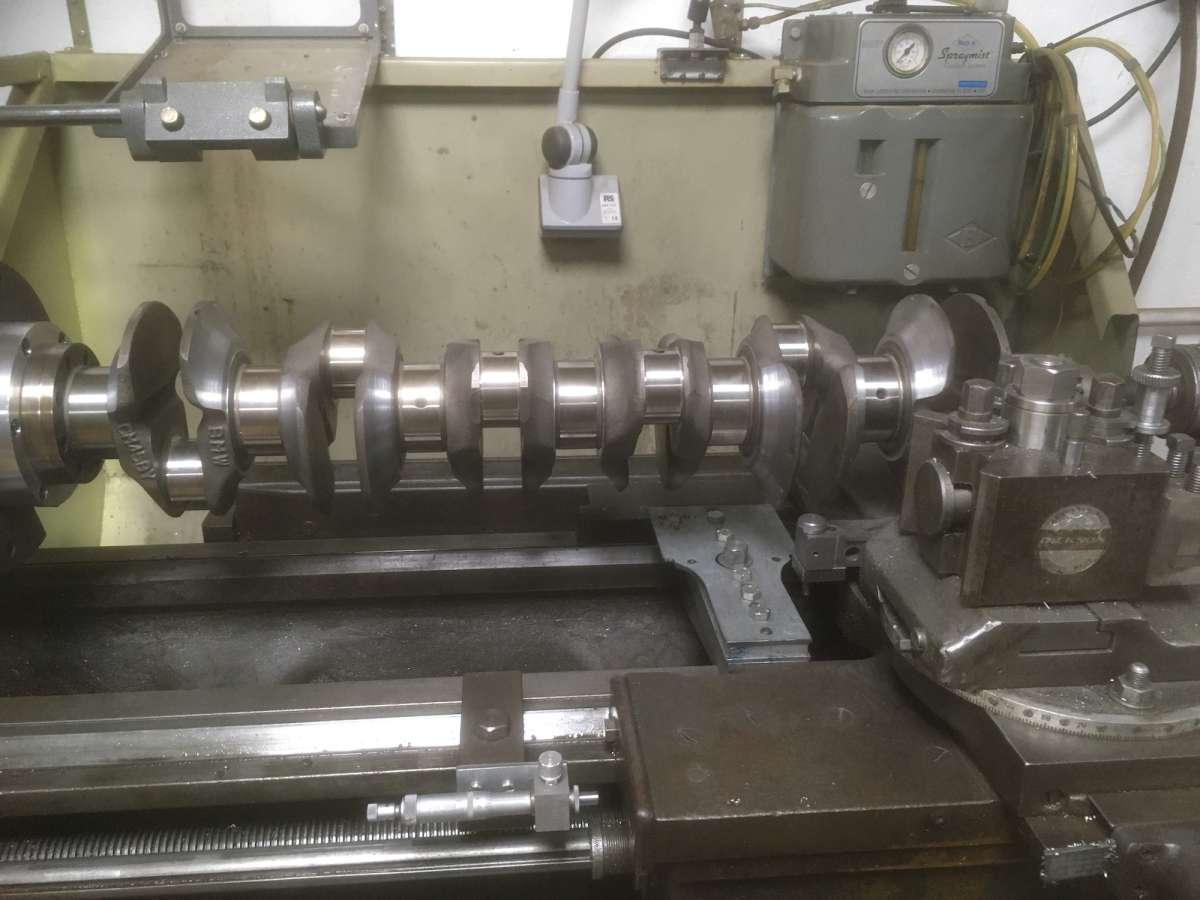

              Or maybe something like this.
              Follower
              BMW 6 cylinder crankshaft set up on my Pratt & Whitney Model B lathe for trimming down the webs to give it the weight watchers treatment to go in an engine for classic racing saloon car.
              Template bolted across the bed with a follower fixed to the cross slide. Lathe tool is pretty much out of sight on the other side of the tool post. Double sided template with left and right handed insert tooling to do the pairs of webs for each crank throw.
              As it’s a one way curve power cross feed works fine by pushing the saddle back as the probe runs down the template.  A fairly significant axial load hence plenty of bolts holding the template in place.
              Bit bigger than what you intend to do but the principle scales. For accurate results you need to consider the effects of template follower radius and tool tip shape. I cheated and generated the template in place by scanning a works racing crankshaft using a dial gauge in the micrometer stop holder and replicating the shape by co-ordiante milling using a cutter of the same diameter as the probe. About 200 points per side I think.

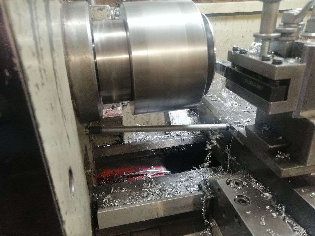

                Greensands. You do not say what radius dimension you are trying to achieve but I used quite a simple method to turn the face of an 8mm thick, 100mm dia ali blank convex so that is was 2mm thick at the edge.
                I used 2D CAD to work out the radius (I’m useless at maths) and made a ‘radius arm’ to that length, I found a convenient place on the headstock for one end of the arm to engage in and temporarily mounted a corresponding ‘divot’ on the carriage.
                I kept the radius bar in place by maintaining steady pressure on the saddle handwheel whilst advancing the cut with the cross slide. Actually I found it best to do the final cut from the centre outwards.
                The finished part was part of a pattern of a product to be cast in bronze resin and for a reason I now forget the designer insisted that the rear had to be completely flat with no spigot or fixing holes so I used superglue (and took light cuts!)

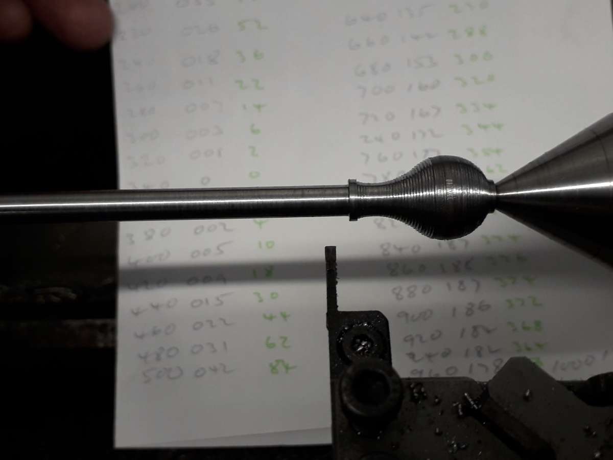

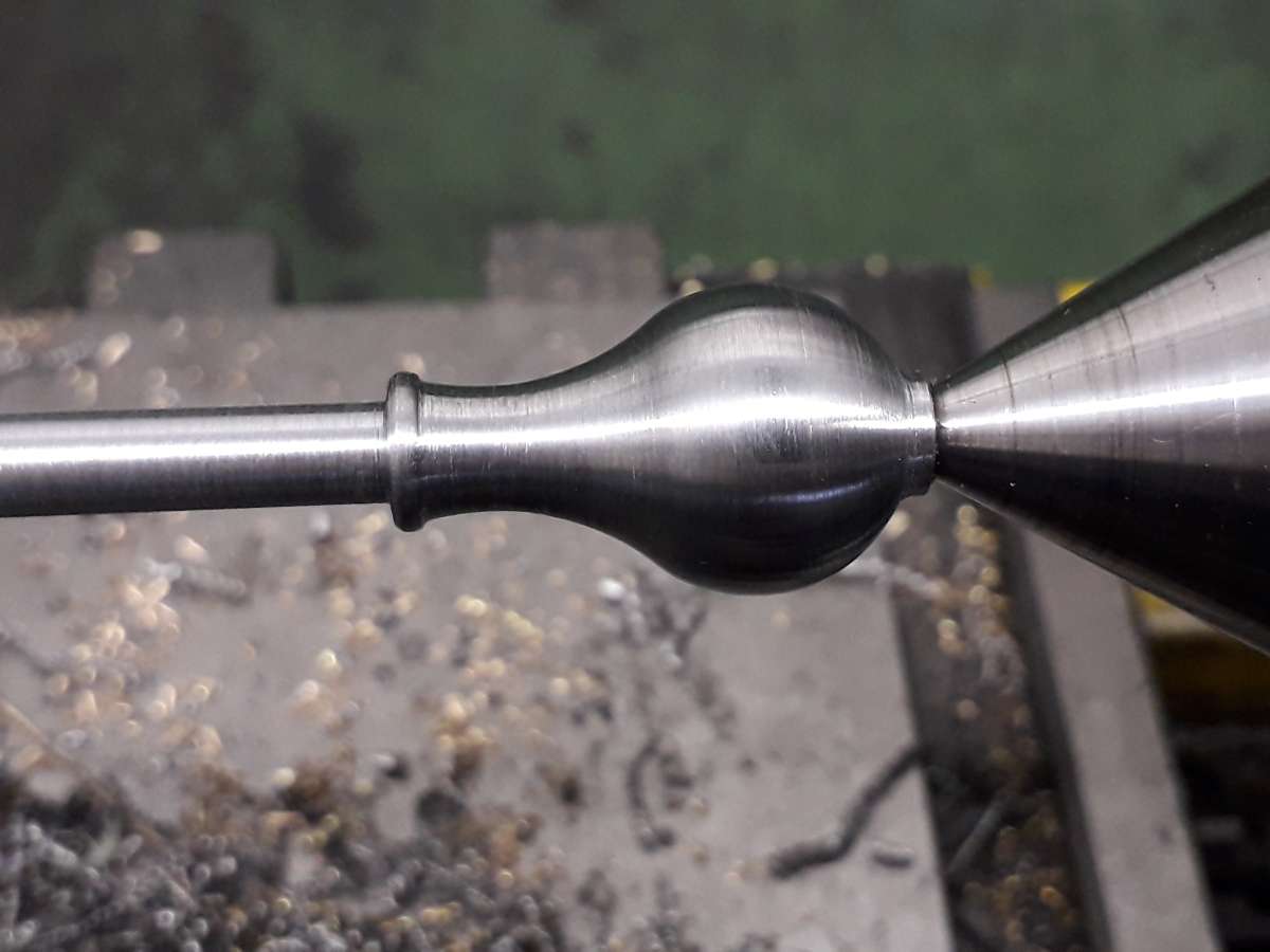

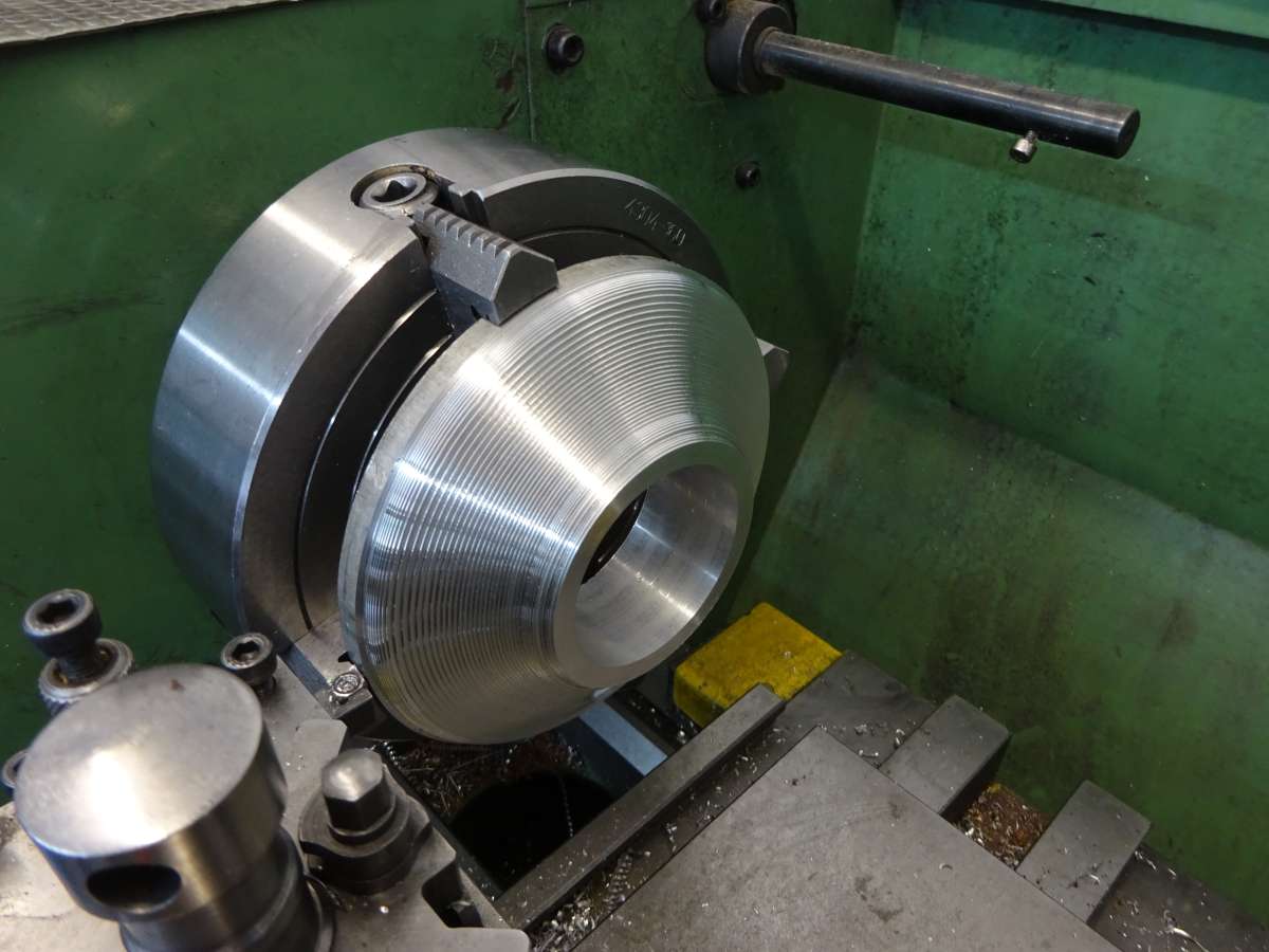

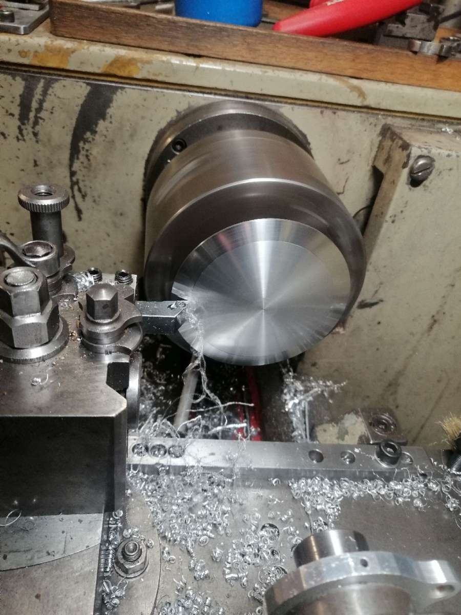

                        Is this for a smokebox door? As you seem to be working on that end of the engine. If so working out co-ordinates and then blending the resulting steps will also work. No more work that the milling of the template shown for the crankshaft where it was worth doing due to the number required but for one offs co-ordinate cutting the actual part may be simpler.
                        Use of an online PCD calculator will give the co-ords instantly. Just use a round nosed tool and enter the pPCD as part dia plus tool diameter. Divide the circumference by the stepover and enter that as the number of holes on the PCD.
                        Or if you have a DRO on the lathe the ARC function will work out the co-ords for you.

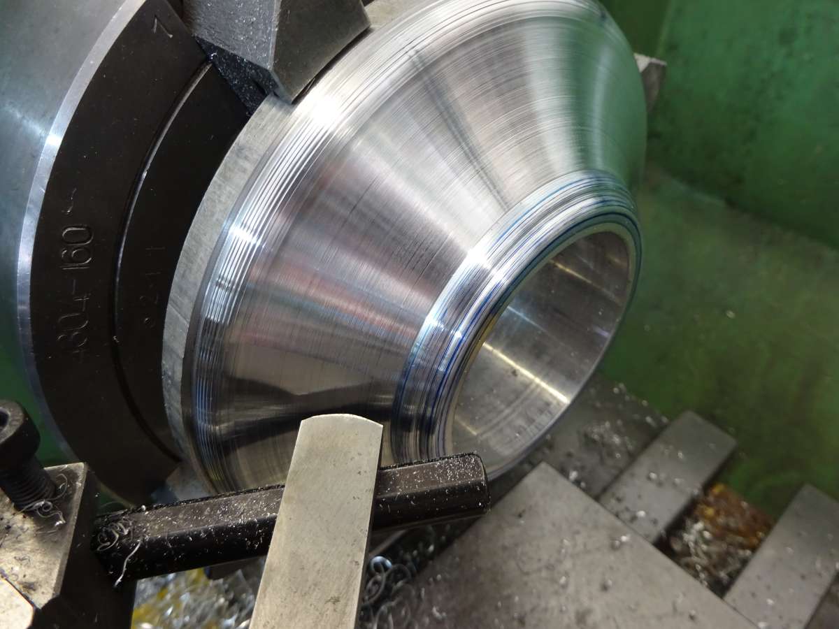

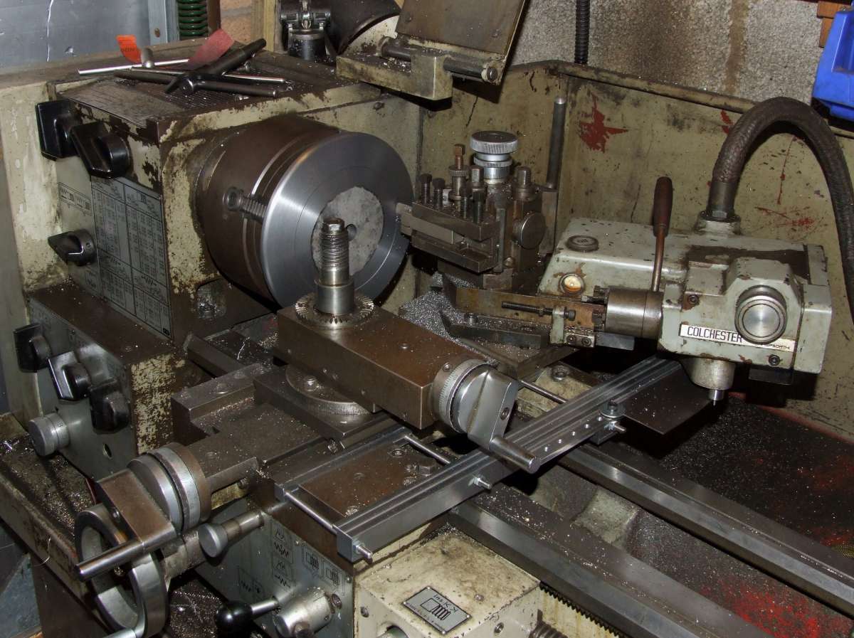

                          The ‘perfect’ way of forming a large radius on a smokebox door:
                          2018_08070012
                          To maintain accuracy the follower needs to the same shape, and orientation, as the cutting tool.
                          Finding a hydraulic copy unit for a Myford would be difficult, but not impossible. I’ll bet somebody has parts from a Mini-Kop tucked under the bench.

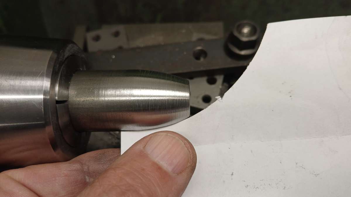

                                                    On JasonB Said:
                                                    I wonder how much pressure is really needed………………………………..

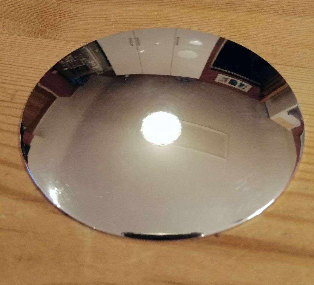

                                                    Wonder no more. I did a quick lash up to get something similar to the Eccentric Engineering tool. Just set the insert of my ball turner flush with the edge of the body. Clamped a bit of 120mm thick wall tube to the cross slide to use as a template. Then just pushed the body of the ball turner along the template, feeding in the cross slide to put on the next cut. Similar could be done with a block of metal to hold a bit of HSS, or a Gibraltar tool post if you have one. may even be possible to just have the topslide loose on the cross slide so you can move it about by hand.
                                                    1″ steel with a 60mm radius to the end. Paper template cut against the pipe to check the profile.
