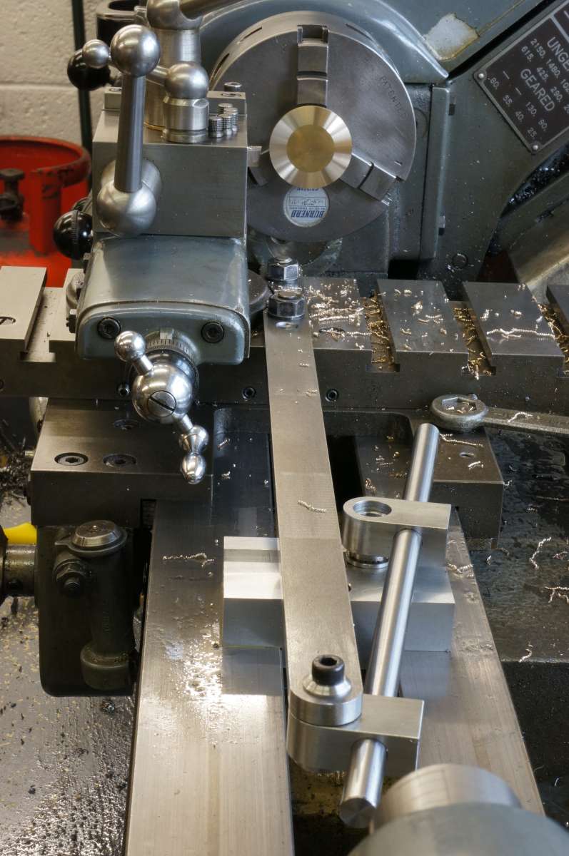

            Similar to Ian P’s method, I made a large radius attachment. The only setting up requirement is that the pivoting radius arm is straight when the tool is on centre (unless the work is required to have a central flat, or point, or be toroidal).
            2017-11-04_Fuel_Tank_radius_turning_ends_01

              Nice job Charles.
              Certainly smarter than the one I recall seeing on the internet.
              Love the way it keeps all the gubbins at the back out of the way of work holding and swarf. Worth a write up in the magazine I think.
              Clive

                Yes quite agree its MUCH tidier than mine and like the fact that its out of the way where mine is in an awkward place right under the work

                  <p style=”text-align: left;”>An excellent attachment Charles, I guess most of us could make something similar from photo but I would agree with Clive. It would make a good article for the magazine, certainly better than my template method.</p>
                  Andy.
