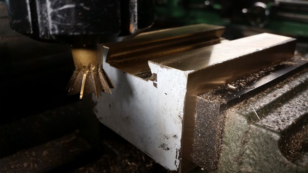

      Having never turned a Fusee for a clock previously, I wanted to look into it before I made any attempts.

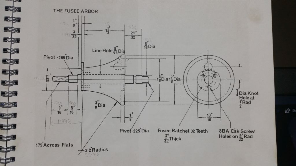

      I noted the two methods used by John wilding, and did not like them as I wanted to use a chain for drive not a twine etc. Therefore I needed a precise method of cutting the groove for the chain, maintaining constant depth.

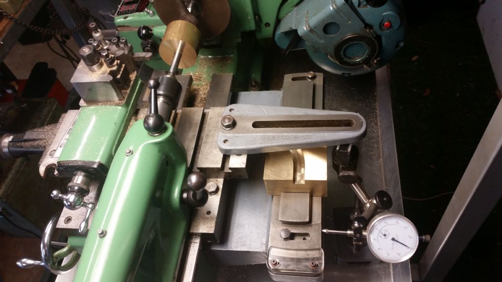

      I decided to adapt my taper turning attachment, replacing the sliding guide block with a fixed but adjustable radius cutting guide.
      I was very happy with the result, here are some photos to show what I did.

      2 The dimensions of the fusee from the book by John wilding.
      3 Cutting the dovetail to mount the block onto the taper turning attachment.

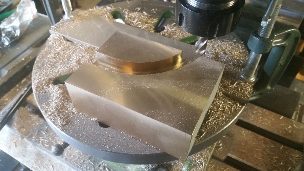

      4 Cutting the radius for the roller guide.
      5 Setting the attachment with the dial indicator.
      6 Showing the first few cuts of the fusee

      I have not cut the thread as yet because I have a fusee chain of 54” long, but I do not think it is long enough, I still have to find out the actual length, so if you have made one I would like to know please.

                How are you going to cut the groove?

                      Posted by KWIL on 10/06/2018 13:04:11:
                      Hello,
                      I will be cutting the groove the same way as anyone would cut a thread.
                      I usually turn the spindle by hand keeping the leadscrew engaged.
                      Turning the radius I used the power feed, and the finish is perfect.
                      As I said above I am going to use a chain to drive the fusee, however at this stage I do not know its length,
                      so still have to order the chain, until I do I cant cut the groove until I know the width of the chain.

                            However, I can’t resist mentioning that the 2” radius nominated for the fusee  does not compensate for the variation in spring output (Mr Wilding’s shows 2.2” radius). If you are looking for good timekeeping, you may have to carry out some torsion test beforehand.
                              Hello Sam,
                              Thank you for your comments.
                              I do realize the radius of the fusee is not perfect.
                              My future intentions are.
                              I am waiting on a book which will give me the ability to calculate fusee curves.
                              I will then produce the curve and cut it into my guide with a CNC. Then I will be able to produce the exact curve.

                                    Any curve can be cut with this method.
                                    With a fusee this is my first try, and I know the radius is only an average of the correct curve.
                                    With this method, the true curve of the fusee (Or any other curve) can be calculated.
                                    The pattern can then can be reproduced with the aid of a CNC machine, put on to a lathe (Myford)
                                    and cut exactly the way the calculations show.
