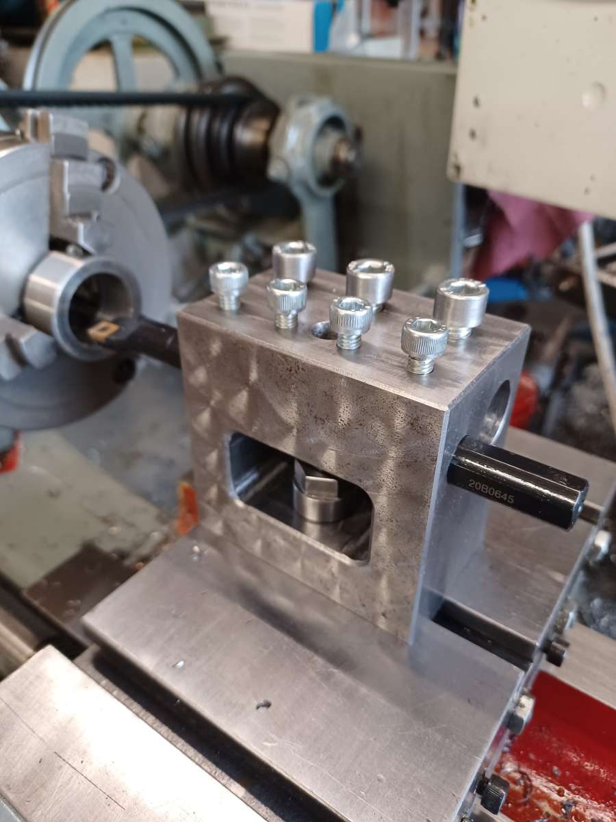

          To solve the problem of the tool height, I created a tool holder with a square seat
          and the lower part 2.5 mm thick.
          20250927_224121

            Neat idea, but not so easy to make. Anyway, why do you want to use such large tools?

                  On dk0 Said:
                  I created a tool holder with a square seat and the lower part 2.5 mm thick.
                  How would you make one from solid material?
                  What methods exist in a home workshop to create the square hole in a cost-effective manner?
                  How does it solve the problem of the bottom of the holder needing to be below the top of the top slide in order to put the tip on centre height?
                  Any design needs to take account of the surrounding physical objects, for which measurements of an actual machine are required.

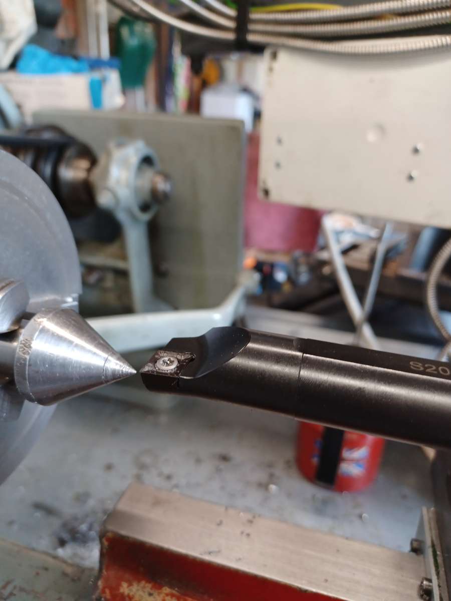

                      I had a problem with larger tools like screw cutting holders for the full form tip tools were unable to fit in the toolholder so i made a solid block with the bore on the center height of the spindle to hold these.
                      20230702_201308
                      20230910_171836
                      20230811_161359
                      David

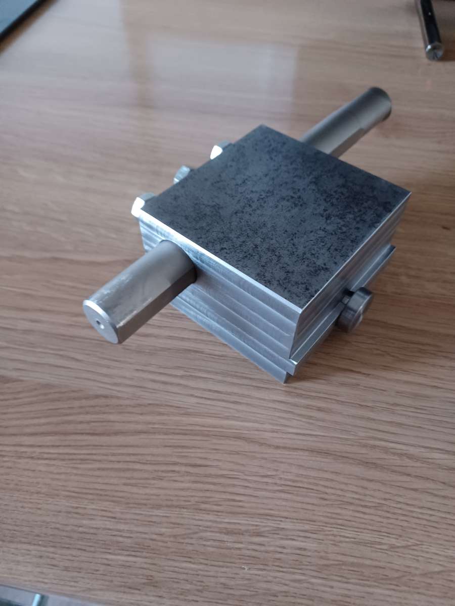

                              This could be an alternative solution for any home workshop !
                              20250928_153829

                                      A point that seems some here have missed with a QCTP is that of the tool block grounding on the top-slide, so making attempting to use over-size tools fruitless. Work-rounds to miss the slide edge will add extra overhang that is not desirable.
                                      dk0‘s block with its square hole may well help, but as DC31k replies, is tricky to make without suitable slotting equipment  – or considerable filing skill. It could be as two parts with the lower, outer part an angle fitted to the rest with countersunk screws, or welded / brazed before finish-machining. As he also points out, you still need consider the grounding problem.

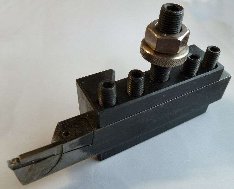

                                        I spotted this as I passed, a toolholder widened by milling with a carbide bit. This allows use of the Mircona grooving tool (cuts on all 3 faces). It is scarcely strong enough for parting anything harder than plastics, but excellent for the intended use.
                                        MirconaV
