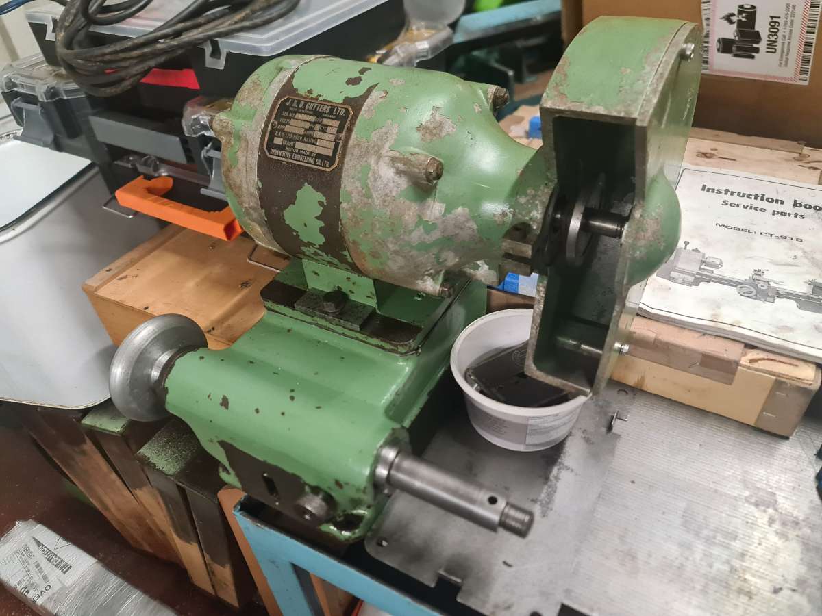

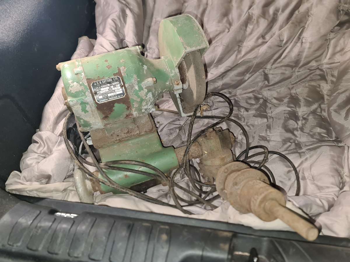

      I recently managed to buy the machine mentioned in the title for £50.  Here it is in its dirty and rusty form:
      20251007_194119
      Here it is now, minus the nasty cheap grinding wheel that was on it and the work head that is of no use to me:
      20251022_222152The horizontal shaft is just over 25 mm (AKA an inch) and one of the cheap universal workheads that fit on the Chinese Deckel SO knock-offs should fit on that shaft.  I’ll need to sort out the electrics as the on/off switch looks terrifyingly risky (I have a VFD that bucks up to 380 V and the motor still runs rather nicely) and make some hubs for cup/dished wheels but that’ll happen at some point.
      What I’m wondering though is does anybody have any information on the company or this particular cutter grinder and it’s original intended usage?  From the look of the original (and now exiled by me into the ‘potentially useful scrap parts bin’) workhead, maybe horizontal mill cutter grinding perhaps?  That’s total speculation though.

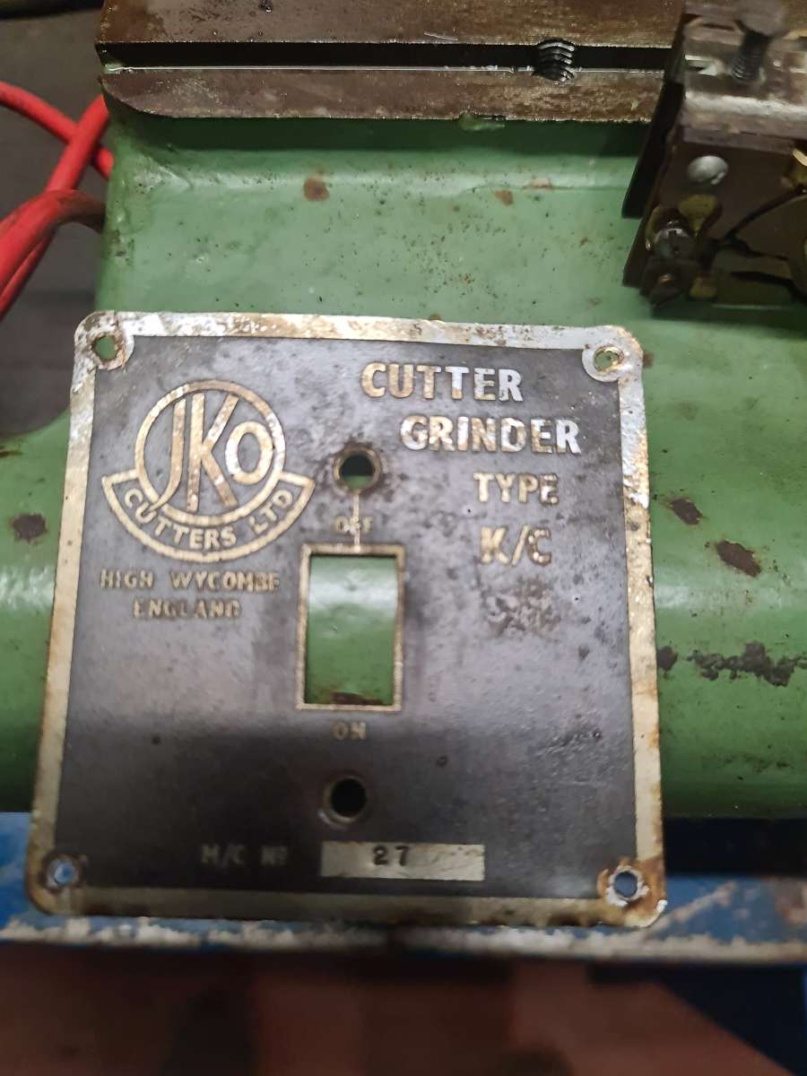

      Oh and here’s the name plate/switch plate:
      20251008_212310
      Many thanks in advance for any information provided.

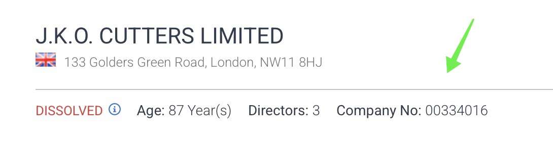

            This was the best I could manage … but I could find  no details on Companies House
            https://companycheck.co.uk/company/00334016/JKO-CUTTERS-LIMITED/contact#company-addresses

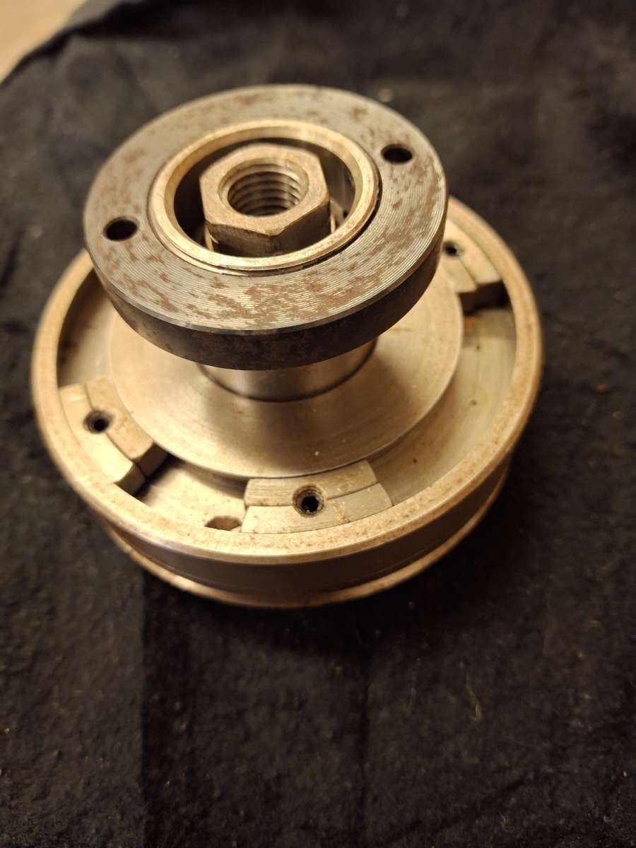

                    Wade Beatty
                      @wadebeatty78296
                      I just bought a surface grinder on a somewhat lowball bid. It came with interesting hubs with sliding weights that were trapped in dovetails. Maybe something like this could be a solution to getting your wheels ballanced.
