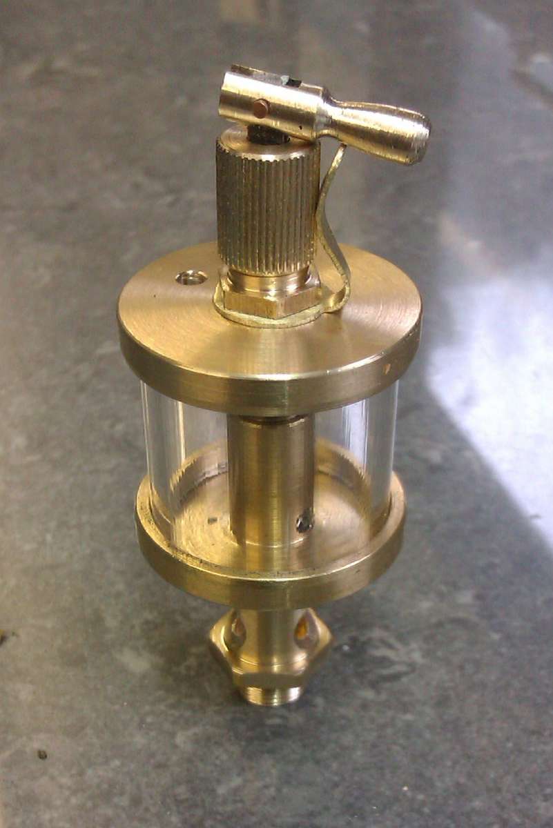

                      Could you set it up in a vee block and mill some V shaped grooves rather than knurl, the straight knurl at the top of this oiler was done that way.

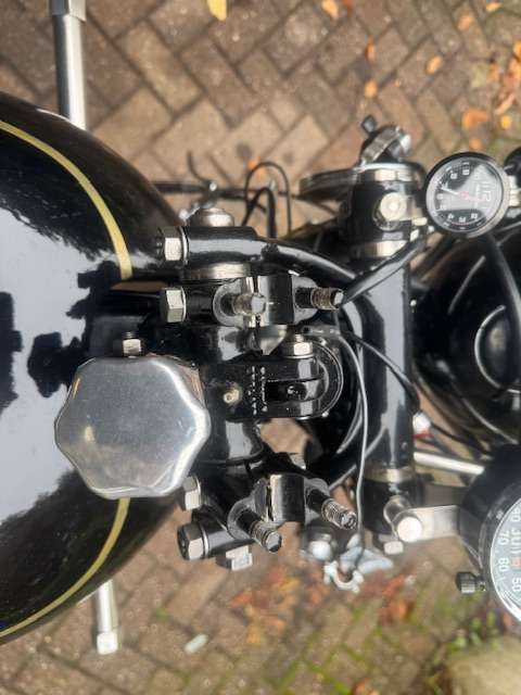

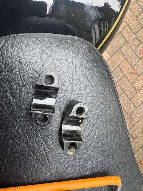

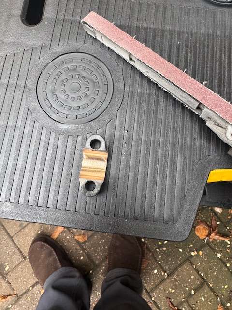

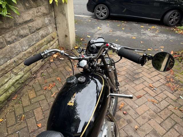

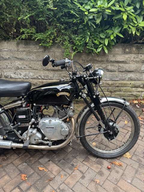

                              The new bars arrived so after removing the old straights the clamps were very smooth and painted gloss…
                              I don’t suppose theres much of a turning moment with the straights but i decided to clean off the paint with a power file and also powerfile the new bars so they were brushed rather than highly polished where the clamps clamp.
                              so far all seems good and its a far more comfortable ride..

                                      LOL. Blimey that will upset the purists, buckhorns on a Vinnie.
