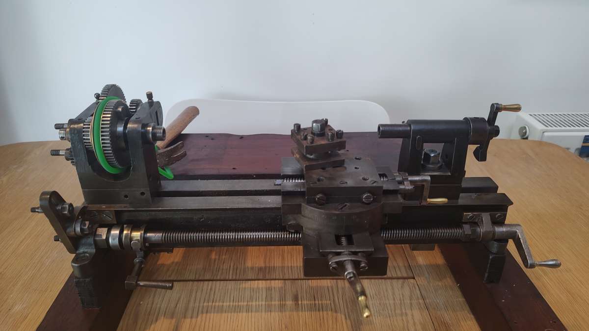

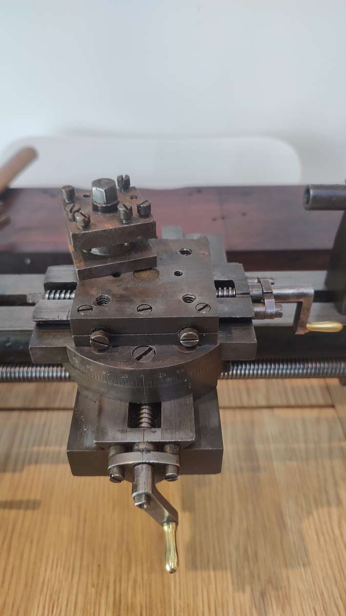

      Hi everyone. This is my first post here.
      I acquired this small lathe from a friend. By all accounts it belonged to someone who worked in engineering at UMIST (now part of Manchester University). When I got it, it was covered in brass swarf and hardened oil, and I have done my best to clean it up. It was supplied with a large AC motor driving the spindle via a belt – no countershaft. The relatively high speed of this setup and brass swarf led me to believe the maker mainly worked on small parts for (e.g.) clocks. I have bought a small 150W variable speed DC motor to power it in the meantime.
      Although some aspects of the lathe are well finished, it looks home made to me – at least in parts. The main bed is a single casting, and the head and tailstocks are also cast. They each sit on a riser block which is tenoned into the main bed. The spindle runs in cone-shaped plain bearings – the rear one has a brass bushing, but the front runs directly in the headstock. The backgear is a very simple but, in my view, clever design, whereby the backgear spindle simply slides forwards and backwards to engage and is held in place with two pins in either position. The nose is threaded 9/16x20tpi – which is the exact same threading as bicycle pedals. Perhaps the maker just had that tap on hand?

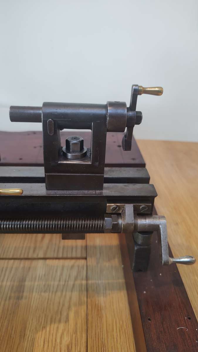

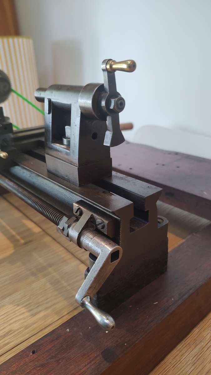

      The tailstock puzzles me. I cannot see that it has any scope for adjustment or setting over. The tailstock appears firmly bolted to the riser block with no play, and each of the four screws has been witness marked to its hole, presumably to assure an accurate fit when disassembling/reassembling. On the tenon itself are two screws that could function as a very crude tightening mechanism. The pictures show the holes where these screws sit. Adjustment is somewhat important as the tailstock and headstock are not well aligned currently.

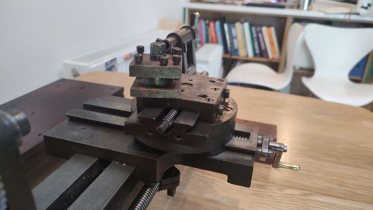

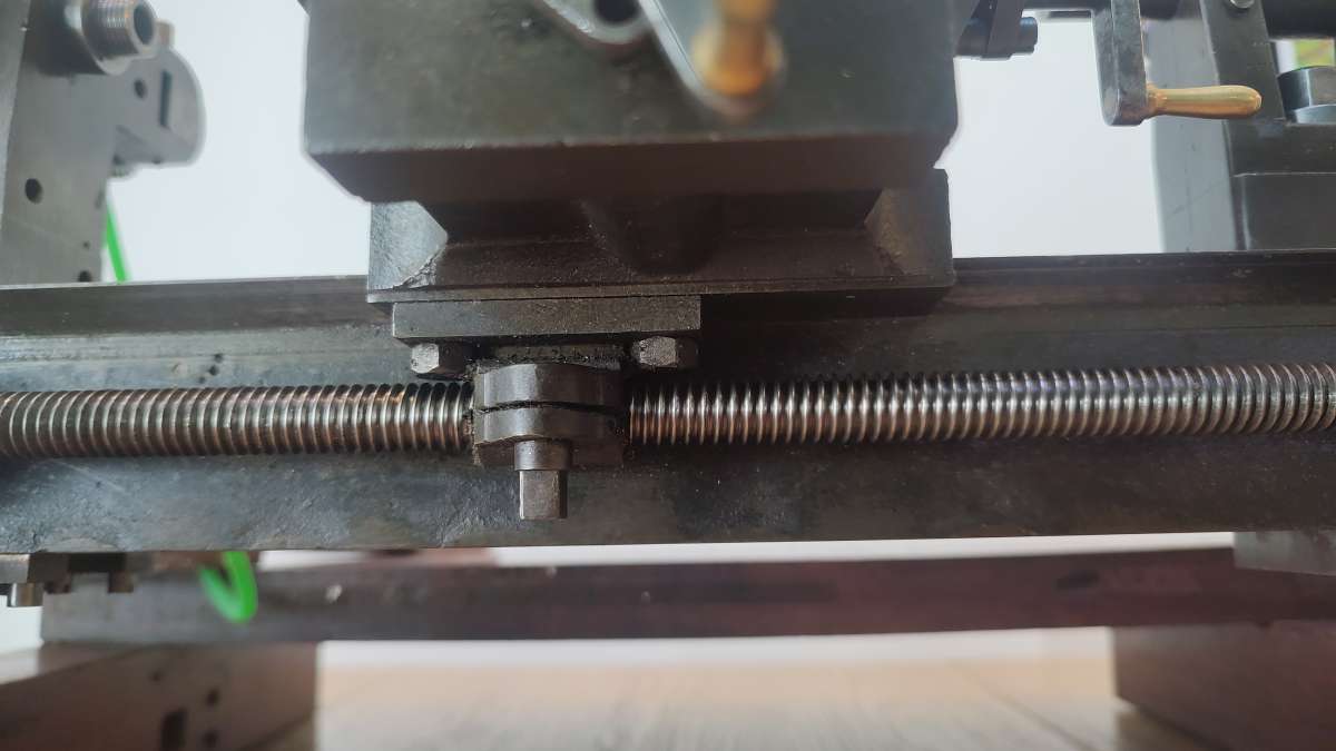

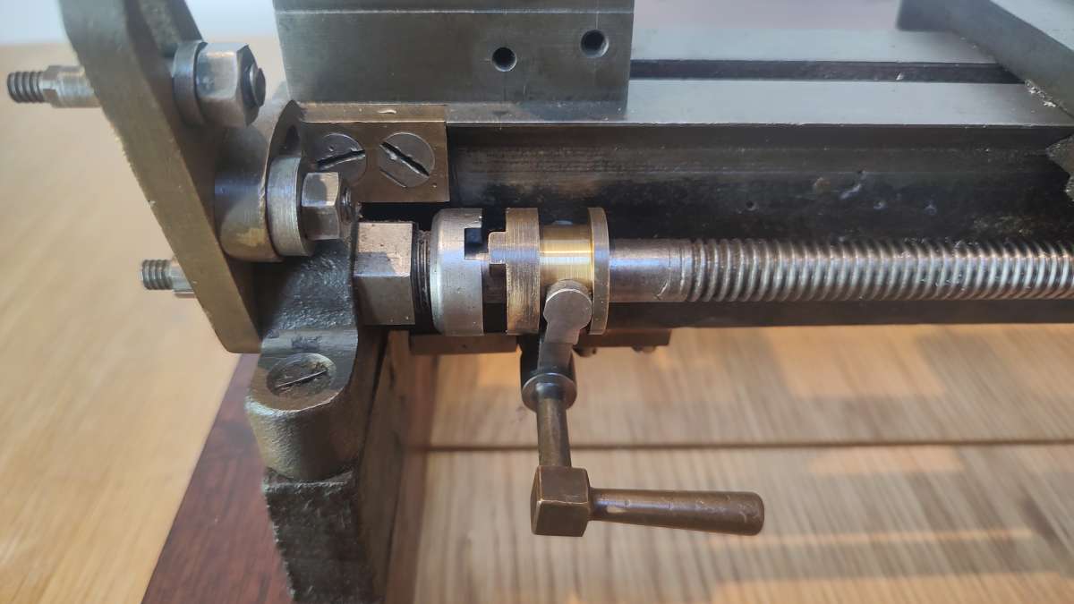

      The leadscrew is 10tpi and appears to be a regular triangular thread, whereas the cross and top slides (also 10tpi) have an acme form. I cannot work out why this would be. The dials on each slide are so small as to be of little use. The markings only go to a resolution of 2.5 thou.
      All three of the moving slides (saddle, cross and top slides) have dovetailed slides but no gibs as I traditionally understand them. Instead, one dovetail is removable and bolted in place. A threaded hole has then been made along the join which interfaces half in the slide, half in the dovetail. And screws are placed in this hole. The pictures show this better than I can explain it. I cannot understand why this setup was chosen, nor how one is supposed to adjust the fit of the slides. The screws cannot adjust the dovetail’s position laterally since a) one half of the threaded hole won’t move as the screws are advanced/retracted and b) the removable dovetails are bolted in place with essentially zero play. Perhaps the grub screws again function as a crude tightening mechanism, but I wonder why the maker chose such an approach, making well toleranced removable dovetails, when a gib is probably easier to do and provides better long-term adjustment capabilities.

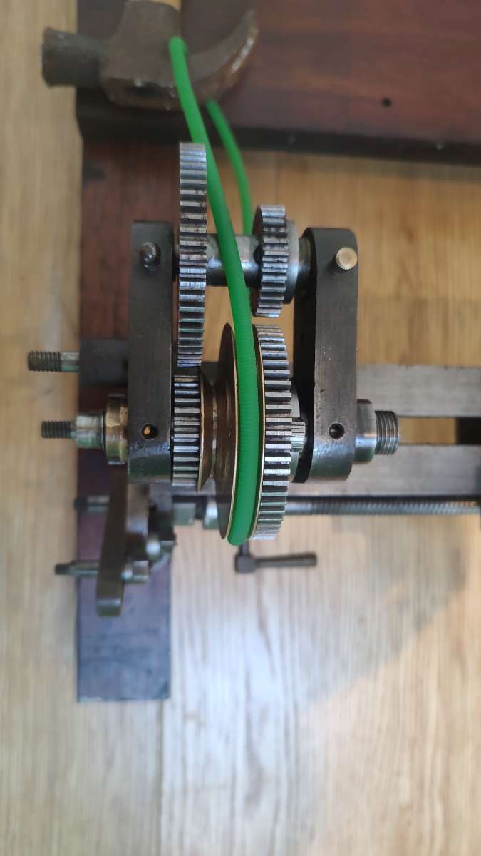

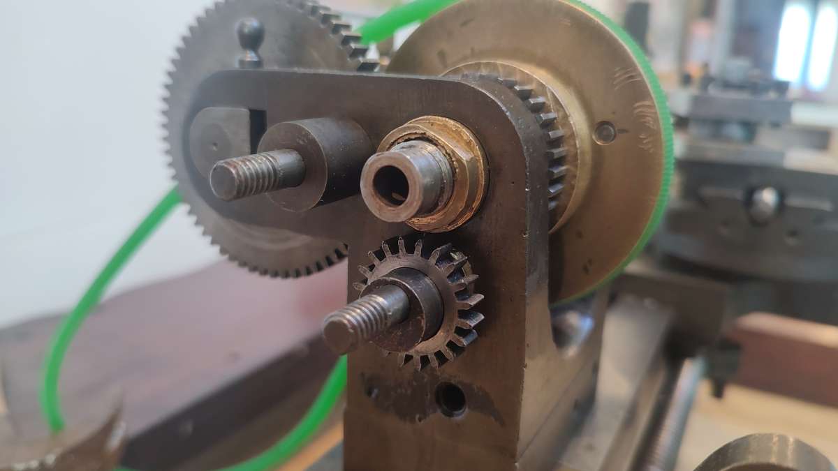

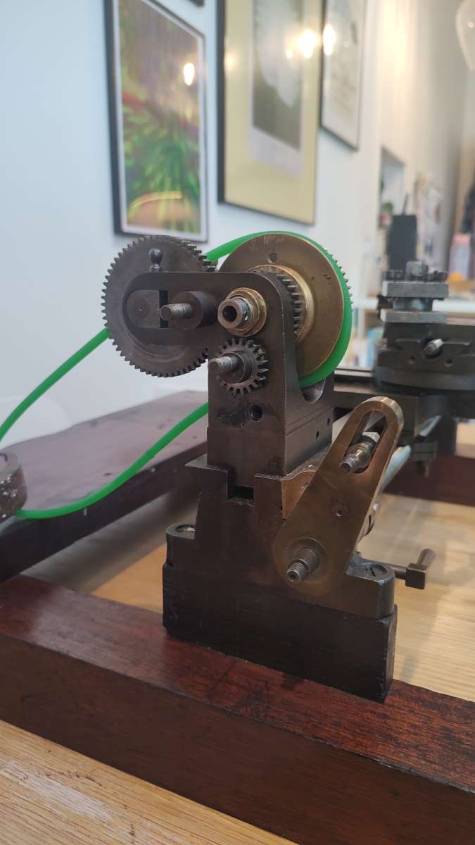

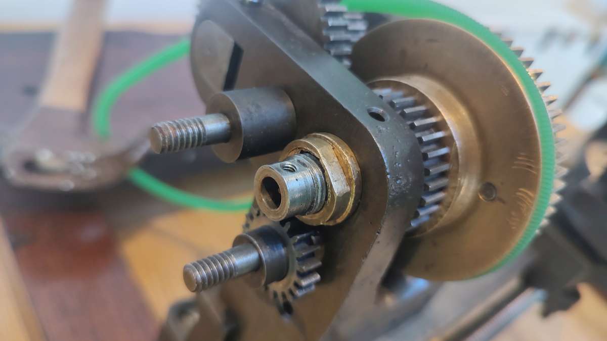

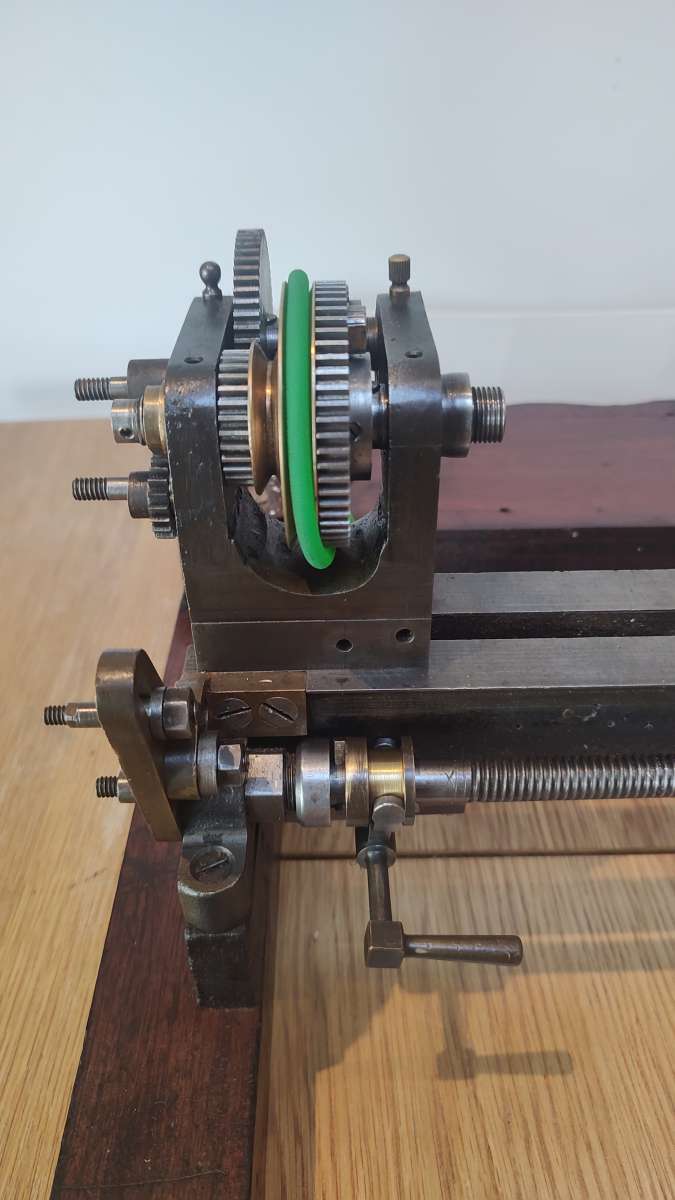

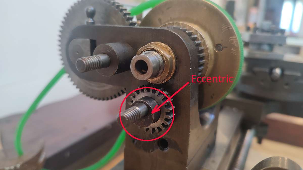

      The screwcutting arrangement throws up more questions. There is very little room there, and I suspect the maker intended only for a few specific pitches to be cut. It’s not clear how the maker intended you to key a gear onto it. Perhaps there was an insert that has gone missing over the years. On the other hand, the lead screw has a space for a key to be fixed in. It also has a very nicely made dog clutch. There are studs below the spindle that are fixed into the headstock, and also a couple of bushings (pictured), one with an eccentric hole. Perhaps this could have functioned as a simple means of engaging/disengaging a gear train. The only gear I found was a 20t dp24 wheel with a 1/2″ bore. This fits the bushings but not much else. All studs are 1/4″, the bushings are 1/2″ OD, but the keyed part of the leadscrew shaft is 3/8″(?)
      The lathe came with some accessories, although some have clearly gone missing. Two 4-jaw independent chucks, a drill chuck, a modest selection of tooling such as horizontal milling cutters and slitting saws…
      At risk of waffling on, I will submit my most obvious questions:
      1. Does anyone recognise the design, pattern, or maker in any way? I submitted it to Tony at lathes.co.uk and he suggested it might be from 1880-1900, perhaps an early Holmes, but I don’t see a great resemblance.
      2. Does anyone have any idea how the dovetail adjustment mechanism is supposed to work?
      3. Does anyone have any sense of whether the tailstock can be adjusted/offset, given the pictures below?
      4. Does anyone know of any reason why the main leadscrew would have been cut using a different thread form from the smaller leadscrews?
      5. Does anyone have any idea why the maker put so many fixed studs on the headstock rear, and why the bushings and shaft diameters are all over the place for the screwcutting drivetrain?

        What a little beauty! Certainly worth tidying up and using. Yes it has that look of turn of the century before things had become more standardised modern looking.
        The moveable dovetail like that was used on the Drummond M Type lathe in the early 20th Century, on the carriage, but had more conventional pusher screws and locking screws. Yours must have something more to it that perhaps only dismantling will reveal. The screw holes on the join line seems very odd. Is the thread intact in both pieces?

          Possibly the gib screws push the extra piece downwards pushing the slide up against the fixed part – odd but would tighten its reference position.
          The bed has a bit of similarity with the George Adams 2 1/2 |” of the same era.

            It is a lovely old thing, deserving a new lease of life!
            There are some neat functional aspects to it, as well. I like the back-gear arrangement, lead-screw clutch and dial, and additional mounting-holes in that vast expanse of flat top-slide. (The scriber marks are still visible!)
            I am impressed too by the apparent ability to set the top-slide through much more than the 45º the scale implies. This would provide cutting very shallow cones such as Vee-pulley groove flanks or pendulum-bob faces. A supplementary fiduciary mark would allow reading the scale at beyond that angle: is there one below the left-hand 20º point?
            The screws on the joint-plane…
            I wonder if the adjusting-screws on the top-slide work like the clamping-screws in modern ‘Taper-lok’ bushes? If so:
            – the half-hole in the main (upper) casting will carry its half of the female thread, likely tapped through into fresh air;
            – the half-hole in the gib block (with the dovetail) will be of close clearance radius, not tapped, and drilled blind.
            So when screwing the adjusters inwards, their threads will operate in the upper section, but their tips will push on the ends of the blind half-holes in the dovetail block.
            The swarf in the ointment of course, is that the three counter-sunk or (more likely) counter-bored screws don’t seem to have enough room for lateral movement, although they should not need much. So….
            Do they pass clear through short slots in the dovetail, to engage nuts, nut-strip or similar sunk into the block’s underside? Or is there in fact just enough clearance in the counter-bores?
            (I think this from having had to learn how to fit ‘Taper-loks’ properly. It took me some thinking to twig their principle!)
            There does not seem any formal set-over for the tailstock but it appears a two-piece body and the large central nut might be hiding a slot.
            The primary pinion for the change-wheels was likely driven by a grub-screw or set-screw bearing on the flat on the end of the spindle, as on the EW lathe, but I would not expect that tapped hole there.
            The builder might well have expected to cut only a limited range of pitches, perhaps Brass (26tpi) mainly, and the smaller BSW ones; though it’s surprising what range is possible even with only a two-stage train of wheels with a single tooth-count increment of 5. (As on my EW lathe.)
            The other bit that puzzles me is that eccentric stub-axle on the back of the headstock. Part of some form of tumbler-reverse gear?
            The triangular lead-screw thread is odd indeed. I can’t think why that. Looking at the rather battered screw slots the lathe has been dismantled and re-assembled a few times over the years. I wonder if it was an old, perhaps plain-turning machine that has been up-graded, perhaps with a mix of specially-made and salvaged parts. That might explain the inconsistent thread types and the rather miniscule dials.

              I would think the leadscrew was original as back gear usually indicates it was a screwcutting lathe originally and not a clockmakers’ machine. But who knows for sure what they did so long ago?
              One question: Are the threads on the cross and topslide screws a true Acme? Or are they square threads? Square threads were commonly used in that era. So perhaps the Acme screws were added later in the machine’s life to replace the original V threads matching the main leadscrew?

                [email protected] suggested 1880 to 1900 and it certainly has the look of a Victorian / early 20th century lathe.  One giveaway is machines of this period tend to be lightly built because carbon-steel tools couldn’t take the heavy cuts made possible by HSS.   20th Century machine tools are often noticeably more chunky.
                Victorian might also explain the slightly home-made look.  Built by fitting methods before the “American System of Manufacture” had caught on,  so well-made the old-fashioned way, not the product of tool-room jigs and fixtures.   Nicely done if it is DIY.
                Pity so much is missing.  There are clues:   fixed tail-stock, so not intended to turn tapers.   Moveable dovetail.  The giant top-slide with many mounting points suggests some sort of multiple tool-holder for repeat work.  The mandrel and tailstock are both high (large diameter work), and the change gear assembly is odd.

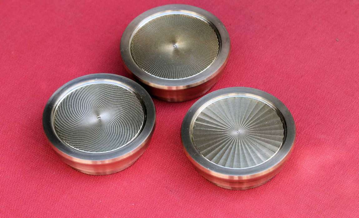

                Cedric suggests Ornamental turning, but I don’t think it’s elaborate enough for that.  I reckon he’s on the right track though!   My guess is it’s a basic engine turning lathe, used to beautify watch backs and other jewellery:
                engineturning
                Evidence!  In what’s left of the change-gear assembly, one of the gears turns an eccentric, and these are needed to generate wave patterns:
                oldlatheeccentric
                Basic engine turning might also explain why the lathe appears to be unworn.  Engine turning was often an optional extra, so maybe the lathe was rarely used.  Possibly sat in a jeweller’s workshop for decades, only fired up when the occasional customer wanted the full Monty.   Could also explain the simplicity of the banjo:  not many gear ratios needed because the lathe wasn’t used to cut threads, only needing the few ratios required to make patterns.   Engine turning varies in complexity, so the lathes can be simple or elaborate, depending on how fancy a pattern is wanted.

                  Or the eccentric, if it revolves, could drive a fine feed mechanism by means of pawl moving a gear or ratchet wheel one tooth per revolution.  I’ve seen pictures of such a set up on vintage lathes.
                  But does the eccentric rotate? Or is it stationary and used to adjust the position of the threaded stud sticking out of it?

                    .The giant top-slide with many mounting points suggests…..
                    … also mounting a Potts milling-spindle, or other such accessory, for engine-turning. Note there is also a small cylindrical register and two accompanying screw-holes in the centre of the top surface.

                    The pinion, eccentric and stud look a single piece; but Mike would be able to verify or correct that point.

                    The tailstock has a small, rounded-end, raised boss on its forward strut: what for? A part or serial-number? Or is it not a cast protrusion but part of a barrel lock?
                    The headstock’s front face has two holes surrounded by faint “shadows”, and a slightly larger hole on the rear face below the eccentric. What do these all hold? Was the rearward one for another gear stud?
                    The holes on the front still have their scriber-lines, too – and see below them, the bed’s planing-machine marks.
                    The upper part of the cross-slide has two (tapped?) holes below the top-slide screw. For a travelling steady? Odd to put that on the rotatable part, so I think something else. Perhaps part of a milling-spindle’s drive, which would have been via an auxiliary overhead line-shaft and pulleys from the lathe’s primary drive. Are there hints of any such on the rear of the bed – e.g. planed seatings and more tapped holes? (Sometimes such auxiliary drives were bolted to the bench instead, or even the workshop wall.)
                    Faint planing marks still on the bed at the headstock end: very little wear so either very little use or reconditioning! The slightly battered screw-slots do hint at the latter possibility.

                      And it’s only one of other possible reasons. The extra stud positions on the head stock might have been to produce what are known as long lead (pronounced leed) grooves or threads and even long lead multi start grooves or threads along a shaft. Some of that can be strictly for ornamental purposes, but its also done for some mechanical reasons as well. Any modern level wind fishing reel as one example where it might be used today. Again this all depends on what the lathe was intended for. But in case you don’t know, long leads like that would have never been possible under the usual spindle power even with a proper back gear. Geared that way, back driving the lathe spindle rotation with a very slow rotation of the lead screw hand crank would be done instead. Given the gear ratios involved, lathes other than a very few specialty designed one’s aren’t designed to handle the loads for thread pitches coarser than the lathes lead screw pitch.That drive could be done using only hand cranking, or some lathes had the ability to use power from a separate belt. Long before electric motors were invented, powered and belt driven longitudinal and cross feeds while a bit rare weren’t exactly unknown. Yours doesn’t have those pulleys mounted of course, but there’s no way to say they also weren’t another option. It’s also not impossible your lathe when new was intended to be powered using a foot treadle drive like old sewing machines were. I think that might be much more likely than not.

                      With that head stock design there’s no shimming or what would be thought of as a more conventional type of adjustment design for the spindle to bearing clearance. That is a bit strange. If it isn’t home made? Then I’d bet the spindle cone is extremely hard and the same for what might be separate hardened cast iron sleeve bearings. The only real adjustment is that end play nut that also pulls the spindle cone into the bearing cone to take up any wear. And with what appears to be open oiling ports in the head stock, If it were me, I’d think about removing the spindle for what I’d bet is a long overdue cleaning and check for any scoring on the spindle cone and bearings. Kept clean and adequately oiled, it’s a good proven design, if there not, they can be a tough and expensive to repair design. Some lathes like a few of the least expensive and earlier South Bend lathes used a very hard spindle cone, but running in just the soft cast iron the head stock was cast from. Those are really involved and without the right equipment, expensive to repair.
                      I also suspect the knob on that lead screw hand crank is original and the others made of brass were one or more previous owners additions since they don’t seem to match each other in length or proper shape. Almost for sure the 4 way tool post was something home made as well. Those parts and added tapped holes do give it an air of something home made, but what’s there and what seem to be the original parts indicate to me it was more probable something commercially made.
