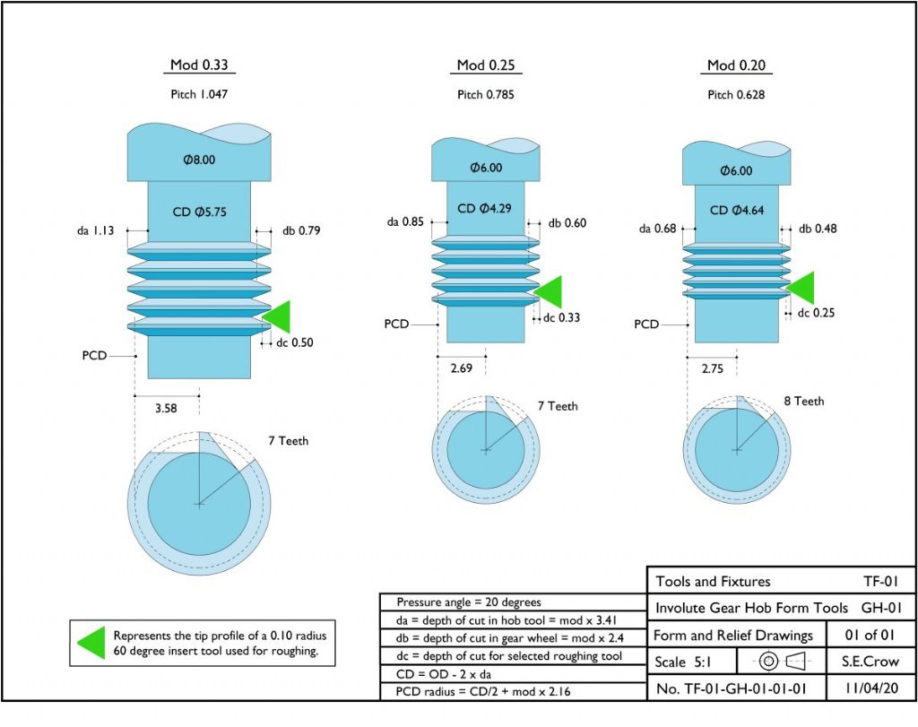

      I intend to make a number of small gear forming hobs as described on the Helicron site and discussed here before.
      I milled an insert type 40 degree cutting tool from GFS, hardened, tempered and sharpened it with a crocker jig and an arkansas stone. I can't see any tip radius under 12x magnification.
      I realise that it won't stay like that for long but I will only need the sharpness for indexing for depth of cut once on the first hob. After that it is indexed for subsequent hobs.
      To prolong tool life further, I intend to rough out the grooves as much as possilble using a 0.1 mm radius tip threading insert I have.
      I want try to do three hobs, starting with the smallest mod where things are more critical.
      I've attached some drawings. Please have a look at the relief forms and let me know if you think that they will work.
      I look forward to any comments.

              In the drawings that you have shown the cutters have no relief at all and
              this will only make for difficult cutting and make quite poor gears
              as can be seen from the information in the previous post by Dave S,
              https://forum.tz-uk.com/showthread.php?458479-One-step-closer.
              To do these you really need to make cutters with form relief.
              In Ivan Law's book Gears and gear cutting there is the
              Eureka device for doing just this ,also in MEW issue 57
              an article for a form relieving device By Dr Giles Parkes .

                My cutter has no relief. Not sure if John thinks it does, or if he thinks my gears are poor.
                However the cutter works fine and the gears, from 12 tooth to 144 tooth all mesh and roll together in all combinations.
                Cutters with relief are certainly more correct, but with care and a little sympathy during machining you can "get away" without.
                Whether my clock will run efficiently remains to be seen.

                  The form relief and clearance angles on all cutting tools
                  is essential if good work is to be produced.The OP had
                  asked the question.
                  "I've attached some drawings. Please have a look at the relief forms
                  I look forward to any comments."
                  The answer i think was clear enough there is none and the
                  cutting action is poor.

                    On Thor Hansen's web site he details a way to make gear cutters with clearance **LINK**
                    As it is a cutter he can use an eccentric mandrel, but for your cutters you could make a tubular sleeve with locking screws. Mount the sleeve in your chuck so it is off center, then follow the method above, but using your form tool.
                    You could either use 4 locking screws with one flat on your cutter shank, or use one screw and 4 flats on the cutter shank.
                    You will also need to ensure the cutter blank is the correct depth in the sleeve, so either make the sleeve blind, or use a center in your tailstock.
                    An advantage of this shaped cutter over your circular design is that it can be sharpened without reducing the tooth depth.

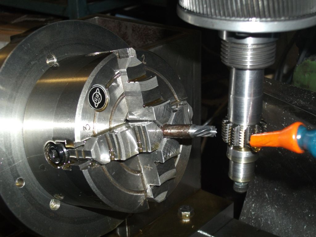

                      This hob is made that way except (1) I took the cuts slightly past the centre line to give some slight back rake to the cutting edge and (2) flied slight relief in the back of the top of the teeth but not right to the cutting edge.
                      Cut dozens of brass gears with no problems and just a very ocassional rub over the cutting edge with a diamond slip.

                          It seems to me that combining the single point cutter forming the hob with the techniques shown in this thread
                          Non circular boring
                          would allow a lobed cutter to be produced so that when the teeth gullets are formed clearance would be correct for good cutting. I don't have a spindle encoder (just a single point indexer on my lathe) so I can't do an example but someone else may be able to do some work towards this.

                              In theory this method should work in a similar manner to a Sunderland gear planer. The biggest difference is that the method indexes one tooth at a time. Whereas a Sunderland gear planer moves the cutter, and rotates the blank, by a small fraction of a tooth per cut. So the planer creates many more facets per tooth. Of course on the planer the cutter has to be set back a known amount every so often. One tooth space would be logical.
                              The method as described should work better on larger gears, as the involute has less curvature and the teeth are in contact with the cutter over more index steps. This seems to be borne out by the linked to pages.The smaller gears look very odd with lopsided teeth, unevenly spaced, whereas the larger gears seem better. The meshing of large and small gears seems odd too.This is the sort of meshing I'd expect to achieve, a thou or two backlash, albeit for larger 16DP gears:
                              If I was going to use this method I'd make the top of each tooth much shorter and add relief with a file before hardening. That was done on this worm wheel free hob and it seemed to cut well:
                              Note that the teeth are on a helix although the flutes are straight. I'd also make the hob as large as possible with no reduced shank.That just reduces rigidity.
                              It would be interesting to see some close up shots of the teeth and meshing on the gears by Neil.

                                            Thank you all for you replies and information. Just a couple of points.
                                            I understand that this is not the ideal method for gear cutting but it's my only chance of making the gears I require. With mod 0.20 or 0.25 a single point cutter of any description is going to be tricky to make to an accuracy to improve on the hob forming method.
                                            Also, the "relief" on the drawings aren't the finished profile, just a guide for milling. I intended to go past the centre for rake and get the files out for relief.
                                            I have a CNC dividing head so I have given thought to going round more than once and adjusting tool height but with teeth this small accuracy would be paramount. I have got a DTI mounted to Z axis so I might get away with it.
                                            I've made the blanks and rough grooved them with a threading insert. I just need to finish the grooves with my home made 40 degree insert.
