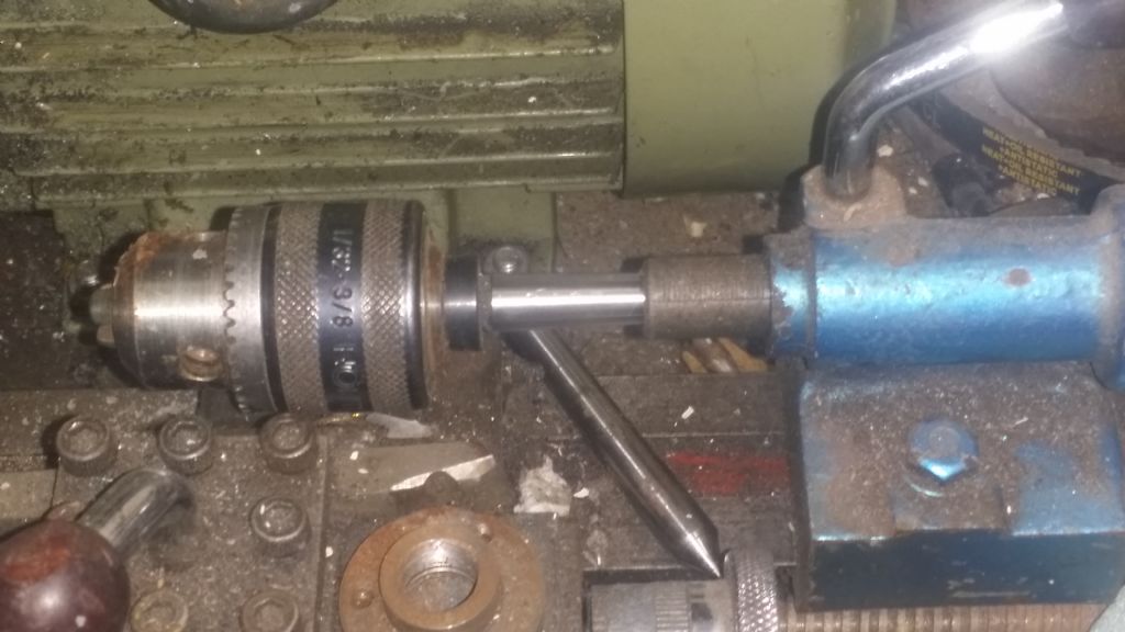

      Can anyone advise on what weight oil I should be using for the bearings on a Flexispeed lathe please
      I'm guessing they are plain bronze bearings….has anyone replaced them? How and any advise on sizes please.
      I've been trying to find a MT0 drill arbor and sourced one via eBay but it sits so far out it ends with a lot of play. Has anyone got shots of their tailstock set up with a drill arbor please.

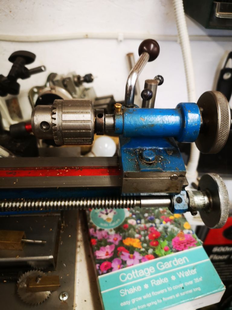

                James A
                  @jamesalford67616
                  Does this help?
                  James.

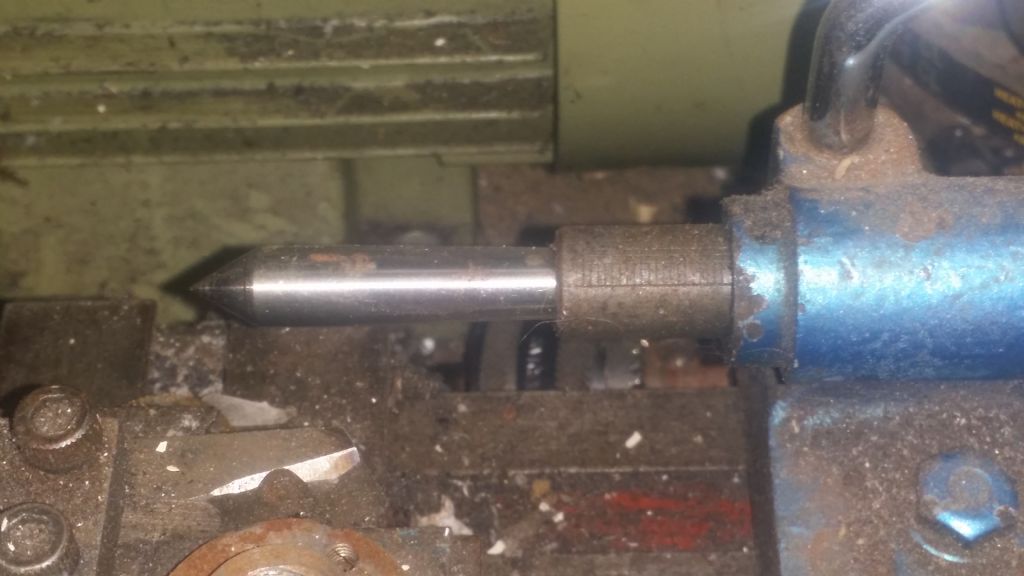

                            20211219_163007.jpgMany thanks to everyone for their advice and knowledge. Please excuse the state of the lathe – frankly it had been buried as I was so disillusioned with the accuracy I could achieve given the tailstock taper problems. I will certainly investigate the heavier oils as the main front bearing drains very quickly (admittedly using engine oil!). The arbor is a real problem and will investigate Cowells. I have attached 2 pictures showing the problems as so accurately described in the replies. The arbor uses the first half on lt – to about 7mm diameter – so half sticking out on a normal MT0. Once again many thanks for your help and knowledge. 20211219_162934.jpg

                              So Cowells are pretty useless. No catalogue, no online specification just a price. Tried emailing them but no reply….are they still in business or is it just a dead website. Anyway was considering ordering a few specially made but then I wonder just how much one could ream out the existing tailstock fitting using a hand MT0 reamer – has anyone tried this? If I could deepen the MT0 taper it would allow access to normal MT0 fittings.
                              #576303
                              noel shelley
                                @noelshelley55608
                                An MT reamer is only good for cleaning up a taper, it will struggle to remove any amount of metal. As for oiling, SAE 10 or ISO32, 2 specs but one oil, hydraulic or light engine oil, NOT a multigrade, as recommended by myford ! Happy Christmas, Noel.

                                    I started down this route on my Flexispeed at one point. I bought a tailstock arbour from Peatol Tools to replace the entire arbour in the Flexispeed tailstock. They are both the same outside diameter and the Peatol part fits the Flexispeed snugly. It cost very little, has a dead centre turned ground on the end and a thread for a standard drill chuck. I never completed it, simply because I managed to cure the problem that I had had with the original taper arbour. However, it might be cheaper that a Cowells part.

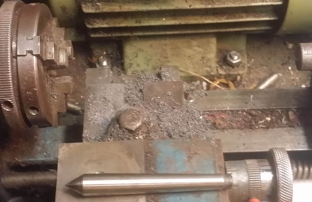

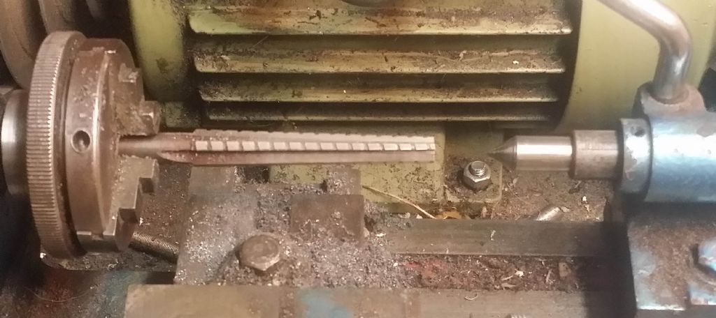

                                      So thought I would update on the problem of the Flexispeed tailstock half MT0 taper. Unfortunately the owner of the Peatol lathe which was suggested may fir has wound down his activities – all power to the retirement. With little alternative I bought a set of MT0 hand reamers from China but have been pleasantly surprised by their accuracy and the way their edges have stayed bright. The pair of reamers cost just £10.88 including shipping. I placed the rough cut reamer in the chuck and used the tailstock handwheel to advance the shaft while hand turning the chuck. I took some 5 hours spread over weeks. Having managed to angle grind my wrist in the summer there is a limit to how much it can take at each session. I now have a tailstock that accepts MT0 and you can see from comparing the pictures just how much of a full MT0 taper sits in. The only obstacle is down the tailstock shaft there is small area that needs to be drilled to increase the depth. I hope this helps others tackle this annoyance with the Flexispeed. First picture shows the reamer and the second is to show the full length of the centre.
                                      Now its useable Ill have to give it a good clean. You can see the plie of chippings from the reaming. Its set up with a small 3 phase motor and phase converter giving a wide speed range.
