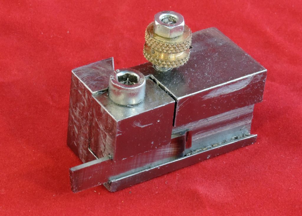

          Most of these toolholders are designed to work with parallel sided blades. Rather than Graham's tool being badly designed, I think it was supplied with the wrong blade, presumably the same supplier for yours too.
          I have two bought parting toolholders with vertical slots and one I made myself, all of which are used with parallel blades and work very well, thank you.
          It's a myth that parallel parting blades will jam – but they must be held vertically.
          Edit: home made holder for parallel blade:
          Edited By Neil Wyatt on 21/09/2018 21:53:50
          Edited By Neil Wyatt on 21/09/2018 21:54:53
