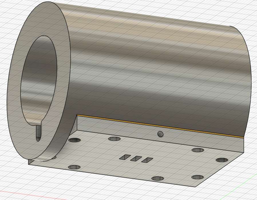

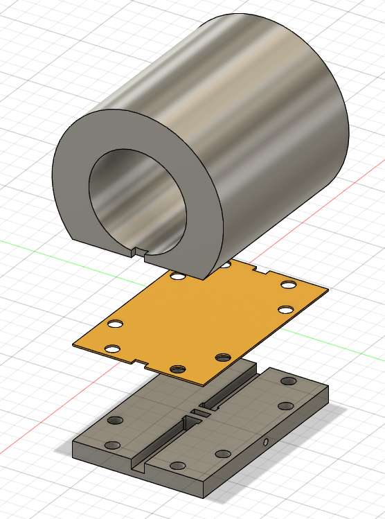

      I’m not sure whether this question would be better suited to here, or one of the steam engine forums, but as I am a complete beginner I guess here is a good place to start.
      I am currently thinking about how to build a small stationary steam engine model (half inch piston diameter sort of size), and was thinking about ways to construct the cylinder that doesn’t require lots of machining from a single large piece of stock or from a casting. I have come up with a couple of possible ways of constructing it from a couple of pieces of smaller stock, and am wondering what the shortcoming/limitations of these methods might be as they don’t appear to be commonly (or at all) used.
      My first thought was to bore the cylinder channel through the centre of a piece of round stock, mill one side flat and then attach a flat block (the cylinder base) to the milled face with the steam inlet and exhaust channels already milled in it, as shown below (with a gasket between them in yellow).
      Screenshot (10)
      Here I am assuming that there are bolts (studs?) that screw into round stock to which the cylinder base, steam chest and steam chest cover are attached. Also note here that I haven’t given any consideration to dimensions yet (inner/outer dimensions, bolt holes, steam channel sizes etc).
      Are there any immediate issues with this approach? One thing I feel might be an issue would be that the cylinder heads (and gasket) would be sealing across multiple parts (including another gasket).
      To solve this, I thought of instead not milling the entire cylinder flat, but instead leaving say a few mm at the outer diameter to provide a solid face to which the cylinder heads can seal against, as shown below (only shown on one end). The cylinder base piece could be extended in height so the cylinder heads didn’t overhang. Screenshot (13)
      However another immediate issue I see here is that now the steam inlets to the cylinder would come out of the sides of the base, and as these can’t be bolted together I doubt there would be a good way to get a decent seal. I suppose I could bore the inlets in the cylinder such that they still meet top of the cylinder base (where the gasket is) but this seems a bit fiddly.
      So this leads me to my current idea – mill the cylinder as above, and instead bond the cylinder base to the milled face to effectively create a block similar in shape to a casting, which can then be bored, drilled, have the steam channels/exhaust put in in the same way. Are there any issues with this approach?

      #842647
        I have done several like that usually silver soldering the two parts together though JB Weld also works well.
        Regarding the steam passages you can either do the milling in the plate and then just notch the inner edge of the bore so it connects or nots and drill vertically. The other option is to not do the milling and simply drill in from each end to form th epassage, at that size 2mm hole swill do and a connecting notch.
        lastly at what is probably not going to be much more than 25mm cube or piece of bar to start with the whole thing is quite easily done on the mill forming the rounded outer and valve chest sides.
        I’ll post some photos in a while or just look through the Stationary engine section of the forum at some of my build threads.

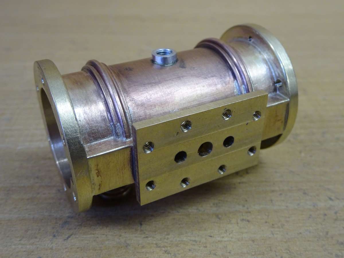

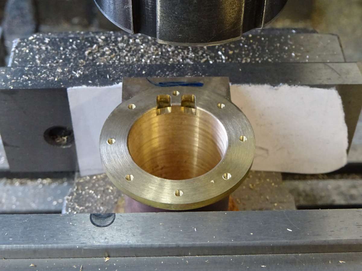

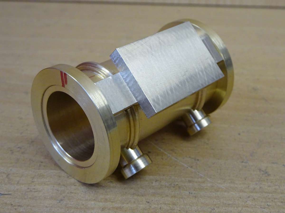

          A few examples.
          This one is a bit larger at 28 or 30mm bore, the cylinder was turned to leave flanges at the end and then the flat milled
          20250123_134216

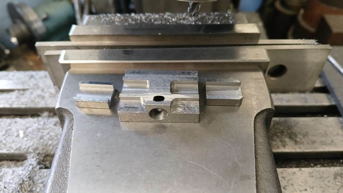

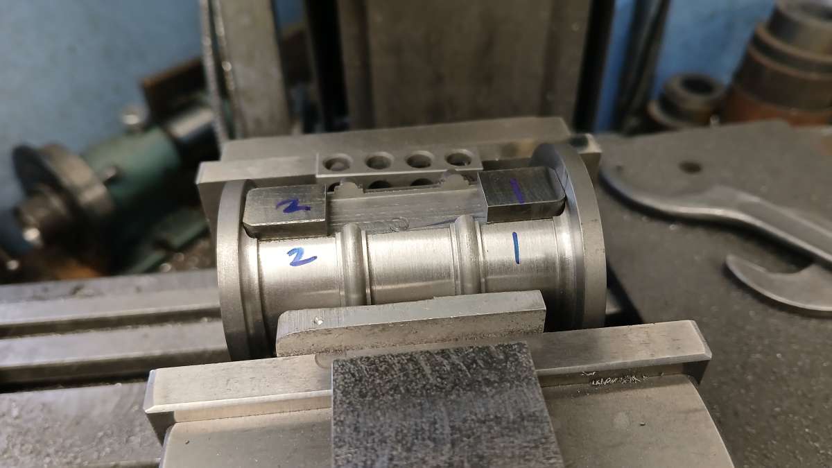

          As I did not want such a long port face I used two smaller bits at the end and a larger central one, milled much like your sketch
          20250124_134229
          After the JB Weld set the ports were milled and the final notches added to the ends
          20250126_134243

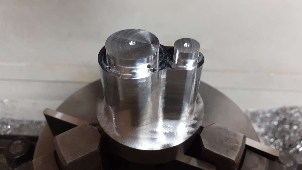

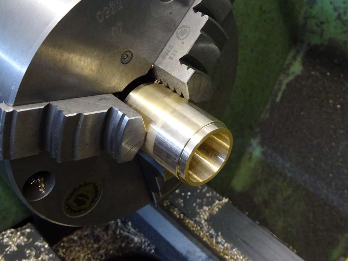

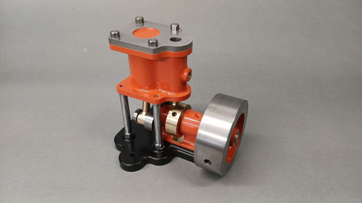

          Similar 24mm bore, this time the two end flanges were added to spigots and I silver soldered this one but JBW would do
          Photo 4
          Port block milled
          Photo 6
          Ends and feet added
          Photo 8

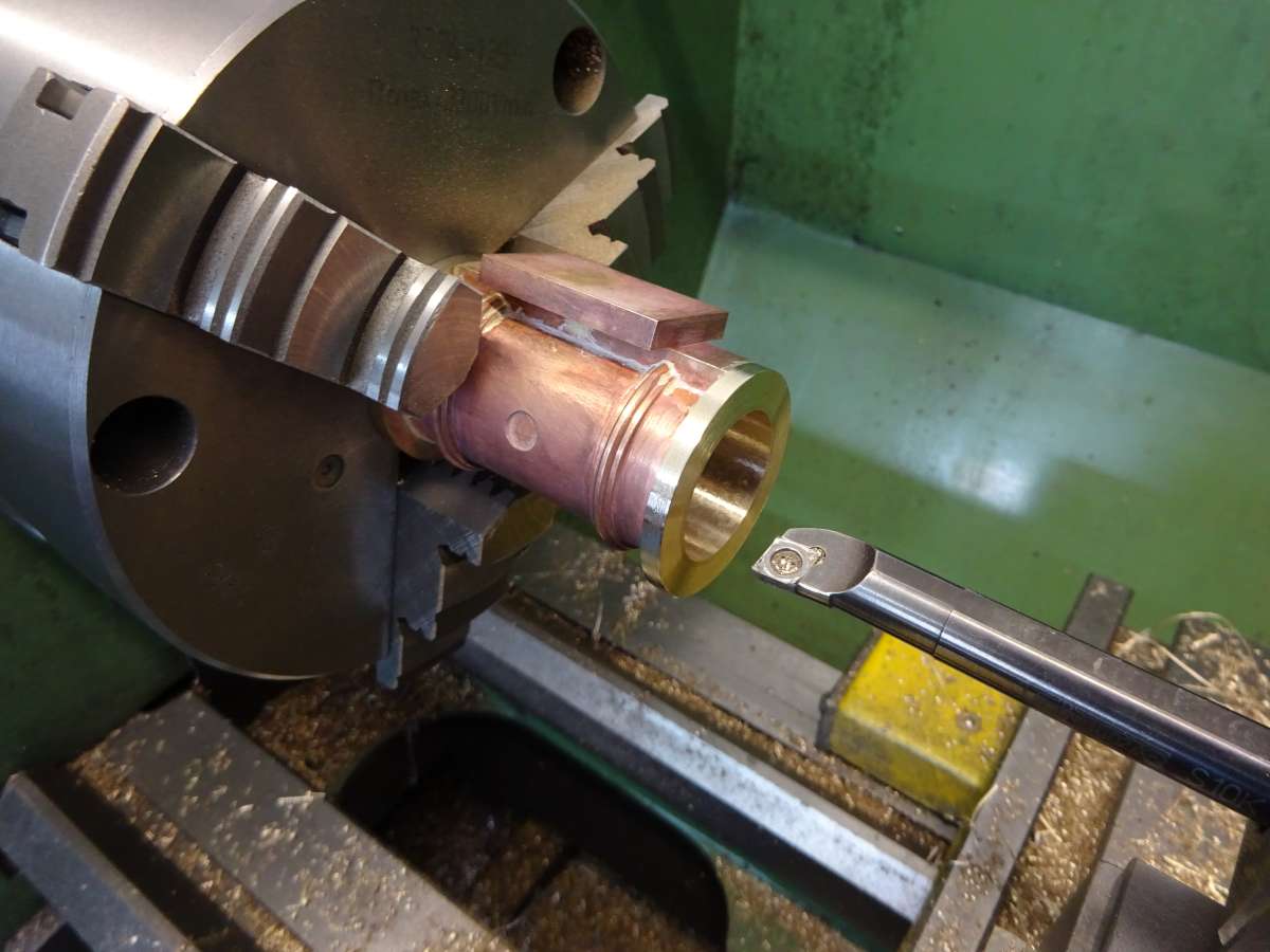

          If silver soldering leave the bore say 2mm undersize and allow some extra length to th ecylinder then once soldered treat much like a casting and finish the bore and face to length. Also a good thing to do with a JBW job as you may not get parts dead level with each other due to trapped JBW in the joints.
          Photo 10
          Finished cylinder
          Photo 14

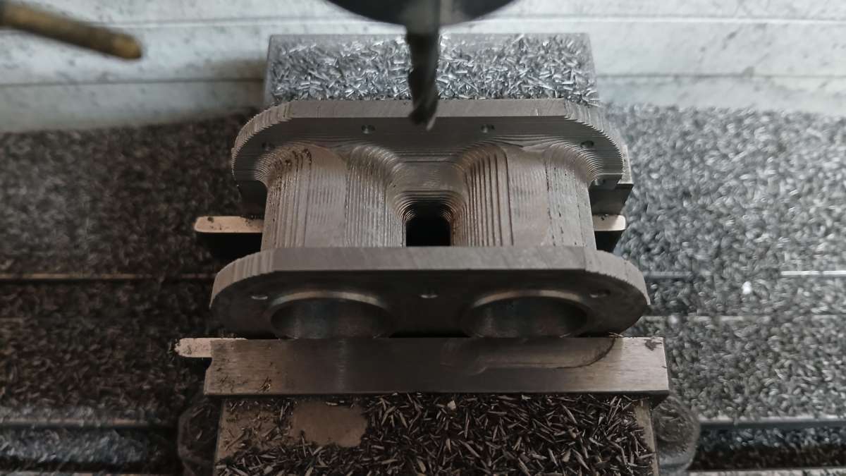

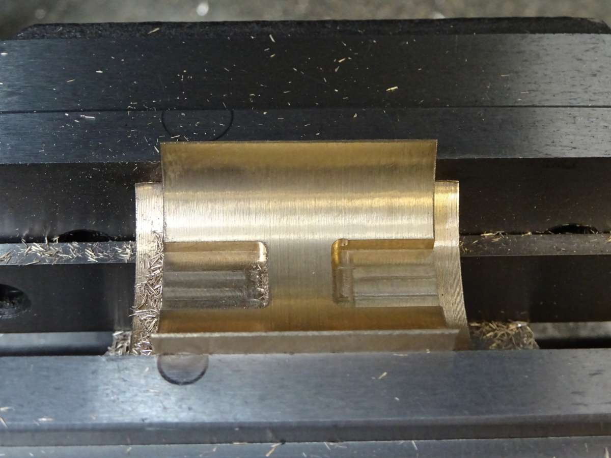

          Another option is to leave the cylinder round and cut a curve on the port block
          DSC02575
          DSC02578
          DSC02584
          More to follow

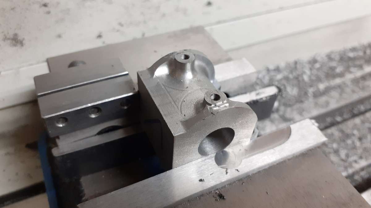

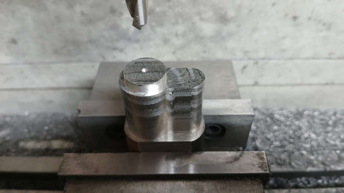

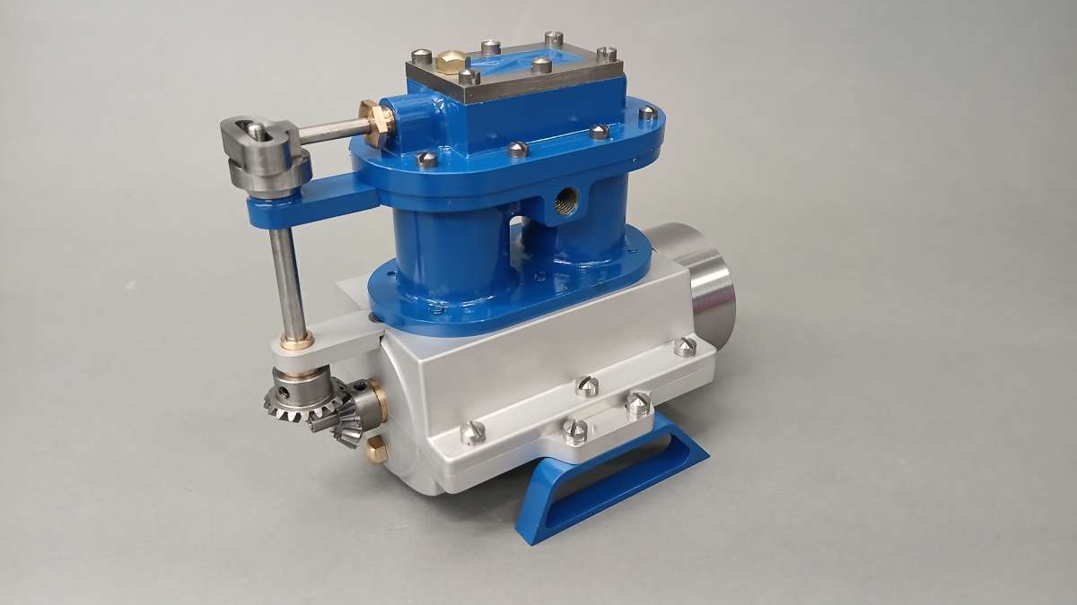

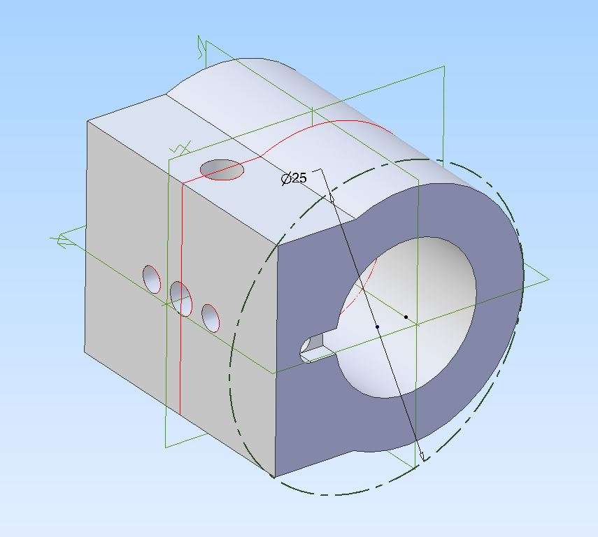

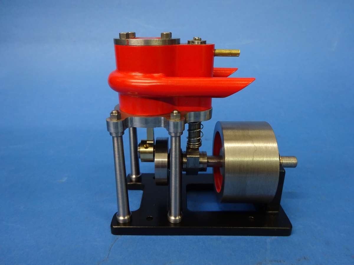

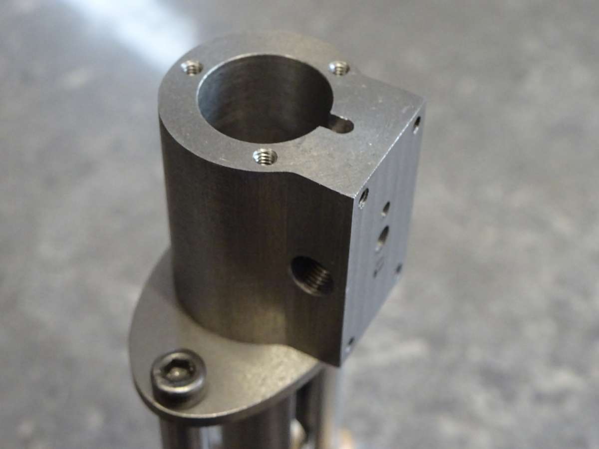

          #842653

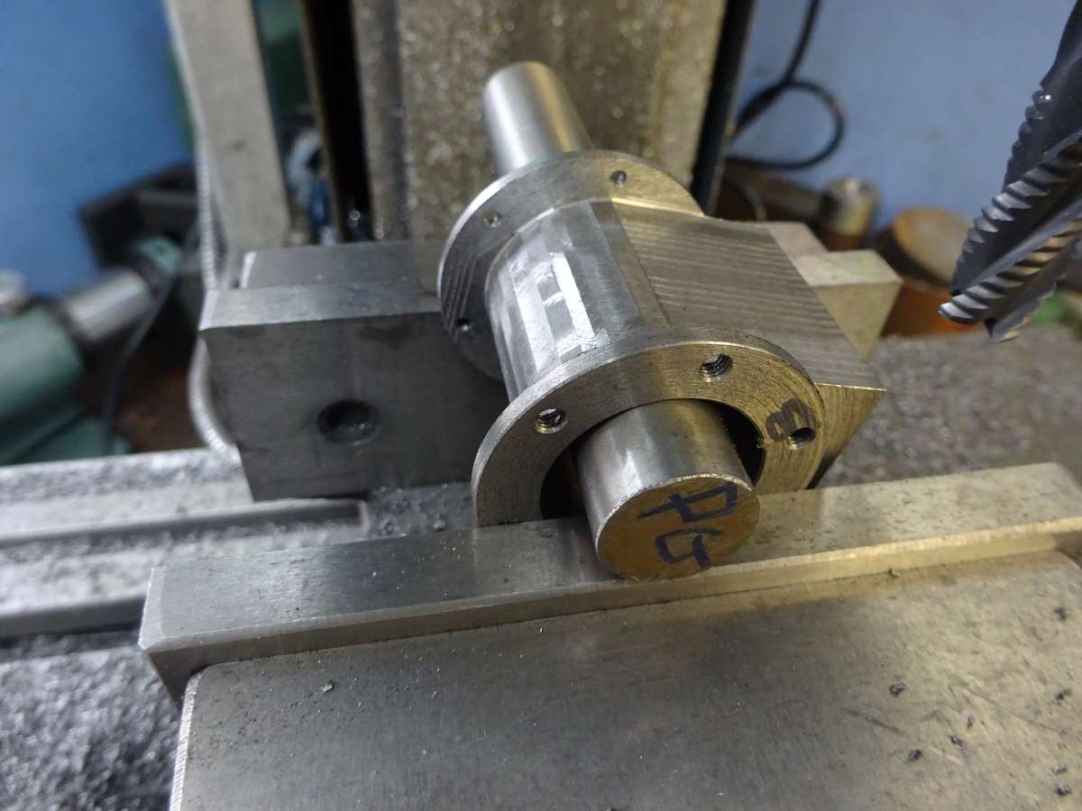

            On the smaller engine of 10 to 16mm bore I often cut from solid. You can just squeeze a 12mm bore one from 25mm or better still 1″ bar.
            25 bar
            The trick is to place the cylinder bore off centre of the bar which gives you enough to form the port face
            See a detailed description part way down this page

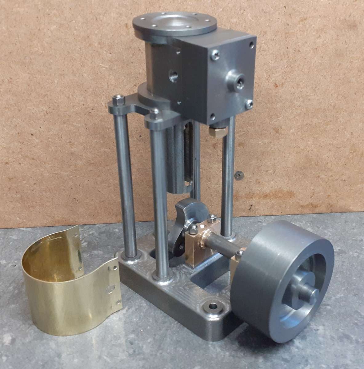

            Building the V-Twin “Kelsey”
            Other engines done in a similar way
            DSC04309
            20211227_141449
            Photo 28

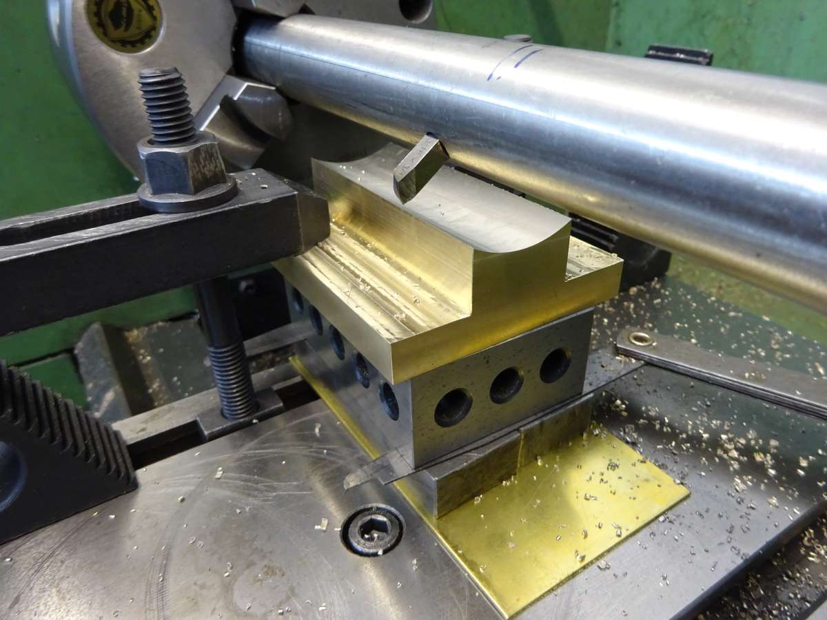

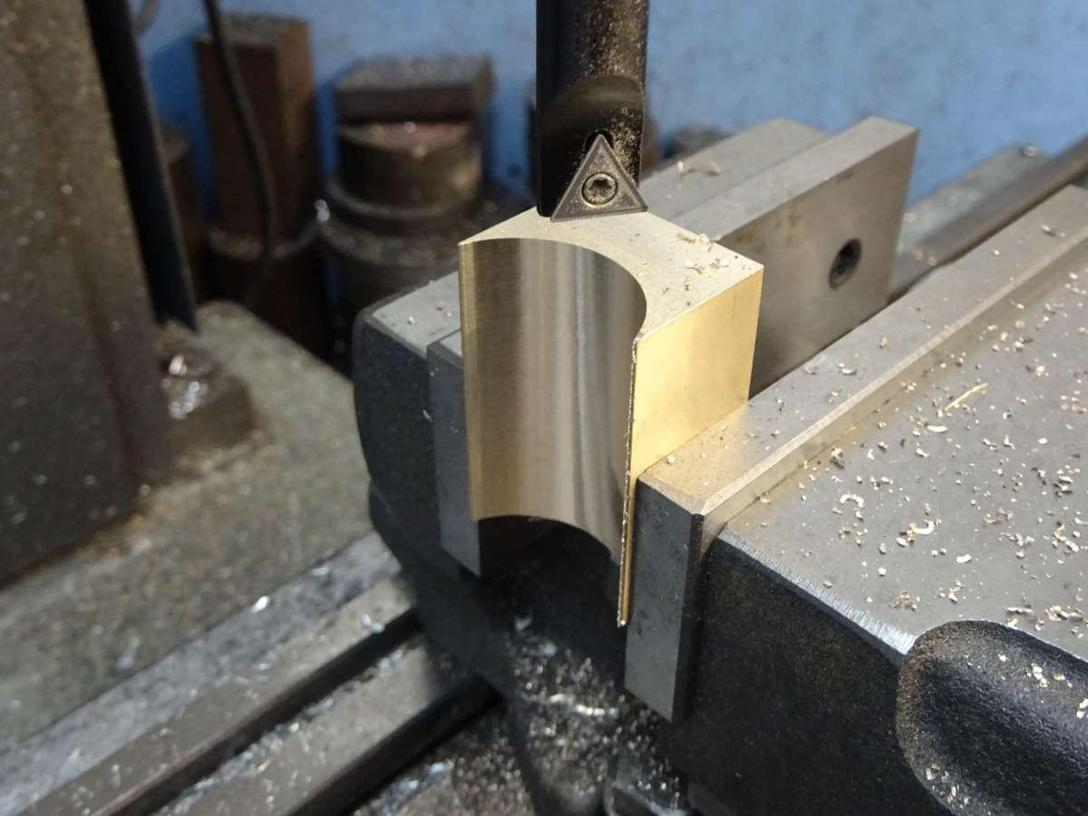

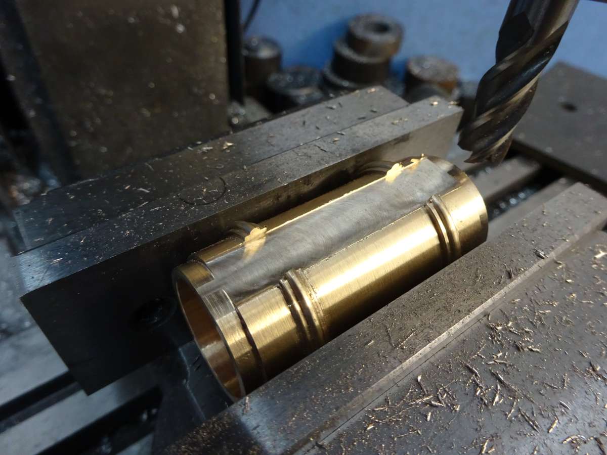

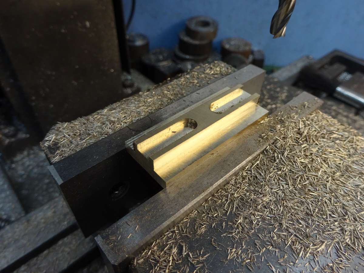

              #842690

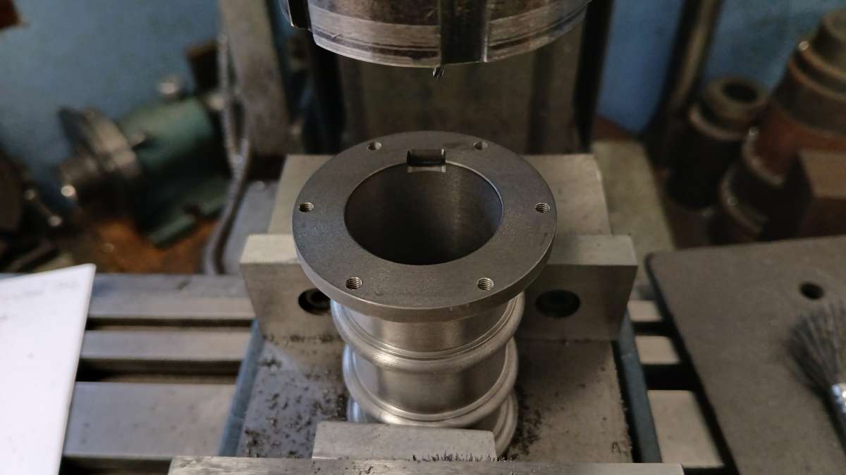

                There are a couple of ways the concave surfaces can be done. A between ctrs boring bar certainly works but may be a bit spindly for such a small cylinder. Another way is to make plunging cuts with a boring head in the lathe or mill. This is best suite dto plain cylinders, the flat method works for them too but is better if you have any decorative beads around the cylinder.
                Tid112
                DSC02576
                If they ar egrey then yes I’m using cast iron which are also the ones I tend to join with JBWeld as it is not so easy to silver solder. The others I use a mix of bronze and/or brass so you may see the turned cylinder and port block done in bronze with the end flanges in brass.
