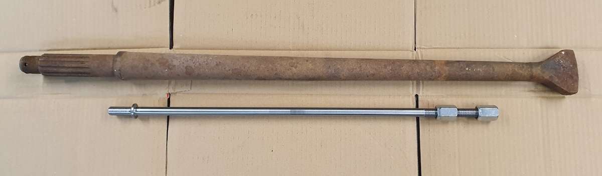

      Firstly I found the drawbar itself inside a drive shaft from a VW beetle, I have quite a few as a mate gave me 7 or 8 from projects he had been doing (beach buggy things).

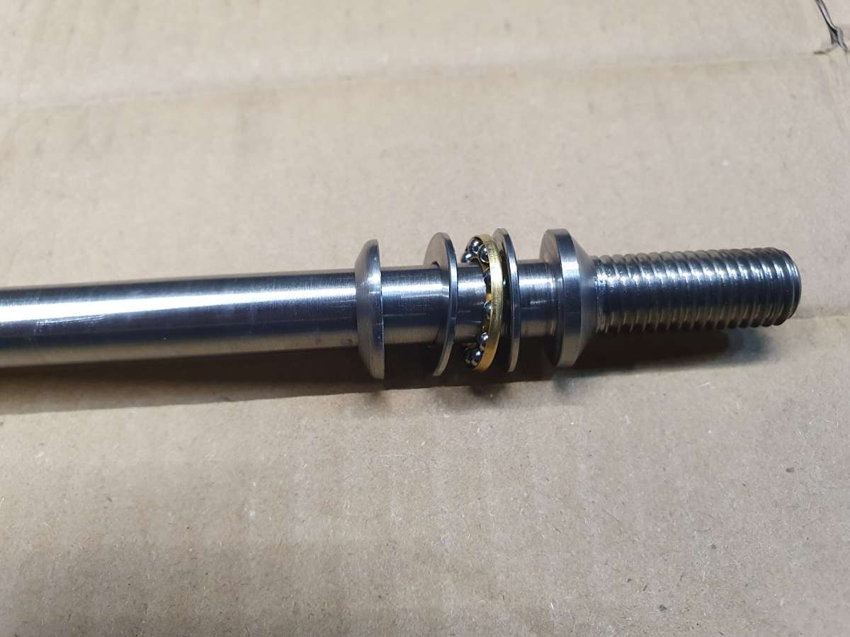

      It’s 12mm, M12 threaded both ends with an integrated thrust bearing seat.

      The thrust bearing set up on the shaft with a shouldered washer on top of it to locate with a suitably machined seat in the spindle.

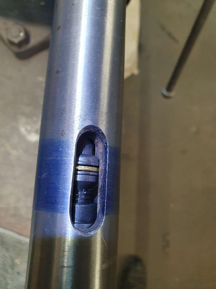

      This is looking through the slot in the spindle, with a collet holder inserted (the spindle taper is MT3) with the drawbar in the tightened position – thread drawbar into the tool holder until it seats then back it off ja thread or 2 to keep the drawbar loose so no restriction from it when pushing the tool holder into the taper.

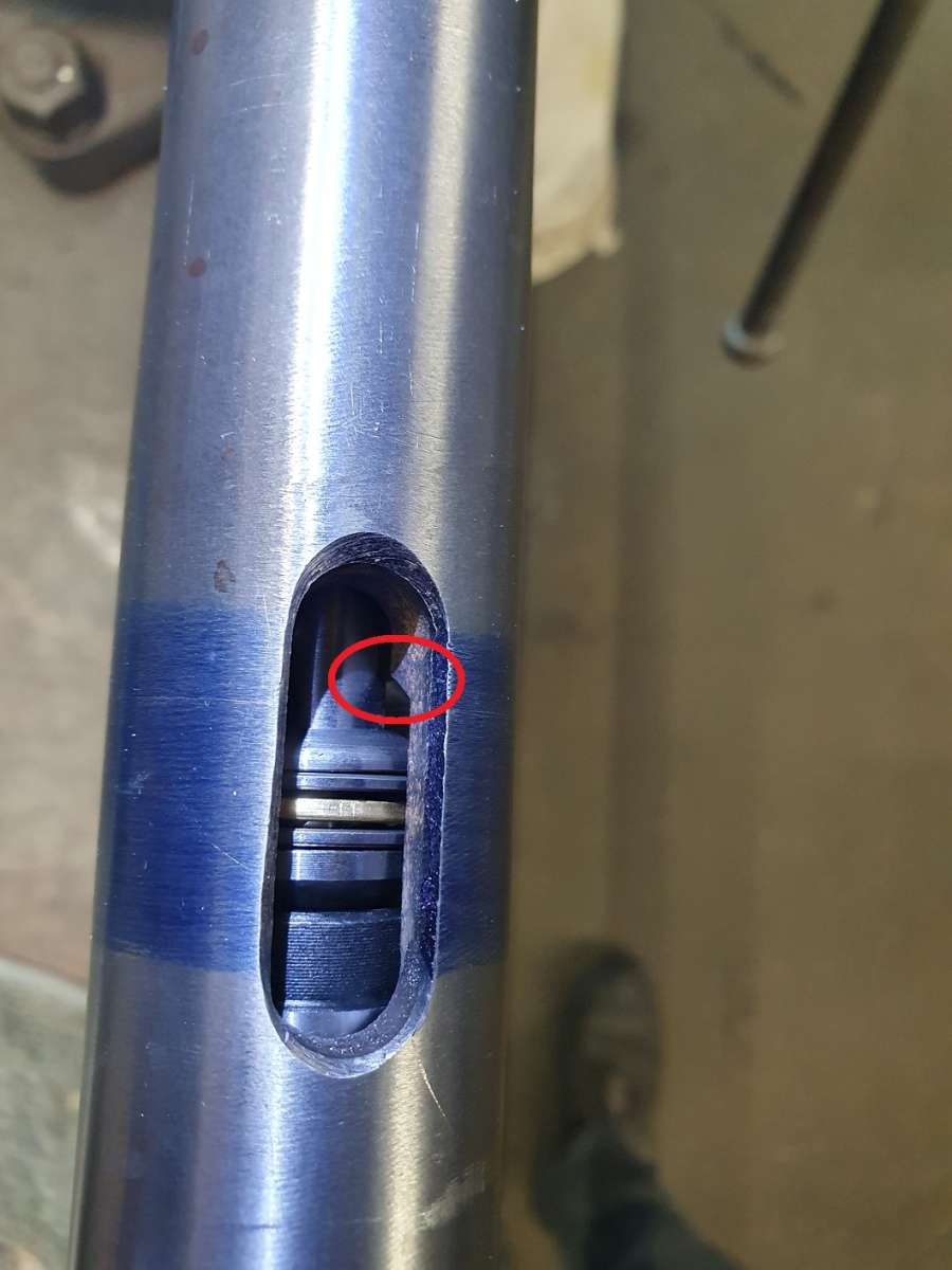

      I’ve circled the seat in the spindle where the thrust washer stack will land when extracting the tool holder.
      Captive_DB_2
      This pic is with the drawbar being undone until the thrust bearing lands on the spindle seat prior to popping the tool holder out.

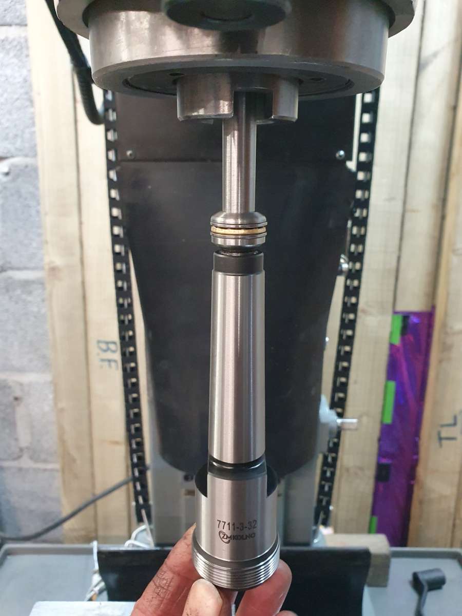

      Here is a pic just showing the set up on a toolholder (ER32 collet holder in this case).
      Captive_DB_4
      And, if you can cope with the ugly mug here is a short video of it in action. No spindle lock, just bottom gear on the head and a short sharp snatch on the tightening spanner I found to be more than enough tension on it, with a normal drawbar that took some clouting to remove! But as you’ll see removal is really easy and no hitting through bearings.

                  As for the shaft, the centre drill in the webbed end was great for support as long as you mark the point where the web harness (just think diamond and your not far off) merges into the shaft (decent material) it is lovely to machine, leaves a great surface finish etc but traveling steady a must!
                  I have to admit to catching the webbed end of the shaft – not the web itself, just the shaft twice, which resulted in an immediately exploding WNMG insert 🙄🤦‍♂️ the only thing I could mark it with was a grinder.
                  I seem to remember there were a cup full of chips or 2.. it was free, I have several and it was decent material for repeated threading into hardened tool holders so seemed the perfect choice.
                  Bazyle,
                  I’ll have a hunt through the old pics and the original thread and find what I can re boring out the rough bit of spindle.
                  Essentially I set the compound angle to the same as I used for the washer tapered face and used a small boring bar with a ridiculous amount of stick out to take lots of really light cuts in the spindle bore so it was cleaned up enough for the thrust bearing assembly which was just removing lumps and bumps mostly apart from the last 2 or 3 mm which made it perfect to cut the seat with the compound to get a matched angle.
                  I tried to radius the outer corner (to match the washer) so as not leave any sharp internals and did manage just about, it’s not much as you can see but there is a radius there so happy enough. It was quite difficult as you can only see where you are through the slots as they come round – it was like working in a night club with a strobe going 😬😂
