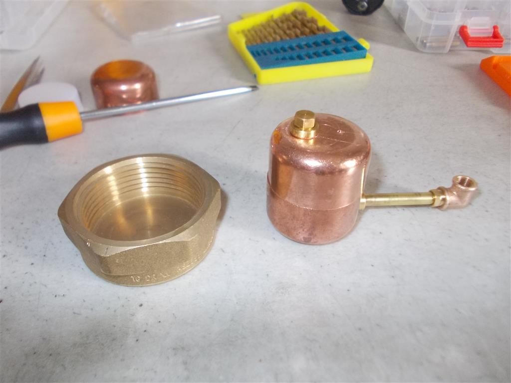

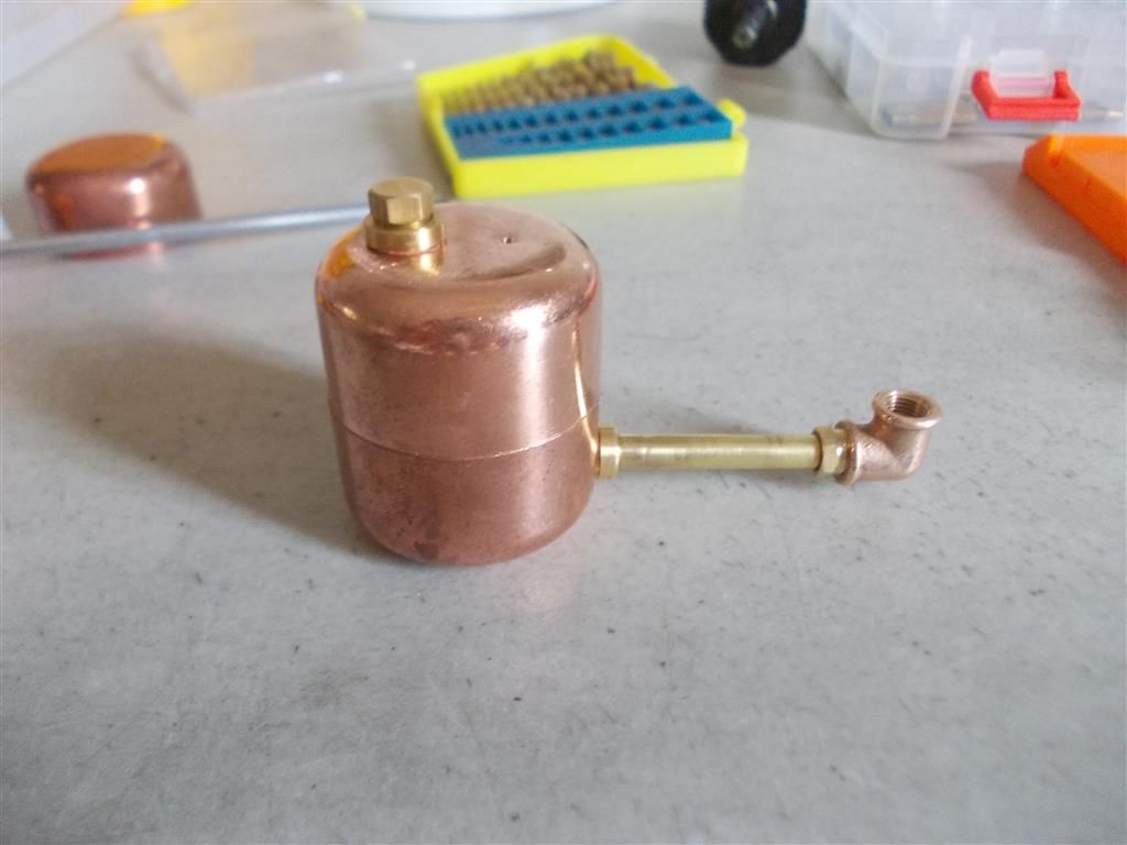

              #174378
              Brian John
                @brianjohn93961
                This morning I did all the drilling and tapping. Nothing is soldered yet but you can see what it should look like. To the left in the second photo there is a large brass end cap. When the other fittings arrive from the US then I will use two of these large brass end caps soldered together to build a bigger burner with two wicks.
                The copper burner will take 20mls of methylated spirits and the brass burner will take 40mls but should burn at twice the rate. Yes, I know the metho should run out before the water runs dry in the boiler but these burners are for a bigger boiler I am building.
                Does anybody in the UK sell those pipe fittings ? The US postage is getting very expensive even for small items.
                Edited By Brian John on 02/01/2015 03:50:23

                  #174382
                    Forrest Classics are PM Research dealers so they keep some of their fittings. I also posted a link to EJ Winter in teh insulation thread they keep some of teh fittings and being in Oz the postage should be reasonable.
                    You will need to have the open end of teh burner at the top level of the liquid in the tank if it is not to drain out so that will want extending if you are going to take advantage of the larger tank capacity. A larger dia at the burner end will also help give more heat due to teh larger flame.
                    J

                    Brian John
                      @brianjohn93961
                      Yes, I can see now that this design will not work as it is too high. The column of fluid will push it out of the burner end. I tried filling it with water and that is just what happens.
                      #174385
                        You could solder a flat disc onto one of the brass threaded caps, would give you the same 20mls capacity but half the height. Or if you can get some larger dia tube just cut a ring and solder on top & bottom plates

                          pgk pgk
                            @pgkpgk17461
                            Is there any particular reason you're making this out of copper/brass apart from aesthetics? As far as this newbie knows a spirit burner is just a fuel reservoir with a wick and possibly a wick height adjustment. Any design must depend on how hot is gets inside your burner enclosure and if memory serves you had the boiler up on high stands with good ventilation underneath so the eat is unlikely to go down to the fuel reservoir if you built something simple with the flame on top. As a kiddie i made some just using a low tobacco tin with a rope wick out of a tube out of the lid – unscrew to fill.
                            If you have enough space for the fuel reservoir under your stand then it'd be nice to get some temperature measure under there. These sorts of things are cheap enough http://www.maplin.co.uk/p/infrared-thermometer-with-laser-targeting-n92fx although their accuracy depends on the colour and reflectance of a surface. If the temp is a low as I'd expect then your material choices get wider.. ally, glass, old cans etc

                            Ian S C
                              @iansc
                              You need a vertical tube for a wick tube that is a fraction higher than the fuel level in the tank.
                              Ideally the horizontal tube would be steel or stainless to reduce heat conduction, if you get too much heat transferred to the tank, don't be surprised if you get a jet of flame from the breather hole. Your horizontal tube is about right, it will need a wick that goes from a length coiled in the bottom of the tank, along to under the vertical wick.
                              For my hot air engines, I usually refuel with an eye dropper, 5 to 10 drops per run, but you can get a plastic syringe from the chemist for feeding medicine to the baby etc, not sure whether they are 5 cc, or 10 cc.

                              Bazyle
                                @bazyle
                                Ingenious use of copper end cap but I'm struggling to get a sense of scale. What dia are the caps?
                                If not too committed to the design I suggest you look up "chicken feed" systems as used by 16mm and G1 locos or the wide flat tanks used in the small Mamod engines.
                                Actually a dipping tube from the top where you have the pin hole will sort the level out chicken feed style.
                                Remember that meths has a much lower surface tension than water so will behave differently.
