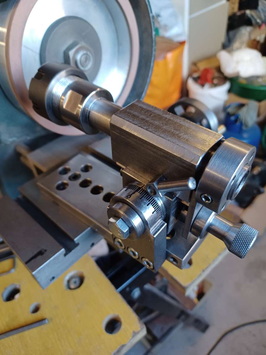

                                                  I have started grinding my own sometimes as mainly bottom of cutters need sharpening or drill edge needs a better than hand eye coordination, as I get older. The Grinder that I modified does most sharpening. I made the tool holder my self and gets me out of a hole or two occasionally.
                                                  20250228_143155
                                                  I can grind most angles and also sides of milling cutters quite acceptable and also mod cutters to cut a taper if i wish but it takes time. I ground a carbide endmill to cut a slot with a 5 degree angle to make a lead in on a square aperture with round corners in tough steel block for a punch guide for a jewellery friend.
                                                  David

                                                    Neat design, David.
                                                    Can you sharpen 3-flute as well as 2 and 4 flute cutters?
                                                    I find the Worden T&C grinder is limited to 2 and 4 edges only, as its indexing is by the tool-holder block’s square cross-section, but a second block of equilateral-triangular section to fit the existing guides would overcome that.

                                                      I index the teeth for the end by using aa collar with holes in. And by unclamping the side clamp pull back the collet holder, rotate to next hole, push back to depth and re clamp and wind over face of grinding wheel and repeat till all faces are ground. II haven’t made a collar for three hole yet but should I need one it wont take very long. There is a dowel in the end of the body and aa set of holes in the collar which is held on by a grub screw to the shaft of a collet set which holds the cutter or drill and also sets depth when sliding out off the location dowel rotate and push back to locate next hole ready to sharpen next face.
