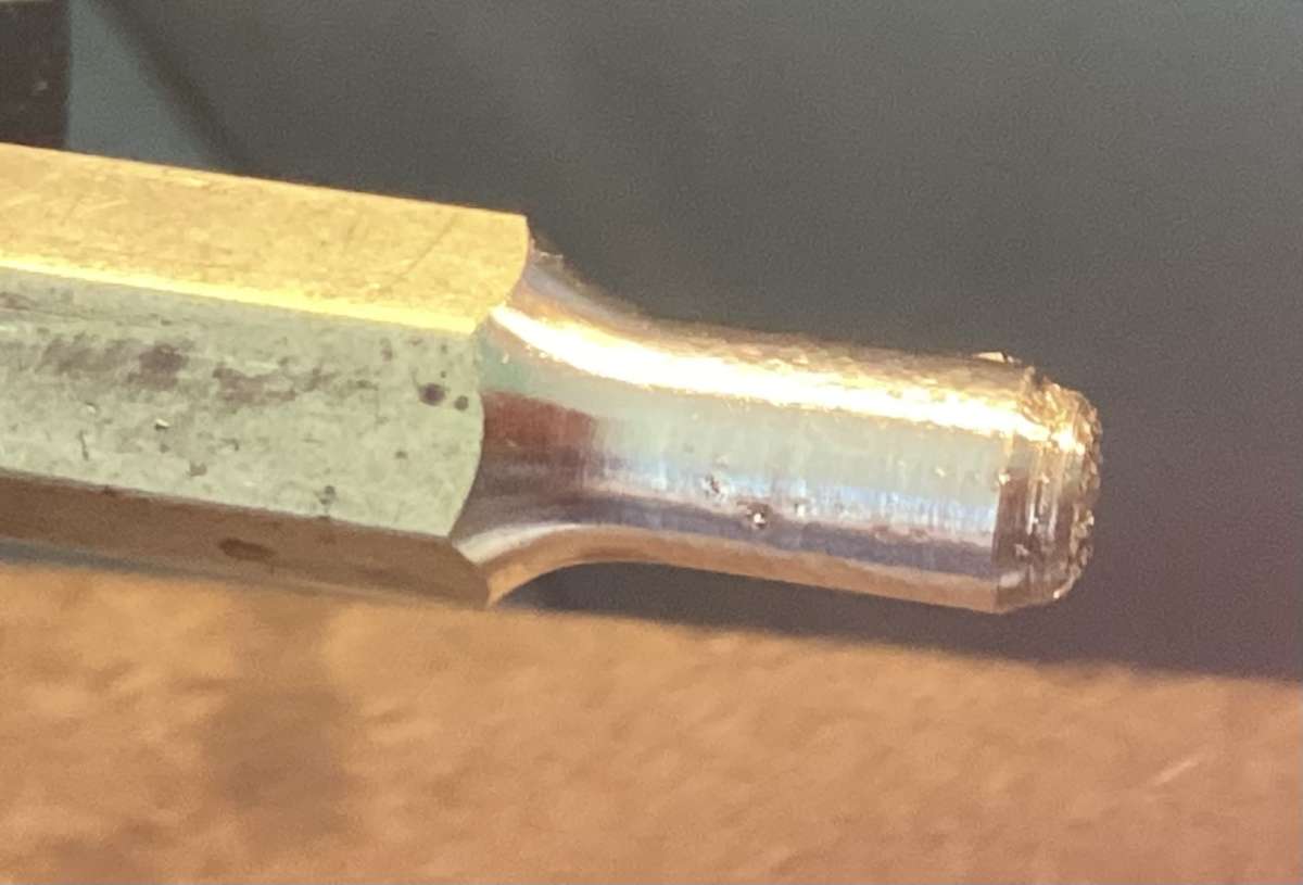

      I’ve got about a dozen Völkel threading dies, mostly bought new. I’ve never had a problem with any of them – until now.

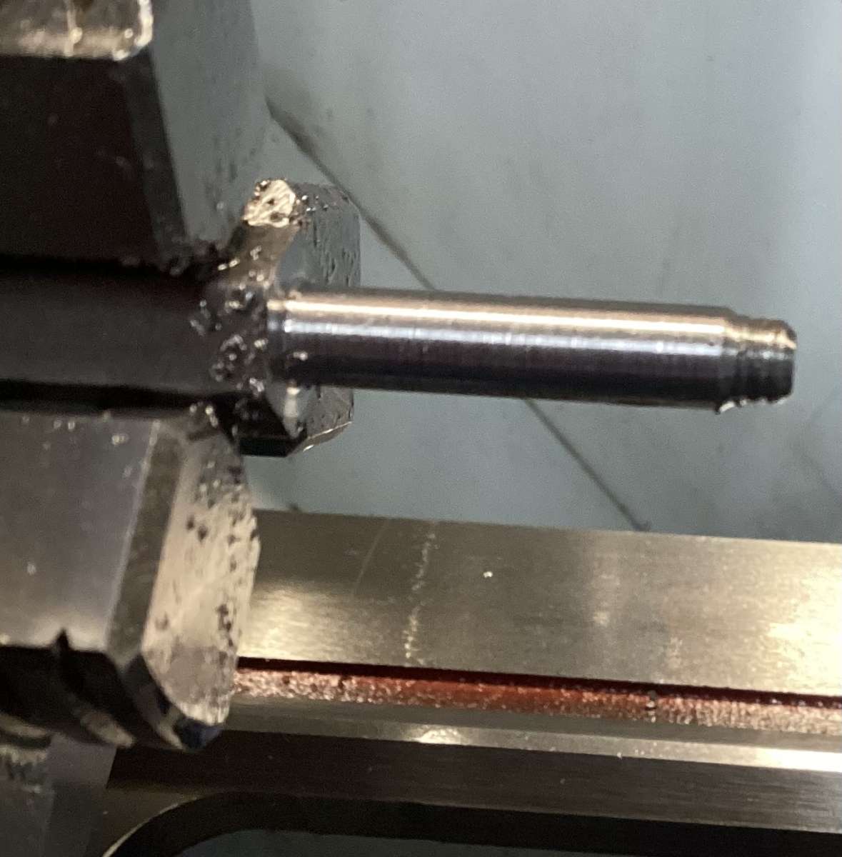

      I’m attempting to make some knurled thumb-screws in 12-28 UNF using a recently acquired new Völkel 20mm round solid die.
      No matter how gradual and long a chamfer/taper I placed on the end of the turned-down-to 5.48mm silver steel rod (not in its heat-treated state, obviously) I couldn’t get the die to start even with a spring tap follower held in the tailstock pressing on the back of the die stock (I’d have to show you to explain how I do this). All I ended up with was a piece of rod with a dog point on the end, even after attempting to thread under power.
      For a sanity check, I tried the die on an existing steel 12-28 thumb screw made commercially many years ago; I couldn’t get the die to start on that either.
      For a further sanity check, I tried threading a piece of 5mm brass rod with the die. Even though 5mm is nearly 0.5mm below the major diameter of 12 UNF and the rod was given a long taper at the tip, the die was difficult to start. I cut the thread successfully but cutting felt noticeably more difficult than cutting, say, an M6 thread with the appropriate M6 die.
      The only way I managed to cut any kind of thread on the silver steel was by making the solid die into a split die using a diamond cutting wheel and opening up the die as far as possible in the die stock. It cut the thread but it was hard going, and I was disturbed to see how chipped and torn the threads were, especially from about 15mm in (see image).
      I know this is silver steel, which is pretty tough even in its off-the-peg state, but the die teeth clearance just did not seem to be wide enough to cut a standard 12 UNF thread. When I shrank the die down again by loosening off the screw in the split I simply couldn’t turn the die on the existing threads in order to “cut to final size”; threading with the split fully opened had already cut the thread to final size effectively, as confirmed by its easy fit into the female thread the commercial thumb screw mentioned above belonged in. Another disturbing detail was that my now threaded silver steel had a major diameter of 5.35mm whereas before threading it had been 5.48mm.
      Is this just an out of spec example from Völkel , or is there something I’ve overlooked?
      P.S. In the picture, the tapered/chamfered end of the rod has now been sawn off.

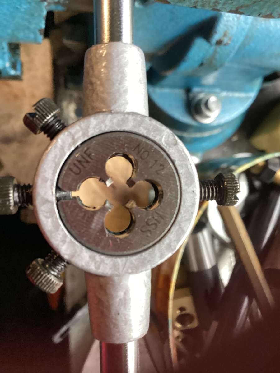

          I’ve posted a couple more pictures, one showing the dog point achieved on a piece of mild steel turned down to 5.48mm. There was no way I could get that die to start even when the split was opened as far as possible.
          The gap between opposite sets of teeth in the die’s resting state is in the range 4.2-4.25mm. This is significantly less than a 12-28 thread’s minor diameter.
          If anyone is willing to try the die for himself to confirm who’s failed here (me or the manufacturer) I’ll happily post it out.

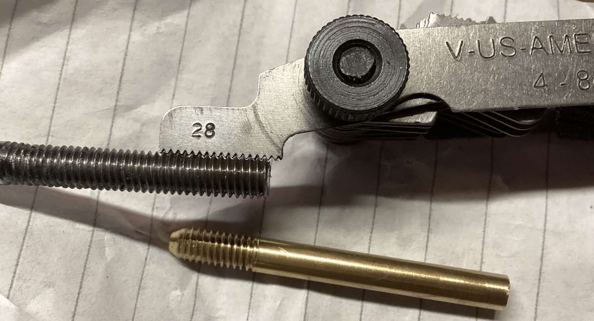

            Have you measured the tpi of the thread you did manage to cut?
            Might it be a mis-labelled No.10 32 tpi?

              Bill, thanks for the suggestion. I did momentarily wonder something similar myself, but it’s not the answer.

                Did you try it from both sides? Some badly made dies still have burrs from the hole drilling on one side of the teeth.

                  I did have a die which had been marked on one side, but the lead in chamfer was on the other. So it needed to be used “Wrong way round”
                  Worked O K once the problem was spotted, but confusing to begine with

                    The die is chamfered both sides and there is no difference in performance either way round.

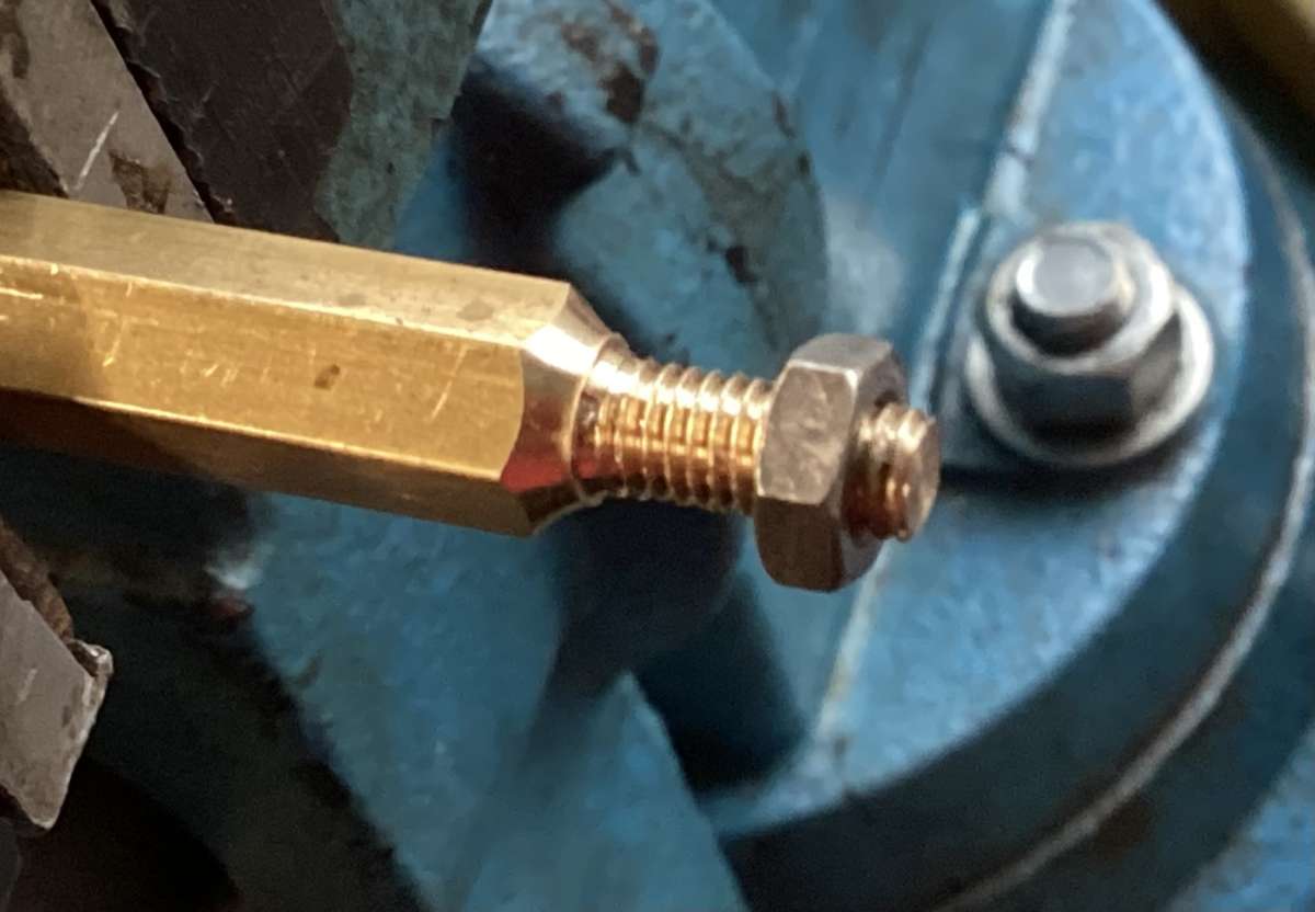

                          Today I reduced the diameter on a piece of brass to 5.4mm. As my earlier experiment with a piece of 5mm brass referred to above suggested would happen, a reduction to 5.4 didn’t allow me to start the thread even with the split opened as wide as possible.
                          Also today I die-threaded two brass lengths in 10-UNF and 1BA, both dies being practically new. The turned diameters were the full major diameter for each of these two threads, the starting taper was minimal, and yet the dies breezed their way along the rods with very little effort.
                          The first photo shows the dog nose effect produced by the 12-UNF die at 5.4mm.
                          The second photo shows the minimal taper I needed on the end of the 10-UNF rod in order to start and complete the thread at full major diameter.
                          This 12-UNF die is undoubtedly out of spec., and I have lost some confidence in Völkel products.

                                First, the die you are using is primarily intended for manual thread cutting. Regardless of the material being machined, this type of die is not designed for machine use. As you are cutting the thread on a lathe, a gun-nosed die made specifically for machine use would normally be the better choice, especially on a longer thread, as it directs the chips forwards rather than allowing them to collect in the chip holes.
                                The starting diameter of the plain bolt is also worth looking at. You mentioned turning the blank to 5.48 mm, which is the nominal diameter of the thread. For actually cutting the external thread, however, we would recommend starting slightly below this. For #12-28 UNF, around 5.38 mm maximum would be our recommendation.
                                That may also explain the slightly torn appearance at the thread crests in your photo. Starting at the full nominal diameter means the die has to cut right into the very tips of the thread profile, which can make the result less clean, particularly in tougher materials.
                                The 5.35 mm diameter you measured after cutting the thread is not necessarily a problem either. It is within the normal tolerance range for a #12-28 UNF external thread, so that measurement alone would not suggest that the die is cutting undersize.

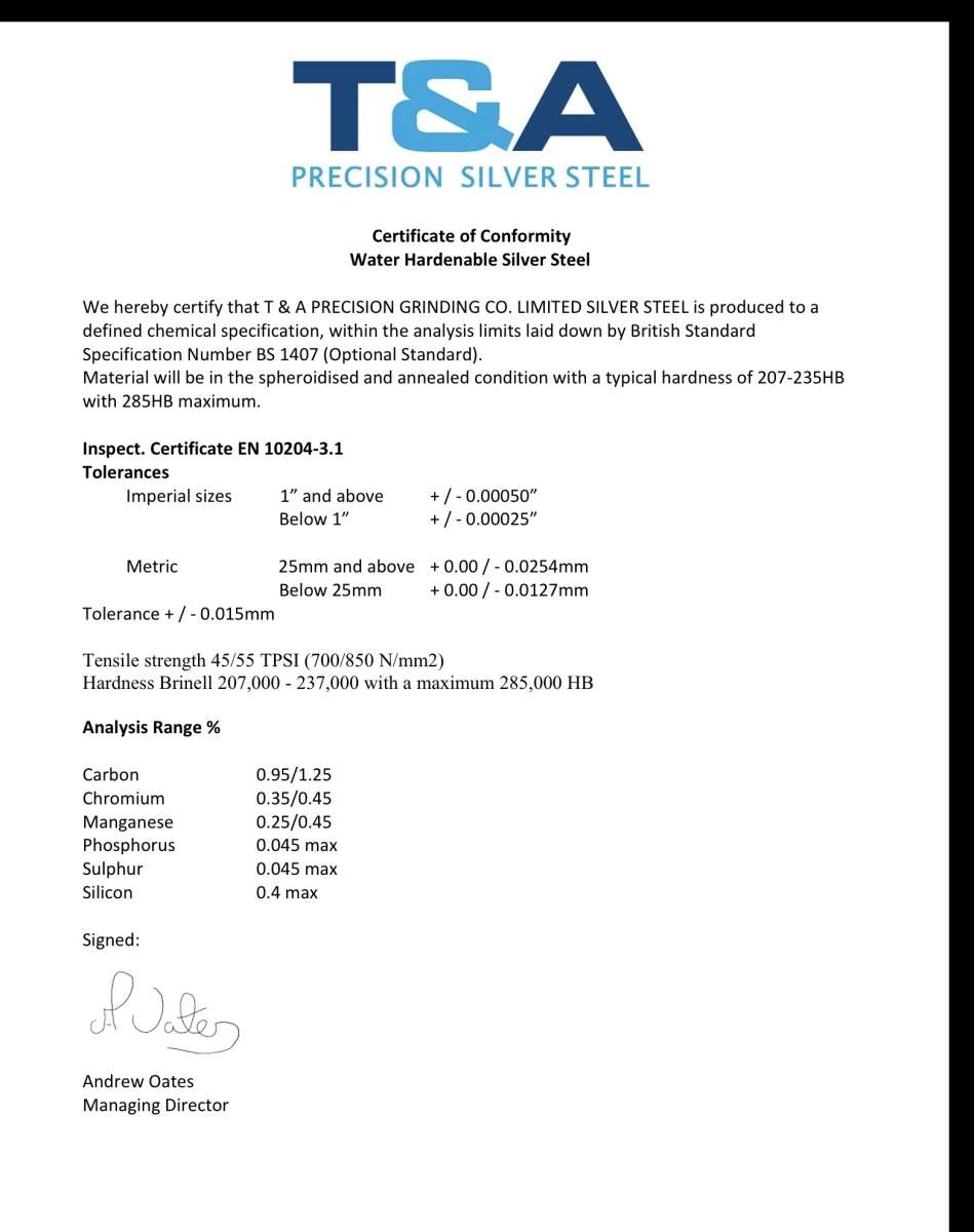

                                    This would be a fairly typical composition of what in the UK is known as Silver Steel
                                    Metric Silver Steel 333mm Long

                                          And thank you for the link regarding Silver Steel. That is very helpful and gives us a much clearer picture of the material being used.
                                          Looking at the typical composition, we agree that the Silver Steel is very likely an important factor here. This particular die is our standard version and is primarily intended for manual threading in unalloyed to low-alloy steels. Silver Steel places considerably higher demands on the cutting edges, so cutting performance, surface quality and tool life can all be affected.
                                          We would therefore agree that the combination of this particular die and Silver Steel is not ideal and could explain much of the difficult cutting behaviour and the torn thread surface Phil experienced.

                                              I feel there are two separate issues that contributed to the problems I encountered in this case.
                                              The first one is my decision to thread silver steel (please see the image below showing its provenance) with a standard HSS die rather than, say, an HSS-E die. In my defence, I chose silver steel only because I had some 5.5mm in stock and I had become accustomed, from following instructions in Hemingway kits, to think nothing of using a standard HSS die to thread annealed-state silver steel.
                                              It’s fairly apparent from the first image I posted that the tearing to the thread flanks and crests is more severe the further along the stock the die has travelled. Given the relative smoothness of the finish in around the first third of the thread I cut, it’s unlikely that the unusual tightness of the die on the work I experienced can alone be responsible for the worsening tearing of the thread flanks and crests as the die progressed, especially when the turning to diameter had been done without tailstock support, which with thin material like this would tend to produce a marginally larger diameter at the tailstock end than at the headstock. I confess chip evacuation wasn’t something I was very focused on whilst my mind was preoccupied with how unusually difficult it was feeling to get the die to begin cutting and move along the part.
                                              The other issue I feel must be at work here though is the critical aperture, as manufactured, between opposing sets of teeth on the die. I own around a dozen Völkel HSS dies up to 1/2” BSP size, and getting on for a hundred other dies by different manufacturers, most having been purchased new or nearly new over the last ten years. Although there are people on this forum with far more experience of die threading than I’ve got, I have to say I’ve rarely experienced such difficulty threading brass and mild steel with a quality branded HSS die as I did with this one. I have no doubts about the die’s cutting power and toughness (the teeth have no detectable wear on them after their encounter with silver steel), but the consistent difficulty I encountered starting the die, even after opening the shop-made split all the way, and the difficulty of completing the threading operation mean I do have remaining doubts about the cutting diameter of the teeth on this 12-UNF die; there simply does not seem to be enough clearance to cut material turned to anything close to the basic major diameter, regardless of whether the material is something probably too demanding for the die like silver steel, or something undemanding like brass or mild steel.
                                              Being curious by nature, and relatively unconstrained in my workshop activities by cold hard economics, I’ve ordered two other 12-UNF dies by other brands, one a solid die and one a split die. I will report back when I’ve received these and had a chance to try them out.

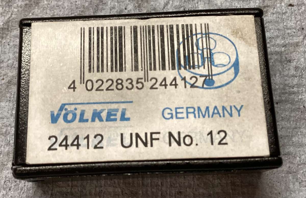

                                              For Völkel‘s information, I have posted a photo of the box my die came in.IMG_2366
