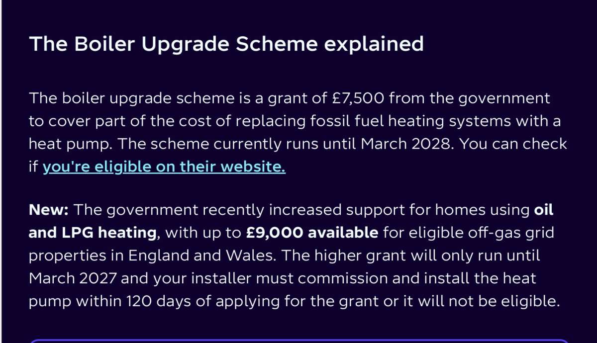

      I am being encouraged by Octopus Energy, to apply for the £9k grant towards a Heat Pump [replacing my Oil boiler]
      I have a lot of thinking to do, but meanwhile I would welcome any comments about the actual contraption that they are offering:
      https://octopus.energy/heat-pump-explore/

                              Be aware that to get the grant, you will need a report showing that your building doesn’t need any work to meet the insulation etc. requirements of the scheme.
                              I had to get some additional loft insulation (at my expense) to bring it up to current standards, before qualifying for the grant for my heat pump.  The cost of the survey may be ‘free’ (but rolled into final cost, by the heat pump provider).
                              That extra insulation led to issues with condensation in the loft – fairly easy to resolve, but the insulation contractor wasn’t interested!
                              Some companies are only interested in the grants, and are not good technically.   I had more than one company tell me my house was not suitable, due to microbore piping.  House  heating and hot water now provided by heat pump, heating still by microbore – one radiator upgraded.
