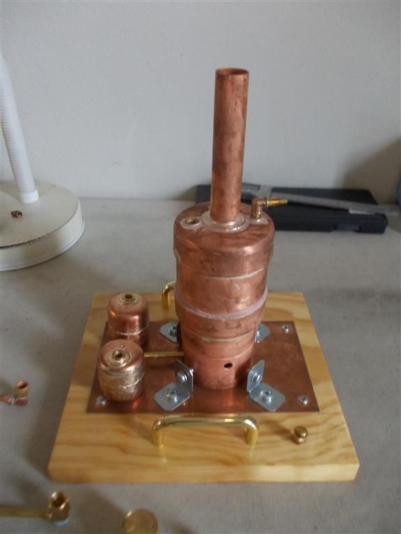

          I have finished most of the drilling, tapping and die-ing (?). Nothing is soldered yet as I am still thinking about using the JB WELD glue.  It is also raining here and will probably rain all this week so I cannot solder outside in the courtyard.
          The small brass twin barrel burner is the one I purchased from ebay. It works well but does not last very long and the filler plugs are way too small. You can see both the single and double barrel versions using the copper end caps and also another burner I am working on using brass end caps which are threaded. I think this will probably work out to be the simplest to construct. The right angle pipe work on the twin copper burner is from an air tool supply shop.
          Also in the photos is my own boiler with the firebox now added. You can see how it all fits together. I am in the process of painting the wooden lagging for this boiler with clear gloss PU.

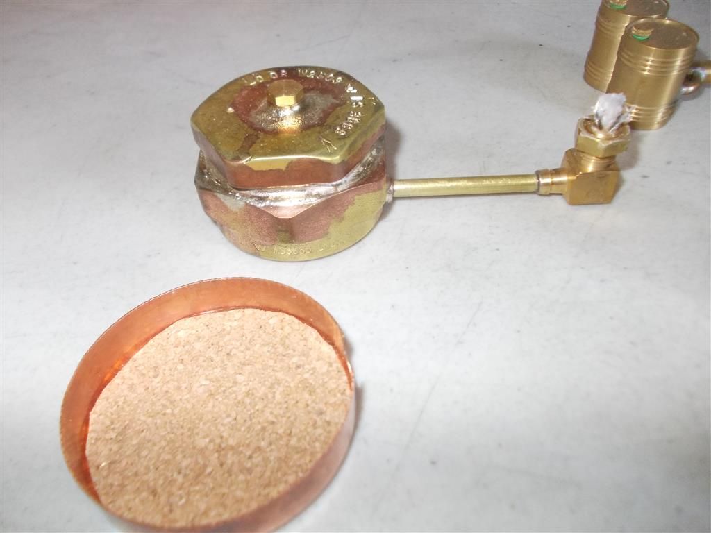

                    I decided to make up one of these burners using JB WELD on the pipe work and the funnel. I glued it all together yesterday. It does take a while to set ; it is not as fast as Araldite. Here are some photos of the single barrel copper burner (32mm copper end caps) in action under my home made boiler (65mm copper end caps). It burns for 15 minutes on 15mls of metho. The flame is good and strong. There was an initial chemical odour as the glue heated up but everything seems to be okay.
                    I will have another go at soft soldering when the weather clears up as it is raining very heavily here now. I did some experimenting yesterday and the problem is the flux : Bakers does not get it to flow nicely. I will see what the hardware store has in stock. I want some sort of paste like I use for silver brazing.
                    NOTE : I have used a copper end cap lined with cork to absorb some of the heat so it does not pass to the burner. It is a temporary solution.

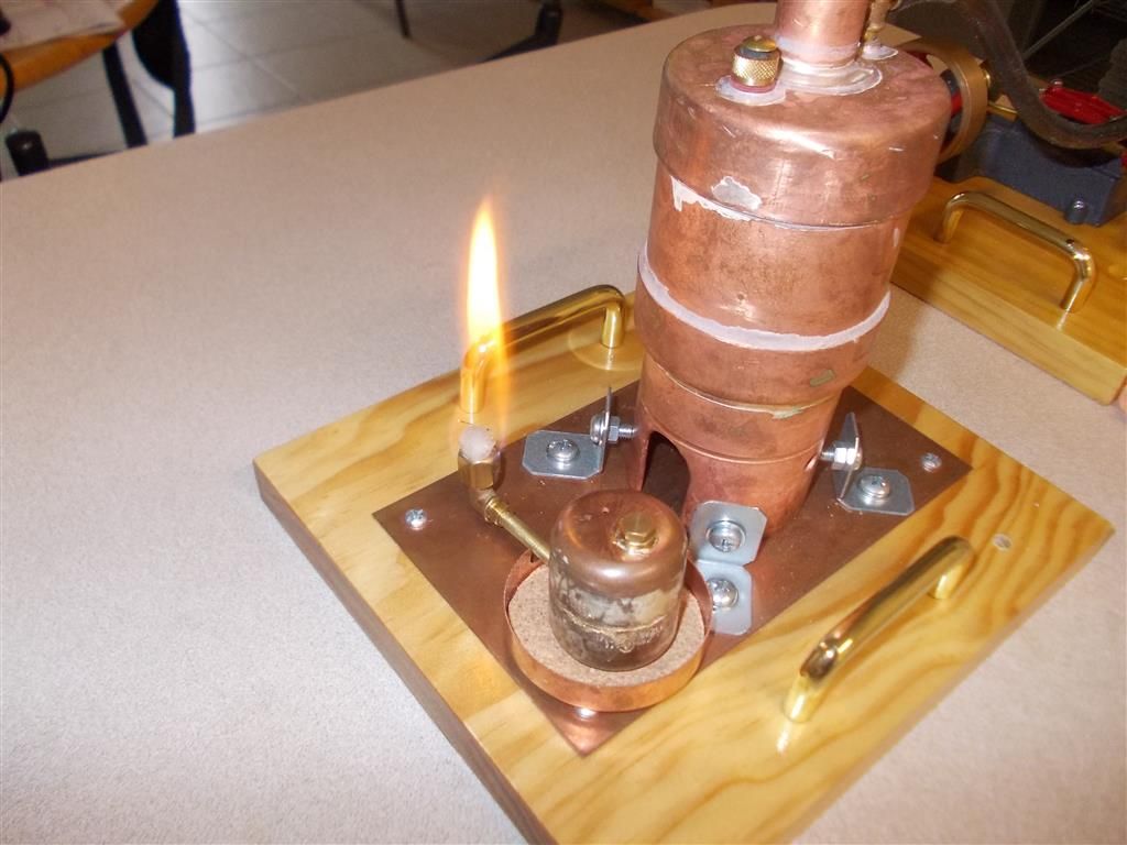

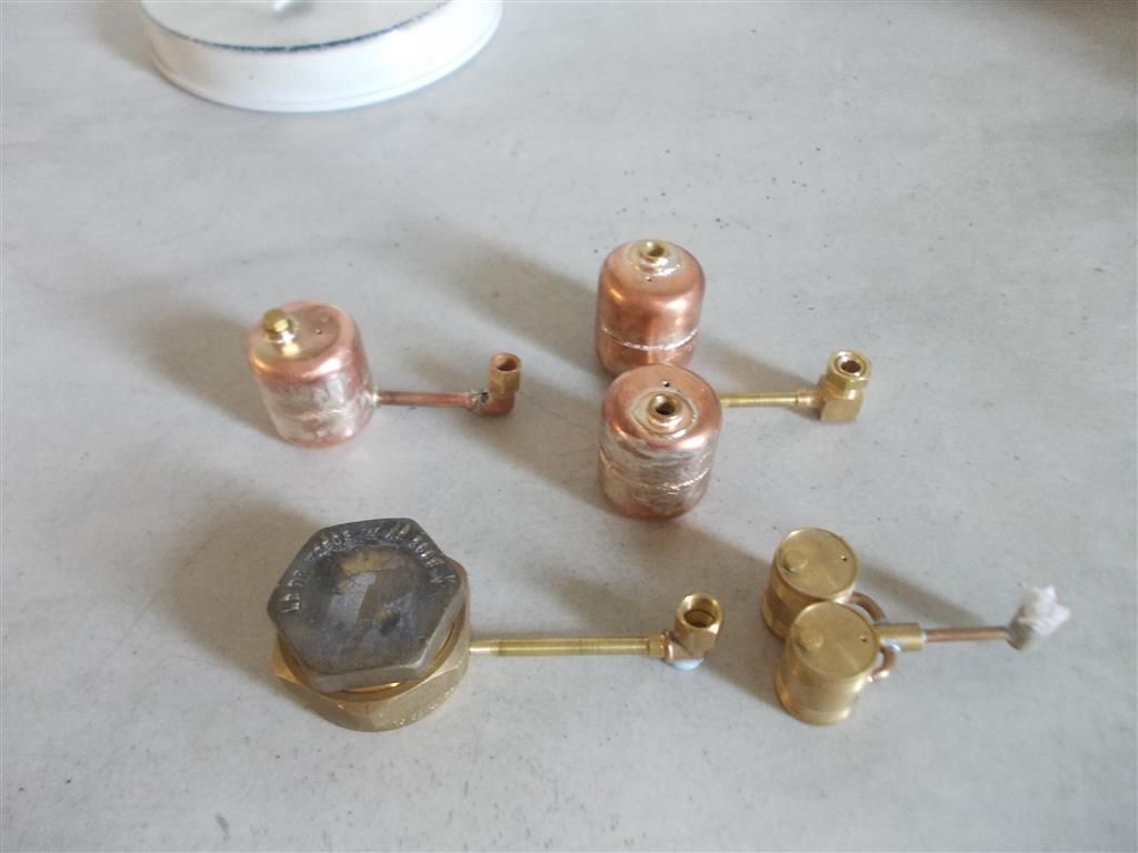

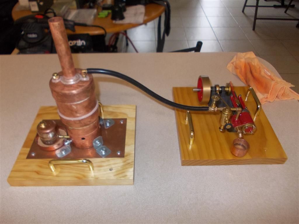

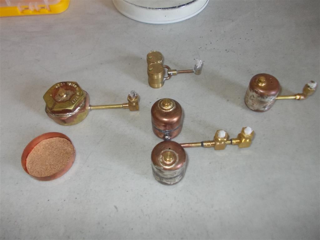

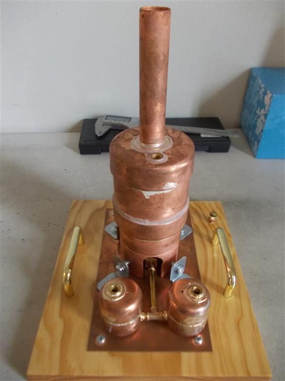

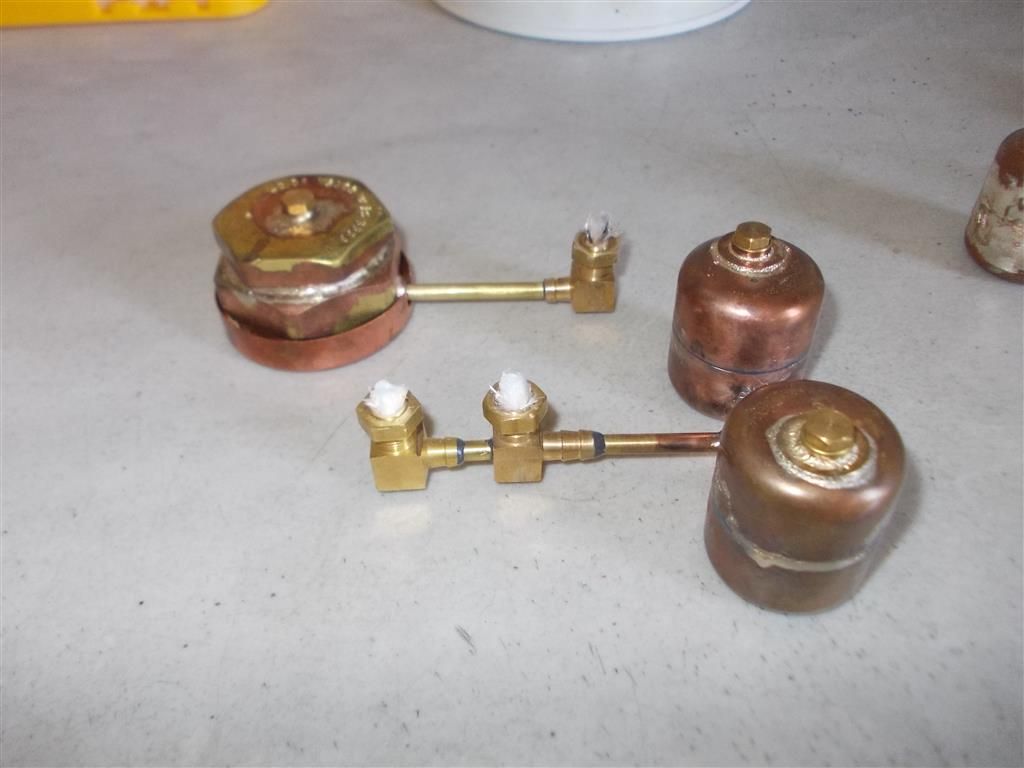

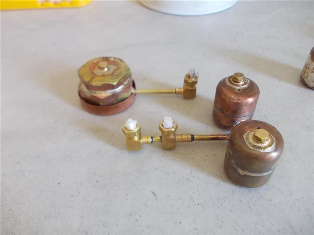

                        I have now finished building three of my own spirit burners using either copper or brass end caps. ( The double barrel brass burner was purchased from ebay.) The big brass one made from 32mm brass end caps also fits nicely into a 50mm copper end cap so I have cut a piece of cork to insulate it from the heat being transmitted through the copper base. It still gets quite hot after 25 minutes so most of the heat is being transferred down the brass tube from the wick funnel and into the reservoir.
                        1.  There is not much that can be done about that is there ?

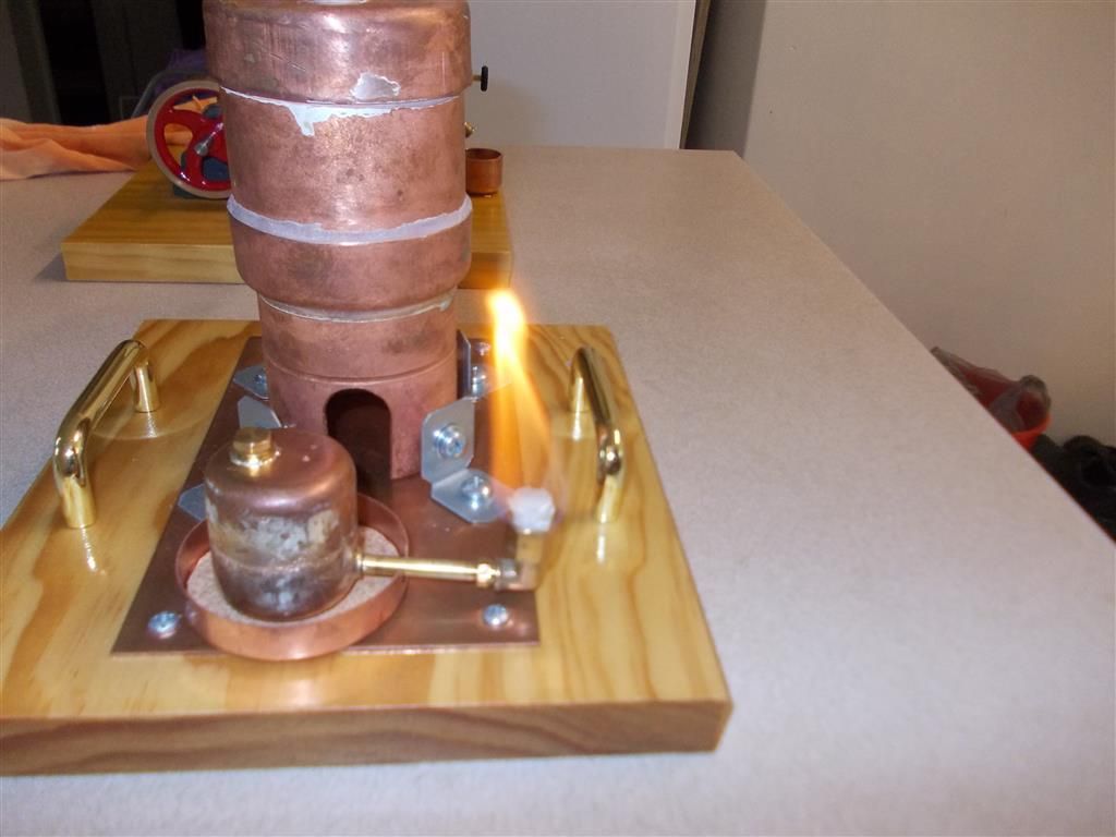

                        I also tested how hot it gets in the firebox by putting a few pieces of low melt 143 degree solder inside the firebox while it was being used. The solder did not melt so obviously the temperature does not exceed 143 degrees Celsius which is well within the range of JB WELD : it will withstand a constant temperature of 260 degrees Celsius.
                        I am surprised how much soot is produced by a spirit burner inside the firebox. I have just finished cleaning the fireboxes and the flues/chimneys with a cut down paint brush and a home made pull through.
                        2. Do solid fuel tablets burn more cleanly than metho ?
                        3. Do solid fuel tablets produce more or less heat than metho ?

                          Brian, ideally the meths should burn with an almost invisible blue flame, but I have also noticed that there is a dirty flame these days. I think the fuel tablets are actually just meths soaked into a porous solid, I don't think there is much difference.
                          Ian S C

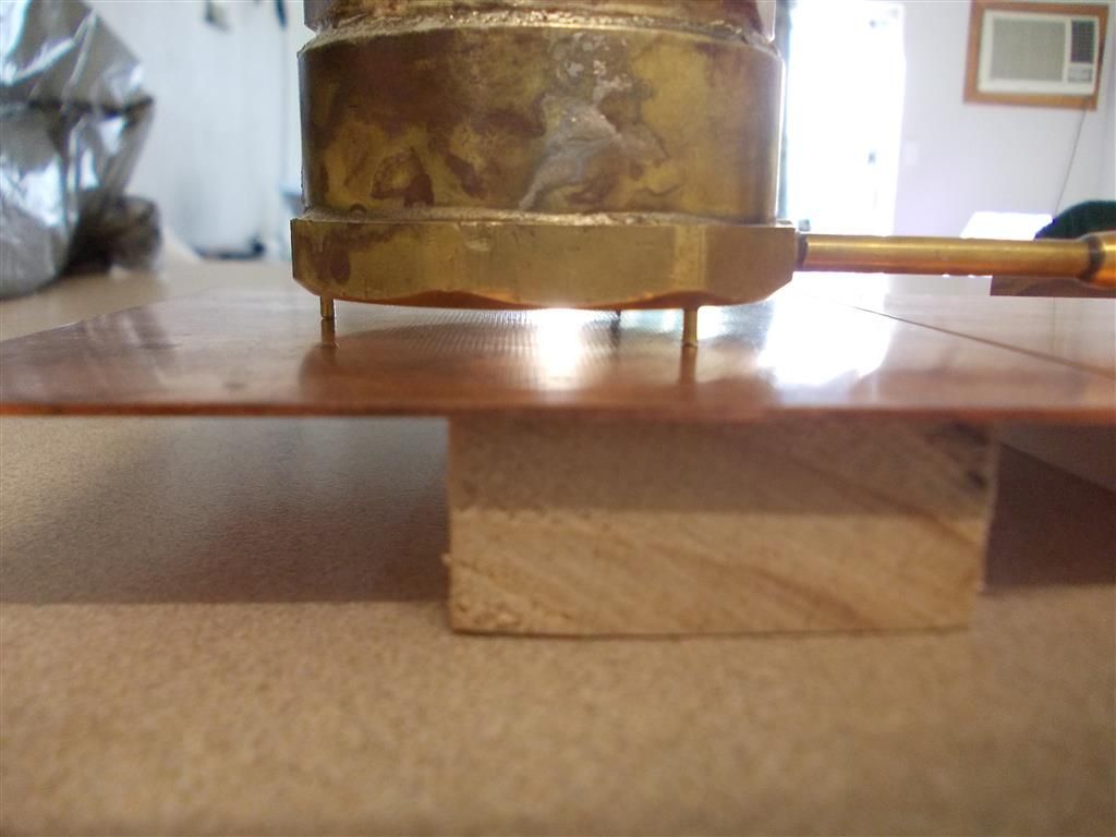

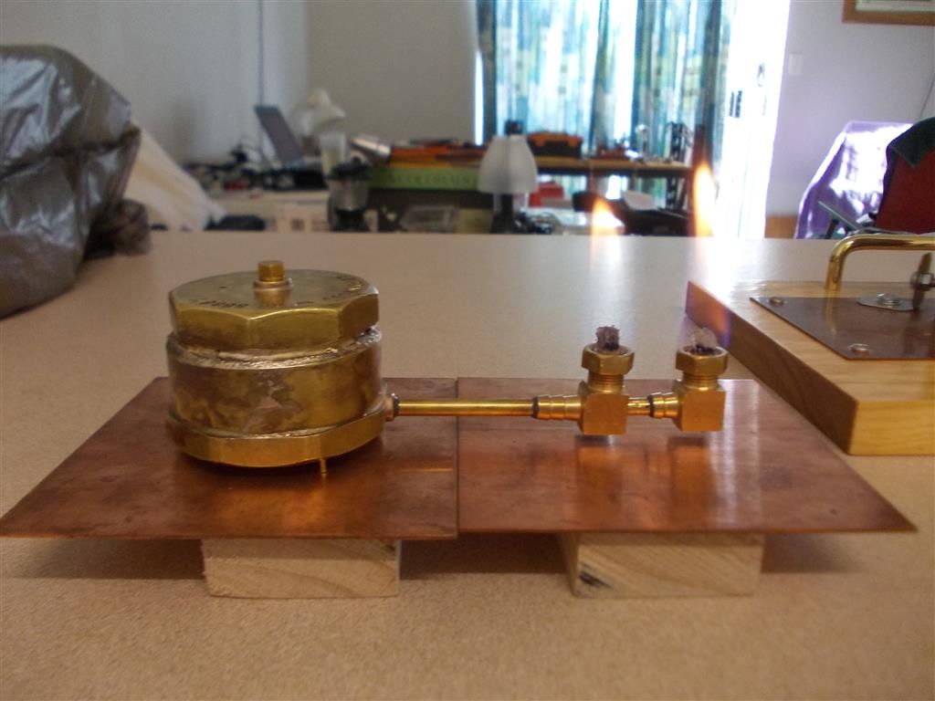

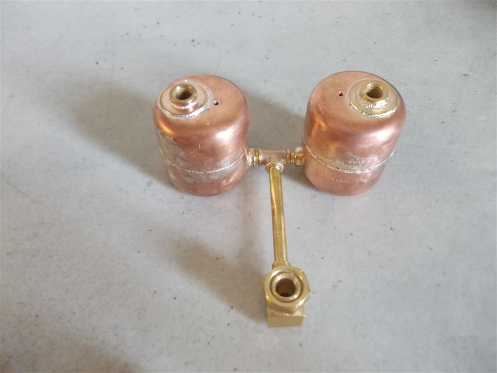

                            I have built another larger spirit burner made from a 55mm brass end cap and its plug. This one has a longer tube and two burners for possible use on a horizontal boiler. I have fitted 3 small ''feet'' made of 1/16 brass rod which sit in shallow holes I have drilled in the base of the brass end cap. They are held in place with Loctite 263. It works very well ; the heat does not now get transmitted to the reservoir which stays nice and cool.
                            It will take 350mls of metho before overflowing at the burners

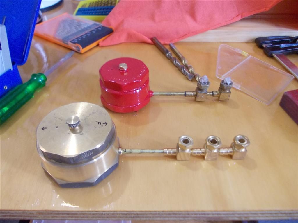

                              I have purchased a large brass end cap and end plug to make a triple burner. I have spent the afternoon drilling and tapping and it is ready for soldering and JB WELD. (The drill press finally proved its worth today.) I have a feeling that I am going to have to run a wick of some sort down the length of the burner tube otherwise that front burner will not function very well. I can get away without any wick on the double burners but towards the end of the burn time the front flame decrease in size.  I do not have a problem with spluttering as others have mentioned. This triple burner will be used on my horizontal boiler to get more steam pressure from it.
                              What should I use for a wick to run down the tube ? Will cotton string suffice ? Whatever goes in there will have to stay there as there is no easy way to change it or get it out which is why I have been reluctant to use a wick on my double burners.
                              In the photos you can see the completed double burner and the uncompleted triple burner. It will rest on three 1.5mm diameter brass feet when finished.

                                You have a few choices for wicks, you can get wicks for oil lamps(here I think the $2 shops have those), There is fibre glass rope for sealing the door of log burners, or you could go the way I do, I use fine iron florist's wire, it's about .019"/.4826 mm, stainless might even be better, you might be able to get some fine stainless cable. The meths comes up the wire by capillary action, so depending on how tight you pack the wire in the wick tube, the faster or slower the meths rises. Cotton(not synthetic) works, but when the fuel runs out the wick burns.
                                I make the wick tubes at the top end as thin as possible to reduce heat conduction, I also make that part in steel for the same reason (I know, it rusts), I'v got 20 year old burners that are as good as new (a bit rough).

                                  Sorry, I did explain properly. I use fibreglass for the wicks that burn and these do a good job (they last forever). But I need something that will aid the flow of meths from the reservoir to the burners. I called this a ''wick'' but it may have been incorrect terminology : some sort of string (cotton) that runs under the burners down to the reservoir. I do not want something that will rot after 6 months.
