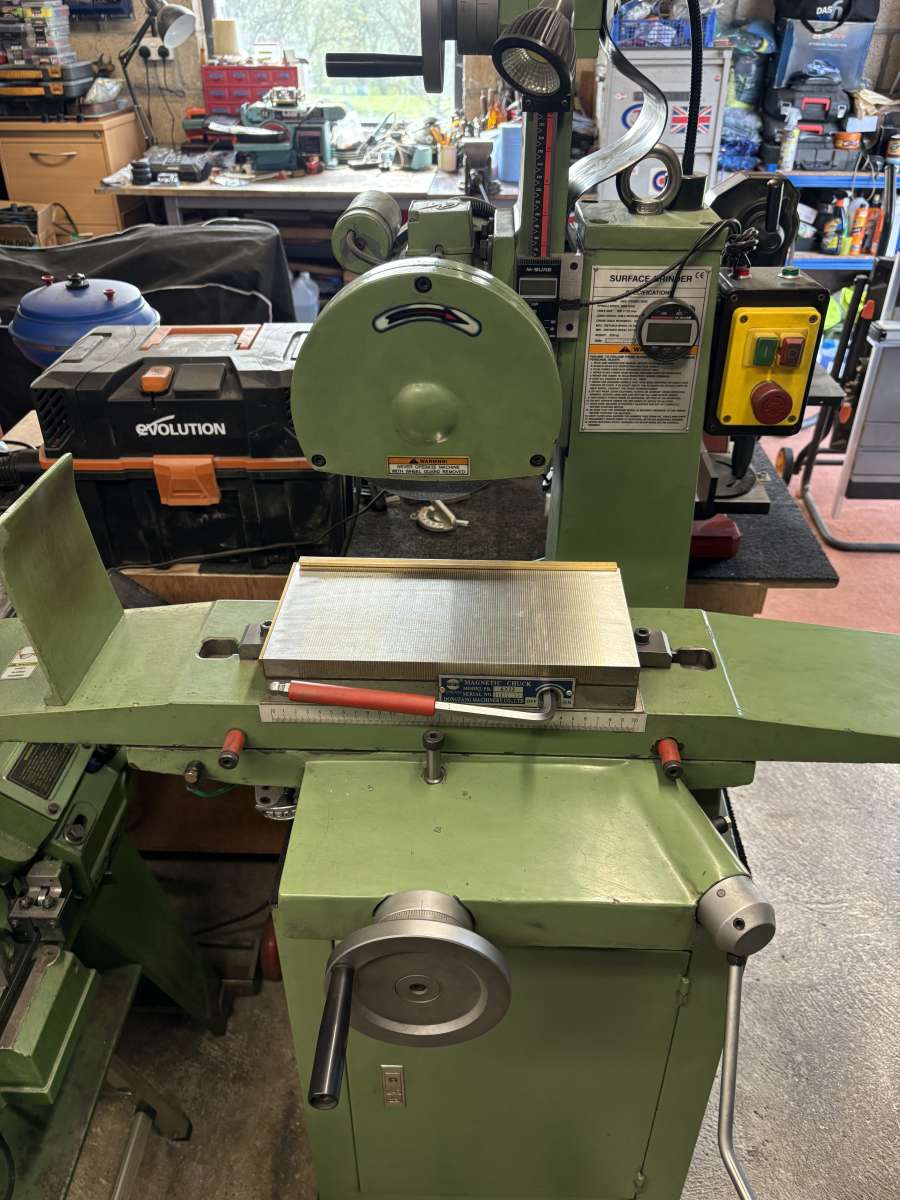

                                #841982
                                Shaun Churchill
                                  @shaunchurchill54517
                                  Hi Wade,
                                  I have two surface grinders – one being an improved chinesium Warco and the other a British made Eagle. Neither of them have a lock on the reciprocating axis and like you have often concerned myself about this when working on jobs where it would be safer to lock the table. Having said that the effort required for the wheel rotation to “kick” the table on the Eagle is considerable and of course I always maintain the wheel so it is off centre and doesn’t dig in. What I do always have to remember though is the wheel rotation on my two surface grinders is totally different! Yes, it would be nice to lock the table movement but so far in practice with a bit of care it hasnt been necessary to do so. I tend to only use the cylindrical grinding fixtures on the Eagle surface grinder as it has a much slower rotational speed. Hope this answers your question. I do agree with you the axis designation for surface grinders never makes sense to me either😂
                                  Shaun

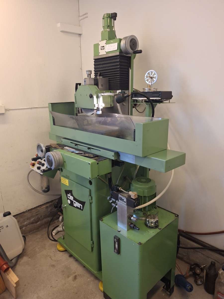

                                    #842008
                                    Wade Beatty
                                      @wadebeatty78296
                                      Nice machines Shaun
                                      My Degen FSHQ 300-V

                                      #842026
                                      Shaun Churchill
                                        Not familiar with that make Wade but looks superb. My experience with surface grinders is limited to mainly J & S 540’s, Exe and a really unpleasant Russian made Stankimport machine – a machine so bad I would rather forget it!

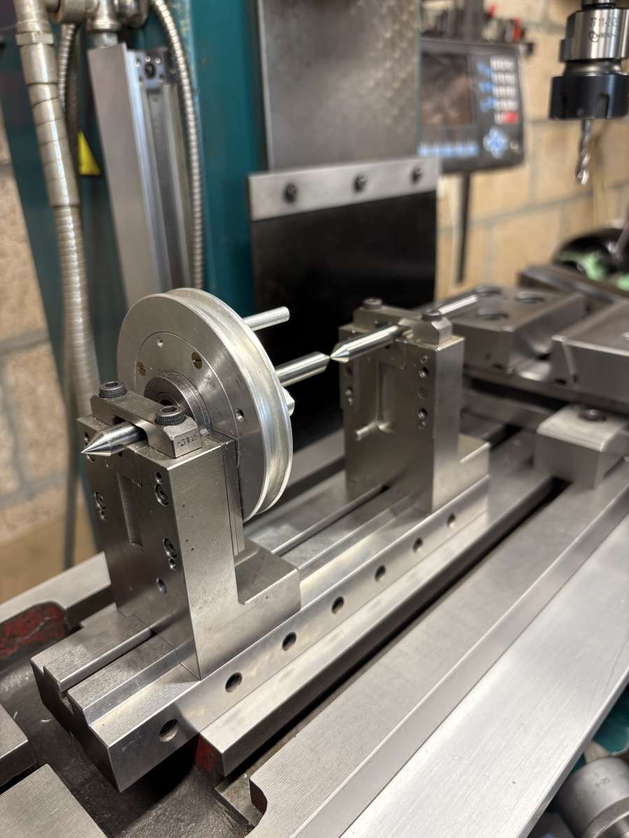

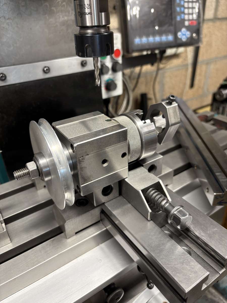

                                            #865164
                                            Peter Neill 1
                                              @peterneill1

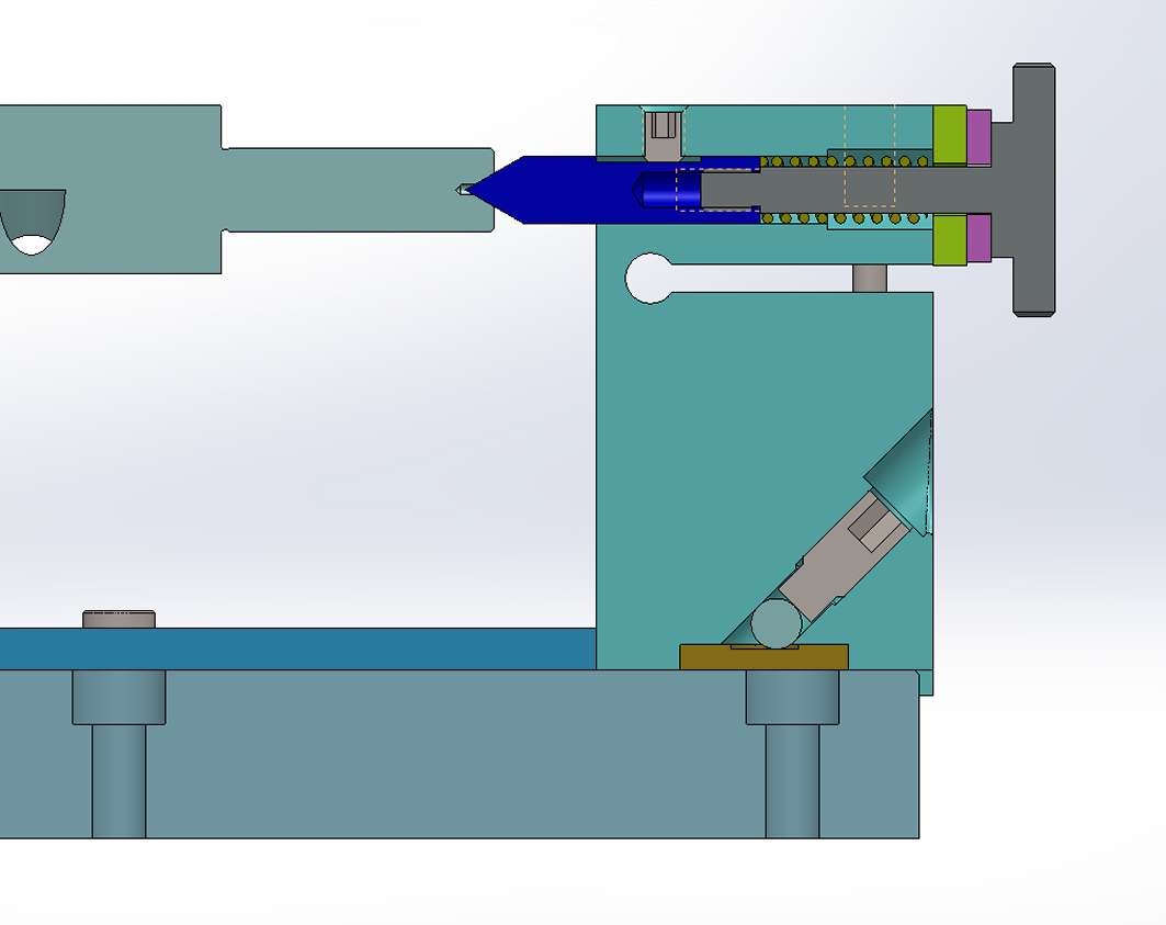

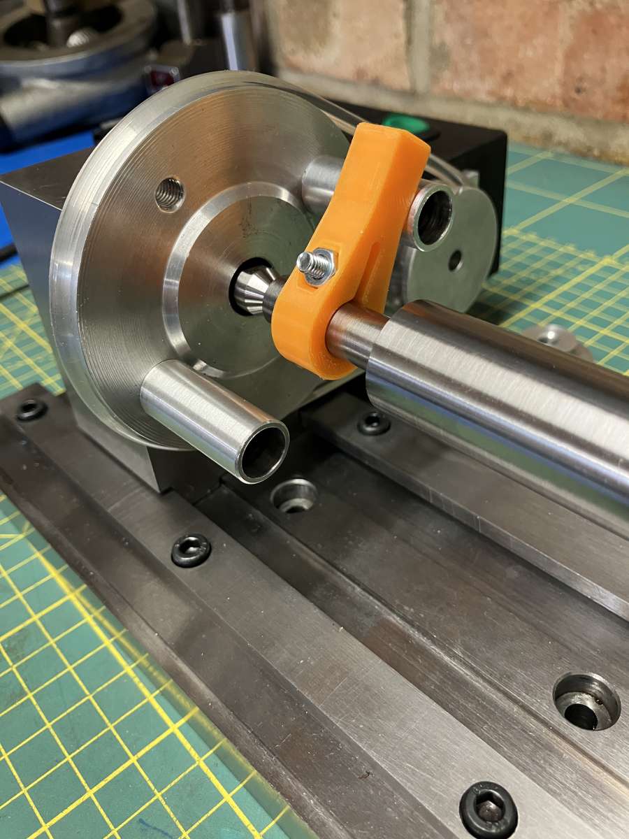

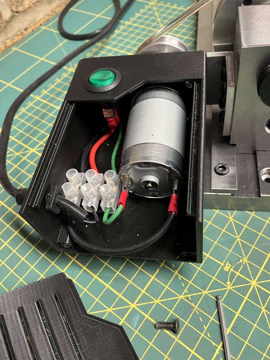

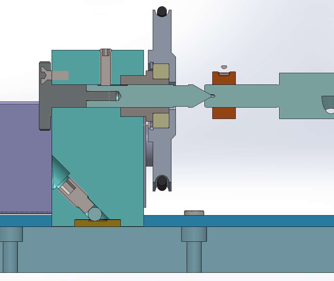

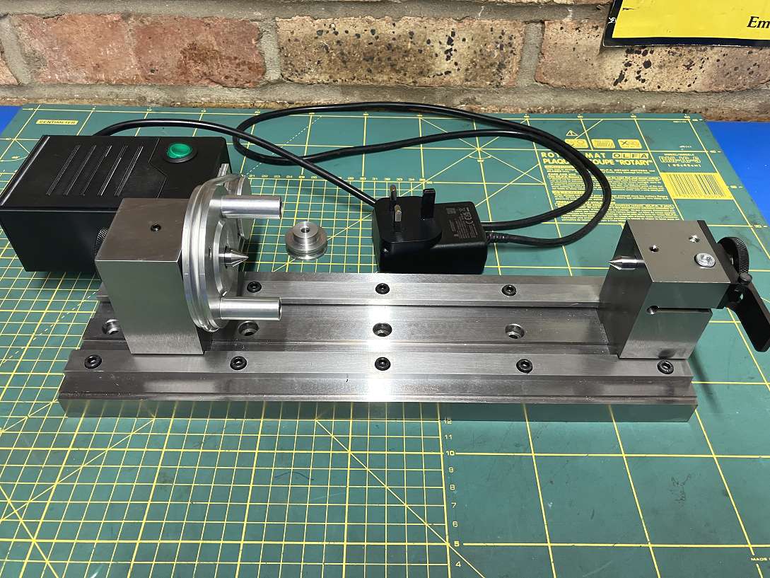

                                              I stumbled across this topic whilst having one of my rare browses on this forum, and though somewhat late to the subject, thought I could possibly add a little to it.
                                              I made a cylindrical grinding attachment for my J&S 540 a couple of years ago, and for driving the spindle I used a small 15W 12vDC gear motor rated at 500rpm, and which is powered by a ubiquitous wall-wart. I know this may sound like it’s underpowered, but believe me it is not.
                                              Depending on which size drive pulley I use, I get speeds of either 240rpm or 180rpm, both of which are in the typical mid-range for work head speed on a cylindrical grinder.
                                              It works very well and has driven a 2″ diameter x 6″ long shaft very easily, with only very minor speed reductions when engaging the grinding wheel, but with enough torque to continue driving consistently.
                                              Then again we are only taking very small cut increments on these things, so not an awful lot of power is actually needed. Happy to provide further details if required.

                                              #865195
                                              Wade Beatty
                                                @wadebeatty78296
                                                Thank you Peter, nice and simple design
                                                #865205
                                                Peter Neill 1
                                                  @peterneill1
                                                  Took quite a lot of work to make it look that simple:)

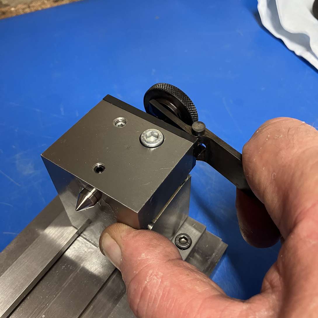

                                                  Front Centre
                                                  Rear Centre
                                                  Thumb Lever 2
                                                  Original_2
                                                  Guide Block Matching

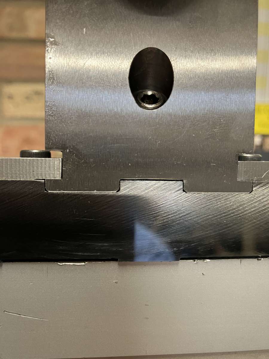

                                                    #865292
                                                    Mark Rand
                                                      @markrand96270
                                                      Like the tailstock height adjustment. I guess that it’s extremely precise/sensitive?
