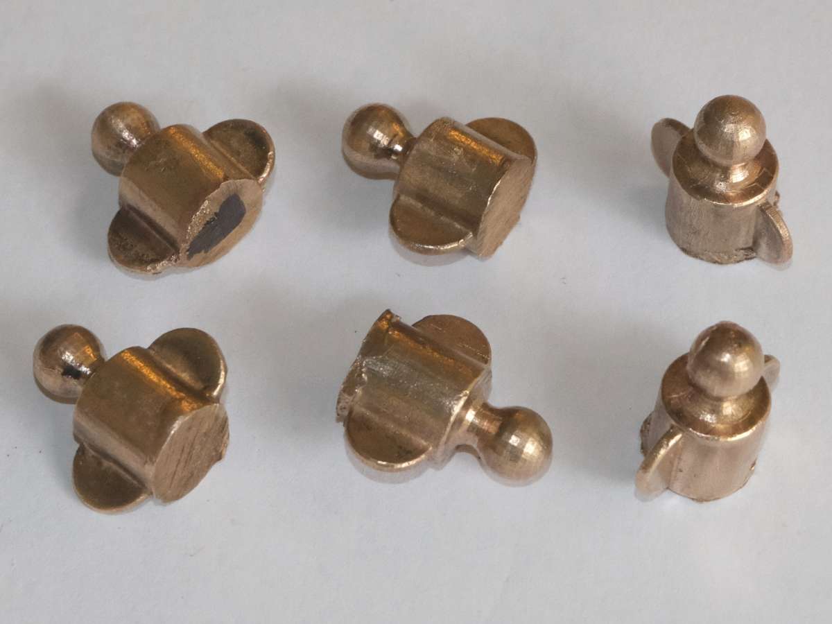

          First ever attempt at investment casting in LG2 – front wheel oiler caps for a 4″ scale Burrell traction engine. For scale the body diameter is 3/8″:
          Front Wheel Oiler Cap Blanks
          The caps are as is from the casting process, just soaked in brick & patio cleaner and a light pass with a fine wire wheel. The undersides will need machining and a hole drilled and screwcut 1/4″ x 40 tpi.

            Nice !
            #864715
              They have come out rather well. Is the slight faceting of the ball the photo or has the texture of the 3D print been captured in the investment?

                I just knew you’d comment on that!
                The facets represent the texture of the 3D print. The base resolution of the resin printer is 0.05mm, probably nearer half that with anti-aliasing. The pattern is almost invisible, and can’t be felt, on the 3D print, but is more obvious on a shiny surface. A quick wipe with wet ‘n’ dry will remove it once machining is finished. It will also tend to disappear as the part tarnishes and becomes duller.
                I made a few dimensional measurements last night. They are surprisingly accurate, within a thou or two of the design. That knowledge will be useful for future parts when adding material to faces that need machining. Less will need to be added that I had anticipated.

                  Certainly nice to know the process will capture such fine detail, would have been good to have had it when you were CNC machining some of those engraved plates, lettering should reproduce well, maybe even that textured background you see on some makers plates.
                  Bead blasting may be another option for final finishing, I prefer that to brightly polished and easy to get in where abrasives can’t.

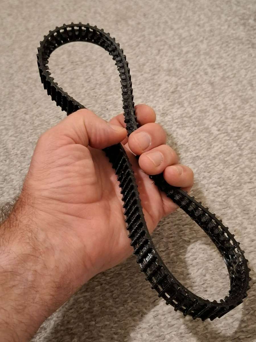

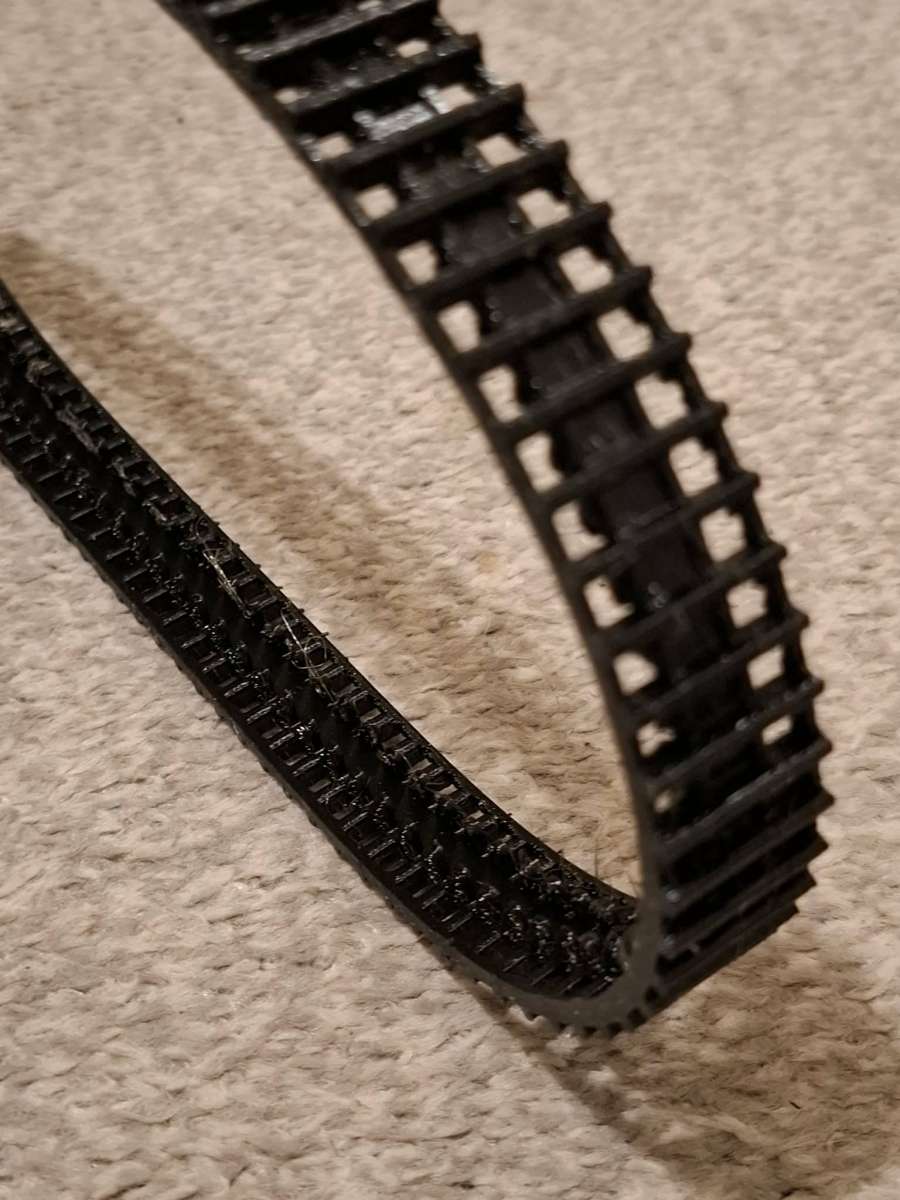

                      I’ve been experimenting with printing one-piece tank tracks in TPU.
                      Not the best photos, but this ‘proof of concept’ track seems pretty tough and dimensionally spot on. I have printed amore accurate track that better resembles individual links.
                      It seems pretty promising for subjects where individually printed links will be too fragile.
                      I think that printing drive belts in TPU would be feasible for emergency ‘keep you going’ purposes.
                      800594058_2475580776269069_9121881097461350280_n800230510_2356256231778596_8000608477232026608_n links.

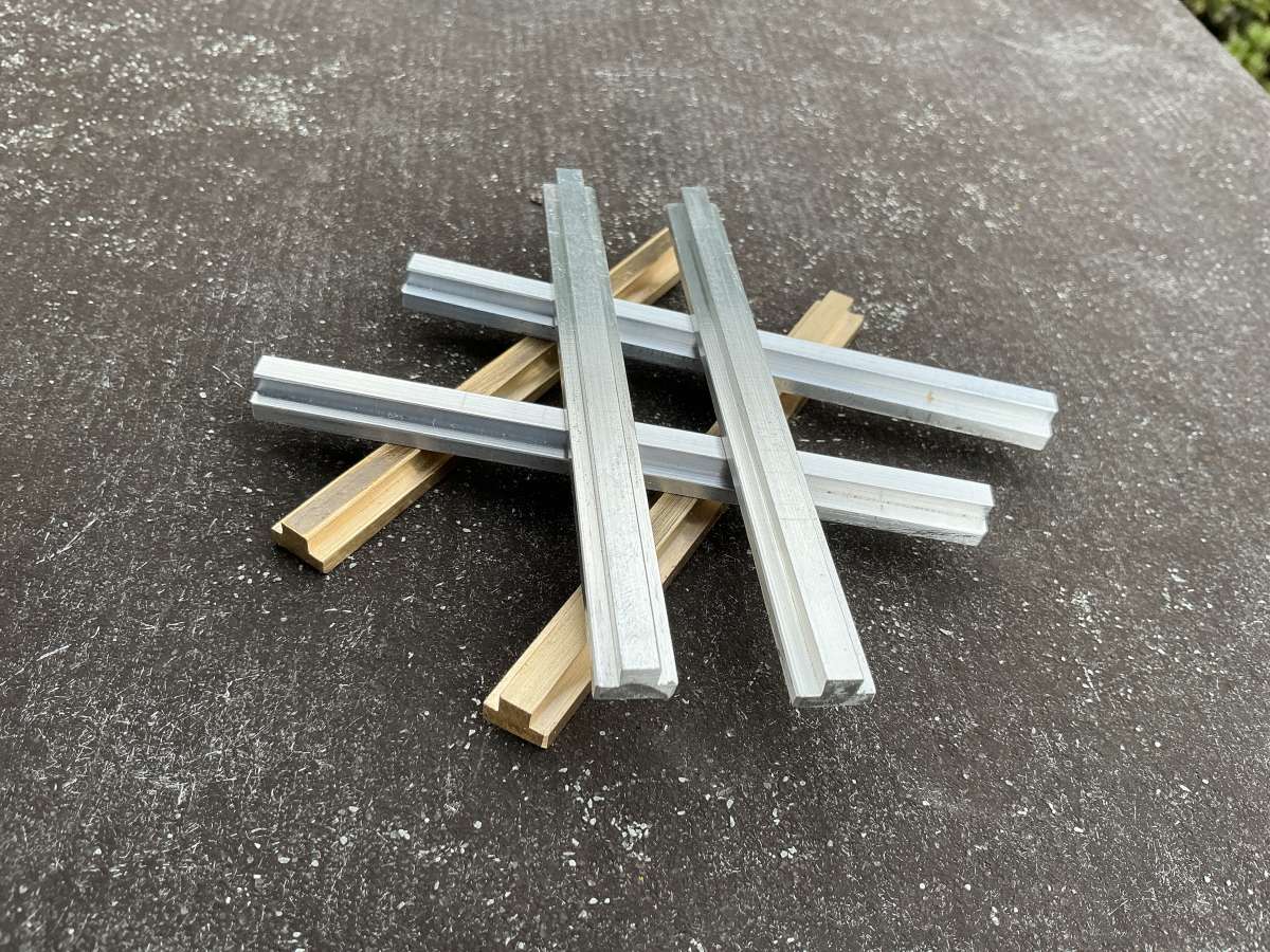

                        Had a couple of hours on the shaper making T nut strips for my Taig gearIMG_4163

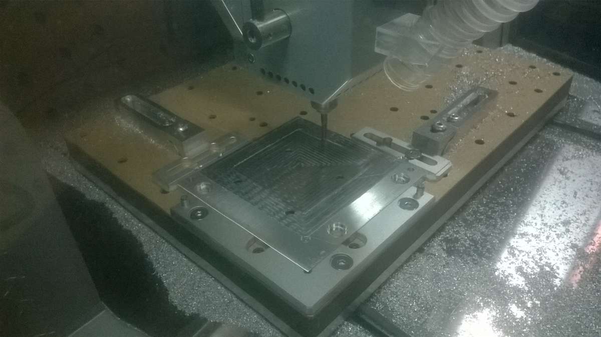

                          More time spent on the Carvera Air mill.  I’ve now installed the Carvera Community firmware and Controller to ease me into the use of my 3D probe.  The community software is more “advanced” than Makera’s own and is far more customisable.  I’ve also got a hand-held wireless remote on it’s way from the Orient and that’s simply plug-and-play with the Community controller.

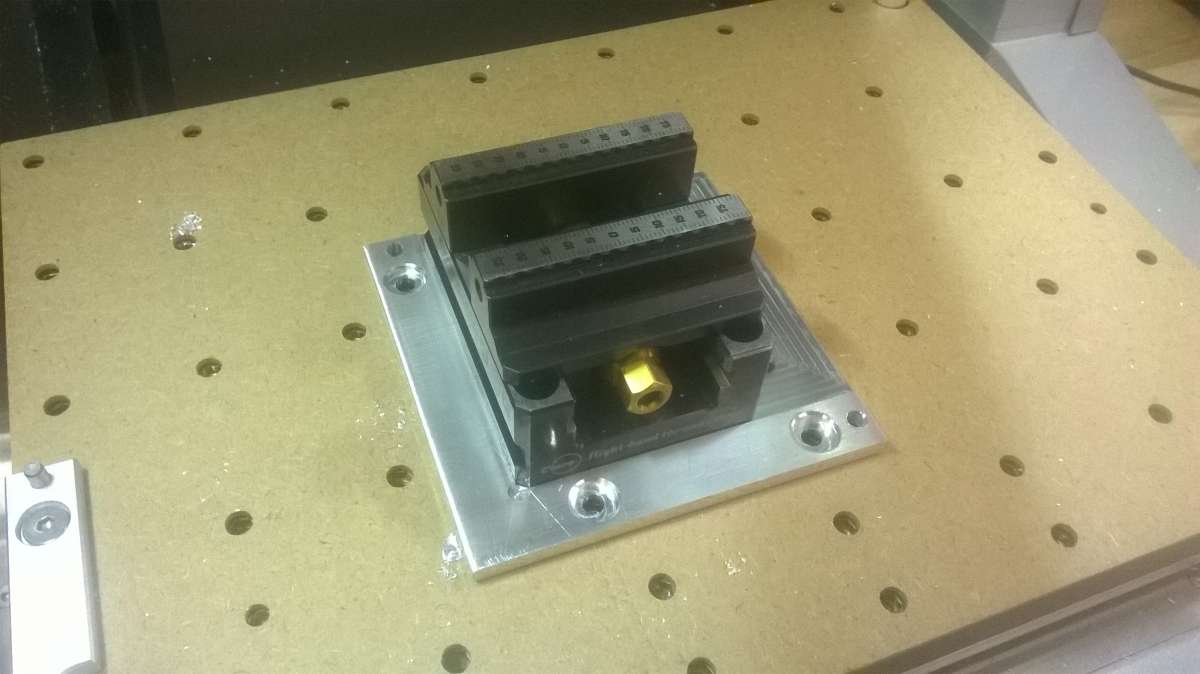

                          I bought a self-centring vice to hold small material and downloaded a STEP file from the web, having watched a video of a chap making one for his Carvera Air.  Had a bit of trouble with the file – holes in the “wrong” place, etc.  But it’s all sorted now and here’s a picture of the machine munching its way through the second side:
                          XinDian mounting plate
                          Not a very good photo, I’m afraid.  Here’s another poor effort showing the vice mounted on the plate and the whole assembly placed at Anchor point 2:
                          XinDian vice mounted on plate at anchor 2

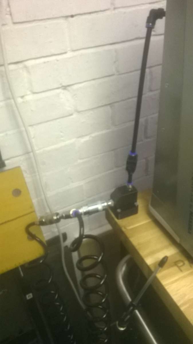

                          I use air assist to evacuate cut chips and had been frustrated by the mill’s lack of automatic on/off control of the air blast due to the removal of the actuating valve in the transition from Carvera to Carvera Air, in the interests of cost reduction presumably.  As I have to control the airflow manually, I’ve introduced a stop valve into the air supply externally, and the air assist nozzle incorporated into the spindle is now permanently on and directed at the point where a cutting tool edge will be.
                          I had to 3D print a manifold to accommodate the mill and a blow-down gun simultaneously but I have a neater aluminium one coming soon.
                          This is the set-up:
                          Air assist supply tap installation
                          Looks slightly out of focus now I’ve uploaded it.  The valve is the blob on the pipe going nearly vertically to the machine inlet at the top of the photo.
                          The next job for the mill is the sub table to mount the Makera Z1 vice to the Carvera.  As I explained in an earlier post, the Z1 and Air have different spacings for the mounting holes, although, thankfully the indexing pins are in the same place.  The vice arrived yesterday and I’ve only had to make a couple of minor alterations to the Fusion file and G-code and I expect to start cutting metal for that project either Monday or Tuesday.  Then I should be in a position to revisit the con rod saga.

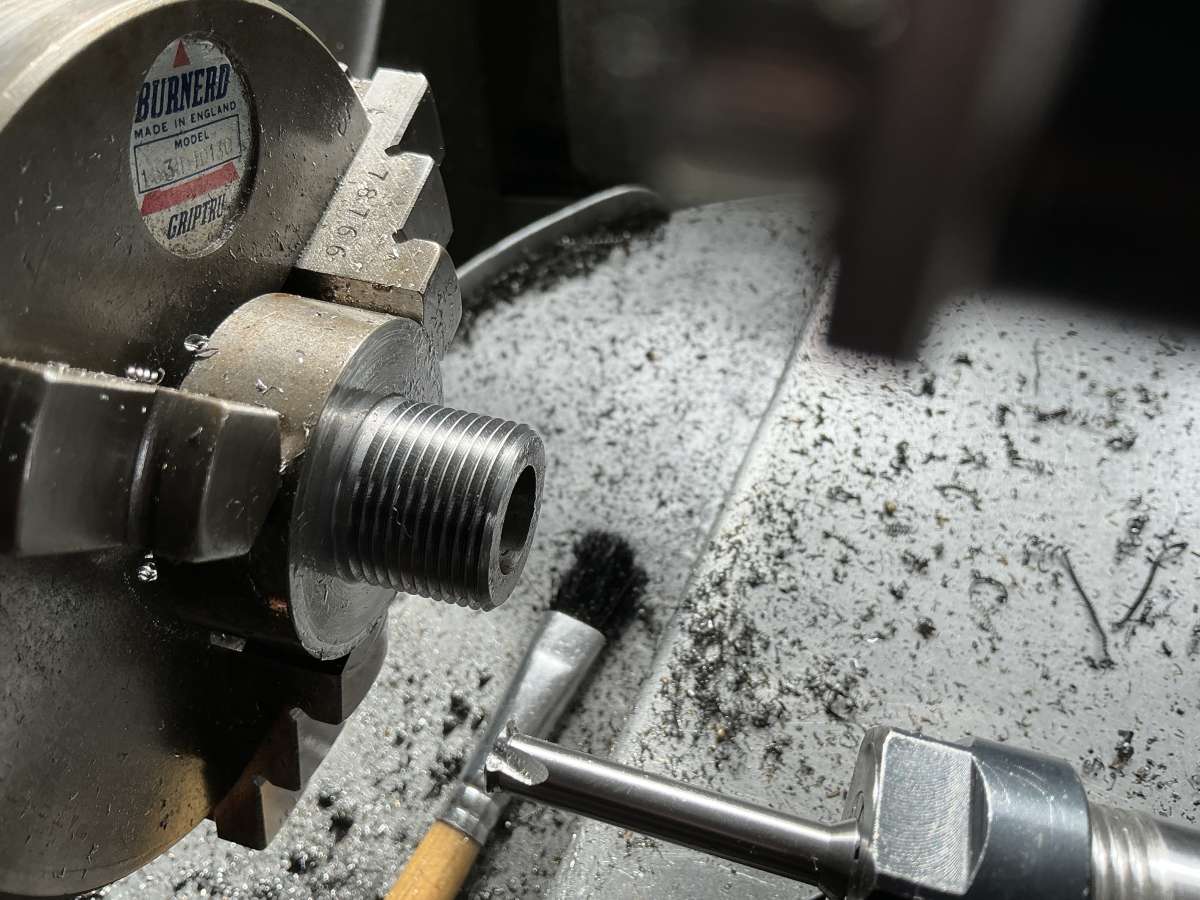

                            One of those days! Just three milled a 22 x 1.5 mm thread and looks good only problem is it’s LH. Imust have got out of bed on the wrong side this morning.IMG_4167

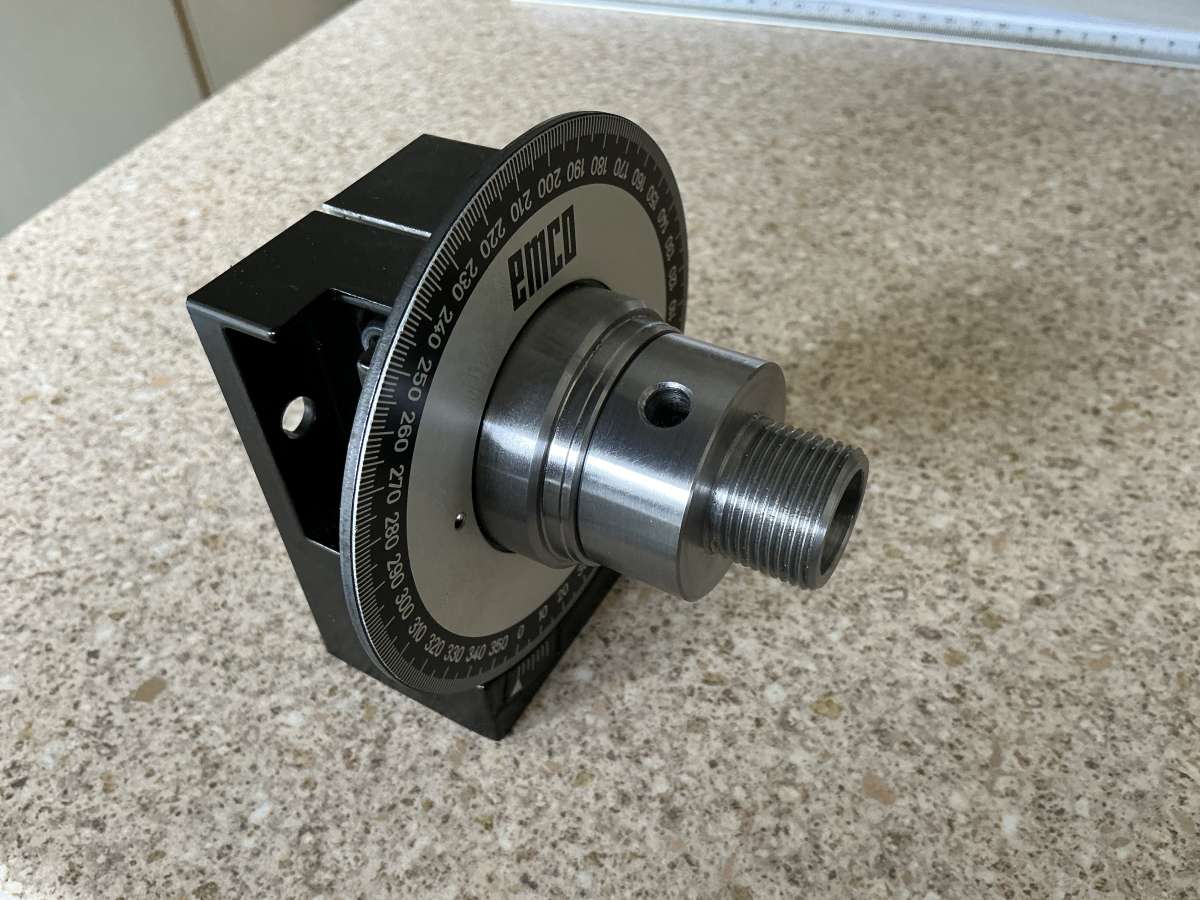

                            #867156
                            bernard towers
                              @bernardtowers37738

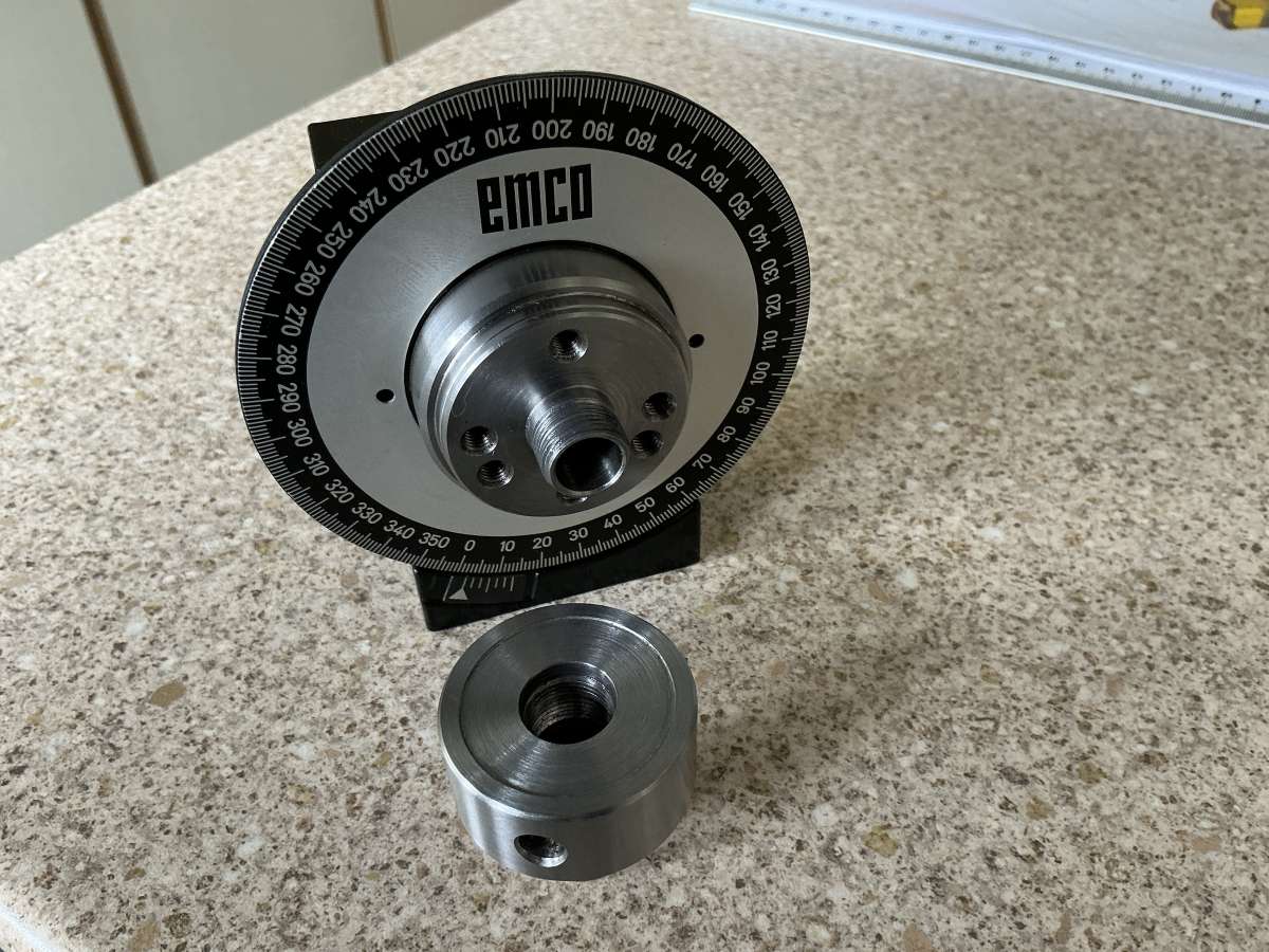

                              Got it right this time. Conversion from 14 x 1 to er16. Much more versatile.IMG_4172IMG_4171

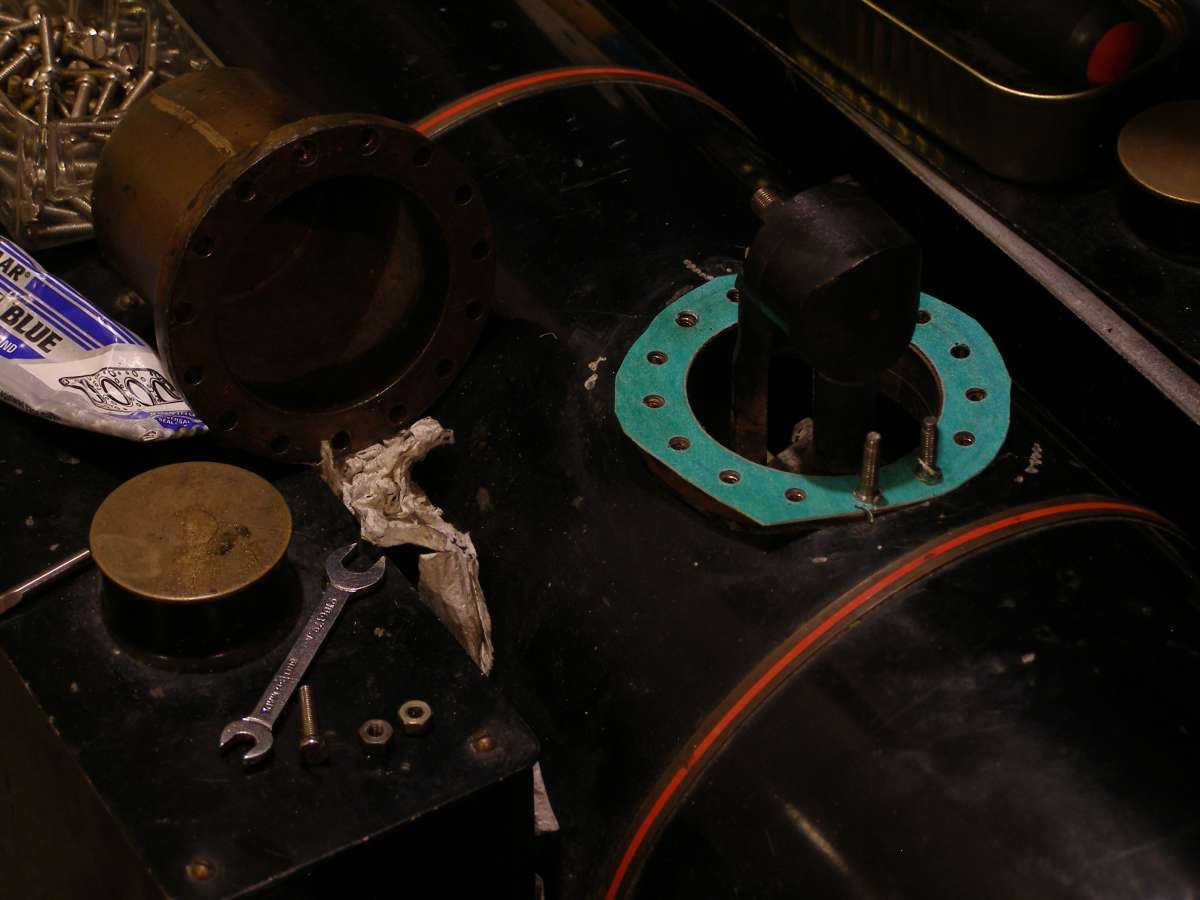

                                Gasket Making.
                                Well, Gasket-making Tool Making.
                                Sorry about the darkness, but this for the dome,
                                P1010012

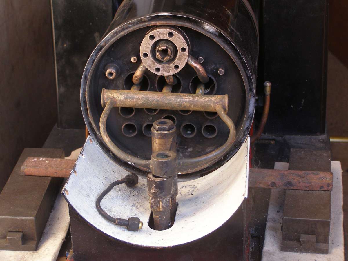

                                …. and two previously for this superheater header and its cover:
                                ‘P1010005
                                One common way is to use wad punches and hammering or slicing the gasket material against the component edges. Here I made cylindrical knives to drill the 1/32″ thick ‘Klingerite’ material, using whatever come-in-handy steel was to hand.
                                With such infrequent, specific use, the knives don’t really need hardening.
                                For the 15 4mm holes (for 4BA screws) in the dome gasket I combined the knife for the large hole, with its ½” dia pilot, as the location jig on a BCA ji-borer.
                                I’d cut the material to rough squares and taped it to a hardboard disc clamped to the machine table, with the pilot right through the lot into the machine table’s central hole.
                                Then simply stepped round 24º at a time,  using a prepared list of angles, to drill the little holes with their own purpose-made cylindrical knife.
                                I did not make a rotary knife for the rim, but simply cut it near to shape with scissors and used a small craft-knife to trim to finish after assembly.
                                The locomotive is a much-modified 7¼” g. version of LBSC’s Juliet. A hydraulic test revealed a leak between the superheater wet header and boilder bush. Dismantling revealed its six 2BA studs were in shallow, blind holes, with the threads in poor condition- one in fact stripped -and I am part-way through the repairs.

                                  Very neat job Nigel on what is always a tricky operation.

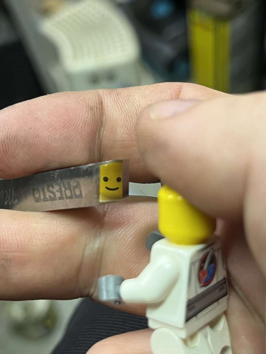

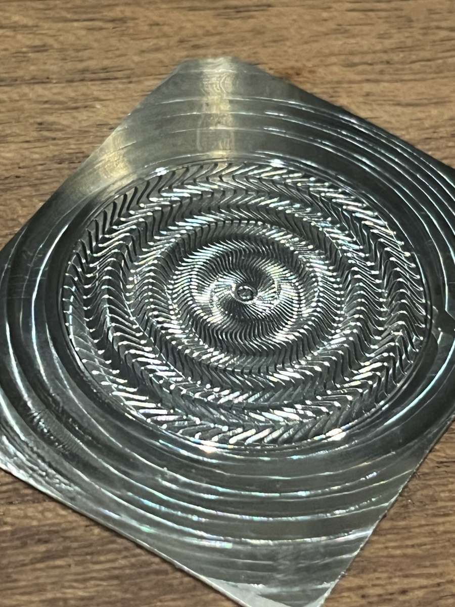

                                    Spent an hour or so yesterday polishing a tool:
                                    IMG_9777

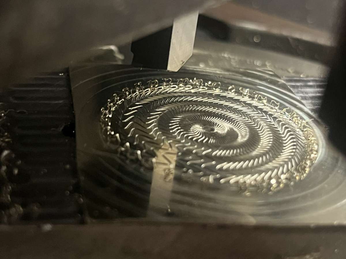

                                    In order to spend a couple of hours tonight making a dial blank:
                                    IMG_9783
                                    IMG_9792Happy with the finish.

                                      Lovely work, Dave! Your little inspector seems happy with it.
                                      Is it pressed work or some form of engraving?
                                      Thankyou Andy.
                                      I started to give the loco a preliminary hydraulic test but it was a losing battle with leaks. I thought the regulator would leak, and it certainly did, but so did the dome joint.
                                      Having removed the dome again, I traced the leak to the two 4BA studs that hold the regulator to the dome ring but also protrude upwards to hold the dome. It is a weak design, and one stud was loose by what seems a partially stripped thread in the regulator body – that part of it is hidden.
                                      It looked as if I could get away with a longer stud so made one this evening; also modified the superheater outlet banjo-union bolt so it can be plugged for the hydraulic test. The photo shows that connection badly misaligned but I think there is enough spring in the pipes to cope with that.
                                      Pu it all back together, willl try another test tomorrow, after the sealant has had all night to cure.

                                        Nice work Dave what’s the material?

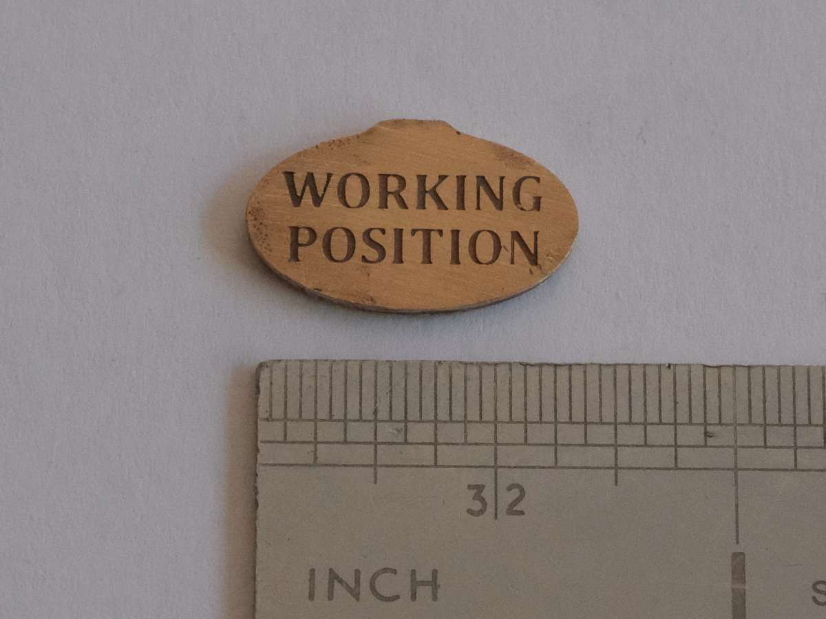

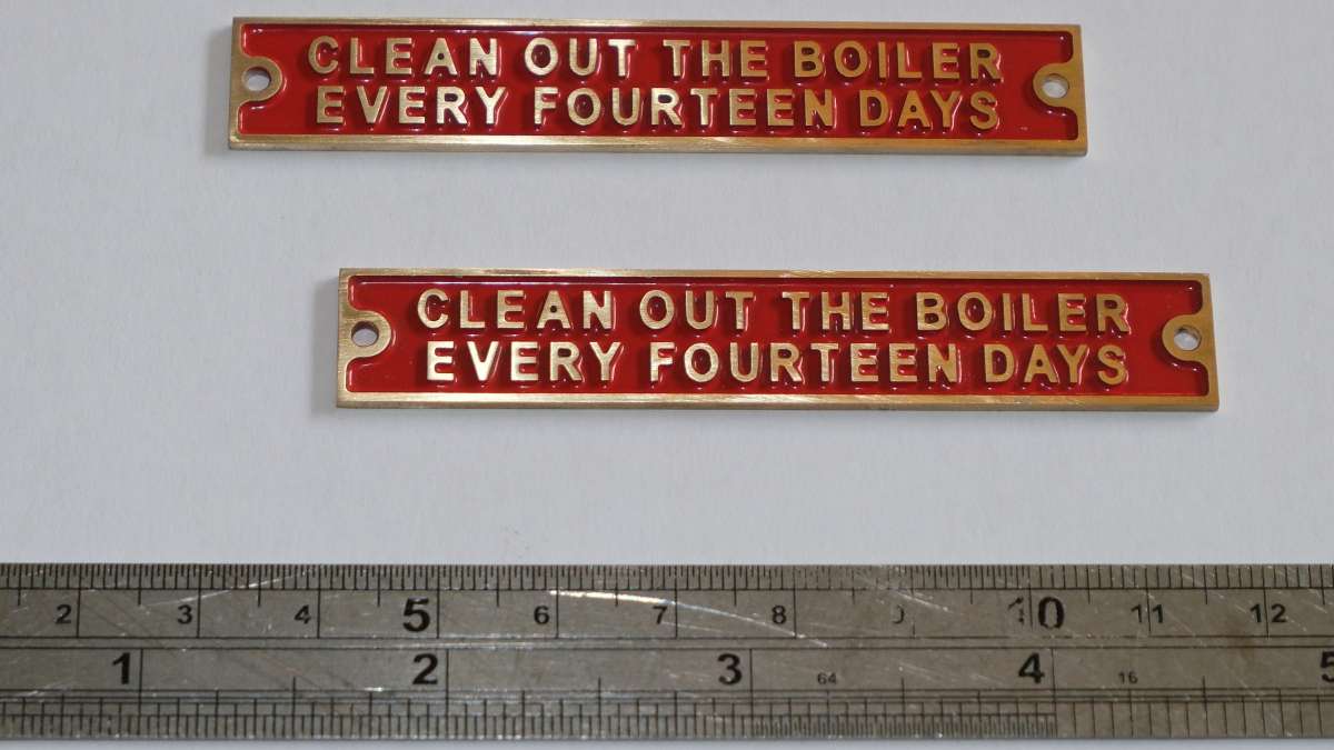

                                          JasonB ‘commented’ on my CNC milled nameplates due to rounded lettering, like this:
                                          Washout_Plates
                                          So here is an investment cast nameplate; lettering is 0.08″ high:
                                          Nameplate
                                          Saved me CNC milling them using a 0.15mm diameter cutter.
                                          Julie

                                            It’s engraved.
                                            Material is somewhat mystery metal. I’m *fairly* sure it nickel silver – cut out of an old sliver plated serving dish. No marks on it, but was with a load of other EPNS stuff.
                                            #867529
                                            martin haysom
                                              @martinhaysom48469
                                              Dave i like it. but can i ask, what is it for.
                                              #867555
                                              Dave S
                                                @daves59043
                                                It’s a test for a watch dial. At some point I need to stop testing and actually make the real thing…

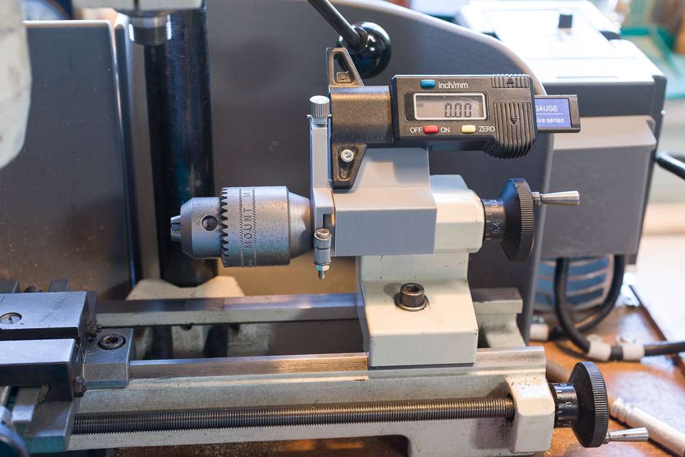

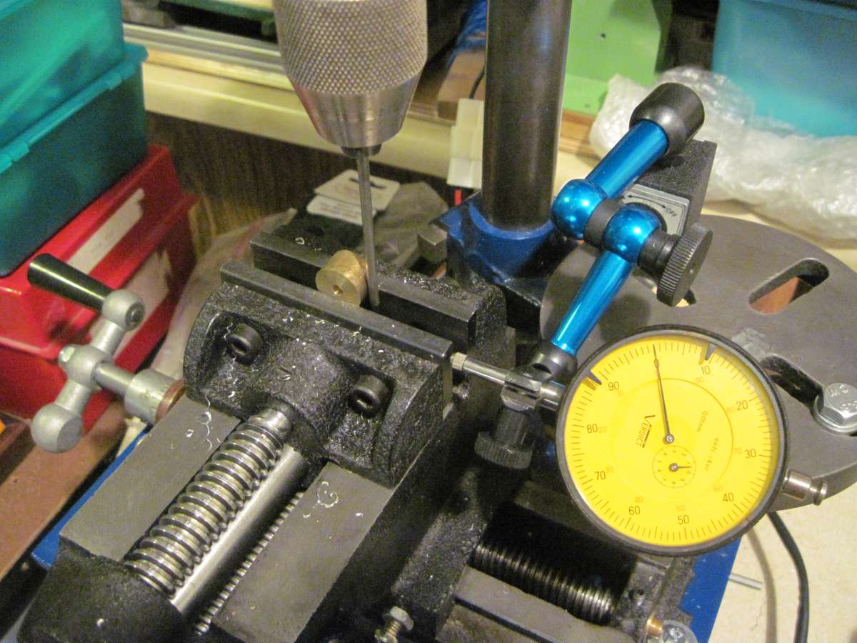

                                                    Today’s project; A digital readout for drilling depth on a Unimat 3.
                                                    A 3D printed collar tightens onto the tailstock quill.  A platform holds a cheap digital tyre tread depth gauge, the measuring probe is clamped into the quill collar.
                                                    I know it’s never going to be accurate to 10 microns, or whatever it displays, but should be good to the nearest half millimetre which will be good enough for my current needs.
                                                    Can all be stripped off in a jiffy leaving no marks.
                                                    Grand cost £3.
                                                    3J1A1903
                                                    #867648
                                                      Are the tailstock graduations not adequate for your half mm needs? I would have thought the 0.05mm increments better than that and with no loss of tailstock travel.
