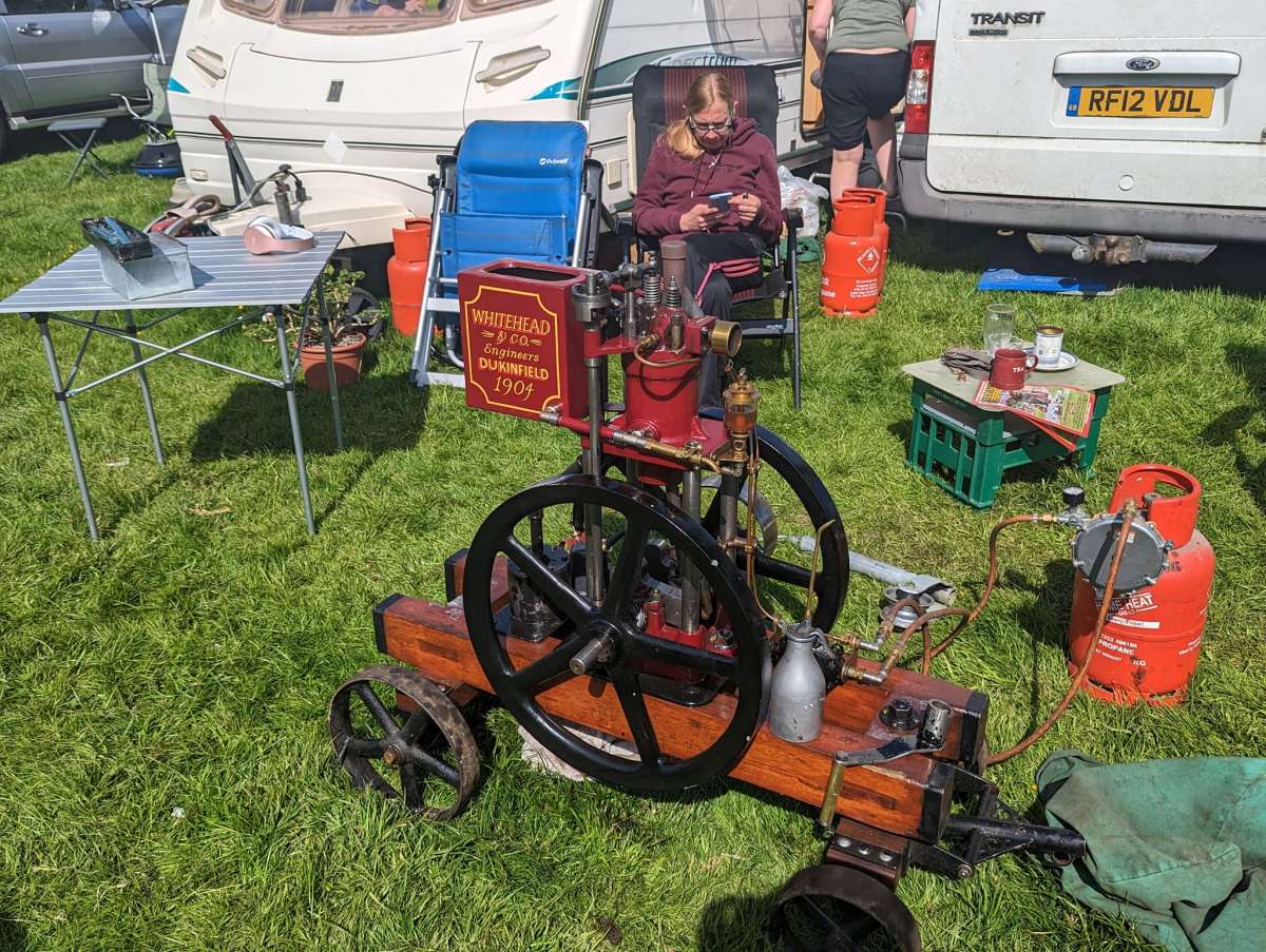

      I’m not sure when this engine first caught my eye but I have had this photo in my “Future Projects” folder for some time.
      whitehead
      There is very little information to be found for Whiteheads or any of their engines. The “A-Z of British Stationary Engines” does have it listed with a copy of this illustration and a summary of the text.
      whitehead 3
      I have been unable to find any views showing other sides of the engine and asking around on the Stationary Engine Groups, it appears they are very rare, the one in the photo is said to have been reconstructed from just a few remaining original parts and it is said there is another more original engine but that is not shown in public. After making a start I did find a short video but once again taken from the same position.

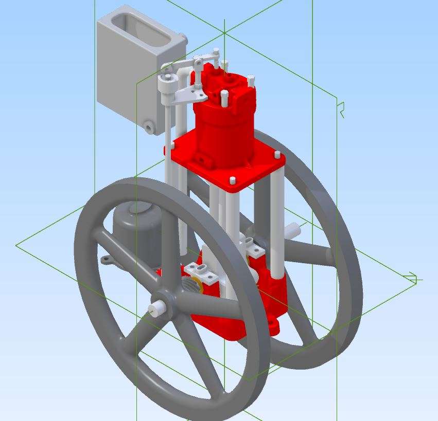

      I made a start on the design by importing the image into Alibre and scaling it to suit 230mm flywheels which works out at just a bit larger than 1/3rd scale. There had been a few comments on the FB Groups that other may be interested in making one so I designed it with using castings for the flywheels and base in mind. This is the basic design with a few of the smaller details to be added as work progressed.
      wh 3d

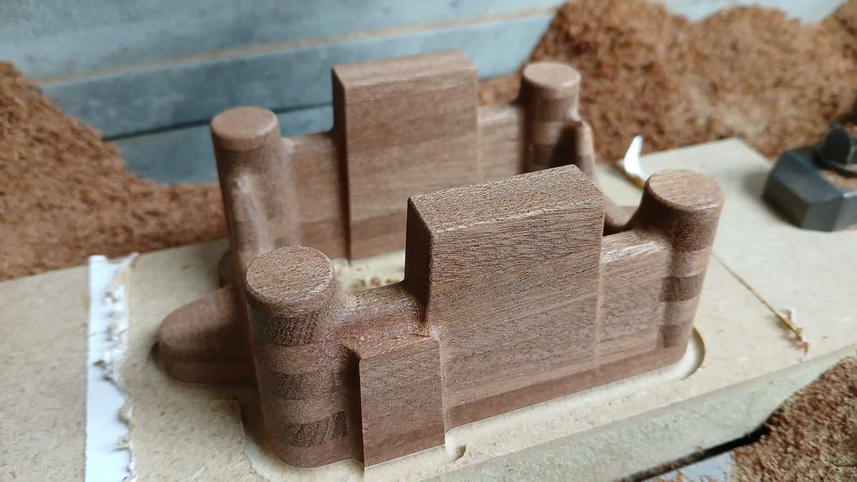

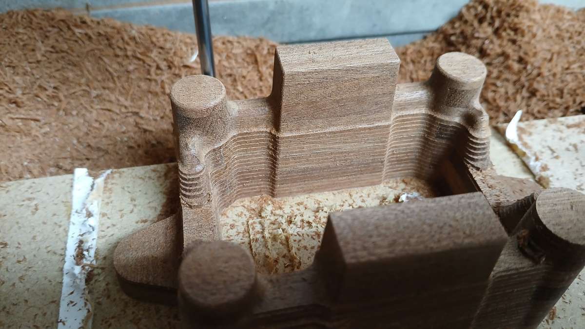

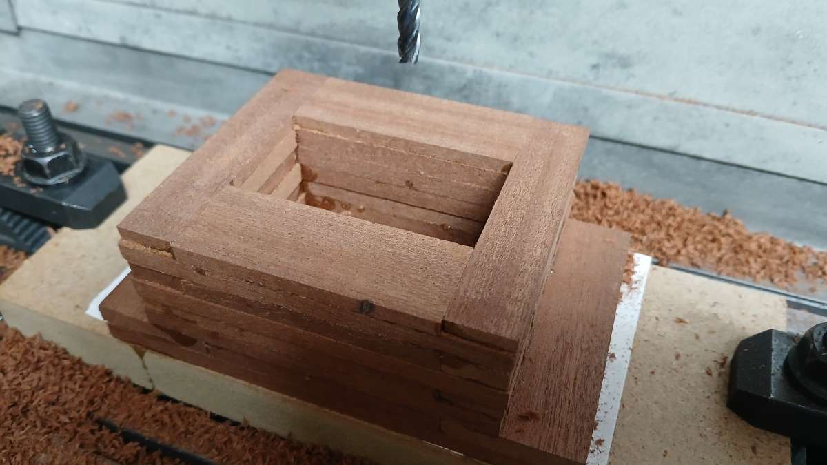

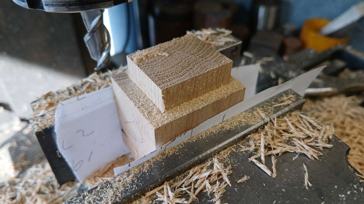

      Starting with the patterns. To reduce the amount of cutting time on the CNC and also to get a more stable pattern the basic shape was glued up from strips of hardwood and stuck to a piece of MDF with a sheet of paper in the joint which makes it easy to remove from the MDF once complete.
      20251021_090628

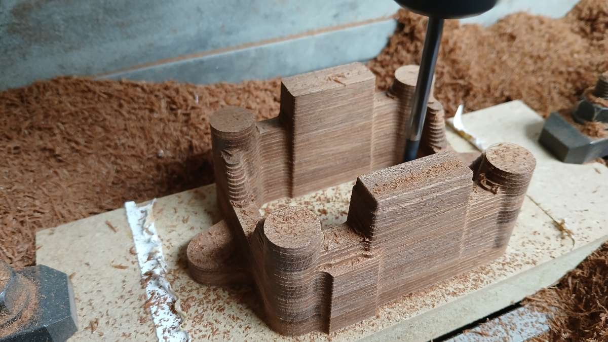

      The roughing cuts were done with a 6mm long reach flat ended cutter, 8mm DOC followed by a 1mm stepdown which leaves a contoured look.
      20251021_105043
      Then a swap to a long reach 4mm 4-flute ball ended cutter using a 0.25mm stepdown refined the surface, part way through, then complete. This finish only requires a very light sand to have it ready to paint.

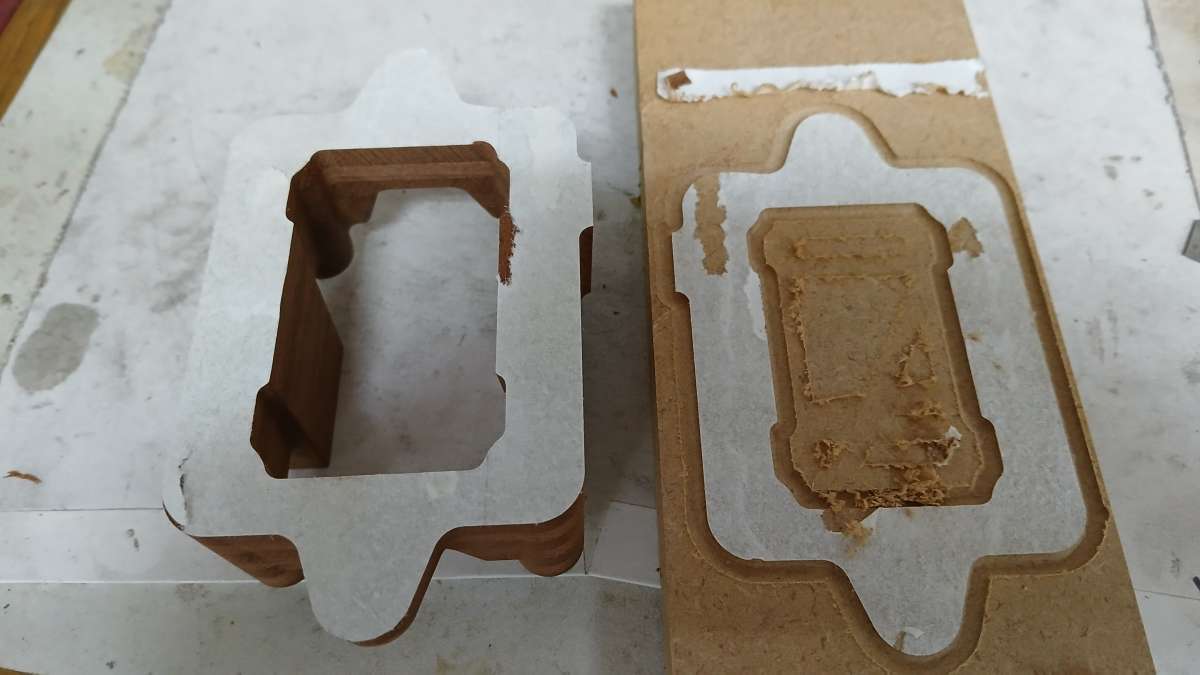

      20251021_110908
      20251021_120819
      A quick blow with a chisel and the part is separated from the MDF base.
      20251021_144818

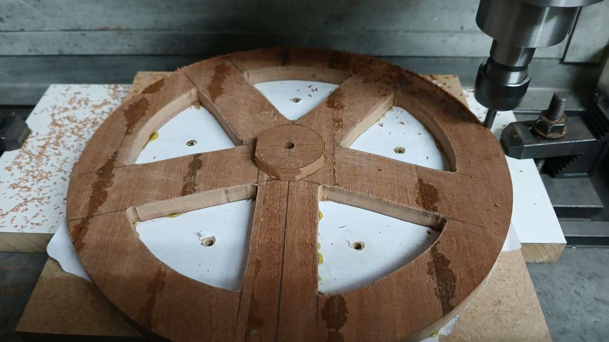

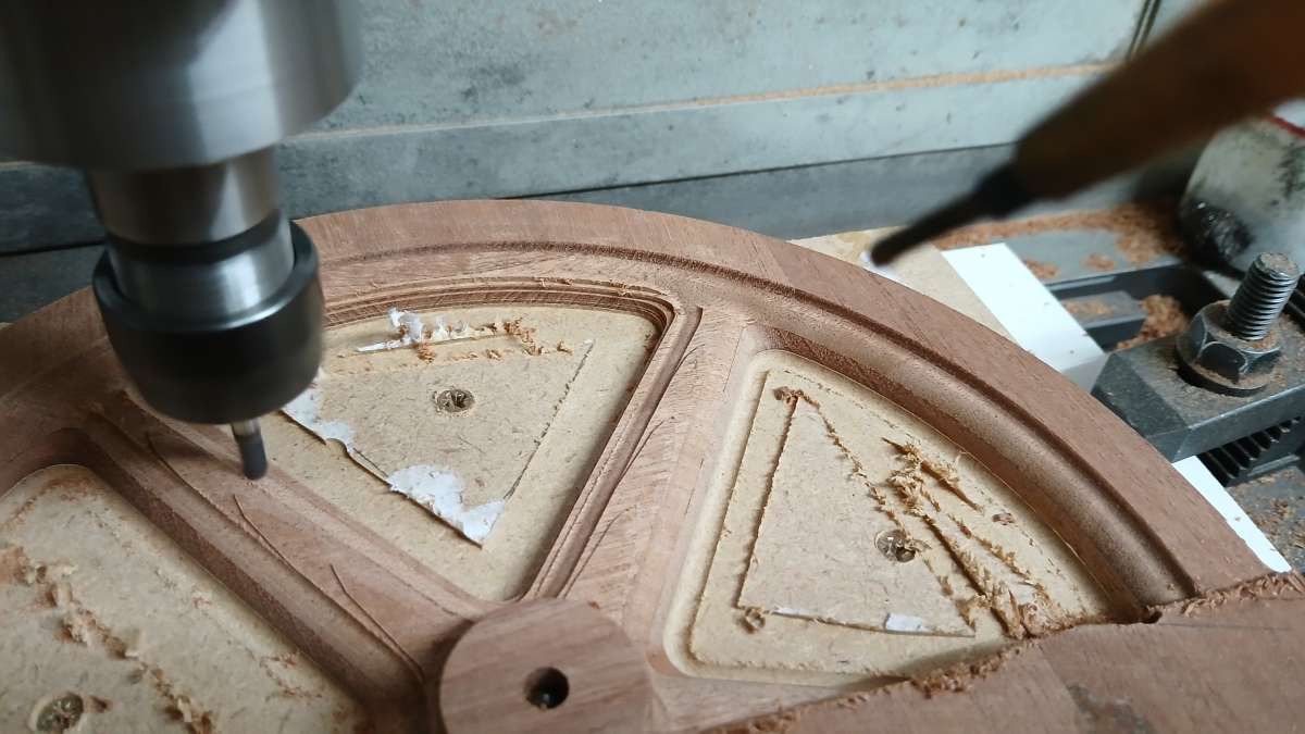

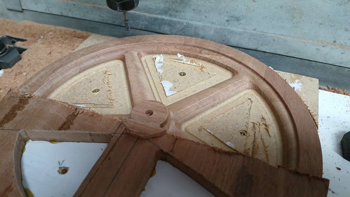

      The flywheel was done in much the same way but as I did not have the Y travel each side had to be done in two halves, rotating the blank 180deg.
      20251024_140203
      20251024_155115
      20251024_163858
      The Sapele that I used did not come from my usual source and after bringing the flywheel pattern inside a night of central heating caused it to warp. It went back flat after a few days in te hworkshop but Idid not want to risk it moving in a hot foundry so decided to get patterns 3D printed in ABS, the base was OK.
      After a few hours sanding the printed pattern was good enough for several layers of High Build primer and then gloss. The base was a lot easier to get prepped & painted. Patterns ready to be sent off for casting.

        Looks like an interesting theme for a model. Do you remember where you took the photo if so try contacting the club that arranged/ run the stationary engine display at the event?
        Or try some of the stationary clubs around the area of the event.
        Some may know the owner who could possibly send some all round photos
        #861968
          The image popped up on the web and I saved it.
          Having learnt that there is very little of the original engine there from the stationary engine community, I’m not so concerned about originality. It is likely that just the main castings are original  – base, cylinder, head and flywheels. The cooling tank arrangement is not original but I like it so will model it.
          This is the video that I found
          #861972
            I presume you’ve seen this, Jason
            https://www.instagram.com/reel/DZu5X0jM89M/
            My wild guess is that the location was Astle Park
            #861975
              Thanks Michaael, no it is not one I have seen. Looking at the dates of the comments it looks like it was posted a couple of months ago by which time this build was well advanced. I can confirm that mine has a duck in it rather than the frog mentioned in the description. 😉

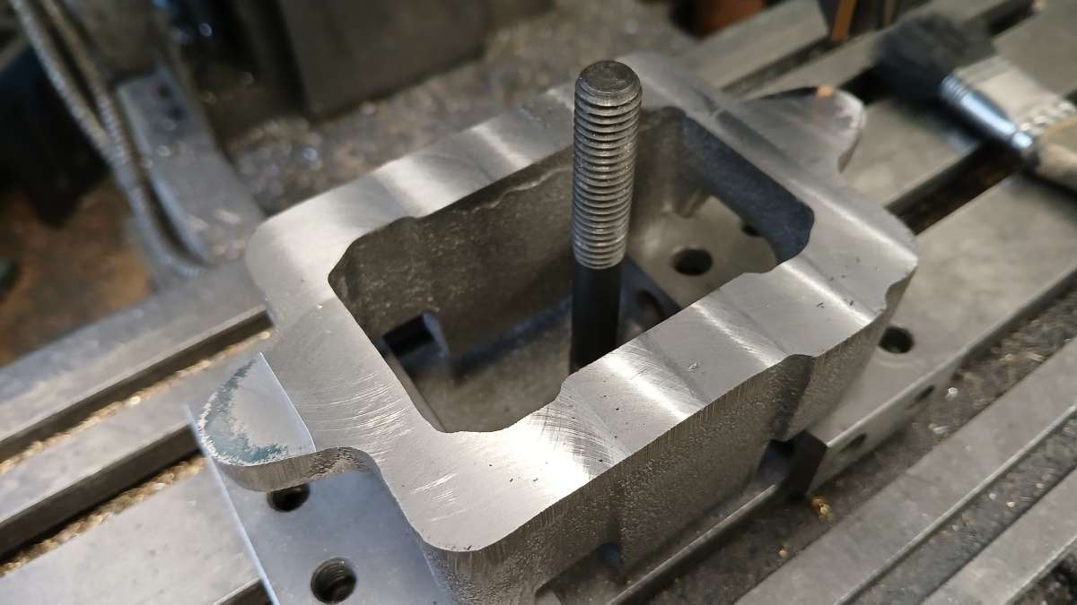

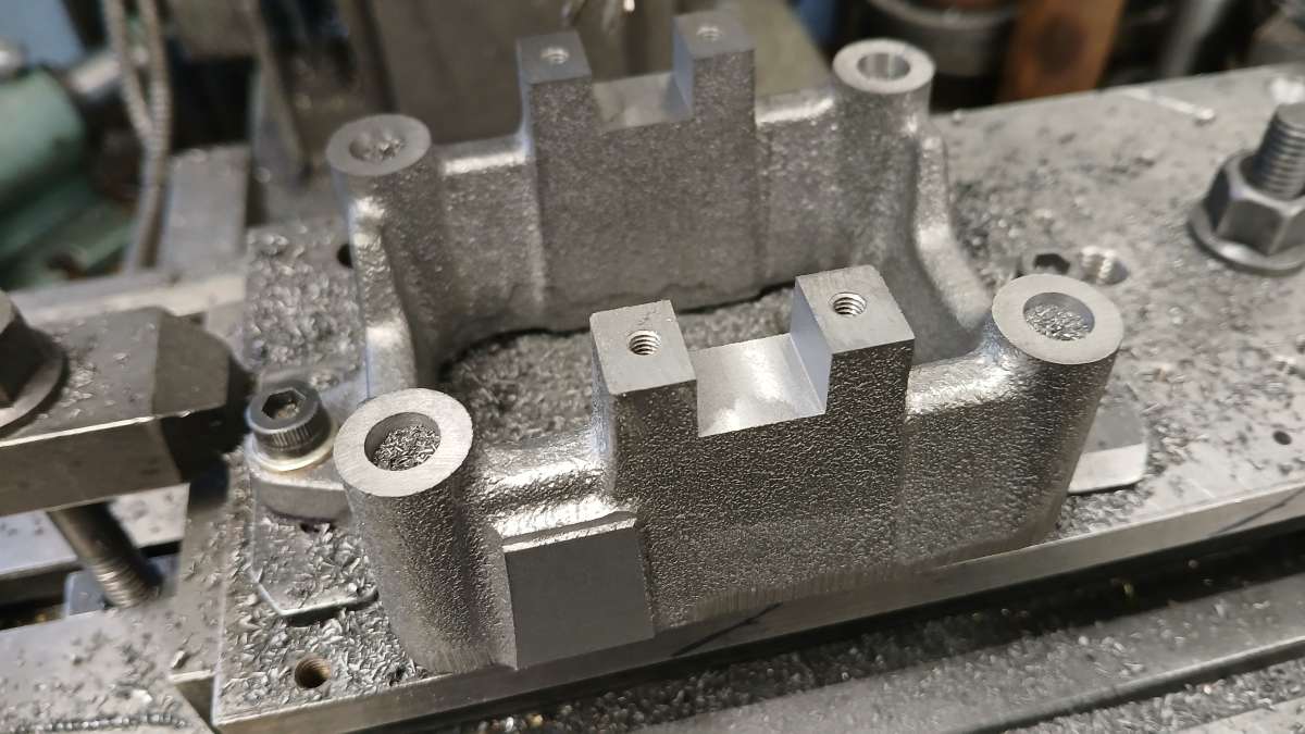

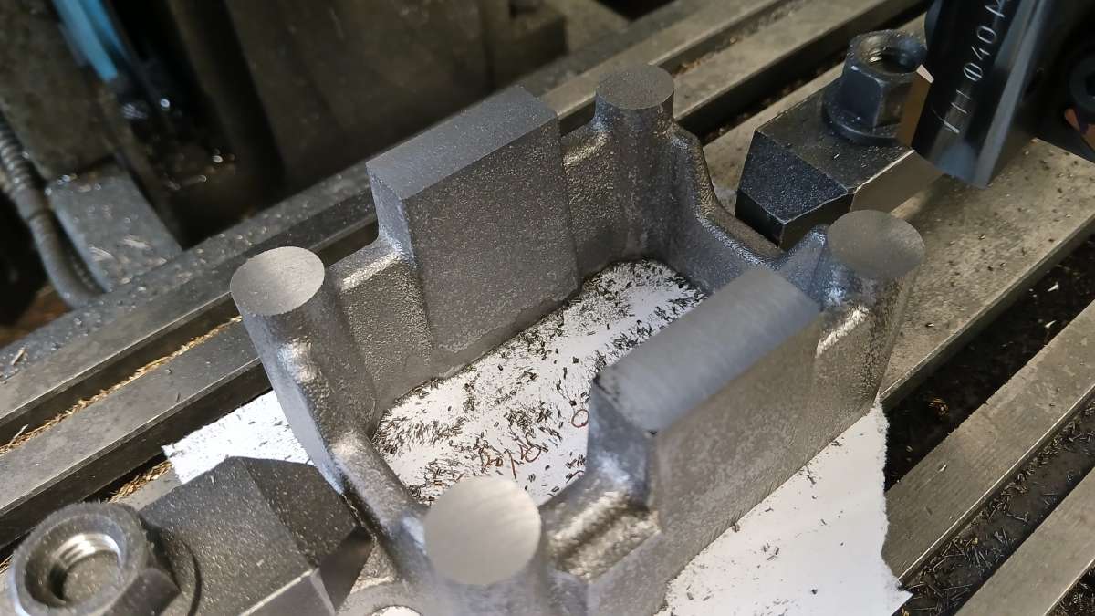

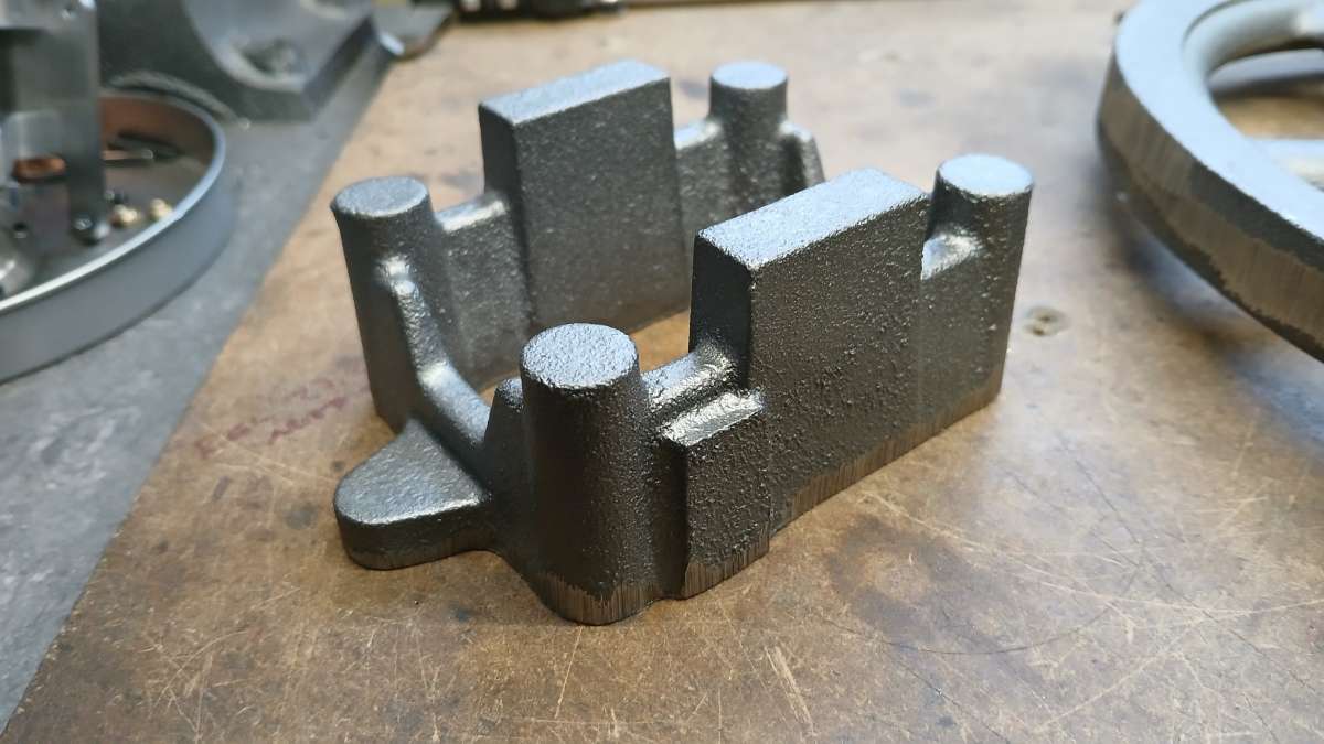

                  The castings arrived in just over 2 weeks which was a lot better than the 6-8 weeks that East Coast Castings had said they would take. The flywheels were very good.
                  20251127_133633
                  The base was a little rougher than I would have liked on the vertical faces, This seems to be a problem with most foundries using an airset sand as they dump a load in and just ram it down rather than packing it against the vertical faces. Fettling was a bit closer than I would have liked too but I can work with it.
                  20251127_133700

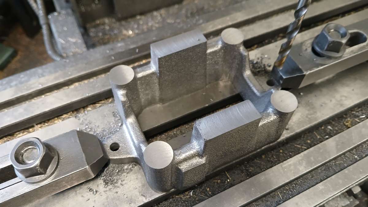

                  The bottom of the base casting was fairly flat so a quick file and it was clamped down to the mill table and a skim taken off the top of the corner posts and bearing housings, you can see a tiny amount of cill on the bearing housing corner but I had allowed a decent 5mm machining allowance expecting these finer features to be the most at risk of chill.
                  20251129_111727
                  With some flat surfaces the casting could be clamped down and the bottom face properly machined flat.
                  20251129_113131
                  Then back up the right way to drill the holes in the hold down lugs
                  20251129_121021

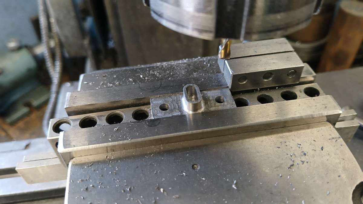

                  These holes were then used to mount the casting to a machining plate where the posts and bearing housings were milled to final height, holes drilled and tapped and in the case of the corner posts counterbored to accept a spigot on the columns. I also milled out the rectangular pockets for the bearing caps. The vertical pad at the front is to take a bracket that supports the bottom end of the cam shaft.
                  20251205_145051
                  I did not have the caps cast but instead machined them from cast iron bar, the CNC did the oval oil pockets and a cutter with a 1mm corner radius left a fillet around the pocket so it looked like a casting.
                  20251210_134905
                  The other side was milled to form a tenon to fit the base.
                  20251210_134725
                  With the caps screwed intoo place the machining plate made it easy to set the casting square for boring the bearings. After this the last 1mm was taken off the top of the bearing housings so that the caps would bear down onto the bronze bearings.
                  20251212_142945

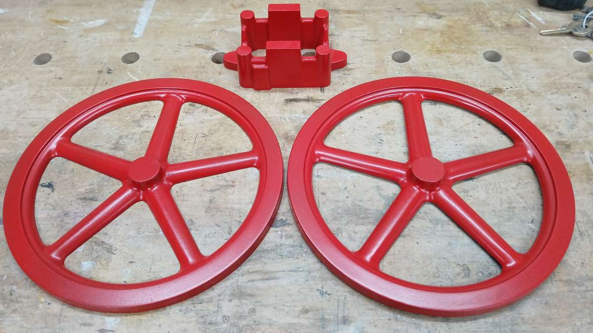

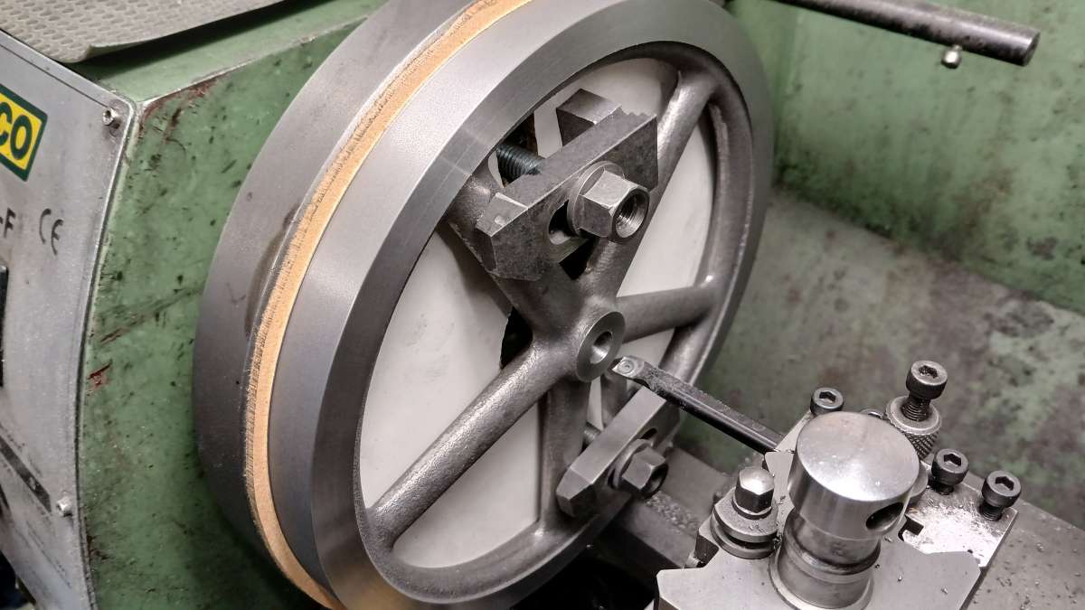

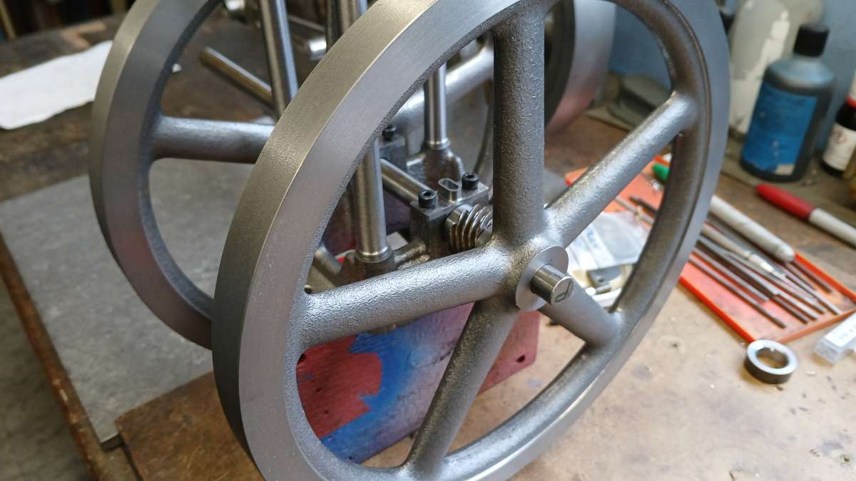

                    Not much to say about machining flywheels that I have not said before. Five Spoke layouts are always a pain to hold as you usually can’t get 3 or 4 jaws inside the rim without the spokes getting in the way so I mount them on a faceplate with a bit of 6mm MDF between. That way I can completely turn the face, one side, the hub and bore all in one setup. The hub was bored using a piece of the 12mm PGMS that will form the crankshaft as a gauge.
                    20251222_144118
                    Here they are slipped into position to get a feel for how they will look. The columns have also been made which are just tapered shafts with threaded spigots on the ends.

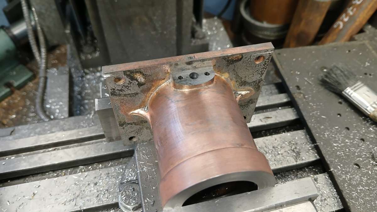

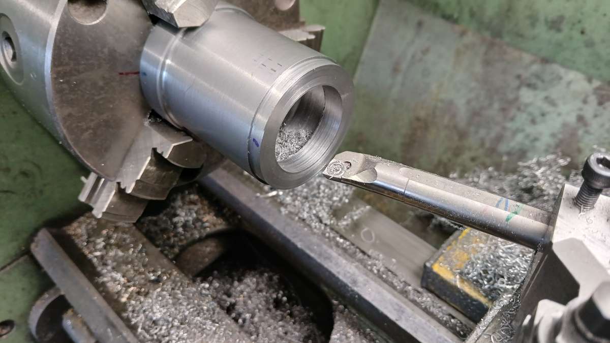

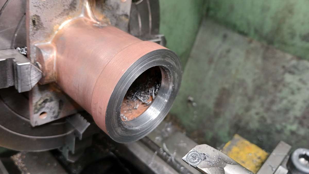

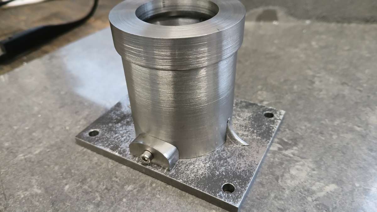

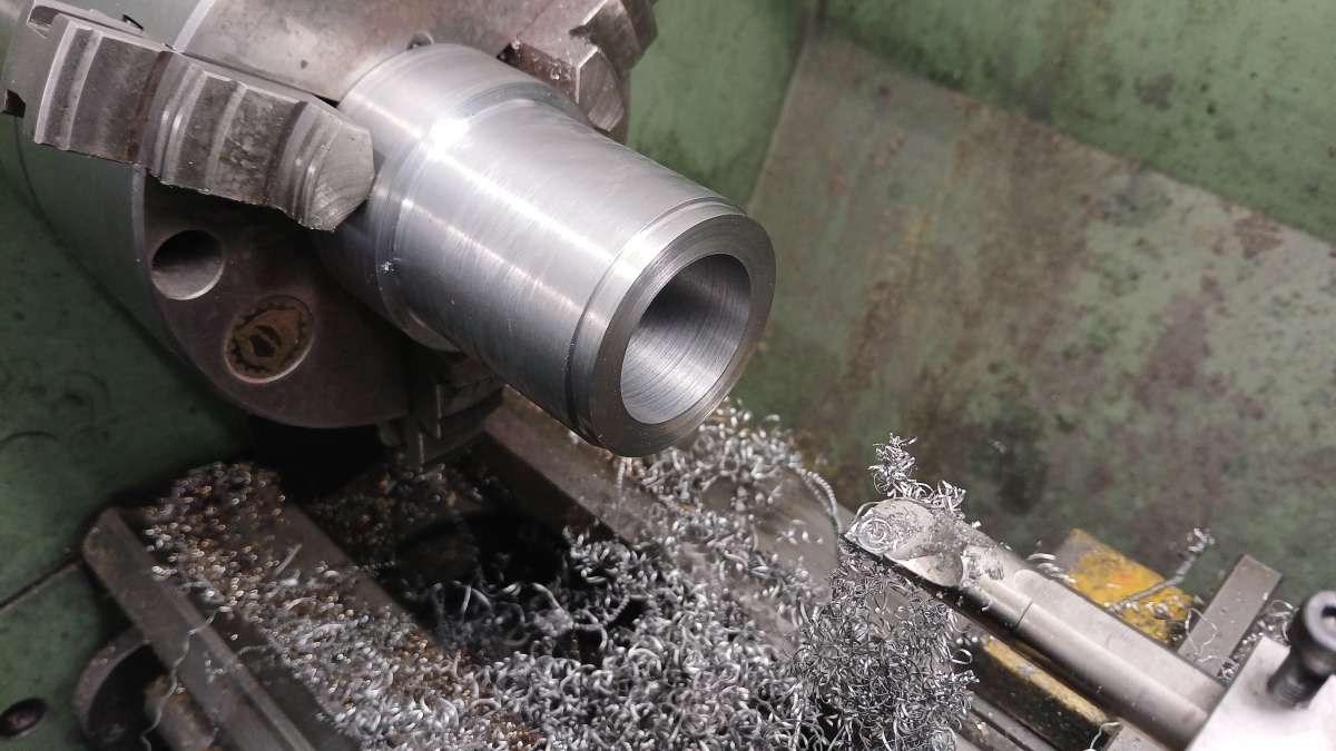

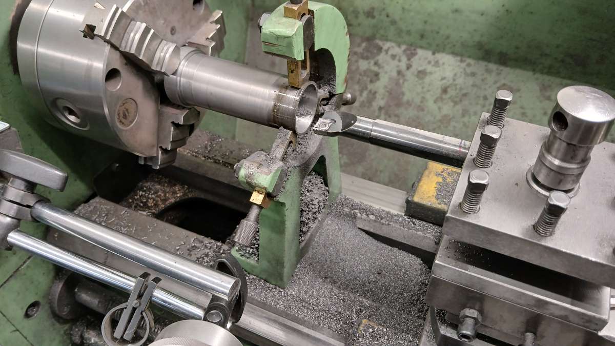

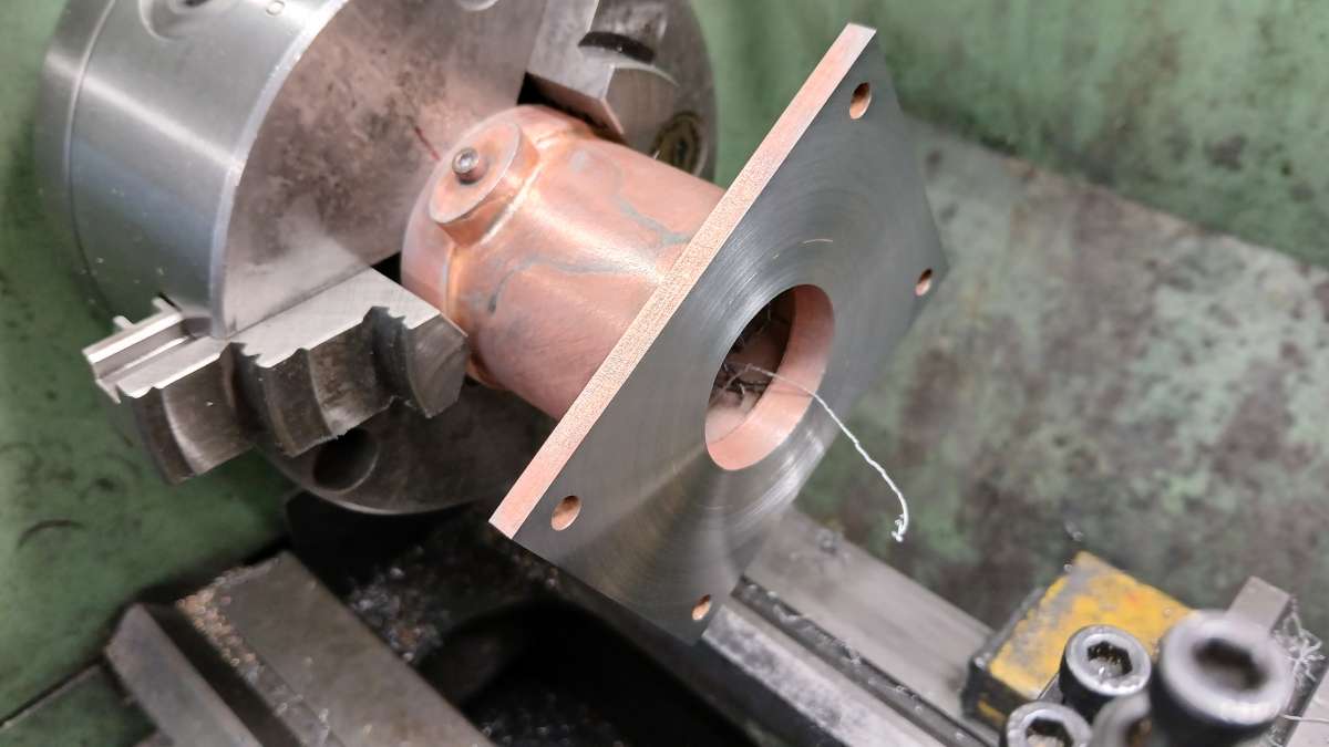

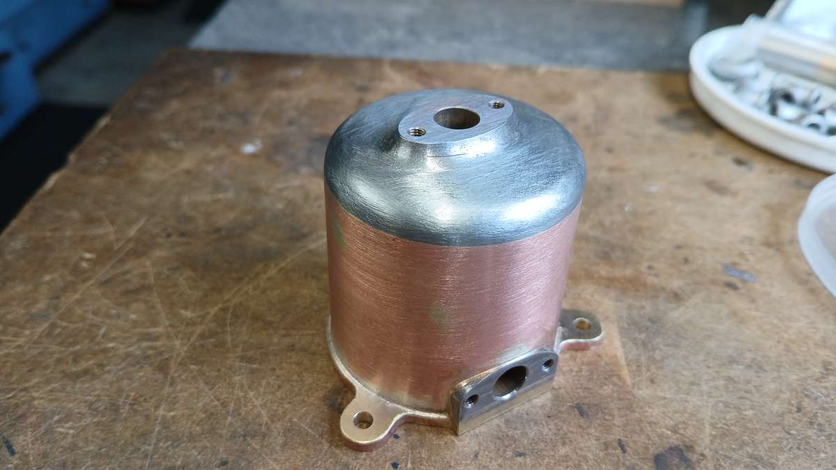

                    The cylinder jacket started life as a piece of 55mm dia EN3 and was roughed out to shape, the short spigot on the end will locate in the entablature plate.
                    20251218_144100
                    With the boring bar held at an angle and coming in from both ends the middle was hollowed out to form the water space
                    20251220_093754
                    There are two small webs at the base of the water jacket, these were formed on the corner of some 5mm plate and then the mill used to cut them from the plate.

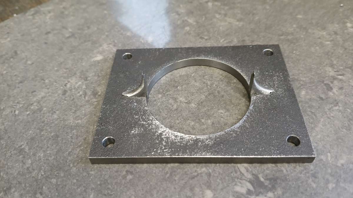

                    here they are stood in place on the entablatur eplate which was cut from over thickness 6mm material, drilled and the central hole bored to accept the cylinder jacket.
                    20251221_103432
                    The water bosses had there oval profile cut on the CNC, a boring head was used to do the concave cuts to suit the jacket and a holes drilled so they could be screwed in place to solder.
                    20251221_110255
                    20251221_113601
                    After a pickle the bottom of the entablature plate was faced down to it’s final 5mm thickness.

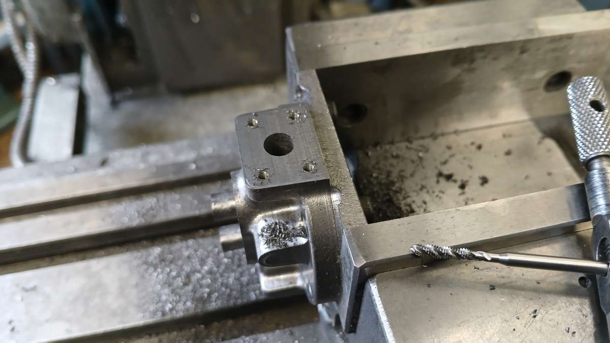

                    20251221_142114
                    Lastly the water bosses were milled off flat, drilled for water and tapped for the flange studs.

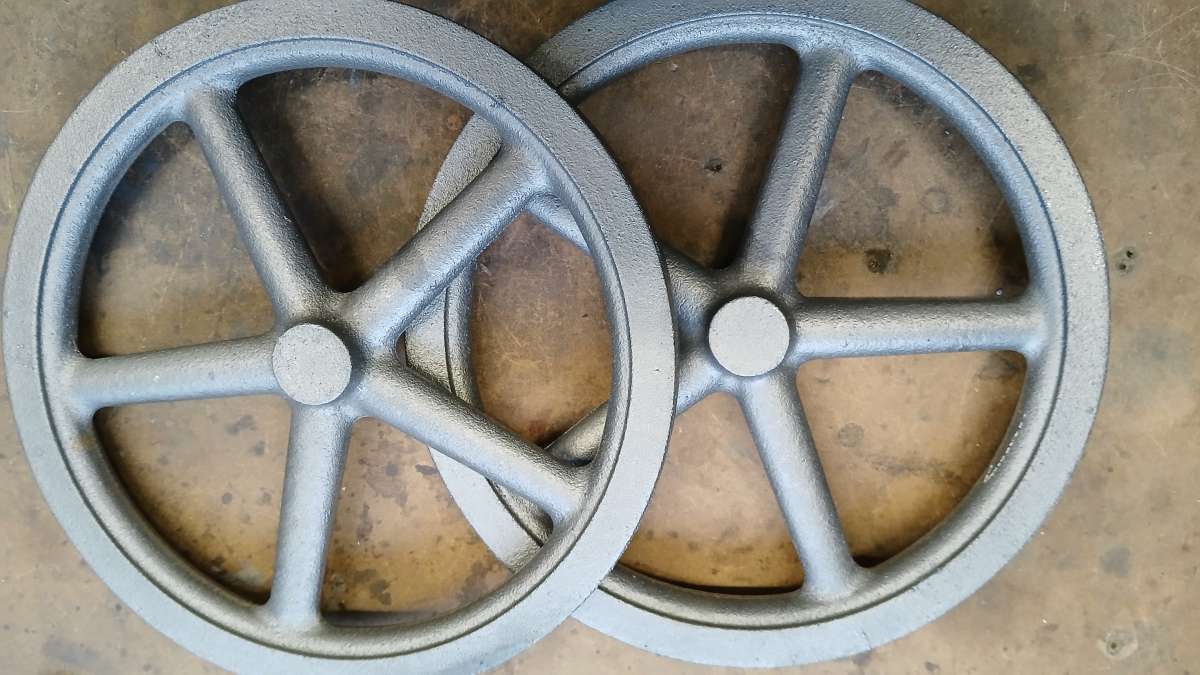

                      As usual, all looking very good so far Jason, those flywheels look like superb castings. Looking forward to seeing the finished engine which shouldn’t be too long by the speed of progress so far.
                      Andy.
                      #863730
                        Thanks, Andrew, yes the flywheels came out very nicely and needed very little clean up.

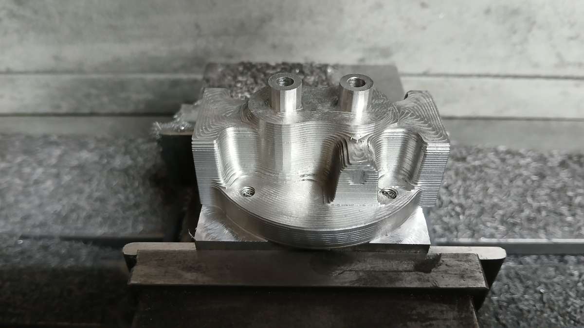

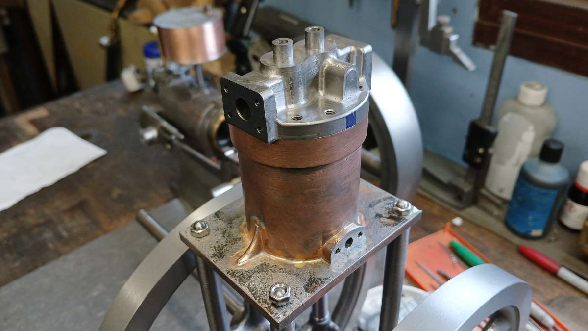

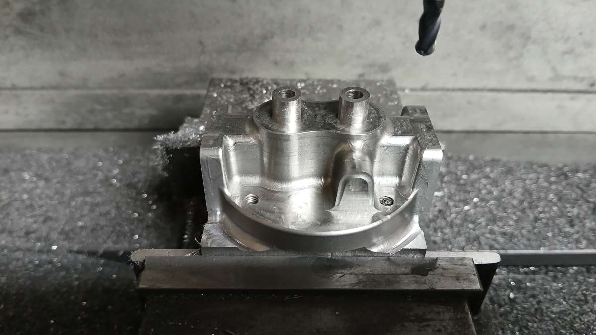

                        I toyed with the idea of making a pattern for the cylinder head but in the end took the cheaper option of cutting it from a slice of 65mm dia cast iron bar and letting the CNC cut the iron rather than wood.

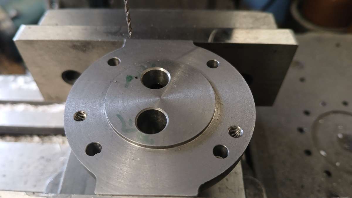

                        The first job was to machine the underside of the head including a spigot to locate in the cylinder liner. I then moved over to the mill and tapped what will eventually be the clearance holes for the head studs so that I could screw the head to a holding plate to give easy access all round for machining. I also ctr drilled the position of the valves at the same setting.
                        20251028_141522
                        Back on the lathe the valve guide holes were clocked in, drilled and reamed, the cavity behind the valve heads opened up and the seats cut at 45deg using the top slide which keeps everything concentric. I actually only needed to angle the exhaust valve seat but got carried away and did both!
                        20251028_145502
                        Then onto the CNC, this image shows the contoured effect that the initial adaptive cuts leave.
                        20251030_132122
                        Then various other paths were run to shape the “cast” surfaces and leave the “machined” faces flat and true
                        20251030_154237
                        With the head still attached to the holding plate it was easy to hold on the manual mill for the last few operations which were mainly the inlet and exhaust passages and the tapped holes around those for flanges.
                        20251102_090040
                        This engine has an atmospheric inlet valve where the vacuum caused by the descending piston opens the valve, this can also be used to act as a demand valve for the Propane gas that will fuel the engine by having the flat valve also cover a small 0.7mm gas passage.
                        20260228_091631

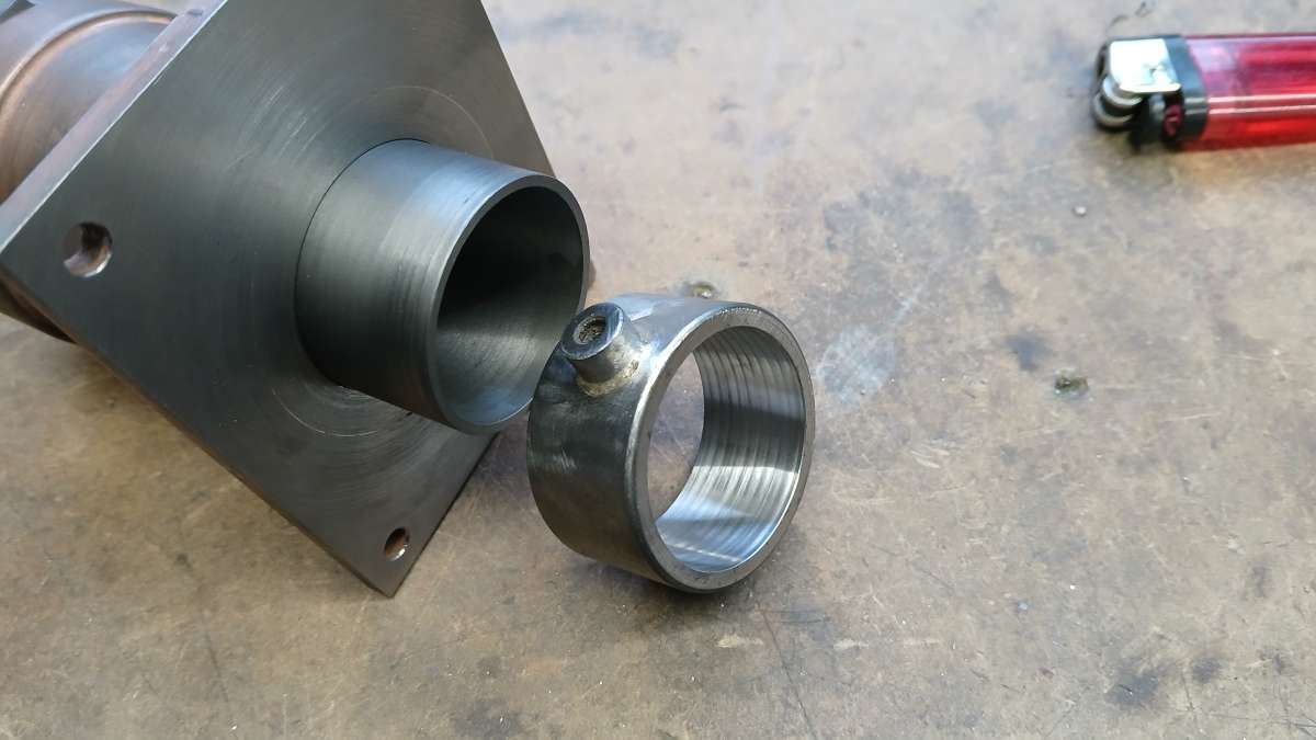

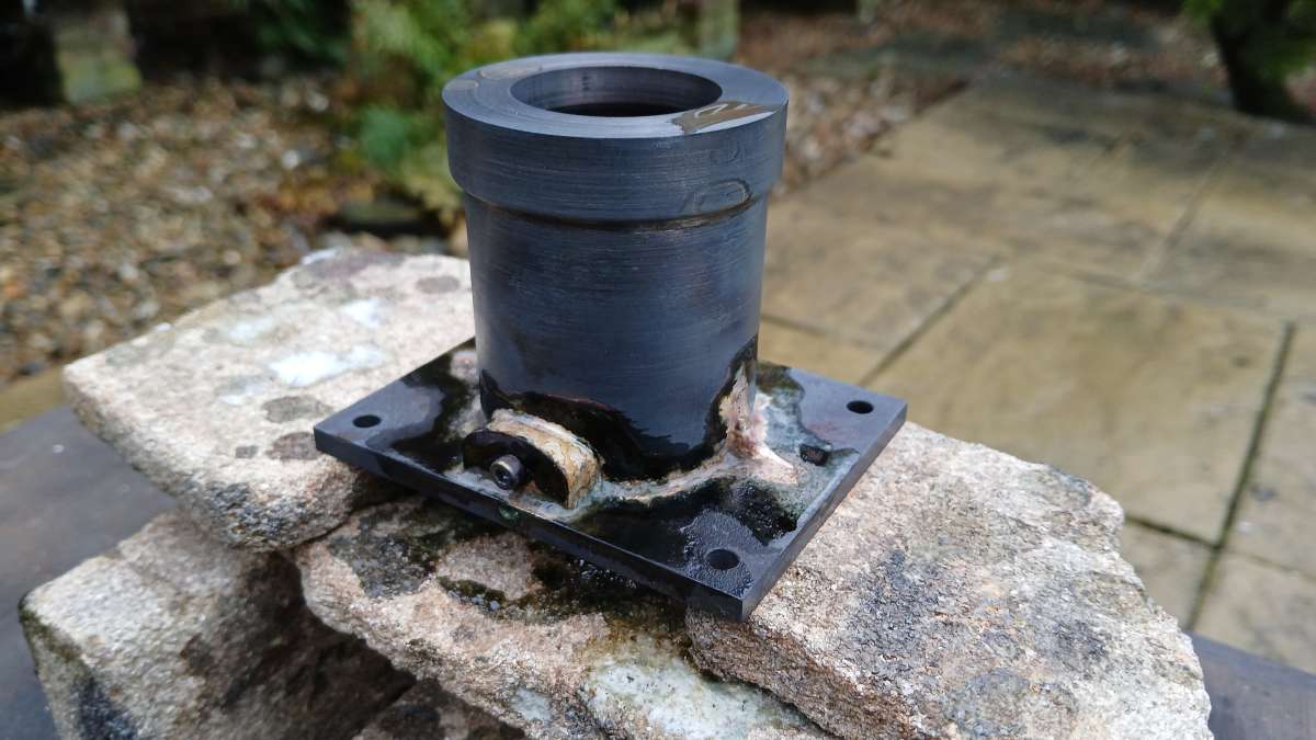

                        The original would have had a water jacket cast in around the cylinder with the water space being formed by a sand core. For our models it is easier to have a separate liner that as well as forming the cylinder also closes off the waterspace. Here the OD has been machined and a steady is in use while the cast iron bar is bored to size. I leave a bit of solid material at the end so that the chuck will not distort the thin liner, this can be cut off afterwards and the liner faced to length.
                        20260108_140113
                        The cylinder does protrude below the bottom of the entablature and as the liner would have been too thin I turned up a sleeve to add the additional thickness. It also allowed me to silver solder on a bush for a drip feed oiler. Liner, Cylinder jacket and sleeve were all a push fit and assembled with 648 Loctite.
                        20260110_094227
                        20251226_122514

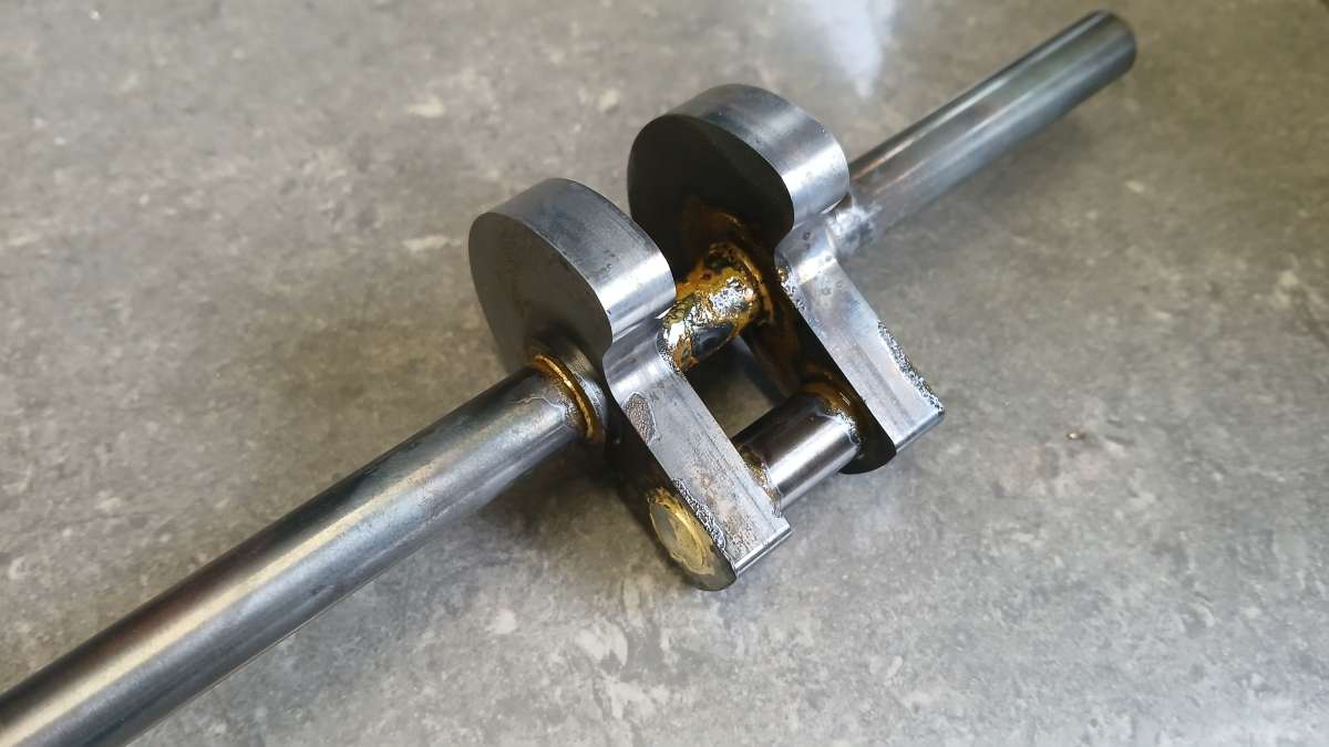

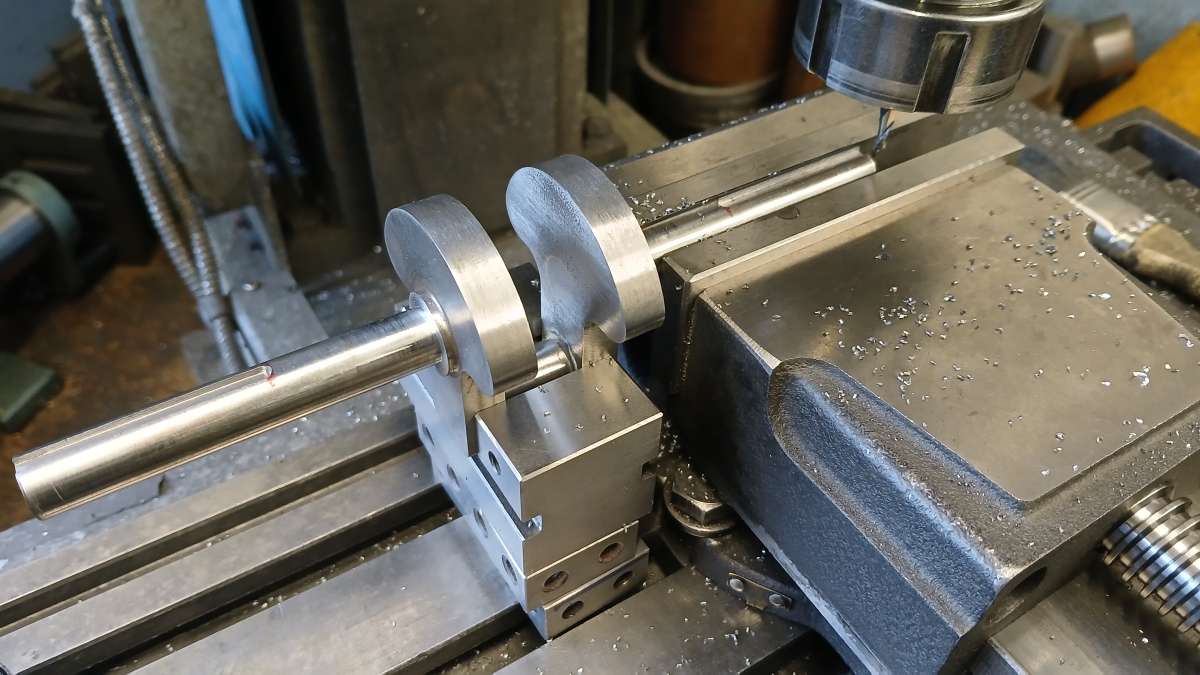

                            The two crankshaft webs were drilled and reamed on the manual mill and then the holes used in conjunction with some top hat bushes to hold the material on the CNC mill to profile the  counterbalanced shape. The shaft and pin were from 12mm PGMS and all silver soldered together
                            20251227_132939

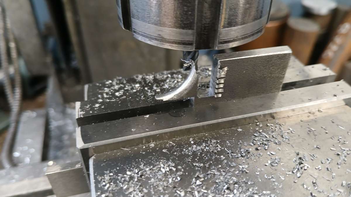

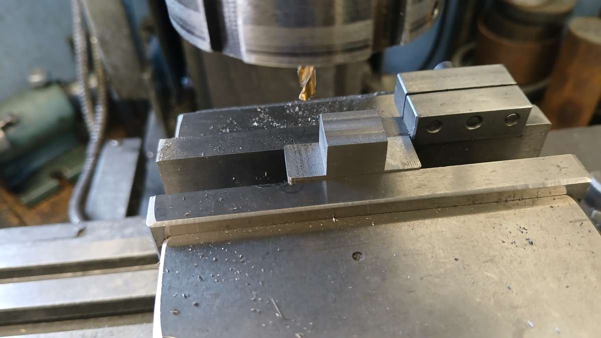

                            After sawing out the unwanted bit of the shaft and filing the ends flush slots for the gib head keys were milled in each end. Don’t panic; I did not mill the overhanging left-hand one like that. The small vice ensures that the crank remains in the same orientation when swapped end for end in the main vice which should hopefully mean the keyways and therefore the spokes in both flywheels line up on final assembly.
                            20260104_090336

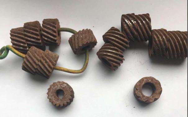

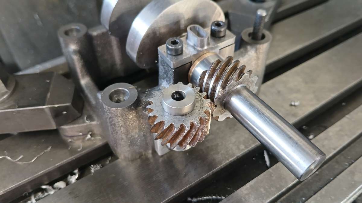

                            I had thought about having the gears 3D printed in steel but Graham Corry of Alyn Foundry kindly donated a pair of equal diameter 2:1 timing gears that had been maturing and developing his usual patina in a damp Welsh workshop for some time
                            rusty gears
                            After a bit of a cleanup and suitable modification of the holes I could put the crankshaft into the bearings with its gear in place and then holding the other gear on an arbor in the spindle set the mesh of the gears and zero the DRO.
                            20260103_111718

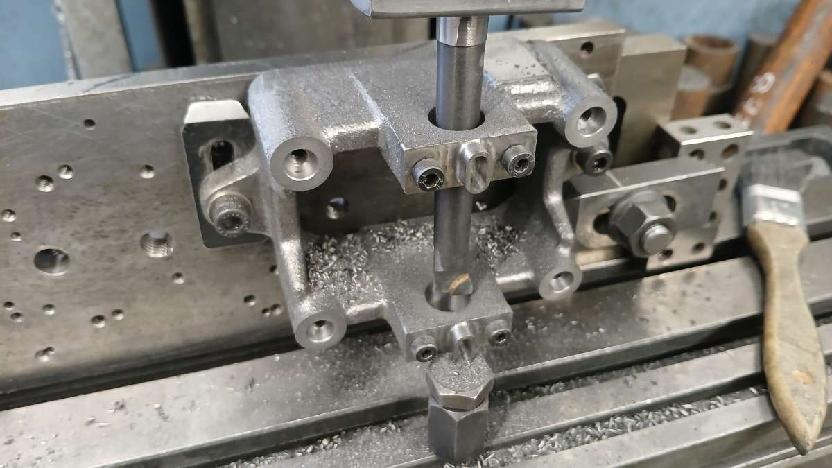

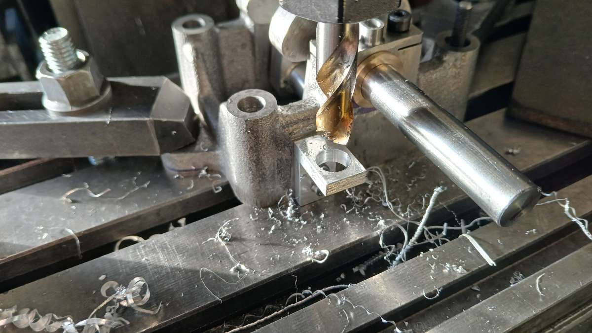

                            The lower gear support bracket could then be drilled and reamed at this position.
                            20260103_105503

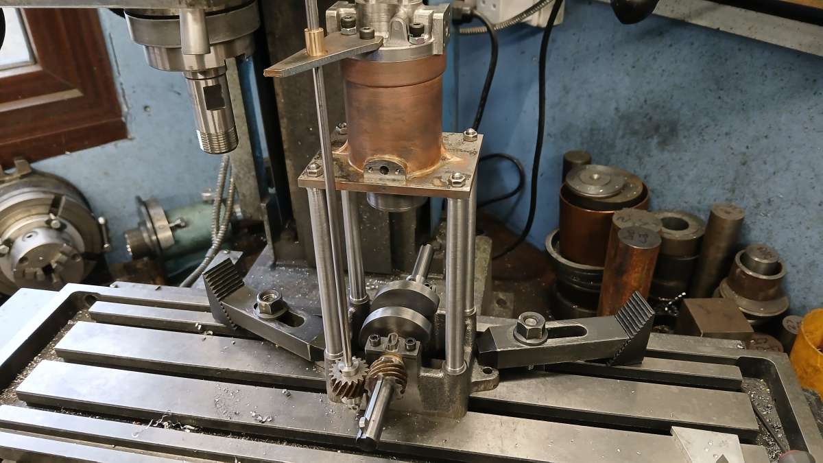

                            Without disturbing the setup the columns, cylinder and head were assembled to the base and the roughed-out top camshaft bracket screwed into place so that too could be drilled and reamed for it’s bearing at the same DRO setting ensuring the shaft was true and vertical.
                            20260110_135711

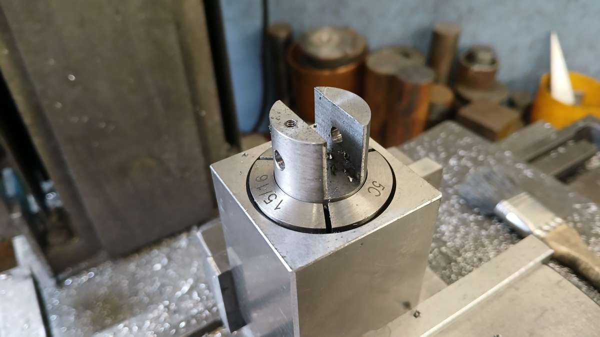

                            Five spoke flywheels are always a bit of a pain to hold. Usually I like to use a 3 or 4 jaw chuck to grip the ferttled casting by the inside of the rim but the spokes and jaws always clash on a 5 spoke layout. So the faceplate was used with a piece of 6mm MDF between it and the flywheel so I could machine the whole outer face, one side of the rim and hub and also bore the central hole to a firm push fit onto the crankshaft.
                            20251222_144118
                            The castings were woth the cost with nice to machine grade 250 iron and no hidden holes or hard spots thought I will be painting the rims so not quite as critical as a bare finish requires.
                            20251226_122503

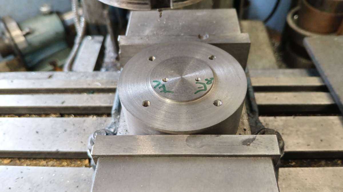

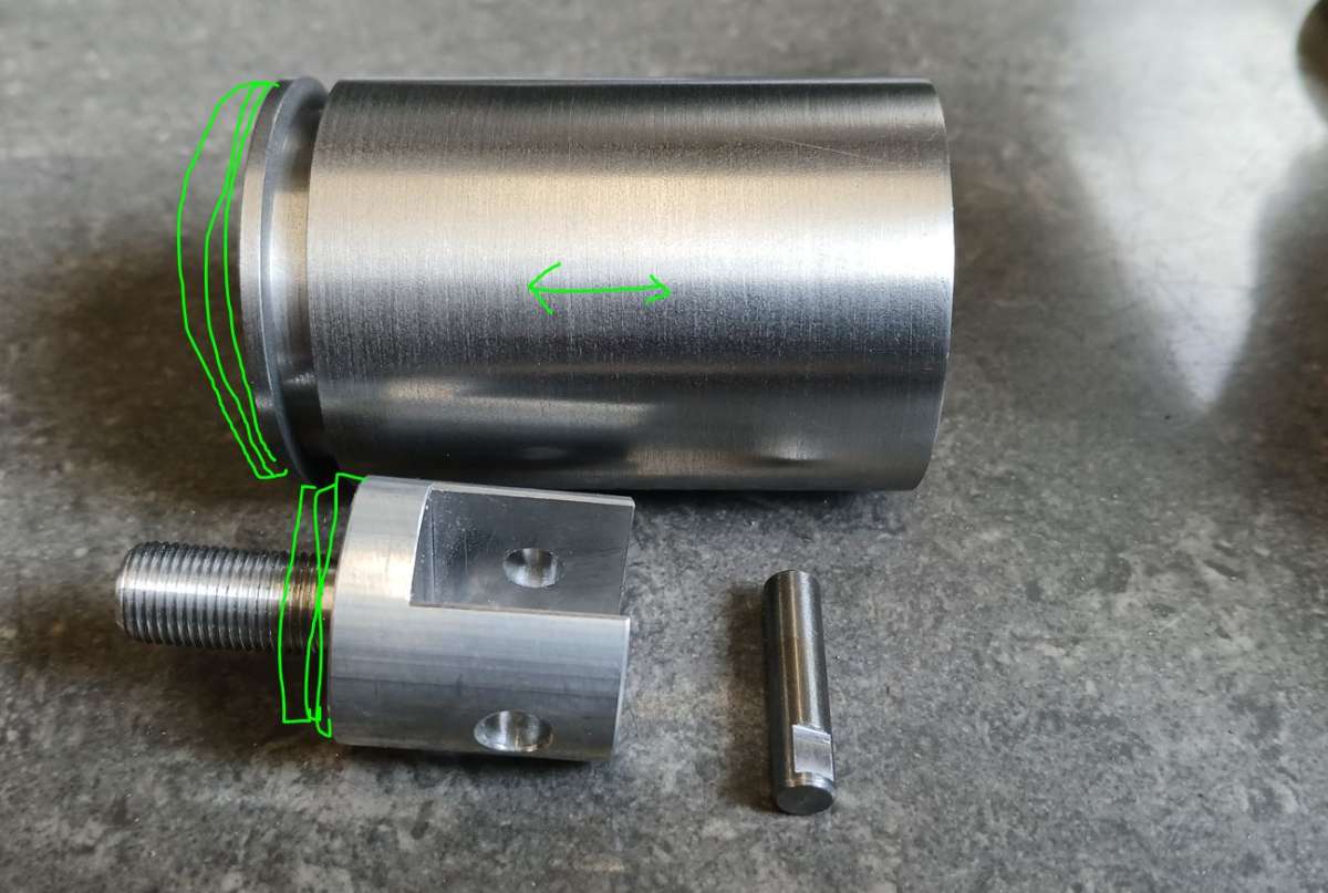

                              Rounding up the last build photos the Piston was done using the common at the time separate gudgeon pin holder, here the pin hole has been drilled and reamed and then the collet block stood upright to mill the slot and add a tapped hole for a grub screw to keep the pin in place
                              20260117_120904
                              Not sure what I did with the original image but this is the piston and pin holder. It also illustrates how with the addition of shims or discs the early engines could have their compression ratio adjusted to best suit the local gas supply. Just a single groove for a Viton O ring.
                              shims

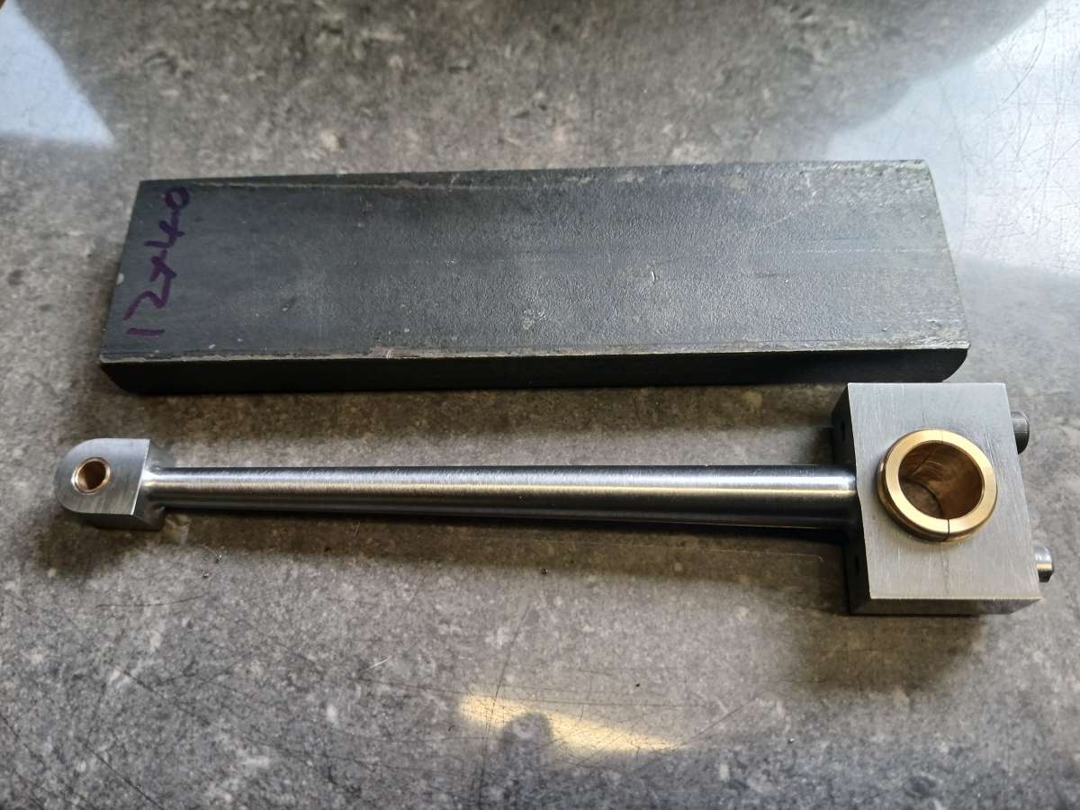

                              The conrod and it’s cap were cut and turned from some hot rolled flat bar and bronze bearings fitted.

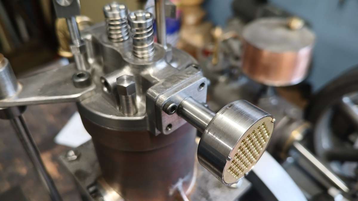

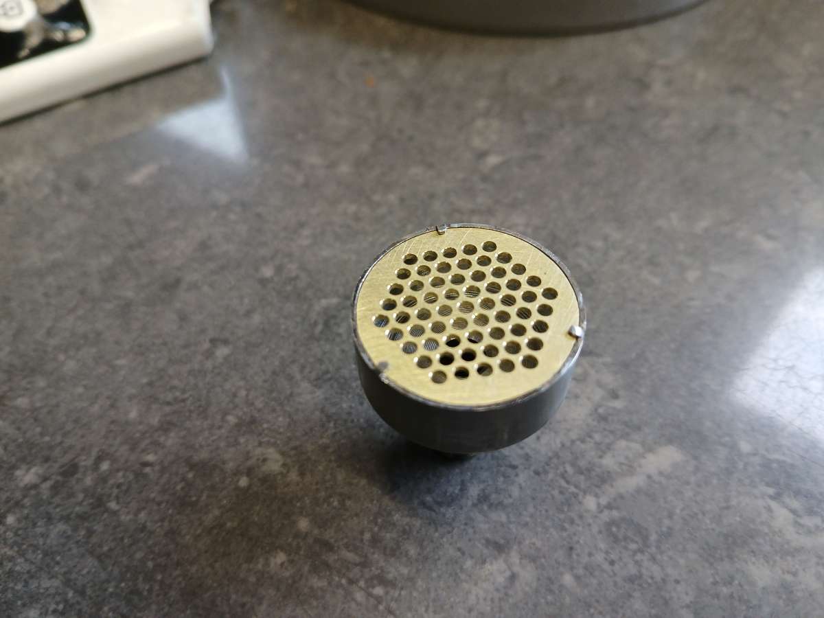

                              The photo of the surviving engine shows a round air filter strainer which I replicated by first turning the outside profile
                              20260131_094424

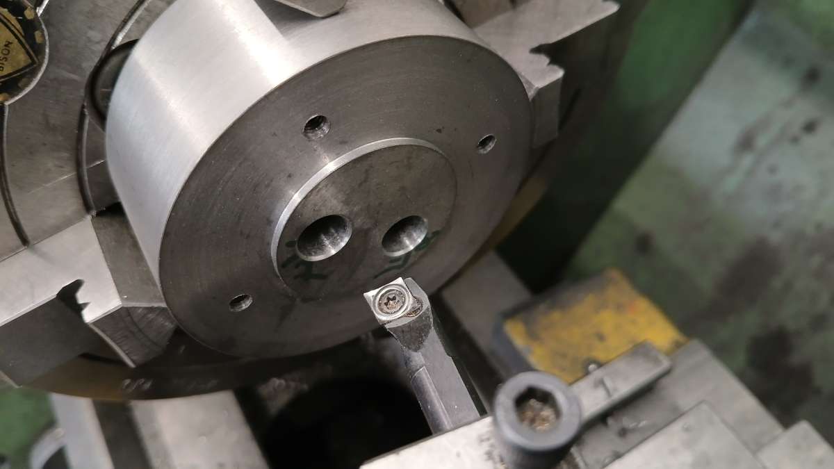

                              It was then held by the smaller diameter to bore out the inside. I cut a shallow rebate around the edge to leave just 0.5mm thickness. Half the depth of the rebate was milled away just leaving three short sections full length. These were then bent over to retain the drilled brass screen.
                              20260201_132203

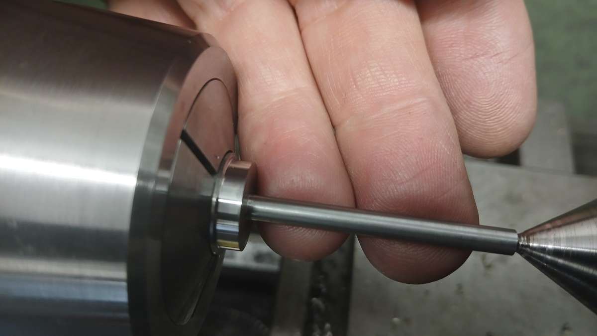

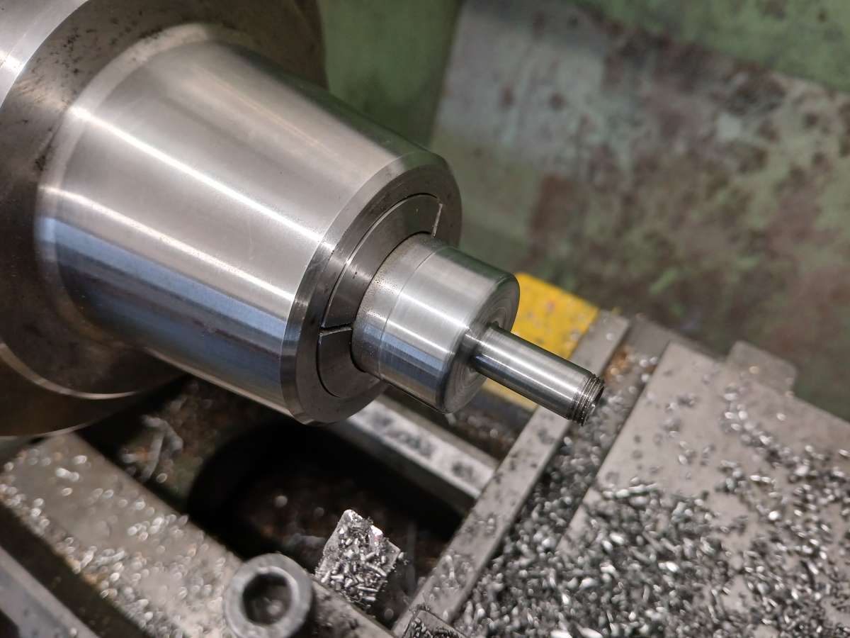

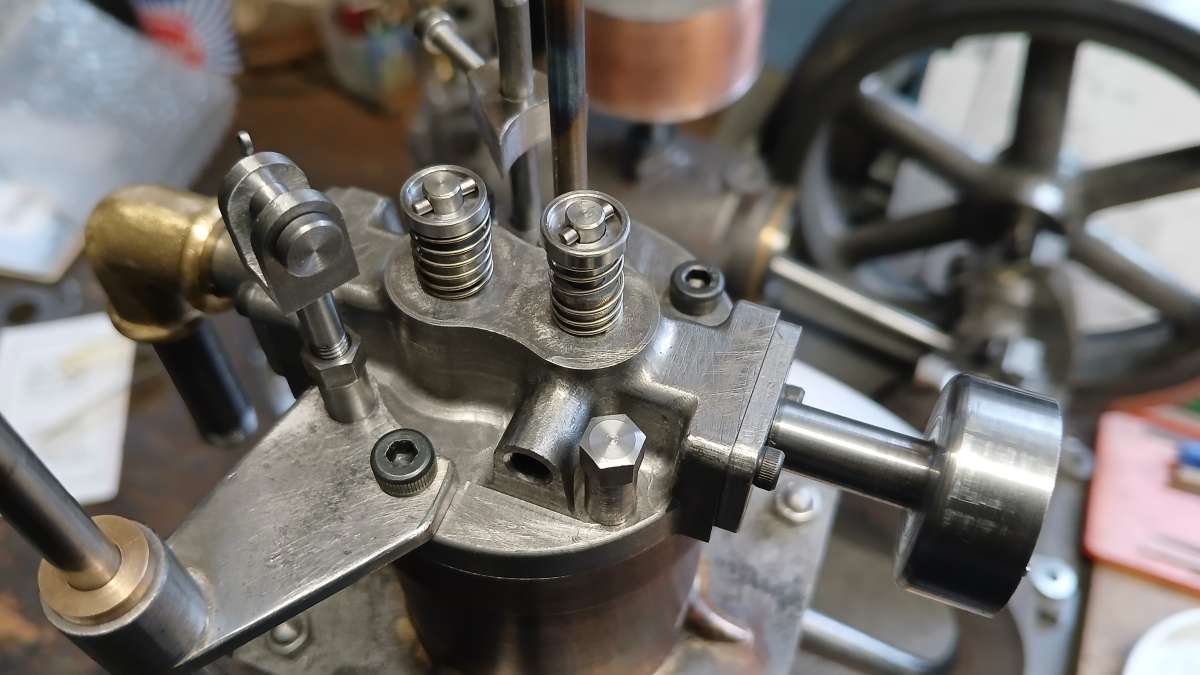

                              Valves were fairly straightforward turning jobs from 303 Stainless, this is the flat one that also closes off the gas supply hole which I showed earlier.
                              20260227_144910
                              Here they are in place complete with spring retainers and pins.

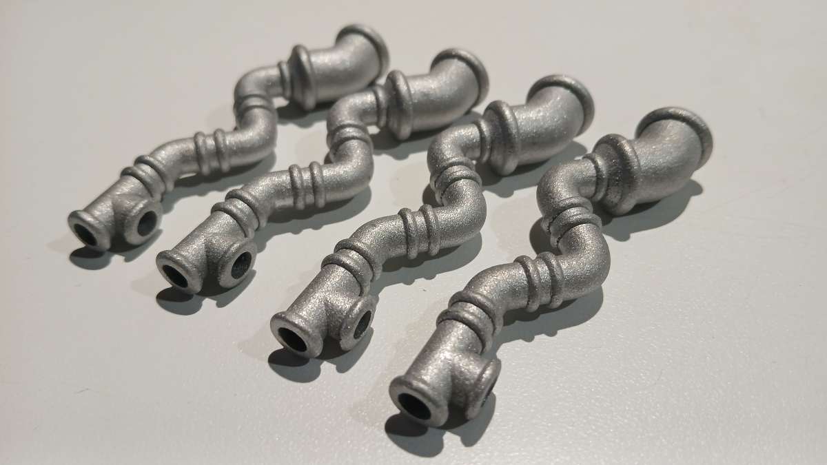

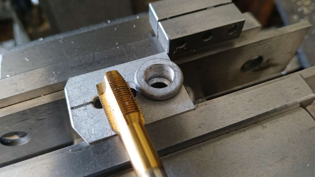

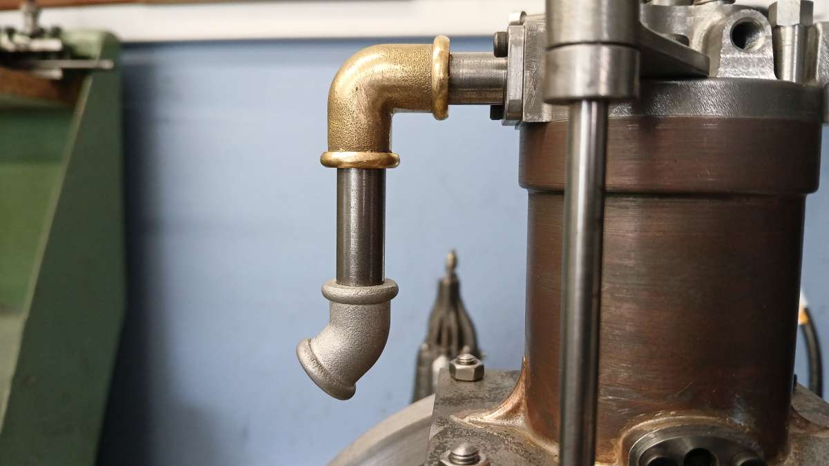

                              I am able to buy quite nice looking 1/8″ BSP threaded brass elbows which can be retapped to M10 x 0.75 but the image of the engine shows two 135deg bends that I could not find good looking fitting for. So I drew one up and had some 3D printed in aluminium along with some smaller ones to suit M6 fine threads
                              20260319_175956
                              A simple split plate with some holes in it and a vice stop made it easy to change fittings so they coul dbe tapped, unlike the cast “trees” that PM Research do mine were printed ready bored with a nice flowing curve and counterbored to just have the thread cut.
                              20260322_135349
                              As you can see the two fittings match quite well and once painted it will be hard to tell the different sources.
                              20260322_141050

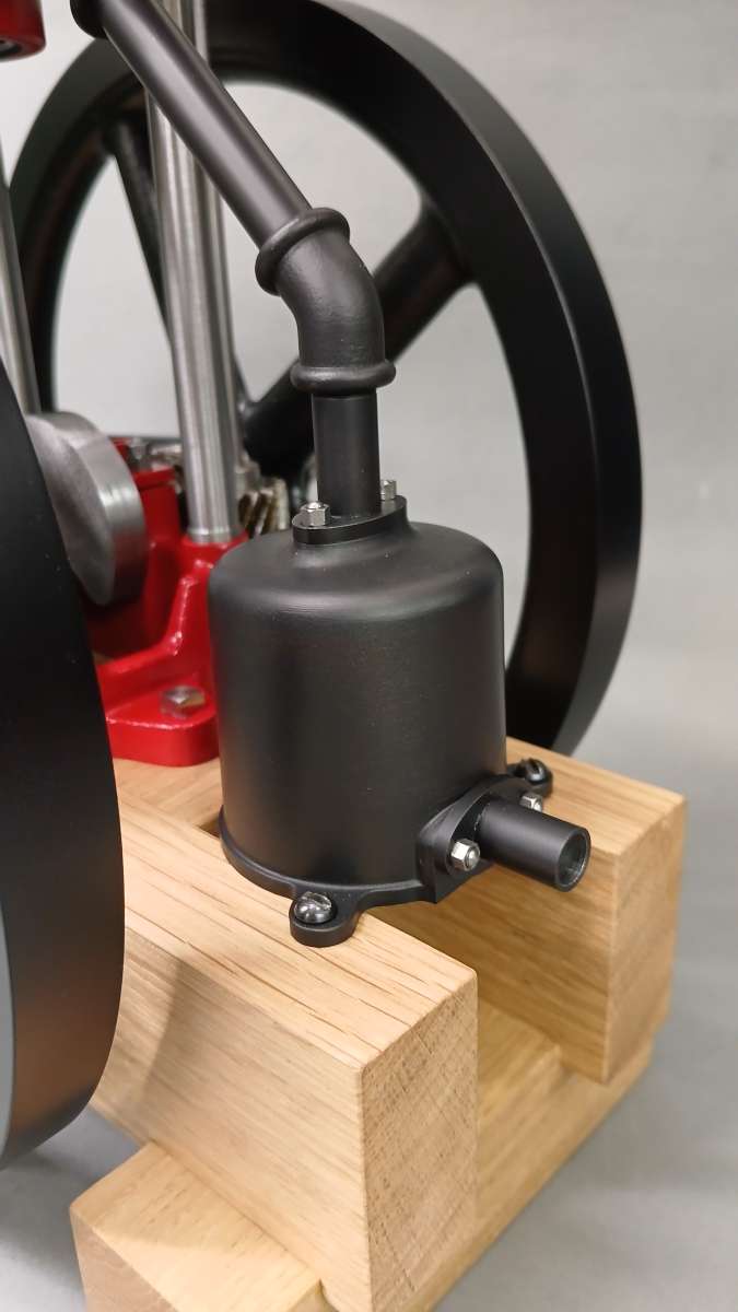

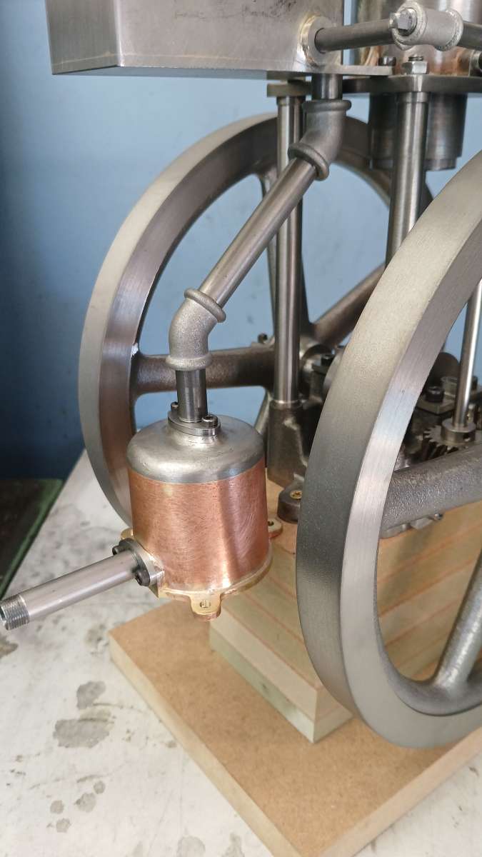

                              I could not go to all that trouble with the pipe fittings and use an old tin can as the exhaust pot so fabricate done with what was to hand.
                              20260330_143359
                              Conn’t in next post as I’m upto my image limit.
                              #865412
                                And all plumbed in
                                20260407_135343

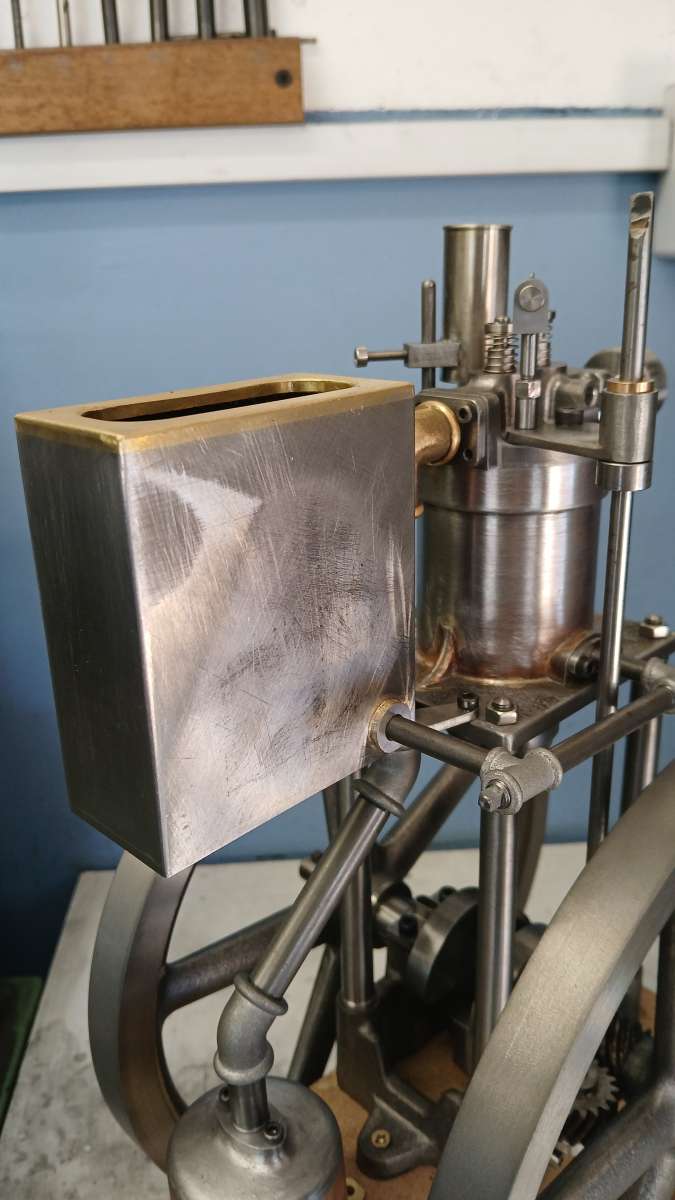

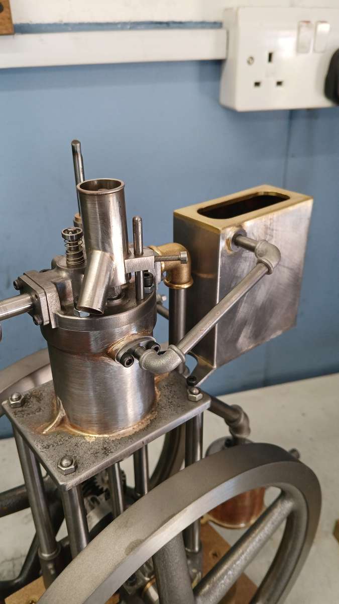

                                The water tank started life as a length of 40 x 80 hollow box section. I reduced the thickness of the walls so that I could get a smaller external corner radius and then silver soldered on the top & bottom plates
                                20260407_135349
                                The hot tube chimney was turned from stainless steel as was the angled burner holder. This is actually threaded internally to allow a small Sievert burner to be screwed in once it’s chrome end has been removed which gives a fairly compact arrangement that does not look too out of scale.
                                20260407_135405
                                The engine stood like this for a few months while I got distracted with steam engines and also I did not fancy cranking over an engine in the hot weather we have had. I got back to it a couple of weeks ago and did the last few minor items which were cutting the face cam, making the rocker arm and plumbing in the gas supplies. It was then ready for a test run.
                                It was poping but as soon as it did the hot tube burner went out, I soon traced that to me having just done the hot tube up finger tight when it was made. The application of a copper washer and spanner soon had that sorted. After another few minutes of the odd pop I realised when I had timed the exhaust valve for some reason I set it as though it was the inlet valve. With that corrected compression was much better and the engine fired into life if a bit on the fast side. Sorry it is jumping about but I made the stand just to assemble the engine on and the screws soon pulled loose with starting loads.
                                With the engine now known to run it was time to make all the studs, nuts and scale fixings, a wooden base and apply some paint.

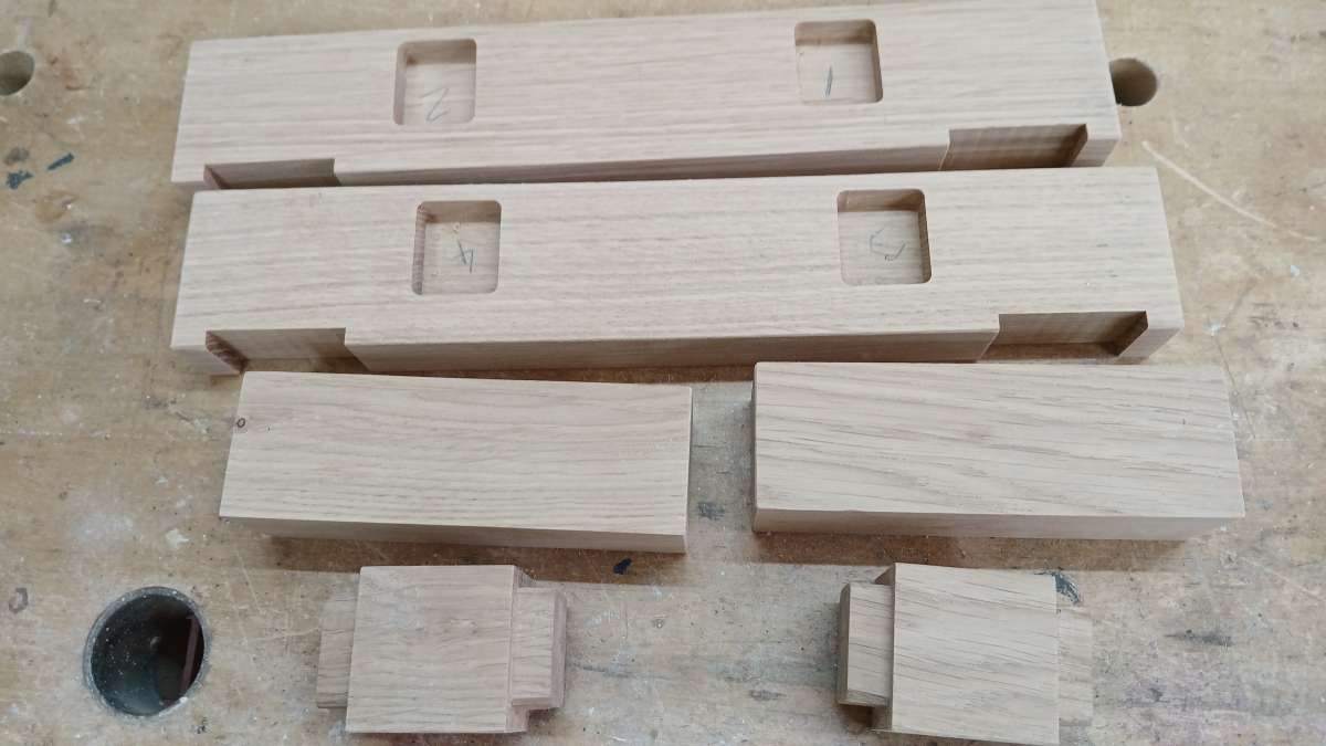

                                The stand was made from Oak and the mortice and tennon joints cut on the mill.

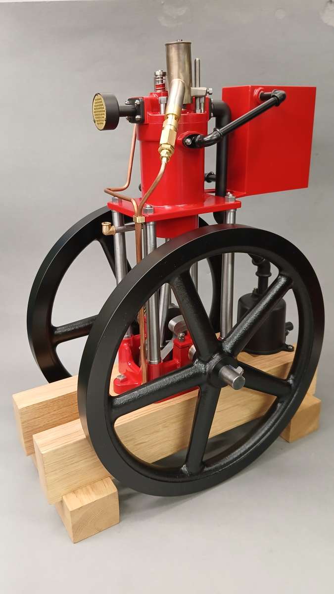

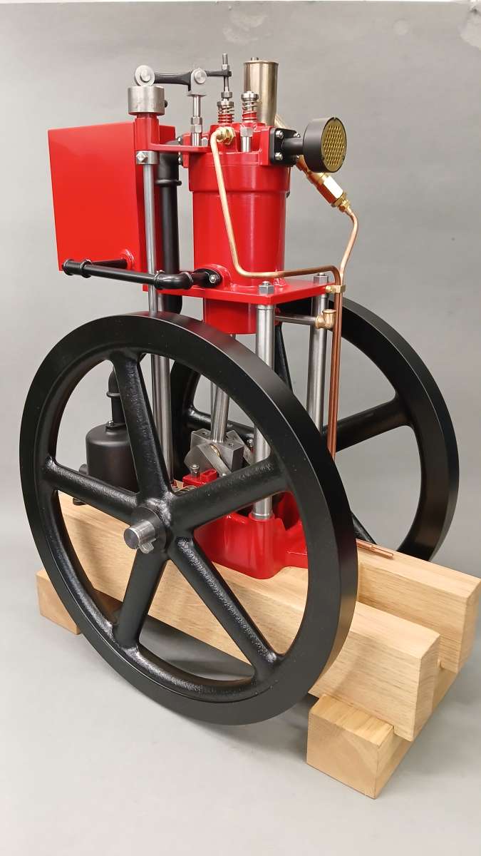

                                #865531

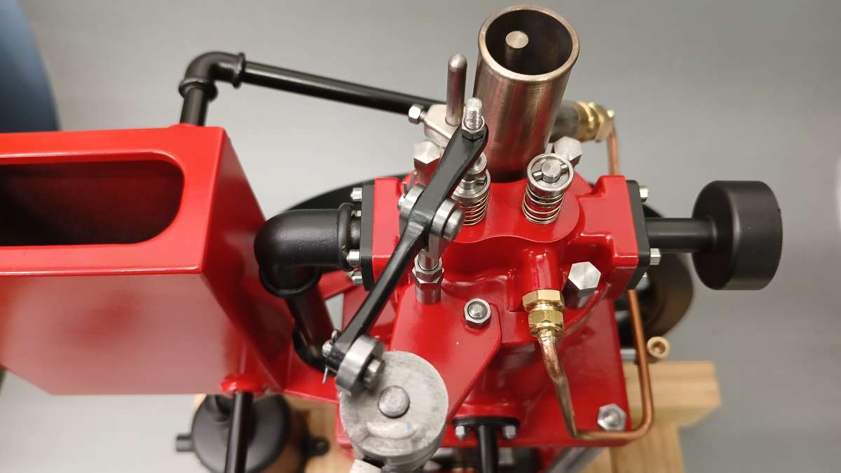

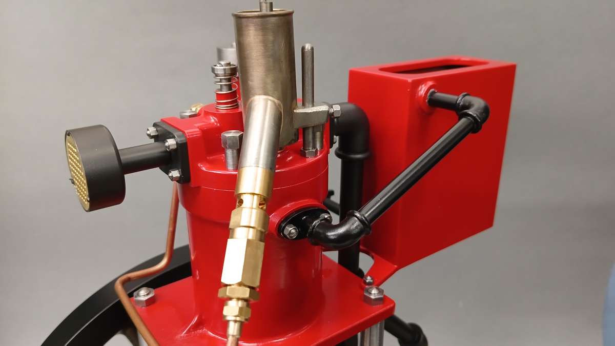

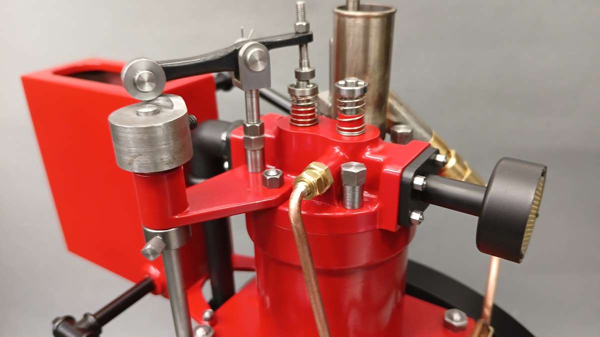

                                  With the paint dry it was time to put it back together and hope it still ran.
                                  20260913_082531
                                  Here you can see the finished face cam and the rocker arm assembly that was not shown earlier, fuel gas connection into the side of the head.
                                  20260913_082558
                                  This shot shows the Sievert burner screwed into the chimney, I made an adaptor to replicate their nick tube end and used a standard steam type nut and nipple on the other.
                                  20260913_082652
                                  20260913_082702
                                  20260913_082752
                                  20260913_082940
                                  And finally a video of it running; the last 30 seconds or so have it at a slower speed as I started to get it dialed in.
