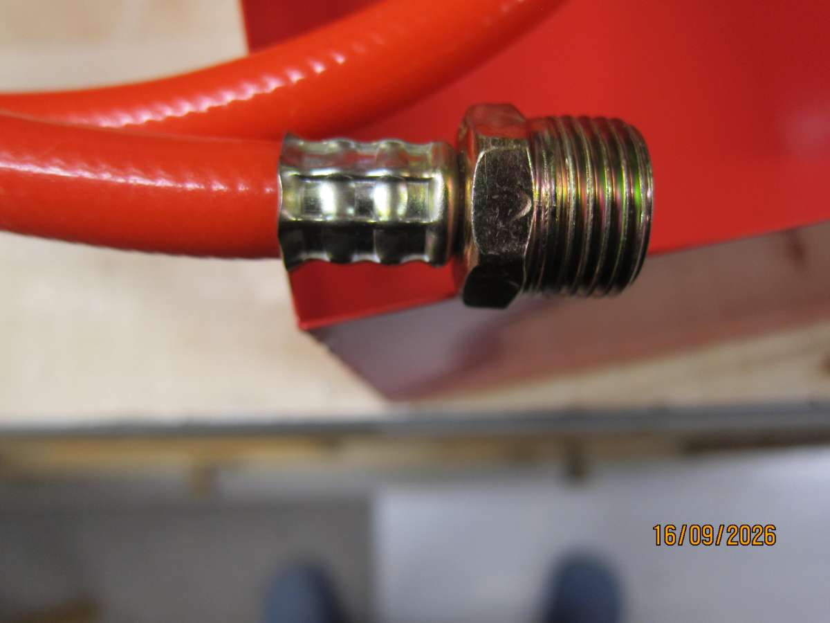

      I have recently purchased a hydraulic pressure pipe tester from TEMU to carry out some local boiler leak testing which I gather has been used for this sort of work and is certainly a cheap (and cheerful) tool for the job. The free end of the 1m length of pressure pipe is fitted with what I think is a standard pipe fitting measuring typically 20.5mm O/d but of unknown thread pitch. To be of any use for model engineering purposes a reducing adaptor needs to be made up and screwed onto the existing fitting but before cutting metal I would like to have confirmation of the thread specification and any advice that can be offered which may be of help. All help and assistance much appreciated.

        1/2″ BSP – 14 TPI, used the world over for plumbing threads, though quite often with rather loose tolerances.

              The Temu listing actually says 1/2″ twice which confirms what Andy said.

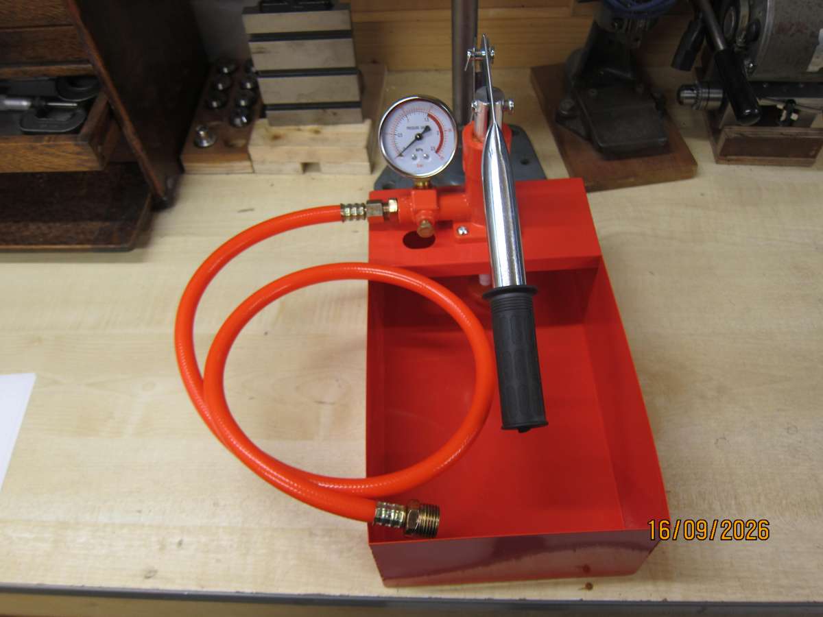

                          What sort of adjustment is provided by the hex headed screw seen at the bottom of the gauge?
                            …is the pressure bleed off.

                              In what circumstances is the pressure bleed off screw used?

                                Okay, so you pump up your test item to 250 bar and it holds perfectly.
                                Then you bleed of the pressure to atmospheric in order to be able to disconnect the item (or precisely set whatever other pressure you want to test). Unlikely you would be able to unscrew the connector threads under pressure (not generally recommended and not really safe).

                                  The more expensive version of a proof pump has 2 valves, one isolates the pump from the system leaving the pressure gauge in circuit, the other is the relief valve, as the name implies it relieves the pressure.  Noel.
                                  A word of caution ! These pumps can easily burst ordinary plumbing equipment Etc a friend of mine borrowed mine and blew up an oil cooler like a balloon. Above 2 bar go easy, unless rated for mains pressure and even then much above 6 is sailing into danger.

                                    20.8 mm = 0.818″ which looks like a slightly undersize (truncated?) 1/2 BSP (0.825″) and 14 rpi, Whit Form thread, not 60 degrees., as already said previously.
                                    Where pipework is concerned, think of BSP fittings and Imperial sizes, not Metric.
                                    Even the EU use BSP fittings, although they call them GAZ, and probably work in decimal Metric sizes, as you have done.
