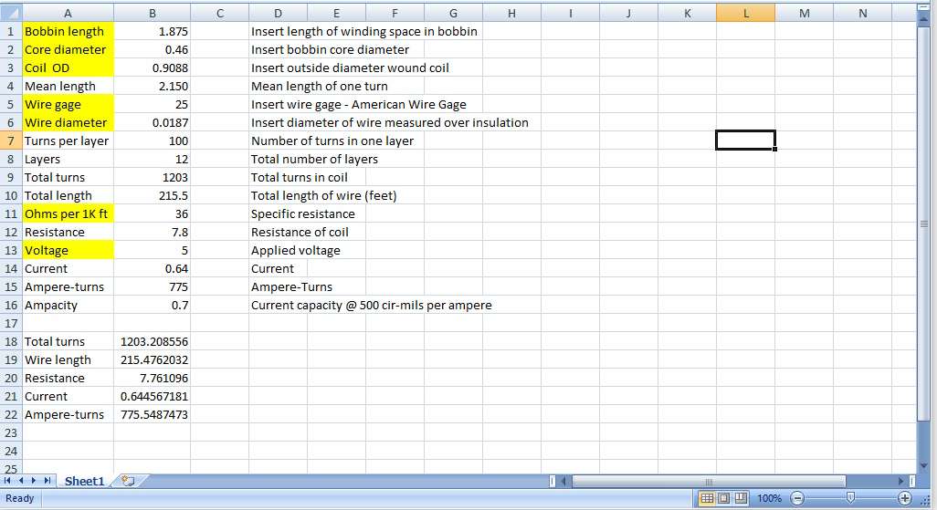

    carlw
      @carlw
      I have started a pendulum clock based upon John Wildings’ version of the ME Jubilee Clock and using my electronic Hipp drive circuit.  The seconds pendulum has a 10 lb bob and I hope to be able to fit the four optos within a 2 – 3 deg swing.  Bit of a space problem here that I hope to suss out.
      What I need is a starting point for the drive coil.  The coil core will be nylon so that I can use a NIB magnet in the end of the pendulum.  Any suggestions for ampere-turns of the coil would be most welcome.
      Carl W

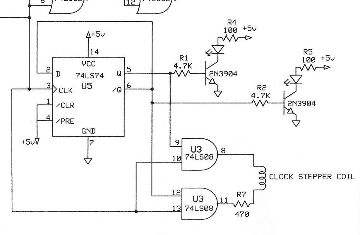

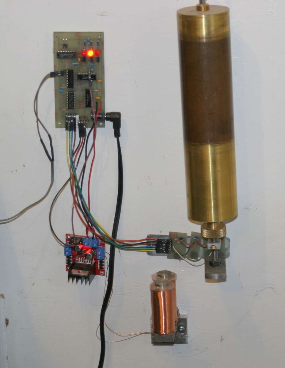

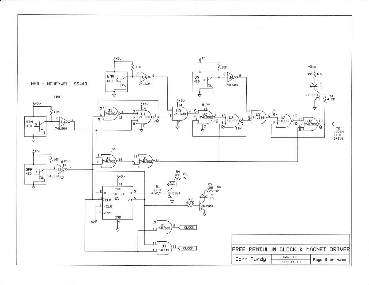

                            Carl
                            From your original post it looks like you are making a clock similar to the one I made. I used the drive circuit that you published in ME with some modifications of my own. I used 4 hall effect sensors for the pendulum and a iron bar on the bottom of the pendulum vice a magnet. I used two coils and the amp-turns of each was calculated as 775 by the program I used for the coil design. If you would like the Excel coil design program PM me your e-mail address and I will send it to you.
                            My clock has been running now for over 4 years and keeps reasonable time, considering it is in my unheated workshop and the pendulum rod is just stainless steel. I have a carbon fiber rod to replace it with but have never got around to it, one of these days. The output of the drive circuit send a one second pulse to a cheap battery clock unit with the internal drive circuit disconnected and my clock drive actuating the Laval stepper directly.
                            Johnclockdrive
                            CoilData
                            Scemo1.3
                            #865322
                            duncan webster 1
                              @duncanwebster1
                              I can only speak from experience. My first clock has 2 optos, and has been running for 20 or so years. It was last put right in early July when the power went off,  it is currently 2 minutes slow. I could readily make it run on one opto, but that would entail including a timing function generated by the processor, which is against my self imposed rules.
                              Using lots of logic gates instead of a processor is making life difficult, but each to his own.
                              To revert to theory, according to The Science of Clocks and Watches, the best time to impulse a pendulum is at mid travel, although I don’t think it really matters as long as you do exactly the same on every swing.

                                Duncan
                                The only reason I used discrete gates is because I had them and it was before I started playing with Arduinos and their ilk, besides, I like playing with logic circuits!
                                In mine the impulse is given to the pendulum right at mid stroke with the coils offset slightly so that it is just before the bar on the bottom of the pendulum reaches the poles of the coils. The 5 volt pulse to the coils is a square wave 94ms long and currently it occurs about every 14 seconds.
                                Just to correct an error in my previous, It should be a “Lavet” stepper not Laval.

                                  Duncan: I’ll second John’s use of gates rather than processor.  I learned relay ladder logic in 1964 and built my electro-Hipp drive circuit in DIP relays before converting to s-r flip-flops.  That is as far as I have gotten in electronics.  My poor tired old brain does not seem to work well with processor logic, so I am not going to go there.  I am curious about your 2 opto drive.  Can you supply some more details?
                                  John: I see the changes in my circuit and should be able to figure out your logic.  But I am lost on the D type flip-flop driving your slave clocks.  I would appreciate some explanation because I am thinking of driving the time-keeping unit via a stepper motor.  This is analogous to a slave clock.
                                  Yes, I am building a pendulum like yours.  Why does it have 2 coils and a bar pole piece?  I was planning to use one coil and a round NIB magnet in the end of the pendulum.  Your coils are much longer than I expected.  I have a bar of Delrin in the lathe and will wait for further info before I begin machining.  Thanks for the offer of the spreadsheet.  I have my own similar one.

                                    John Purdy
                                      @johnpurdy78347
                                      Carl
                                      I’m sorry, I have forgotten why I used two coils and a bar on the pendulum. I think it may have had something to do with not imparting a sideways motion to the pendulum, (or maybe not).
                                      As for the D flip-flop, I’m using one of the small quartz clock movements that are powered by a single AA battery for the clock. These use a “Lavet” type stepper motor that increment the second hand on each pulse applied to it. But being a single phase stepper successive pulses have to be of opposite polarity,hence the use of the D flip-flop where the Q and not Q outputs alternate states on each one second input pulse to the flip-flop’s clock input. The Q outputs are buffered by the 08 AND gate which are connected to the coil in the clock movement after the internal electronics are disconnected. The 470 ohm resistor is for current limiting as the output of the 08 is ~5 volts and the clock is designed to run on 1.5 volt. Hope this revised schematic makes it a little clearer.
                                      There is a good explanation of the workings of a Lavet stepper in MEW issue.
                                      You mention pendulums vibrating. When I first had mine running I had the coils too close to the bar on the pendulum, resulting in the pull on the bar when the coils were activated being so strong that the whole pendulum rod vibrated creating a load “twang” that could be heard clear across the shop!
                                      FLIP-FLOP

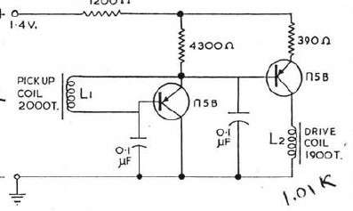

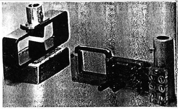

                                                  Here are a couple of pictures of the Fedchenko circuit and “motor”.
                                                  fedchenko_circuitfedchenko_drive
                                                  There is a rectangular former fixed to the clock with two windings on it. On the base of the rod is a steel “yoke” with two wedge-shaped magnets inside it which create a strong field between their points. The field maximum is arranged to coincide with BDC.
                                                  The yoke can be split to allow the coils to be threaded through, then reassembled. As the pendulum swings, as the coils pass through the field they generate a pulse which triggers the circuit.  Because the coils are tightly coupled the circuit regenerates so the transistors turn on for a short period, impulsing the pendulum very close to BDC. Because the coils and field are orthogonal the force is tangential to the motion as required. The coils generate opposite polarity on alternate swings, only one can trigger the circuit. As the pendulum Q is very high (~1 million, swinging in vacuum), only a tiny force is needed and the current pulses are very small. There is no amplitude control loop, but the suspension provides circular error compensation over a small range of amplitude. Circuit is run from a 1.4V mercury cell which has very constant voltage.

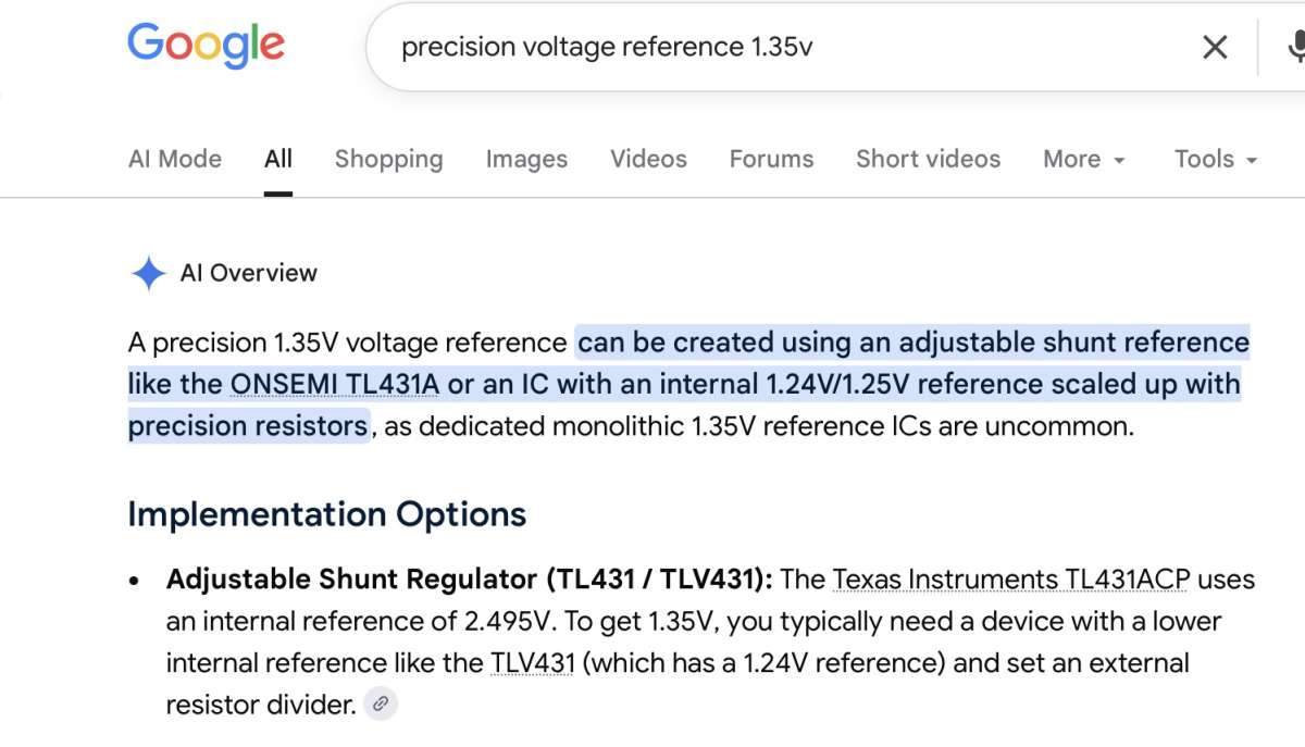

                                                      As Mercury cells are widely banned … This may be of interest to Fedchenko enthusiasts 🙂
                                                      IMG_2060
