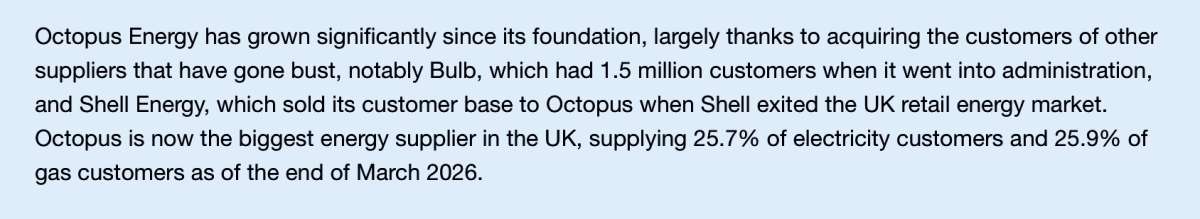

                                              They must be doing something right, they’ve gone from starting up in 2015 to being the UKs largest energy supplier…

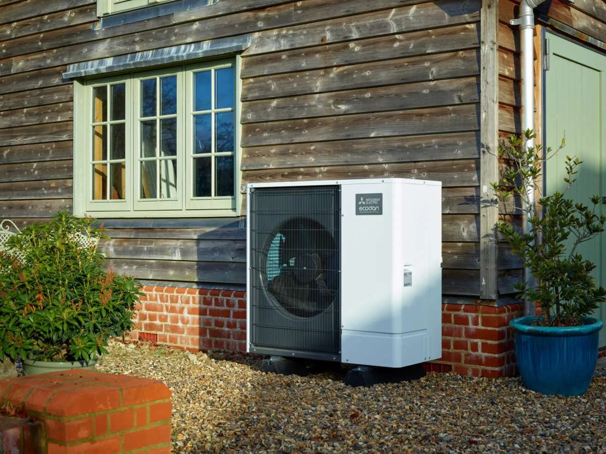

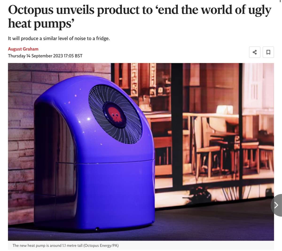

                                                Michael, aesthetically you may have dodged a bullet?! 😮 🤣
                                                I know which one I prefer.

                                                  #866878
                                                    Vic
                                                    I have just asked Google a couple of questions 🙂
                                                    who was responsible for the styling of the octopusenergy ‘cosy’ heat- pump … We deserve to know ,
                                                    followed by
                                                    no, I just wanted to identify the culprit !
                                                    #866907
                                                    Adrian R2
                                                      @adrianr2
                                                      Octopus bought the smaller company who designed it. It might have been OK if they had kept the shiny painted finish.
