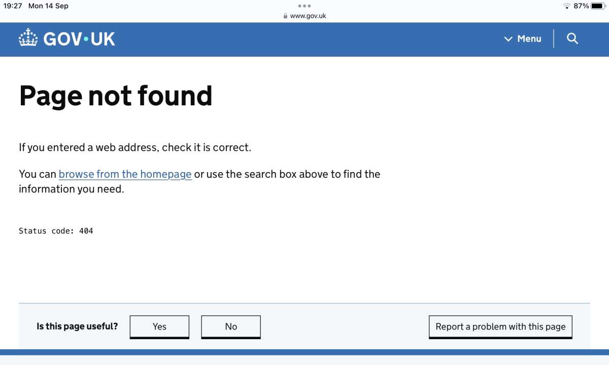

                                                  Our second ASHP is a Vaillent.  Pleased thus far but still have  a winter to do.
                                                  Many installers will apply for the grant on your behalf but it is not essentiaal.  However to get the grant your installer must be MCS registered.  See the list here:
                                                  https://www.gov.uk/guidance/find-a-
                                                  However the technical threshold for getting registered must be pretty low IMHO so do your own due diligence as well.
                                                  Martin

                                                    Oops … this is rather unfortunate
                                                    IMG_2047
