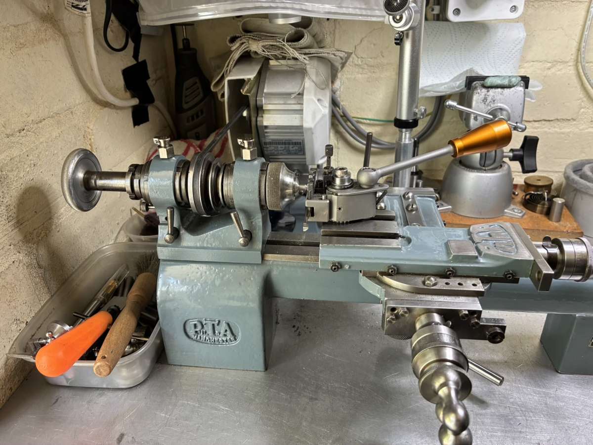

            Dell
              @dell
              Personally I would take a hard look at the second hand vintage lathes because they were & probably still are much better built, I have restored a good few Pultra lathes 17/50-17/70 & P types & they take some beating, being English accessories are often to be found.
              This is my current Pultra that I use for clock parts the video shows the lack of runout.
              IMG_0592-compressed

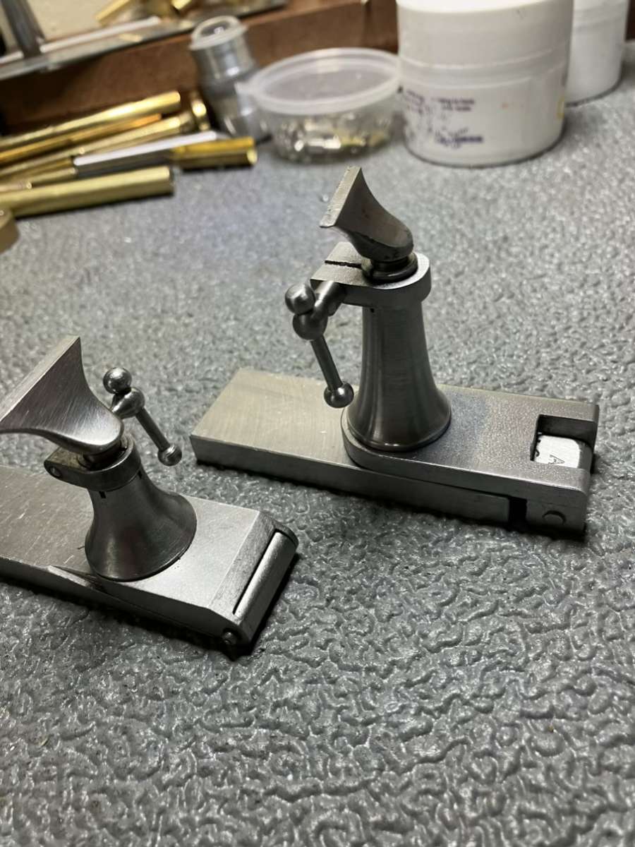

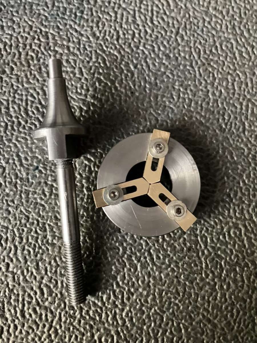

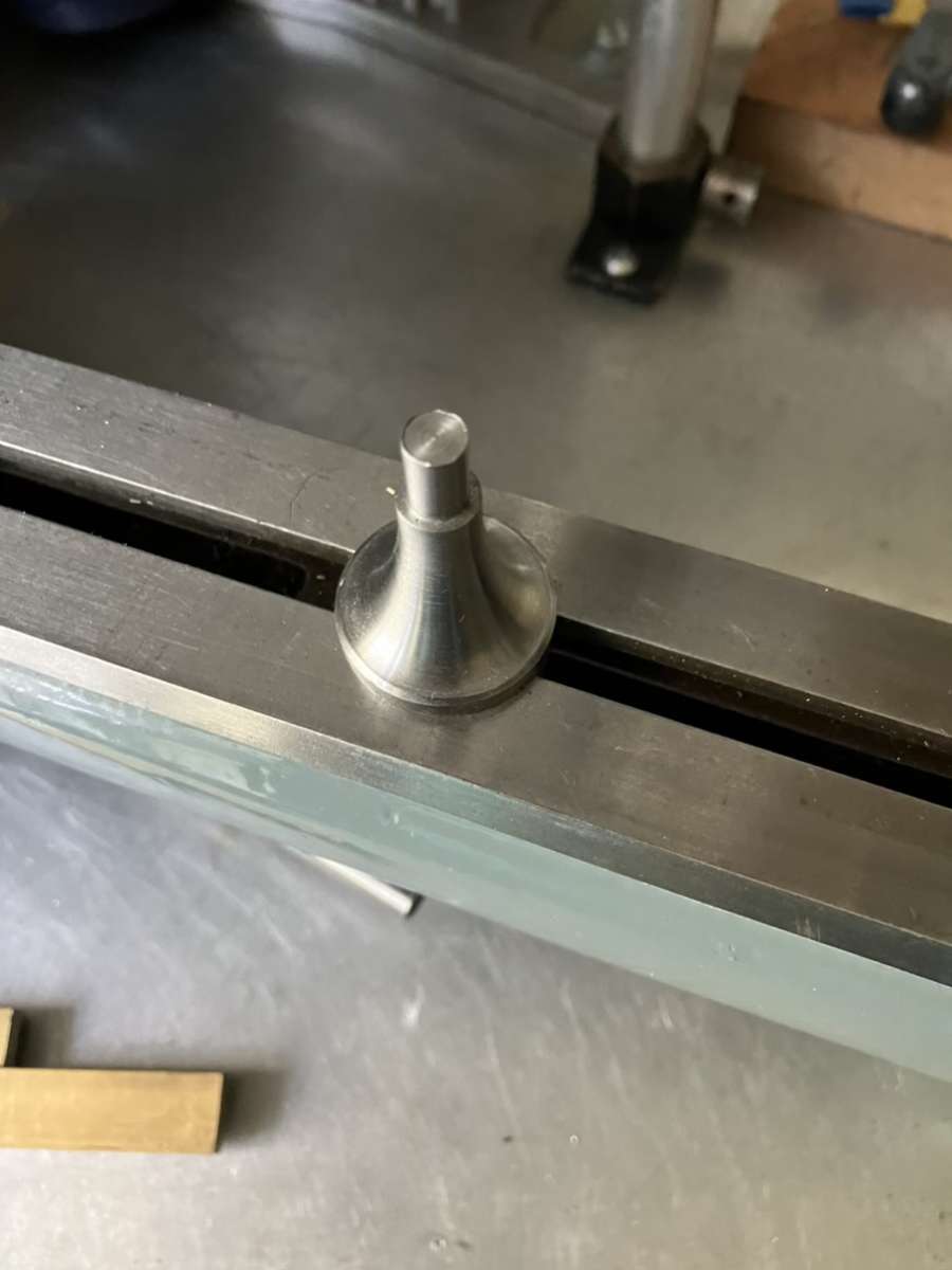

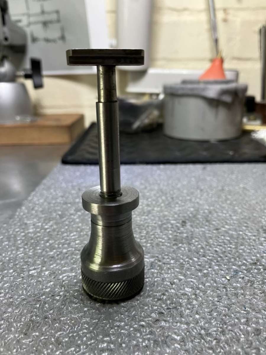

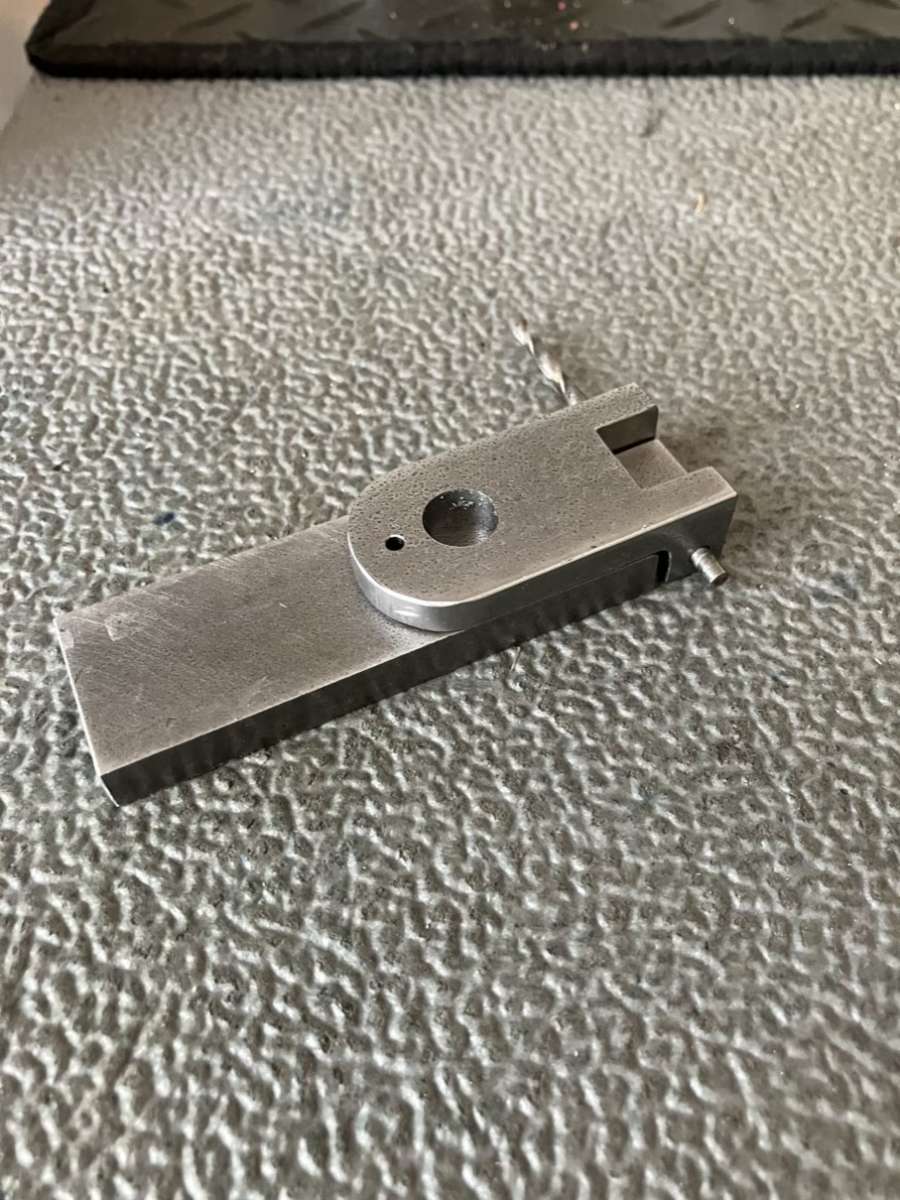

                                      Dell
                                        @dell
                                        Pultra accessories do come up & admittedly it has taken a while to find everything I want & need but I also have a Myford 10 so I am also able to make some tooling because I have Rocketronics on it so it’s easy to make accessories for the Pultra, I have made tip over tool rests, fixed steadies, arbor to use ER11 collets.
                                        i am in my mid seventies & when I purchased my Myford i was 70 & I picked it up including the cabinet in a Mercedes B class so it is possible to lift as long as as it’s taken apart.
                                        Here are some pictures of what I have done using my Myford with Rocketronics, the last picture shows an original tip over rest & the taller one is home made for a 17/70 70mm centre so you can see that the Myford 10 is a viable option as well.IMG_0357-compressedIMG_0274-compressedIMG_0358-compressedIMG_0346-compressedIMG_0294-compressed
