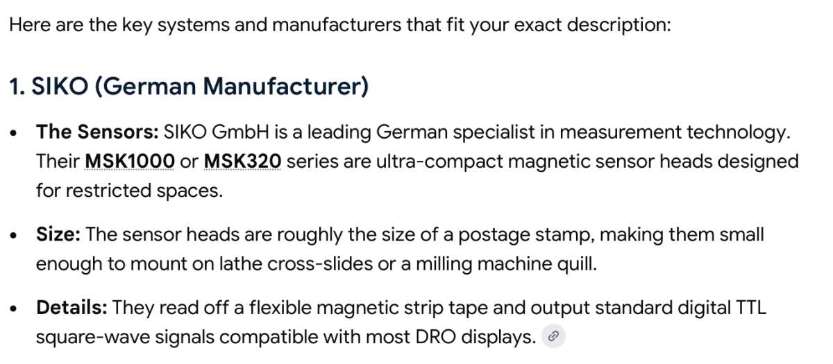

                  Google AI was helpful in my brief search for the ‘Holy Grail’
                  IMG_2064
                  [back to bed now]

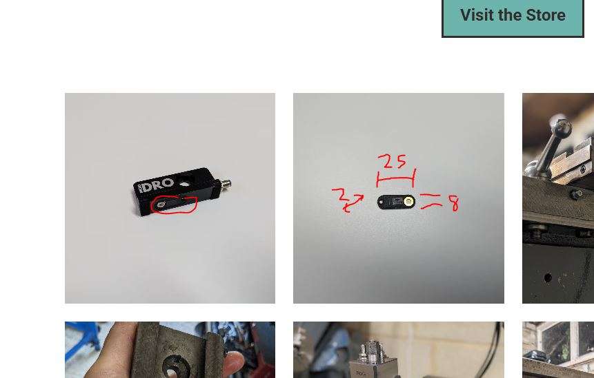

                          Michael can I ask why the link to Siko? the sensors you link to look a lot larger than the microdro.com ones.
                          The image on the right is their sensor, the one on the left is it within a bracket for easy external mounting.
                          small

                              You can certainly ask, Jason
                              There may be relevant detail somewhere on the Siko web-site, or Google may be mistaken.
                              IMG_2064

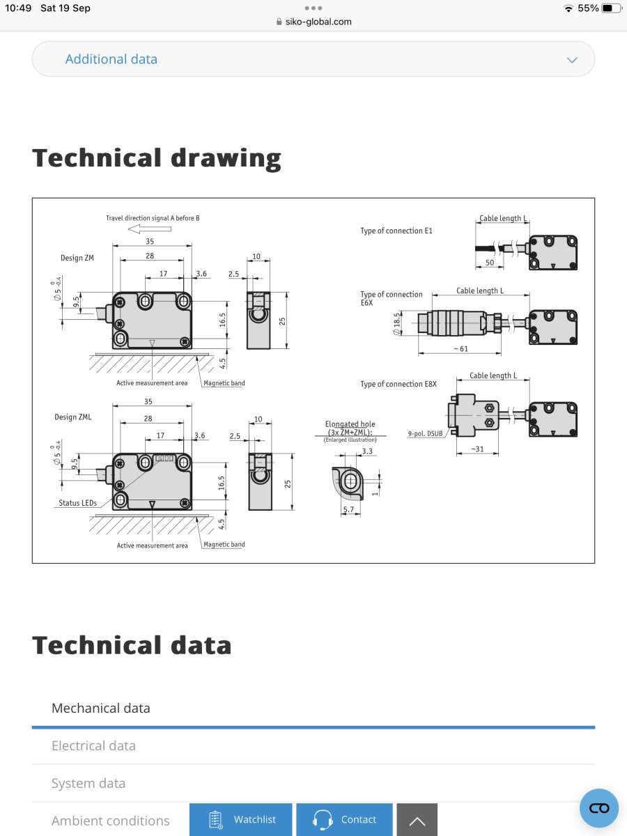

                                Somewhere within this enormous great box will presumably be the actual sensor that MicroDRO is using:
                                IMG_2066

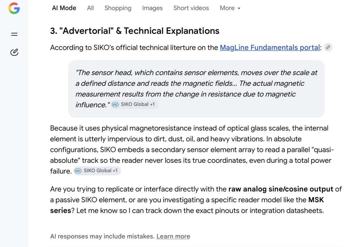

                                  Here is the Rabbit-hole:
                                  IMG_2067

                                        What make you think that one has the actual sensor, there are quite a few out there. This one for example is 8mm x 12mm x 2mm for those that want to go the diy route
                                        https://www.rls.si/eng/rlc2hd-miniature-linear-and-rotary-pcb-level-incremental-magnetic-encoder

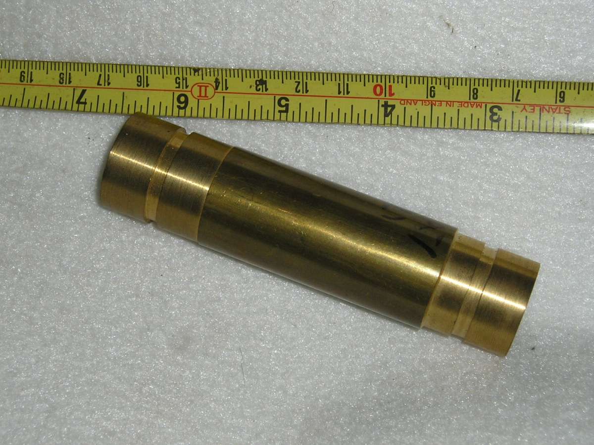

                                              Yes, I designed my DRO system 35 years ago, first one used a 68008 CPU, mask programmed single chip CPUs were not a cost effective solution. Then the Microchip PIC single chips arrived, then used them.
                                              The electronics is easy, it is the sensors that cause the problems, and using glass scales at £1000 for two axes, in the early 90’s, was rather more than model engineers wanted to pay. I note from all the comments that no one seems to know what the accuracy and repeatability of this DRO is. I claimed +/-2 thou, and every sensor was teste to make sure it complied. I still have the test rig, a DOS 5.0 computer running on a 25MHz 80486.
                                              My installation instructions said to put a guard over the wire, simply to stop curly swarf catching the wire, not for physical protection, if you drop a lump of metal the wire simply moves out of the way. The guard also keeps the coolant off, but the wire enters using a PTFE bush and after repairing dozens of sensors can only think of a few that had coolant ingress.
                                              I did nearly all the exhinitions in the 90’s, and talked to many people. Taper turning atachments were noticible by there absence, but the loss of travel by the tailstock up to the saddle was mentioned by nearly everyone, hence my Myford DRO mounted the cross slide sensor on the left, under the chuck, and again it has never been a problem.
                                              When I used my Dad’s Myford I found that the skewing of the saddle ruined any possibility of accurate turning, been a recent article in the ME saying the same thing. So anyone who believes that a Myford will turn to 2 microns is deluding themselves. Lookk at the attached photo, looks simple doesn’t it. Two lands spaced by three grooves. Machined with the cross slide locked, one cut towards the chuck, one away. Then you use a tenths micrometer to measure the land diameters, and if you get them within 3 tenths then your lathe is very good, a Myford will struggle to get below 3 thou. At the shows many people said that 2 thou was useless, so I challenged them to do this test, not one, in ten years, came back to me. Read Righ First Time by Frank Price for some basic statistical tests for just how good your lathe is.
                                              P1010002

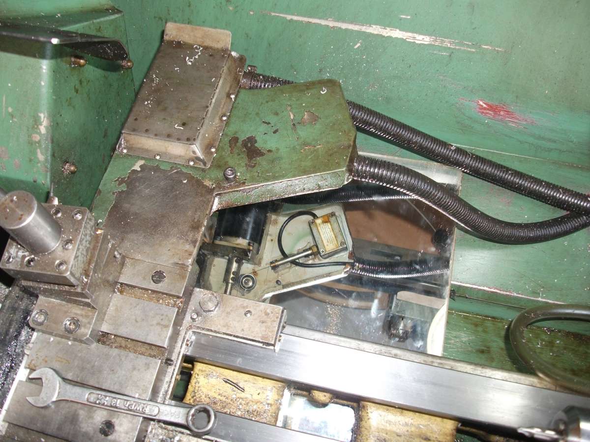

                                                The photo here shows the the B&W encoder fitted to a bracket at
                                                the rear of the Myford crosslide ,it was not always like this as
                                                i fitted the DRO long before i cnc’d the machine.
                                                Fitting the cnc, the stepper motor needed the space where the
                                                encoder was placed ,an extension to the original bracket
                                                and the encoder was placed off to one side ,the wire runs around
                                                a ball bearing to connect up to the original pin location on the
                                                saddle . You can just see the sheet steel cover for the saddle
                                                encoder wire ,the encoder is at the back of the bed right out
                                                of the way from the muck, swarf and oil.
                                                myford dro
                                                Its been fitted like this for 20 plus years i don’t think it has been
                                                moved in all this time just compare how clean the underside
                                                is with the top.

                                                  Bob & John, thanks for confirming tha tthe wire is best covered which like I thought will increase the room needed for the wire run.
                                                  I also see that John has covered the sensor, much like MicroDRO have done on their bolt on kits where the very small sensor is encased in a box that is still considerably smaller than Bobs unit. But better still why not use the machine to cover it and that is why they have it fitted into the underside of the slides thus reduceing external room needed.I assume some of those covers have required the drilling of the machines to mount the covers so not a lot different to machining the underside of the slides.

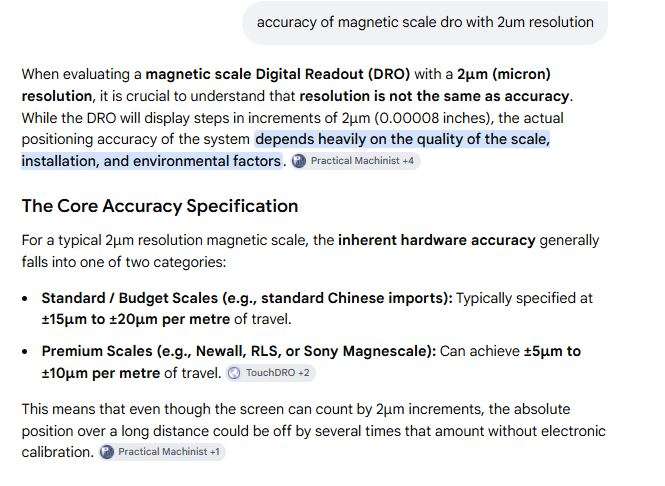

                                                  Taking Michael’s lead I did a bit of Googling and AI said that a typical magnetic scale with 2um resolution sensor was accurate to +/_ 20 microns, with budget tape or half that for quality tape, that is 0.0008″ Budget or 0.0004″ premium, somewhat better than 0.002″ for Bobs wire system. I have included the question in my screen shot as I think that helps people more than just showing answers.
                                                  accuracy
                                                  AI also states the accuracy over a distance, Stating a figure such  as 0.002 without saying what distance it is over is a bit meaningless a sit would be considerably different if over 1″ or 1yd.

                                                    Accuracy: The 2 micron figure is the display resolution. I’ve previously deliberately avoided quoting an accuracy figure, because the accuracy of finished work depends heavily on the condition of the lathe. A DRO can’t correct a worn bed or a loose saddle, and I didn’t want to imply it could. That said, the accuracy of the readout itself is a fair question, so here are the figures.
                                                    In my most recent test on my own Super 7, I took 71 readings from 0.5 mm to 100 mm using a set of Slip Gauges. The mean error was +0.5 µm (0.0005mm) and the standard deviation was 3.6 µm (0.0036mm). The worst case was −6 / +10 µm (-0.006 / + 0.01mm) .
                                                    For my own use, that’s more than adequate. When I need something tighter, I do what most people do with any DRO: turn to within about 0.05 mm of size, measure with a micrometer, set the DRO to the measured value, then take the final cut. That way any small inaccuracy that may have built up is mostly corrected for.
