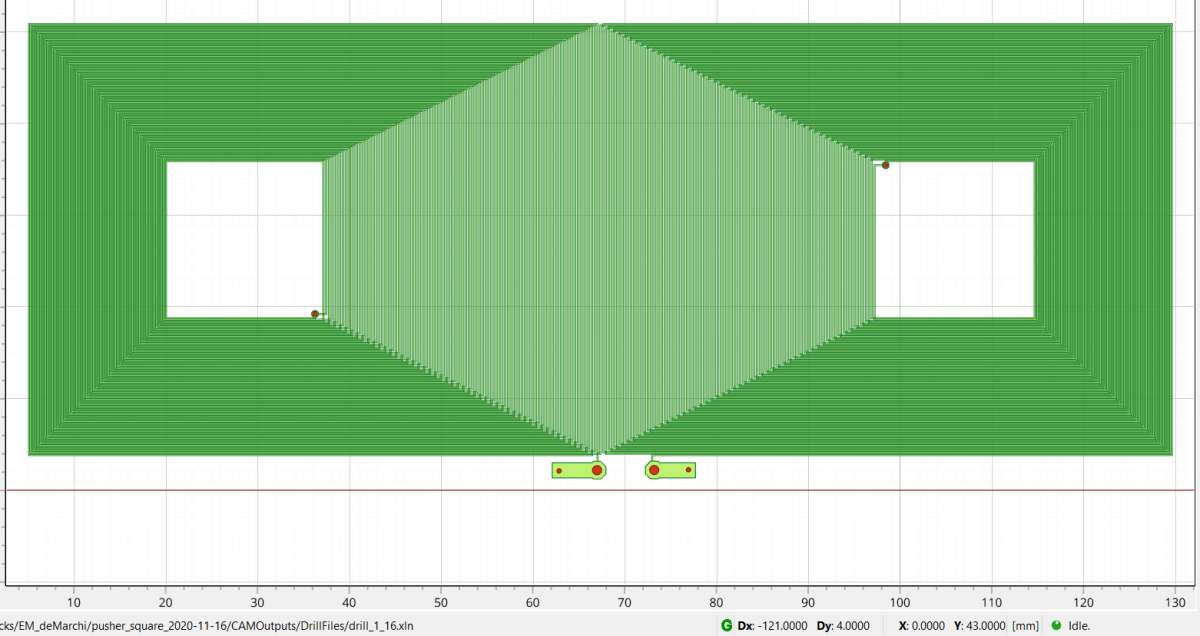

          There is another extremely elegant scheme invented by Andrea de Marchi and described over on HSN but to illustrate that I’ll need to get some pictures together. He uses a printed circuit coil design to apply tangential drive to a magnet on the end of the rod. Again, this is very predictable from the geometry of the “coil” and the dipole moment of the magnet.

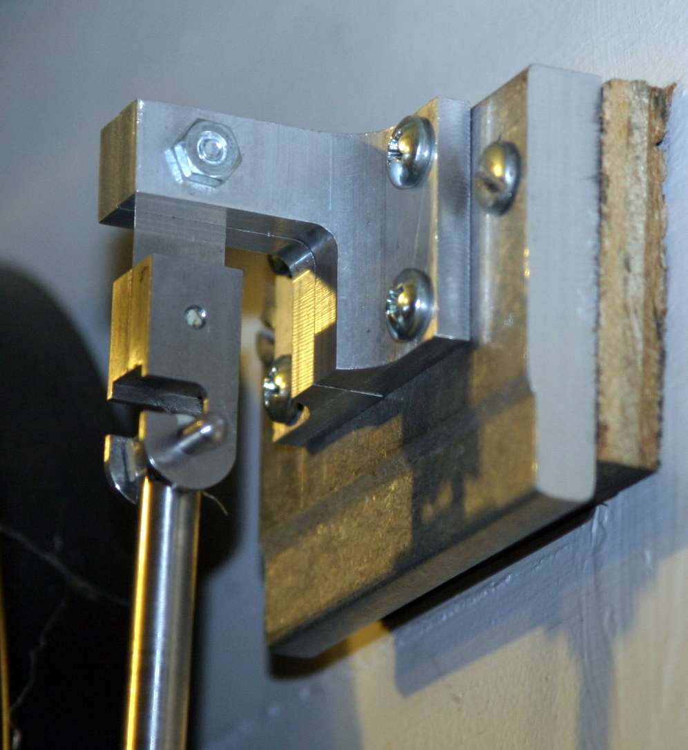

              I am about to replace my 304 stainless pendulum rod with a carbon fiber one. At the same time I plan to change the suspension from a single spring to two. I notice from the pictures of your Hemholtz clock that your suspension unit appears to allow the pendulum to swing in two planes, both sideways and fore and aft. Is this the case, if so why? The way mine is currently configured it is restrained so it can only swing sideways.

                It’s usual to have a “fore and aft” trunnion bearing to allow the rod to hang vertical in that plane. If it isn’t vertical it couples energy to that mode and causes the bob to follow a slightly elliptical path. In some clocks such as the Synchronome there are clamps to hold the ends of the trunnion once the pendulum is hung and set up. Mine has semicircular grooves in the bracket.

                    As far as I know the details of Andrea’s scheme are only contained in a few articles and posts in HSN and some emails from him.  The basic idea is to have a magnet on the base of the rod with its NS axis coaxial. The drive is generated by a “current sheet” just below the magnet, consisting of a double-sided PCB with a clever pattern etched on it.  Over a limited rectangular area in the centre of the PCB this generates a horizontal magnetic field vector which is fairly constant with distance above it.  Look up current sheet in Google for more information.  The magnet tried to align with this field and in doing so exerts a torque on the pendulum, in effect via a tangential force. In his amazing clock there is another pair of similar plates which act as a velocity sensor to generate a drive current in the first.
                    I do have the Gerber files for the PCB, here is a photo from flatcam.
                    png_20260920_103711
                    The squashed hexagonal area in the middle is the active region. Dark green is top copper, light green bottom. Holes are plated through. Grid is 10mm per box. For the avoidance of doubt this is the top view of the PCB as “seen” by the pendulum vertically above it. The PCB is mounted in the case so it’s horizontal.
                    I will check with Andrea if he would be OK to share the Gerbers or even some boards if I get some made.

                      Thanks for your reply. As far as the fore/aft motion is concerned I wasn’t thinking straight, there has to be freedom in both planes to allow the pendulum to hang vertically. Mine also has freedom in that plane, only below the suspension not above. Any advantage to either arrangement?

                        Having donned my tin hat so it won’t hurt as much when I’m shot down in flames, here’s my take:
                        If you imagine an extreme case where spring was stuck out at right angles it would twist as the pendulum swung to and fro. With a very small off vertical, the effect will be very much reduced, mainly bending, but a very small twist. However if JP remembers to not tighten the bolt on the top chops until the pendulum is hung and has settled  it will be truly vertical, so no issues.

                          No tin hat required.  I had to read your post a couple of times to figure out what you were saying, but I agree. Yes I did leave the top bolt and the screw that holds the two halves of the bottom chop/pendulum hook loose, tightening the top bolt then the screw once the pendulum was hung and had stabilized vertically. Thus ensuring all was vertically in line.
