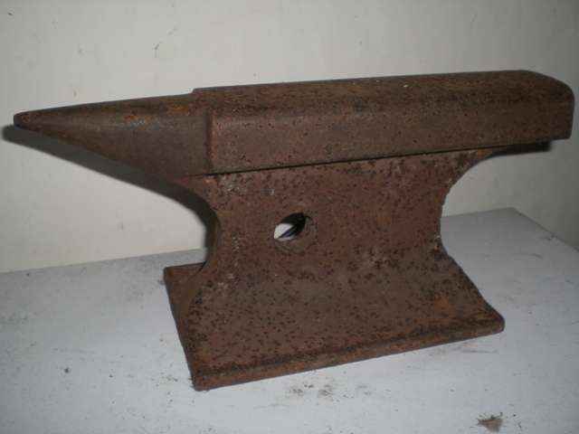

      I am in process of purchasing an anvil – specifically. (<–link to Vevor item for the cautious amongst us.)
      I thought I would ask for anvil opinions/observations before I press the button.
      Current thinking:
      Second hand items are either frighteningly priced or too far away.
      I currently use a short length of rail line but that has its limits.
      “The Internet” is as useful as it is in its opinions on these things – but, in the end, it’s just surface to hammer on.
      Thanks in advance for any observations etc.

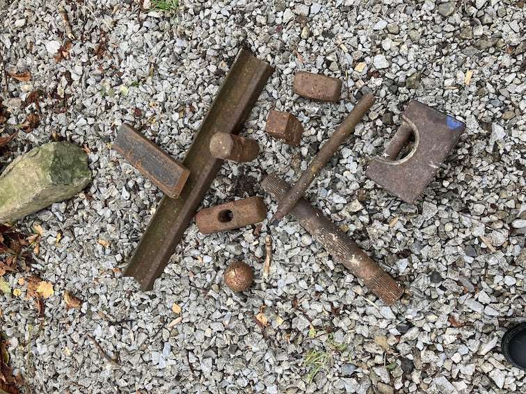

                        Chuck Taper
                          @chucktaper
                          What I lose in versatility I should gain in convenience (or vice versa!!)
                          Current “anvil”.
                          IMG_7693
                          FC

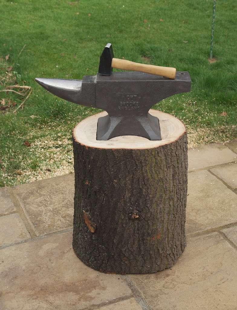

                            Vic
                              @vic
                              I got this unused 1cwt Brooks on eBay maybe fifteen years ago for £114 I think it was. A bit more expensive now!
                              IMG_7552

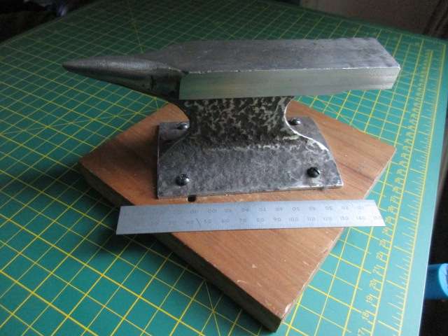

                              Nicholas Farr
                                @nicholasfarr14254
                                Hi, this is my small indoor one, which is made from a piece of narrow gauge railway line. Very useful for small parts and hammers, but I don’t class it as a Jewellers one though.
                                001
                                Regards Nick.

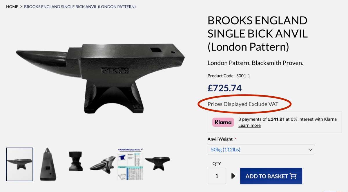

                                    Vic
                                      @vic
                                      This is the current model of my Anvil. Made of a single piece of cast steel with a face hardness of 63 – 68 Rockwell. Note the price – excluding VAT.
