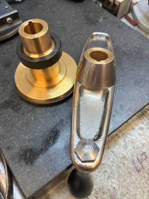

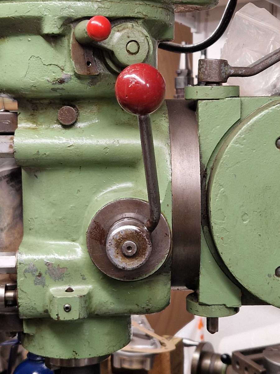

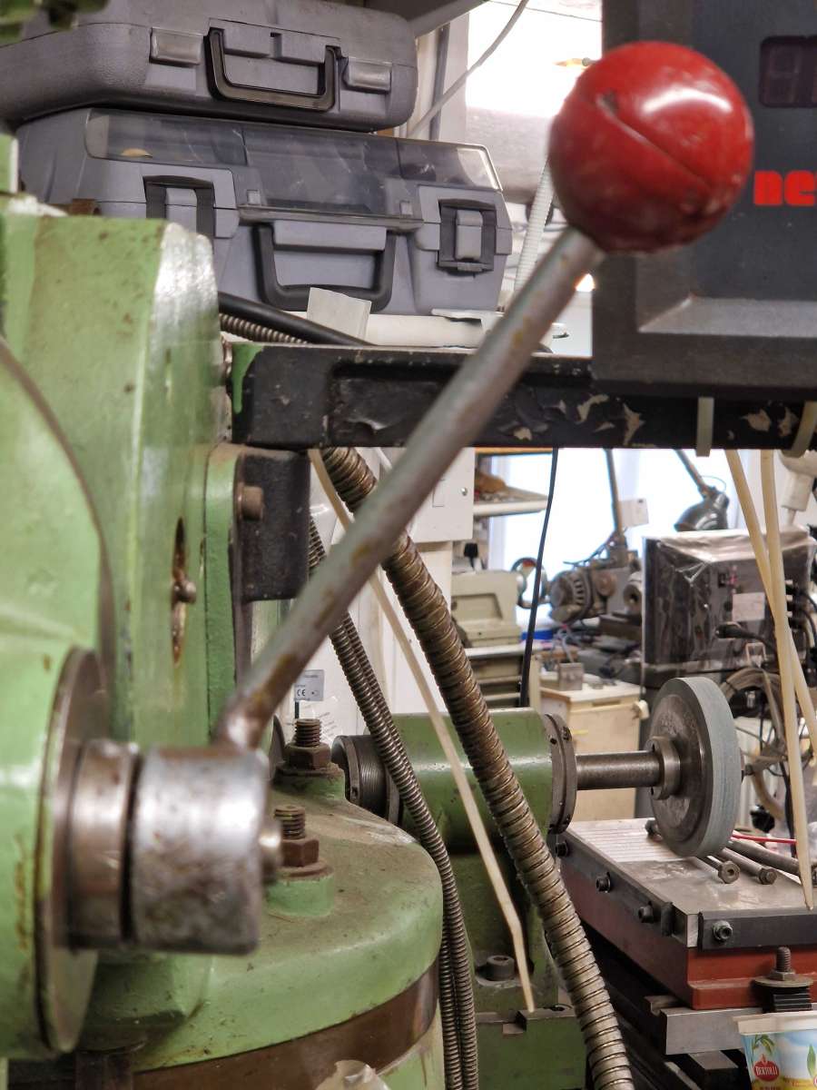

        Swarf Maker
          @swarfmaker85383
          Hi Andrew Skinner,

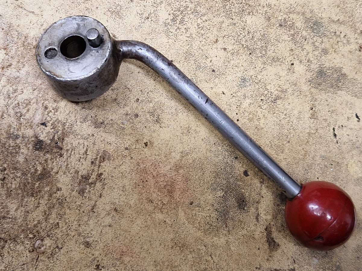

          The quill handle is very simple and basic.  I hope these photos help.
          Quill Handle 3Quill Handle 1Quill Handle 2

            Thanks swarf maker, the photos do help. Does your quill handle/boss just sit there loose, or have you removed the retaining bolt?

              #805397
              Swarf Maker
                @swarfmaker85383
                The handle sits on the shaft without any form of retention.  It is therefore easy to slide to the right and reposition for the required stroke of the quill.  Would only be a problem if the head was tilted to the right.

                  Right, cheers. I guess I could make a knurled knob to retain it if needed, using those threads in the end of the quill shaft.

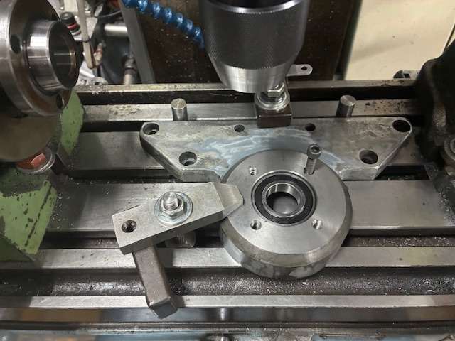

                    Lex Davis
                      @lexdavis38817

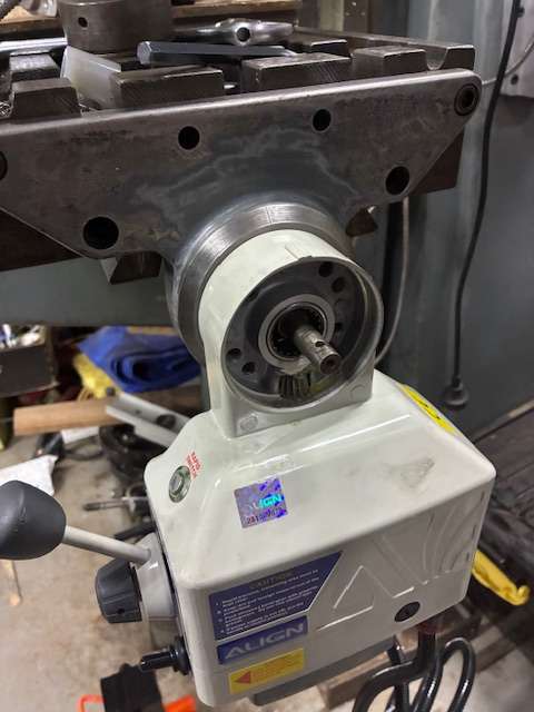

                      I am in the process of fitting a Power Feed unit to the X axis of my Beaver mill to replace the old mechanical drive, I will post photos as I progress with this.

                      #841862
                      Lex Davis
                        @lexdavis38817

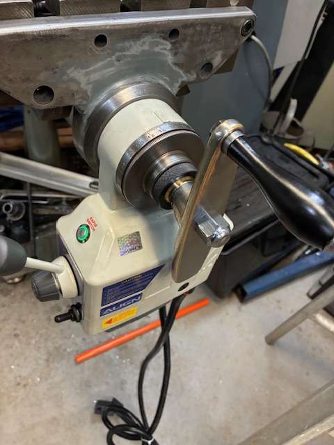

                        Pictures of the modifications to the handle.

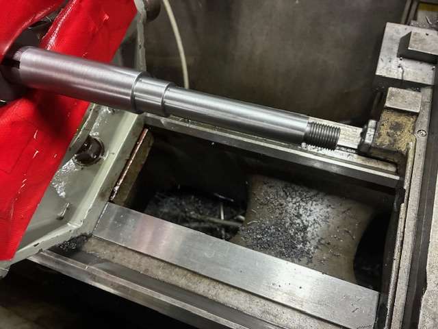

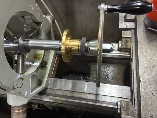

                        #842296
                        Lex Davis
                          @lexdavis38817
                          X axis leadscrew modified (extended). I just need to cut the keyways now.
                          Beaver 6
                          Beaver 7

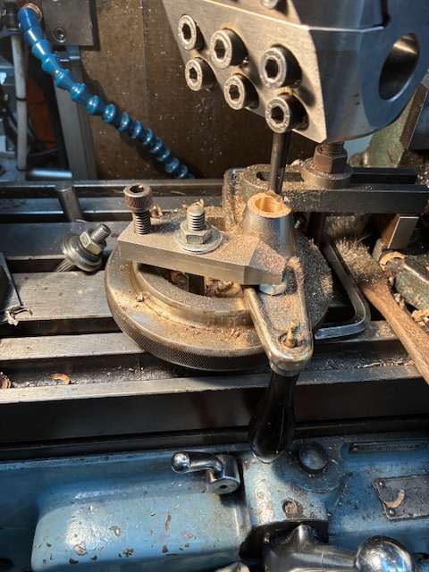

                                #842434
                                Lex Davis
                                  @lexdavis38817
                                  Yes, these things are great, I can go from about 31″/minute to virtually nothing just by rotating the dial.
                                  The installation is actually finished now, just have to secure the wiring.

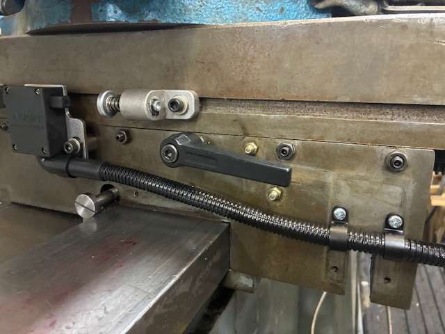

                                    @lexdavis38817
                                    Limit switch fitted and working well.
                                    Beaver 9
                                    #848908
                                    Andrew Skinner
                                      @andrewskinner94774

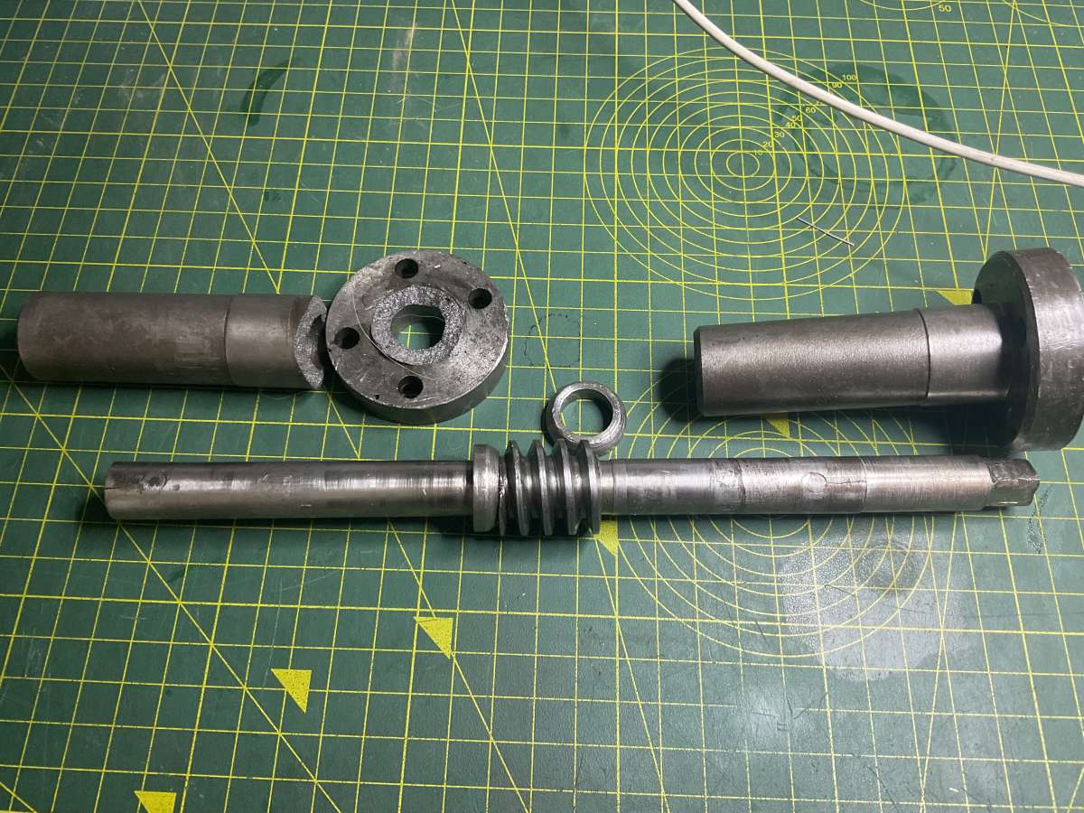

                                      I’m thinking of rebuilding the nod and tilt mechanisms on my old Mk1. The nod is very stiff and notchy, and the adjusting shaft has been twisted at some point. Any general advice appreciated.
                                      #848962
                                      Mark Rand
                                        @markrand96270
                                        What’s the condition of the ‘worm wheel’ segment that the worm on the adjuster works against?
                                        The shaft itself can be re-manufactured. The worm is an ACME profile, though I never measured the pitch/DP.

                                          Andrew Skinner
                                            @andrewskinner94774

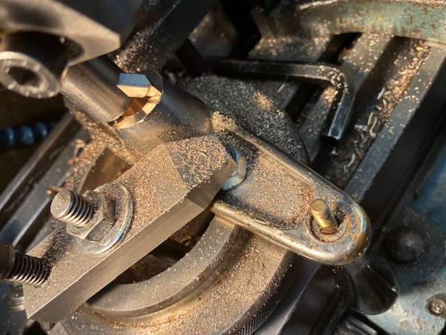

                                            Right, all rebuilt. I took the motor off and rotated the head upside-down, then supported it on some boards on the bed. With the ram and turret loose, I was able to separate the parts fairly easily, with the exception of the tilt worm shaft, which I’ve ruined. It’s back together now and trammed, just with ‘manual tilt’ for now.
                                            IMG_1431
                                            So, we have two flanged sleeves and two shaped washers either side of the worm. Someone before me has sheared the shaft and drilled and pinned in repair sections which have expanded, which meant I struggled to remove the sleeves, and in fact also ruined my bearing puller. Not realising the sleeves were cast iron, I gave the left-hand one a tap with a hammer and broke it.
                                            1. Should I just make a new sleeve from ordinary steel, or perhaps send the broken one to someone skilled like Doubleboost to TIG braze?
                                            2. It looks like the worm part is integral to the shaft. Would this be reproducible on a little Boxford lathe, or should I attempt to splice in new shaft ends to the old one, and how? If you look closely to the right of the worm, this has already been done, in addition to the repair further along.
                                            #850221

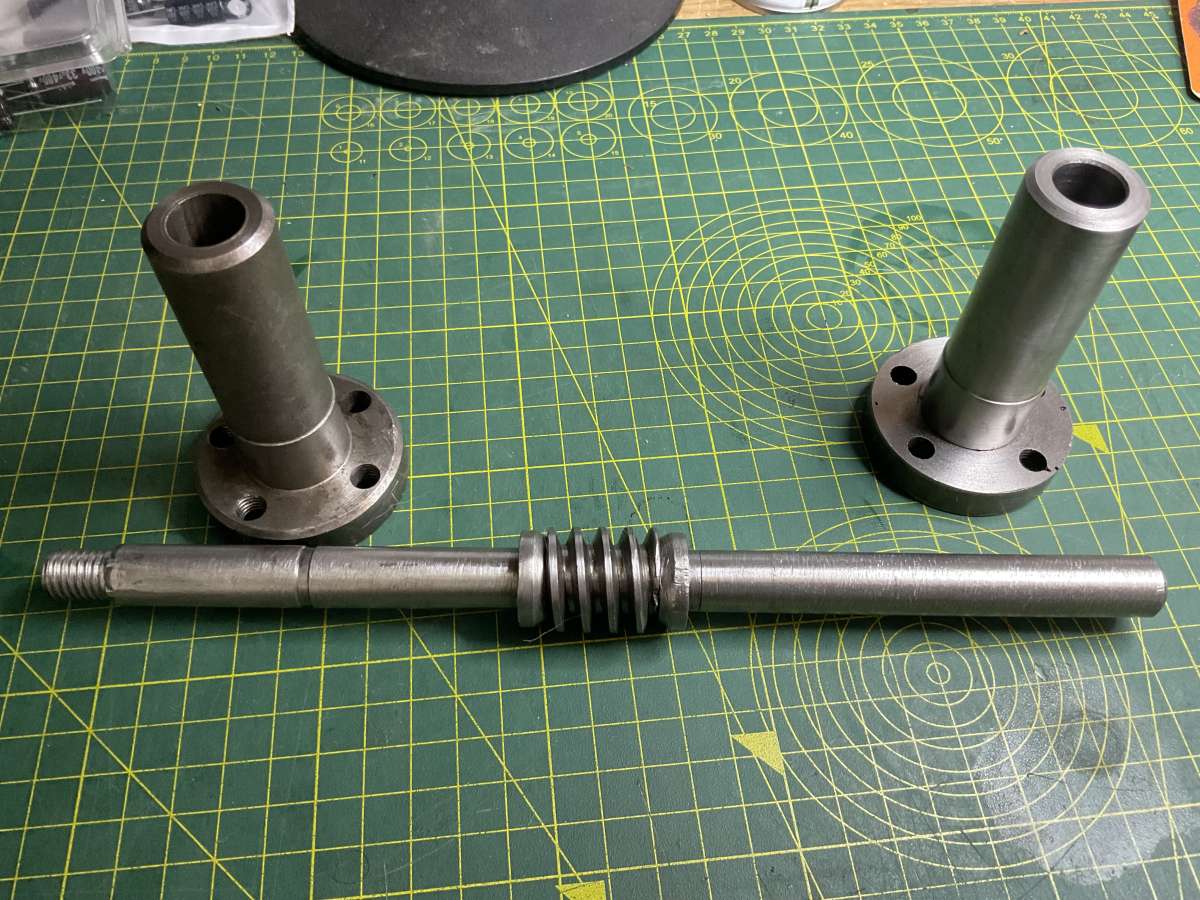

                                            Andrew Skinner
                                              @andrewskinner94774
                                              I don’t know why I didn’t get any replies, but anyway, here’s the repair I did. New shaft sections pressed on to stubs turned either side of the worm. New sleeve made (RHS) and the old cast iron flange pressed on to that.
                                              IMG_1432
                                              #850264
                                              Mark Rand
                                                @markrand96270
                                                Sorry, I got a bit short of round tuits 😀
                                                If I had found any of them, I would have commented that the reason you had a square drive on the shaft is almost certainly because a previous owner/user lost the splined handle and/or used a Mole Wrench on the shaft and buggered up the splines.
                                                Looks like you’ve done a more sensible job than the original.
                                                Did you use any Loctite or just a press fit?

                                                Andrew Skinner
                                                  @andrewskinner94774
                                                  No, it’s ok! I wondered if it should have been a new thread.
                                                  I drilled and reamed a blind hole in the new shaft sections exactly 10mm, to press fit onto the stubs at 10.025mm, but discovered that the cheap (hand) reamer I bought is tapered and somehow made a step in the bore.
                                                  So, I ended up skimming the stubs down, knurling them, smearing with red loctite and bashing everything home. I took the new shafts down to size after fitting them, so they ended up concentric.
                                                  Would I need machine reamers to make a parallel hole, or are all reamers tapered?
                                                  #850277
                                                  Mark Rand
                                                    @markrand96270
                                                    Hand reamers have a long lead-in taper to guide the reamer into the hole. machine reamers generally cut at the (chamfered) ends of the teeth. Machine reamers can be pretty hard to get aligned into a hole by hand due to the lack of guidance from the taper. To be honest, with a gauge (either bore gauge for measuring and/or bit of rod turned to the right diameter for trying), then boring the hole in the lathe can be as good as a reamer or better.
                                                    Once it’s all glued together and turned to size it doesn’t matter so much, so long as you could hold it concentric with the worm.
                                                    Don’t know if it’s worth re-manufacturing the thrust washer on the right side of the worm. It looks as if it’s suffered a bit. On a related idea:- Make sure that the sleeves can be pulled down firmly with their three screws each, without locking up the worm. If it does, you’ll need to machine a bit off one of the thrust washers or sleeves. A small amount of axial clearance in the shaft is not a problem. A negative amount is…
