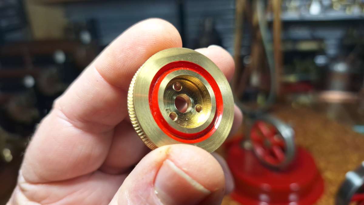

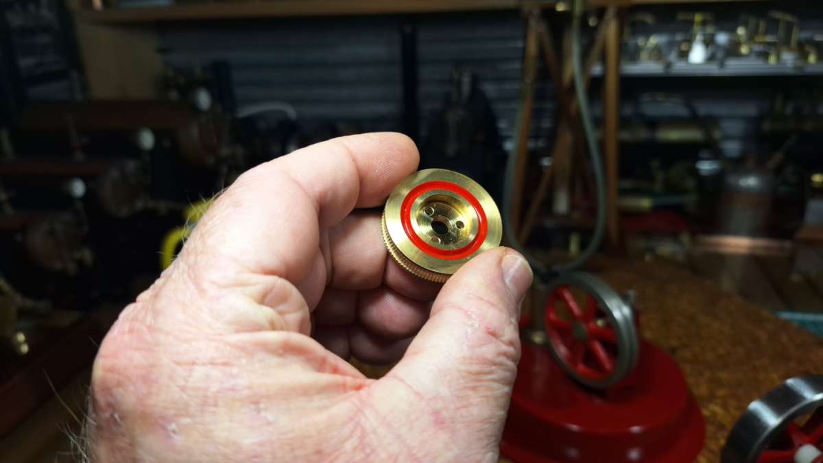

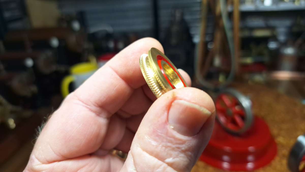

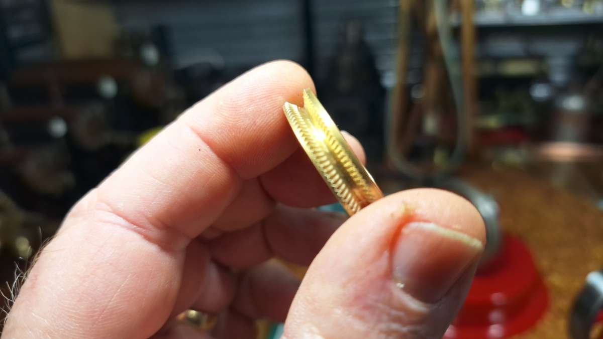

            The method of using a tap in the chuck of the lathe and the pulley on post for hobbing works really well. I made this brass pulley up this morning and hobbed it.
